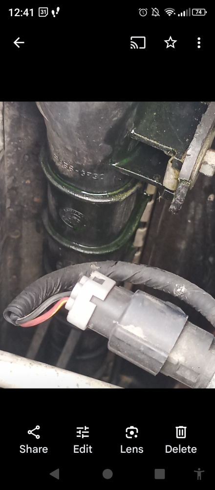

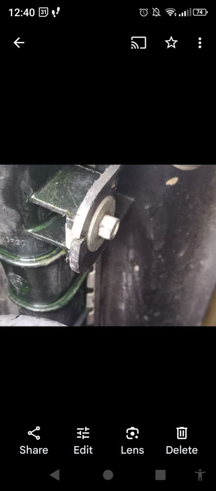

Here are some pics
It's hard to see the actual leak point in pictures, but it appears to be the radiator itself that's leaking. It's likely the seal between the plastic side tank and the metal part of radiator; or it could be a crack in the plastic.
Newer design plastic-tank radiators are usually replaced rather than repaired. It's really not that hard of a job to replace it, provided that you have the few basic tools that are needed.

You might try to call around to other repair garages and mechanics in your area to see if you can find one which will spend a few minutes to look at it without charging. Explain that you have a visible coolant leak at the radiator area, and you need an estimate to repair it. There's nothing wrong with telling them that you're on a limited budget, either.
The only other suggestion that I have that you can try, is to take a largish, regular screwdriver (with the flat tip, for "slotted" screws), and check that your hose clamps are tight. That's the silver band-looking thing in your second pic, that's around the big black rubber hose. There's a slot on the hex-screw that you can use a screwdriver on; turn it clock-wise for tightening. I have had loose hoses leak before, so it's worth checking and it's easy to do.
