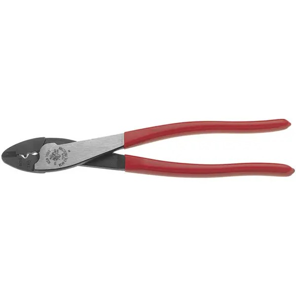

Not one works well on every application. By far my favorite is the Klein crimper...
because I mainly use non insulated type connectors and always use the dual wall shrink tube.
I’ve used a dozen different types of crumpets, those Klein are my go to as well.
The ratcheting ones are bit bulky and you don’t have as much control on the pressure.
The cheap insulated connectors are not all made the same. Some have thinner wall on the metal, some different thickness plastic. I have both the ratcheting crimpers and a set of channelock like the Klein's shown above. I do the same as gump.
I don't believe a single pair of crimpers work for every application. I have weatherpack... deutsch... insulated connector... non insulated connector... battery lug crimper...
Not one works well on the application. By far my favorite is the Klein crimper...

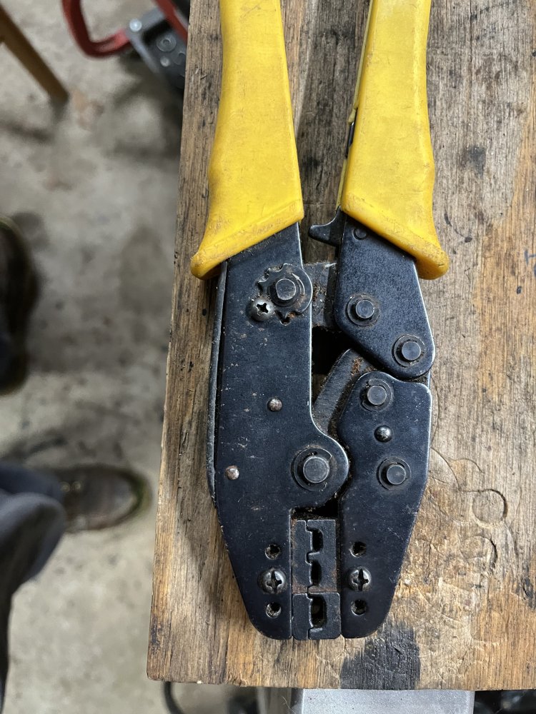

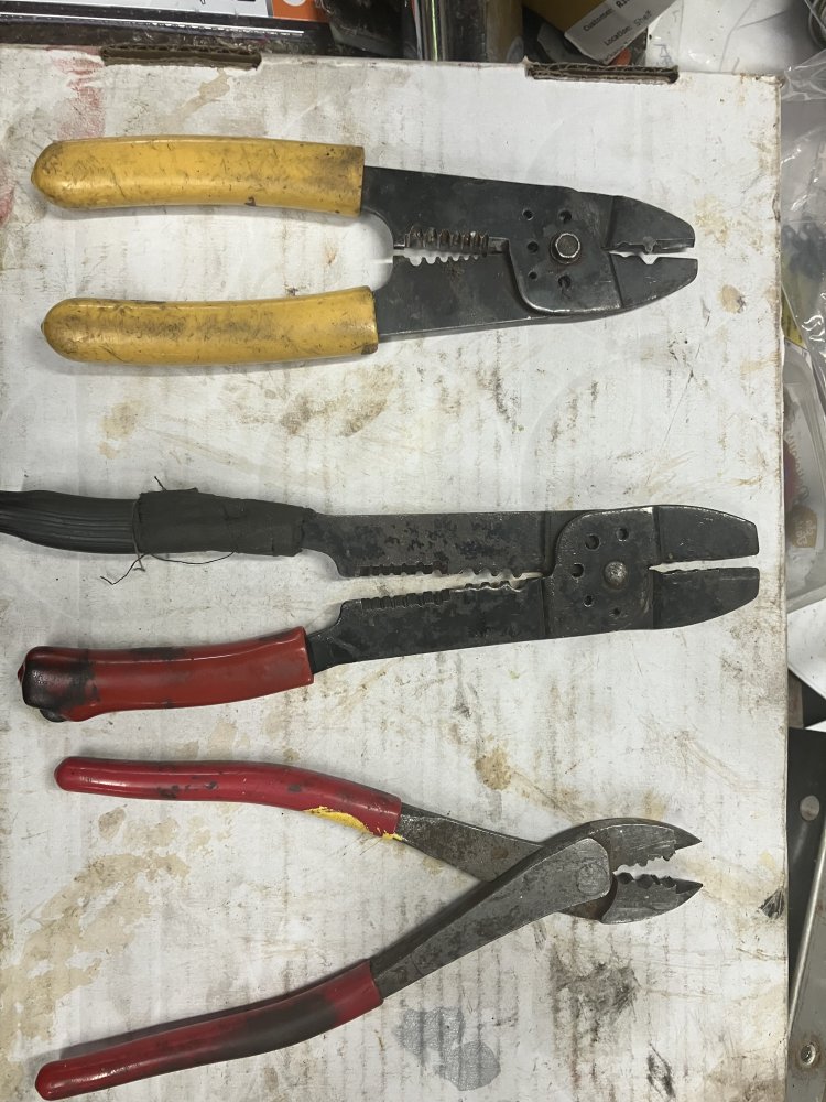

Like any old fart with dirty hands, I’ve got nine or 10 of these things at least. These three are my favorites.
The top/yellow pair are by far my go-to. I have no idea who made them, but they’re pretty high-quality. One feature I really like, is that you can tighten the nut at the pivot point. Cutting jaw on the tip rarely fails to cut anything that will fit in it, the bolt cutters do an excellent job, and the strippers do a 95% job. My experience with “one size“ crimpers is that it is more a matter experience/technique and applying the right pressure when holding the whatever in the right place, than the actual tool itself. I bought these new 20 30 40 years ago.
When I’m doing a lot of electrical work, with all different sizes and styles of wire, like the Road Ranger or Missing Linc, I like the pair in the middle for crimping. If you look on the user side of the pivot, there are a half dozen different size crimp diameter cut outs. They alternate from side to side.
I have peined (sp?) over the rivet several times to tighten them up. The front cut off jaws and the bolt cutters work, but not very well, and the strippers are worn and don’t line up anymore. In this thing’s defense, I found it underneath a spare tire in the trunk of a car, where it no doubt sat for more than a dozen years, rusted into the wheel well. I never pass up any tool, and it’s my favorite for crimping different size wires in one project, especially if I’m laying on my back under a car or such. The black handle is a piece of vacuum tube and friction tape for those times when I stripping something hot. Again, I have no idea who made these.
What I don’t like about these first two, is that it’s really easy to chop your finger with the strippers if you’re not careful. As I get older, and more wobbly, and my hands shake more, that’s a consideration.

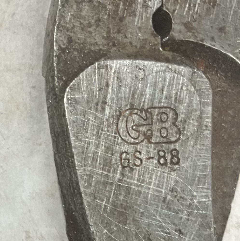

The third set, like your Kline pliers, are very high-quality. But if you look at mine close, they actually have two different size crimpers in the jaws. I bought these new in the late 80s, but I rarely use them. Unfortunately, the two crimp sizes seem to be about a half size off for anything I want to do. Maker’s mark:
Gardner Bender.
They make a lot of electrical related things. Zip ties, connectors, wire nuts, wire number stickers, hand tools. Their hand tools are all just ok, not HF chincey, but not what I would want if I was using them every day.

Ratcheting crimpers are supposed to be calibrated to give the exact proper crimp pressure every time, if the proper die is used. The quality if the crimp is much more accurate and repeatable.
This latest one has an adjustment star wheel in it for that very reason. I'm not sure about the other one for bare terminals. It probably does as well.
But you have one die setup for various wire gauges. Still only so dedicated. Even then, only so good if you are doing the same size wire all the time
Most of the time the dies bottom out to prevent over crimping, the adjuster wheel is only for the spring tension on the ratchet mechanism.

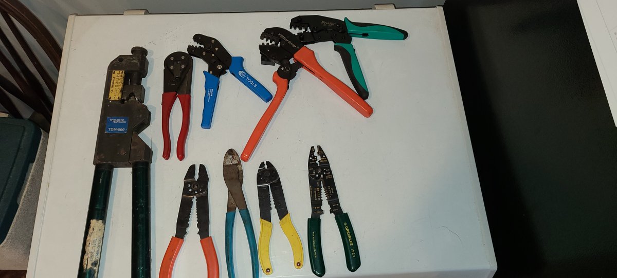

With that said, here are most of the crimpers in my arsenal. The Greenlee pair in the lower right corner gets more use than any.

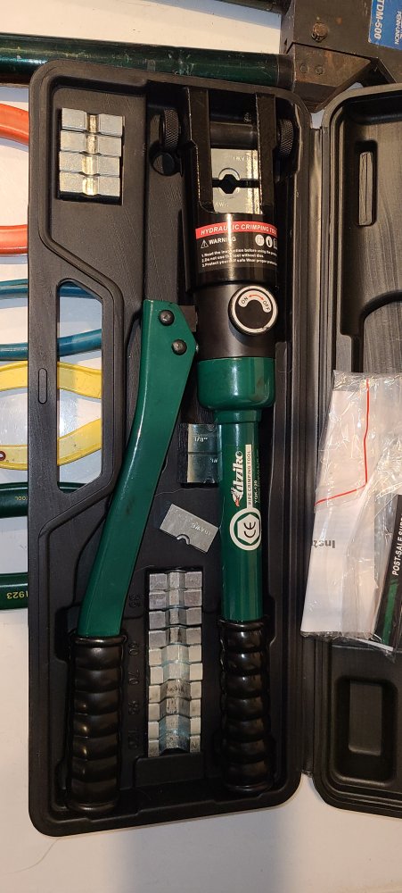

Oh, yeah. Forgot this one.
