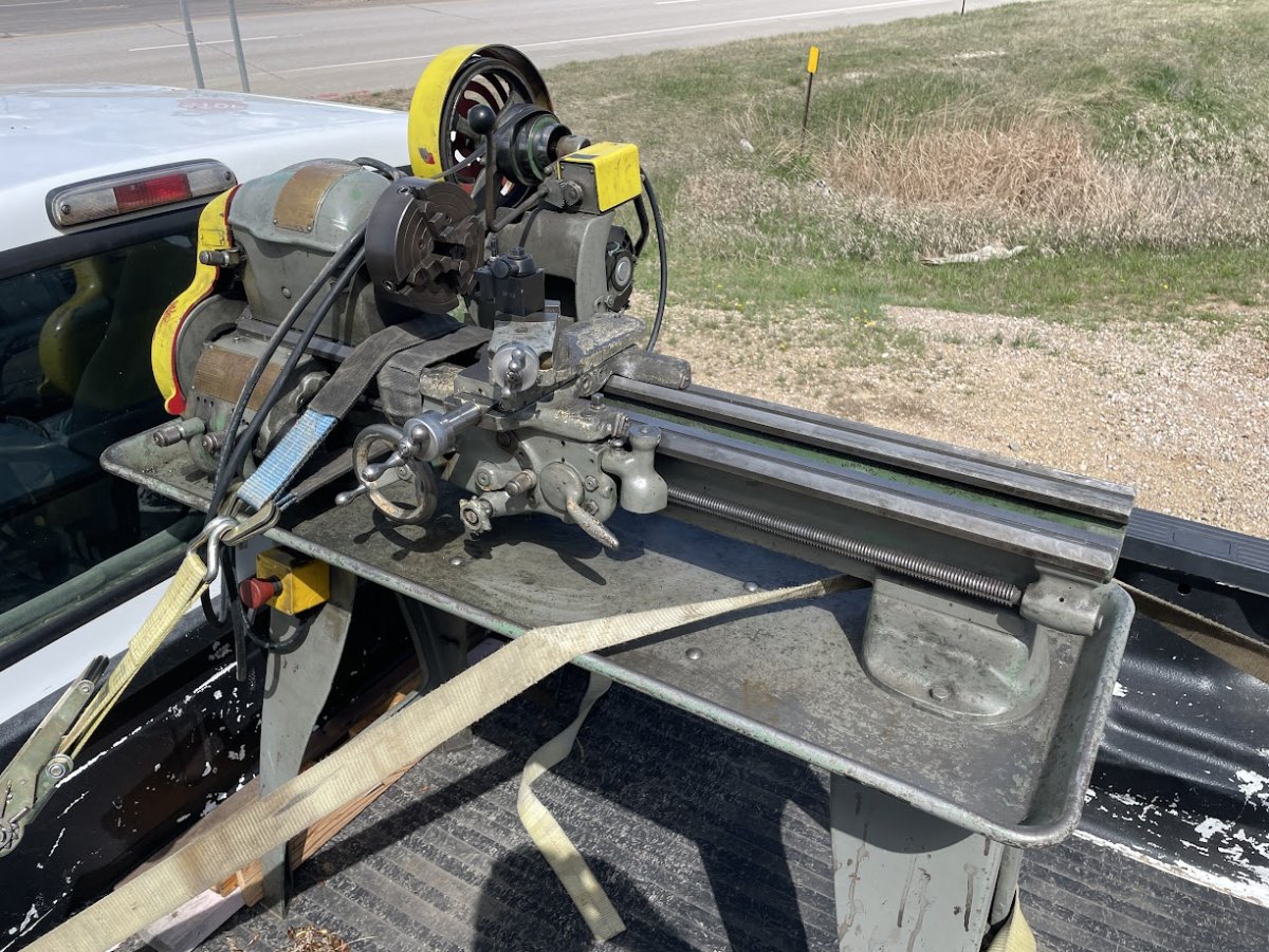

I've sorta been looking for a lathe. My requirements were pretty specific - no Chinese junk, single phase power, small enough that I can move it but big enough to be useful... I found this yesterday for $1200:
I haven't looked up the manufacture date yet but I'm guessing late 1950's maybe, early 50's and prior had no belt guard. It is a South Bend Model A with (I believe) a 3' bed. Pretty cool little machine, it has a quick change gear box for threading plus power feed and crossfeed. It came with 3 and 4 jaw chucks, brand new live center & drill chuck, 5 brand new tool holders and a couple carbide tools. I have some HSS tooling for it already. I got it from a guy who is moving across the country and didn't want to take it - he said he got it from a friend in Minnesota who got a bunch of these from a school and rebuilt the good ones from parts from the broken ones and I guess this was one of the good ones.

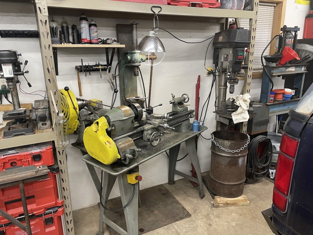

I ran it a bit yesterday and it seems to work pretty well. It has definitely seen some use and needed some cleaning & oiling but for my purposes it'll be fine. I'm not a huge fan of how the motor is mounted off the back as that makes it hard to find a spot in my shop for it so it ended up at an angle. I'll live with it - I think it's happy there.

Would it be hard to move the motor underneath? Maybe by adding an an idler shaft/pulley to loop the belt up close behind?

I'm sure there's a way to do it, and in fact they sold this lathe mounted to a cabinet and the motor was mounted below and somehow the belt ran down there. How that was accomplished, I have no idea. I'm sure I could figure out out but the motor is on a pivot with a lever for belt tension and it all works pretty well... at the moment I think I'll just leave it alone and think about it before I try to reinvent the machine. I may have an epiphany sometime in the future of how to make it work well. The belt tension feature has to work perfectly because switching pulleys is how you change speeds.

i’m not joking on this, but is that a cinderblock wall? What’s behind the wall? Can you take out two or three blocks so the motor nests in there?

EDIT: or move the motor above it? What about putting it 90° from the wall, where it sticks out into the room, but you could get closer to the wall when operating it? Would it fit better in a corner, swap it with something else? Just blue skying….

Nope it's a 2x6 wall full of insulation & sheathed with OSB. I'm sure I'll come up with a better place for it... I would really like to tear my shed down and use that space for an addition to the shop - would be my machine shop room/reloading spot... but I like the shed... and then I'd have to find a place for all the junk in the shed.
Where it's at will work OK until I figure out something better. I just need to stare at it for a while and it'll work itself out.

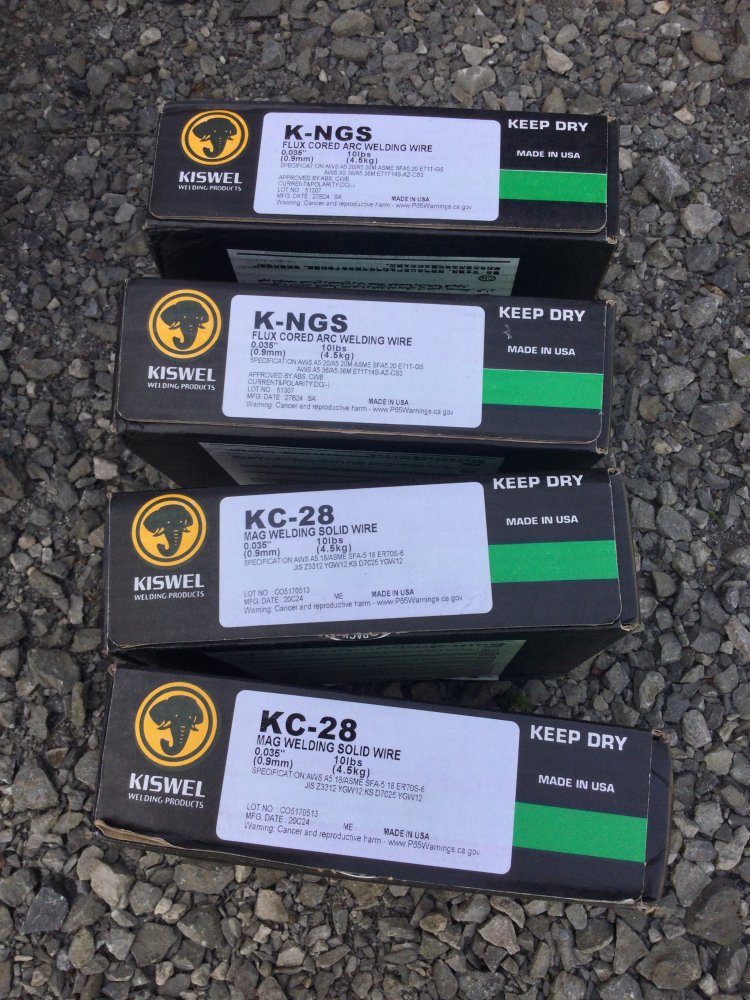

Welding wire showed up today :icon_welder::icon_welder:

That’s only a drop in the bucket. These are the smallest rolls my big welder will take without running a spool gun. They’re the biggest rolls my small welder will take. The big welder had a 44# spool in it that just ran out the other day, all four of these rolls are still 4# short of that…
