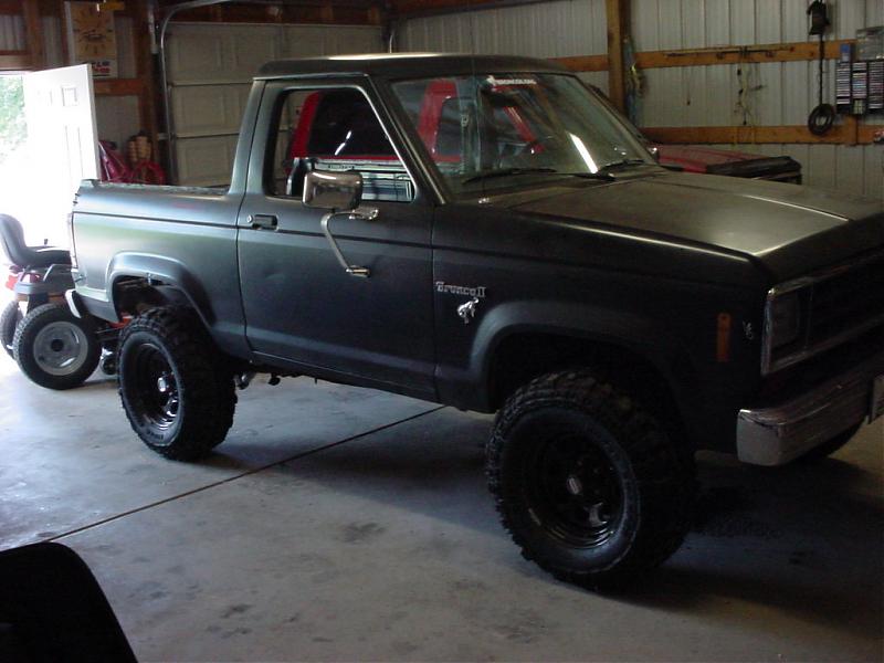

if it helps, I have a 2in suspension lift on my 88 B2 and I run 30x9.5x15 on it with no prblems, riims are 15x8, and the rims and tires didn't fit before the lift, mainly the front tires rubbed, in the wheel well, always wondered if I could fit 31x10.5 with only a 2 in lift.
I have an 88 Bronco II with a two inch body lift. I am running 15x8 rims with 30.9.50 15's with no rubbing issues. I had an 84 with the same 2 inch lift and ran 29-10.50-15 Super swamper SSr's with no issues on 15x8 steel rock crawlers.
Didn't know they made 30x10.5x15, I was always looking for a little wider tire than my 9.5s...without going higher.
