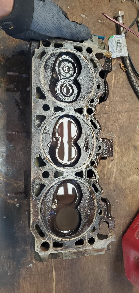

Hello, I just purchased a new to me ranger. 2000 ex cab 4wd with a 4.0 and 280,000 miles. Everything works great, but no compression on one cylinder (air blows right out exhaust pipe) and 90 comp in another (exhaust pushrod never loosens up and rocker arm sits higher than the other two next to it) . Looks like I have two bad exhaust valves. I'm getting ready to pull engine and replace heads with remanufactured heads.
I'm looking for advice on what else I should do while engine is out, and any other top end parts I should replace while replacing heads.

That's the info I was looking for. Thanks. Engine is out now. Cylinders look great. In fact each cylinder still shows the crossing marks from the honing. Unless this would normally show on an engine this well used, it's possibly a new short block? All exhaust seats are significantly sunken into the head.

Low compression was exhaust valve seats. Pretty much gone. Also each head was cracked between valves in one cylinder. New heads from King cylinder heads and the new rocker arms solved the problem. We took the engine out. Everything on bottom end looked good. Probably a remanned short block? Replaced all sorts of stuff (clutch and slave, rear main, oil pump) cleaned it up and slapped it back in. Forgot to hook up the big hose right under the throttle body. But once we figured out what we forgot we now have it running like a champ. Thanks for the help.
