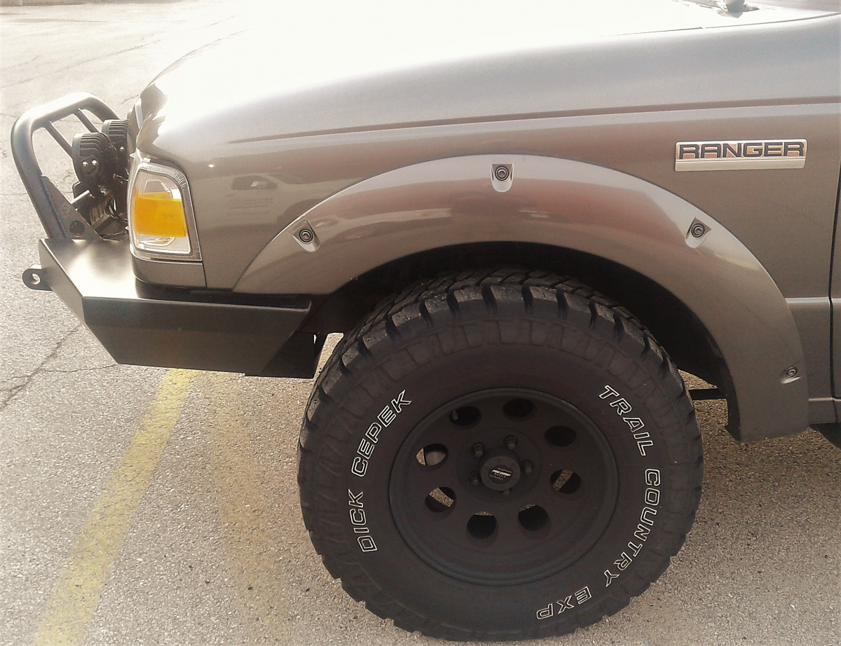

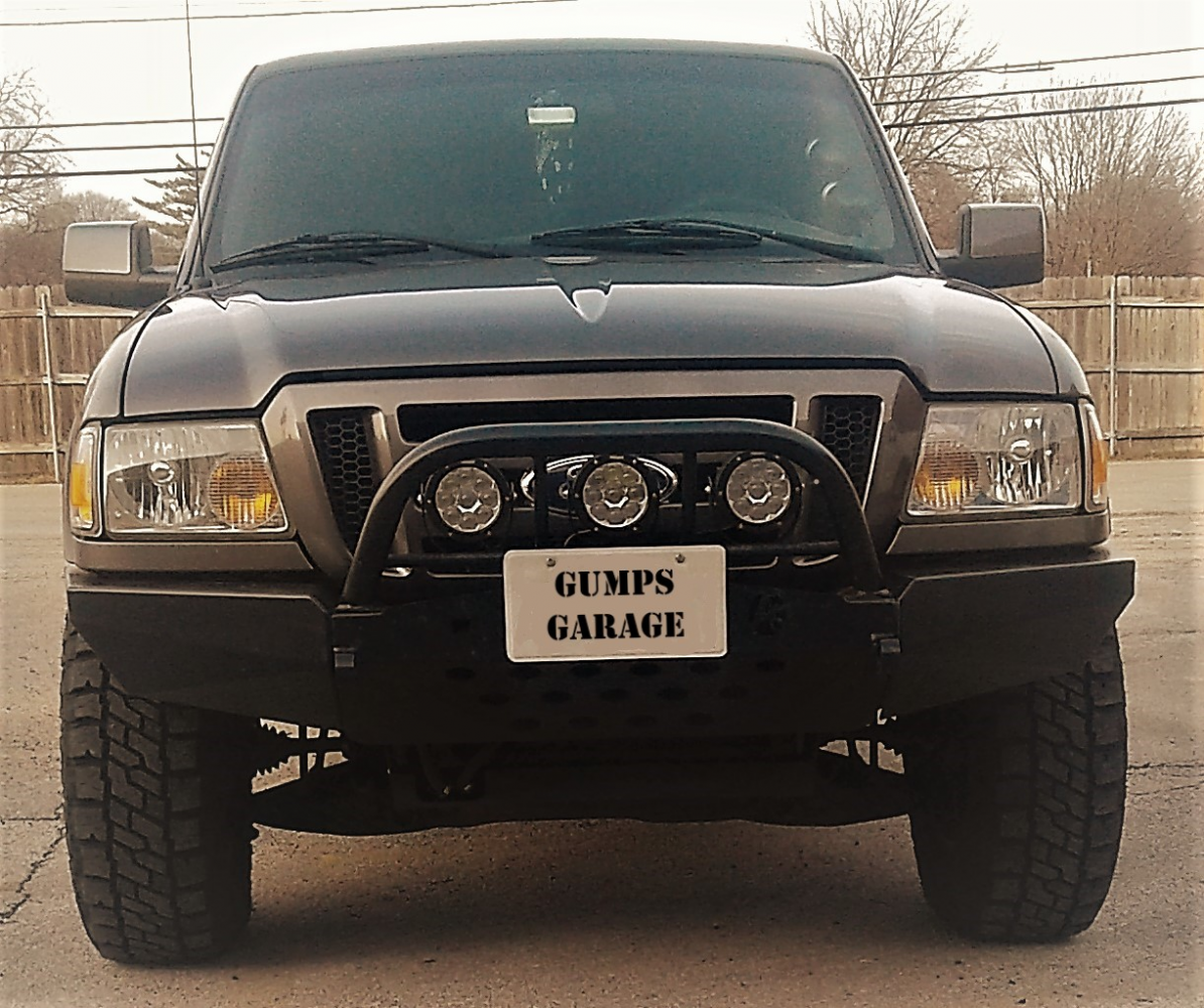

Take a picture of the front of your truck so we can see the angle your axles are at. This is mine for comparison purposes... My axles are fairly straight... leave both compression and rebound.

I can tell just looking at the lower control arm that you have to be about max. Look at your control arms vs. mine... huge difference.
I don't think you did anything wrong really... many folks do this very thing. The trouble is they wear shit out quick and it provides a pretty rough ride compared to the factory.
