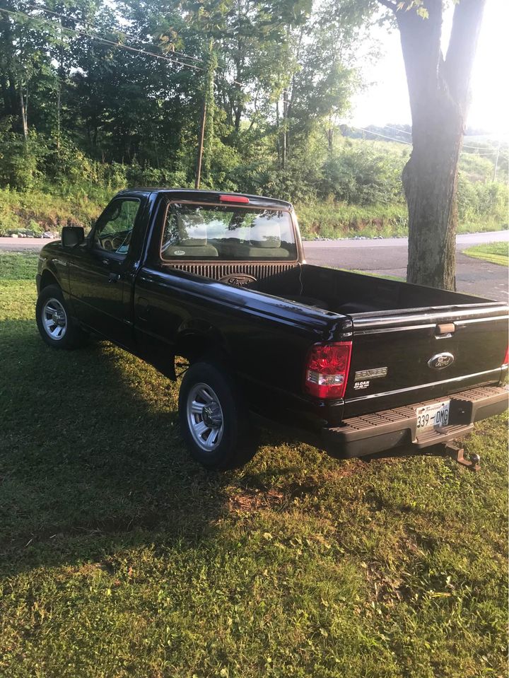

Just bought this very well-kept little black-on-black 2010 Ranger XL with the 2.3L and just over 30,000 miles! (see pics) It seems to have been garage-kept by a very old man. Look at all that pristine pleather! In this economy it was truly a deal.
That being said, this is my first "grown-up" vehicle -- prior to this I'd never paid more than $1500 for a car, usually half-dead Toyota trucks that I could bash into things without concern -- so I'd like to baby this one as much as possible.
That brings me to my question. I think I can assume that, aside from regular oil changes, not much scheduled maintenance has been done in its 11-year lifespan. It appears to have the original tires for example (which are a bit scary with cracks, and pretty bald -- high priority).
So then, which fluids (or anything else that has a scheduled replacement) will have degraded overtime, regardless of mileage, just while sitting? The booklet says new coolant every "105,000 miles or 6 years" so I guess I can assume that's due, but most things only provide a mileage guideline. Should I assume that, if they look okay, I can keep running other fluids? And what about things like fuel filter, spark plugs, shocks -- surely things like these don't degrade much while sitting, right? (it does feel pretty bumpy/squeaky though)
Right now, aside from the tires, everything looks fine -- but, see paragraph 2, I have white-trash standards. Like I said, I'd just like to keep this thing running smoothly a long time, so however I can baby it, I'd like to. A list of things to check would be a big help.
Please let me know if I should post these questions in another section. Thanks y'all!

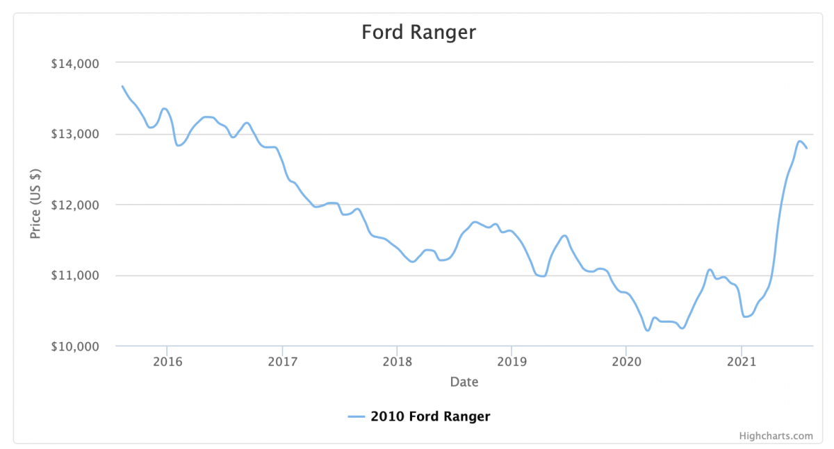

It was 9k which, if you haven't been watching this inflated used car market, might not seem that impressive, but as someone who's been obsessively shopping for a used Ranger for the past six months, man. Around that year/mileage, a private seller is typically asking 15k right now, and a dealership wants around 20k! It was actually still a little out of my price-range, but I couldn't resist.
63967
(2015-2021 average selling prices for the '10, as per carguru's price trend tracker)

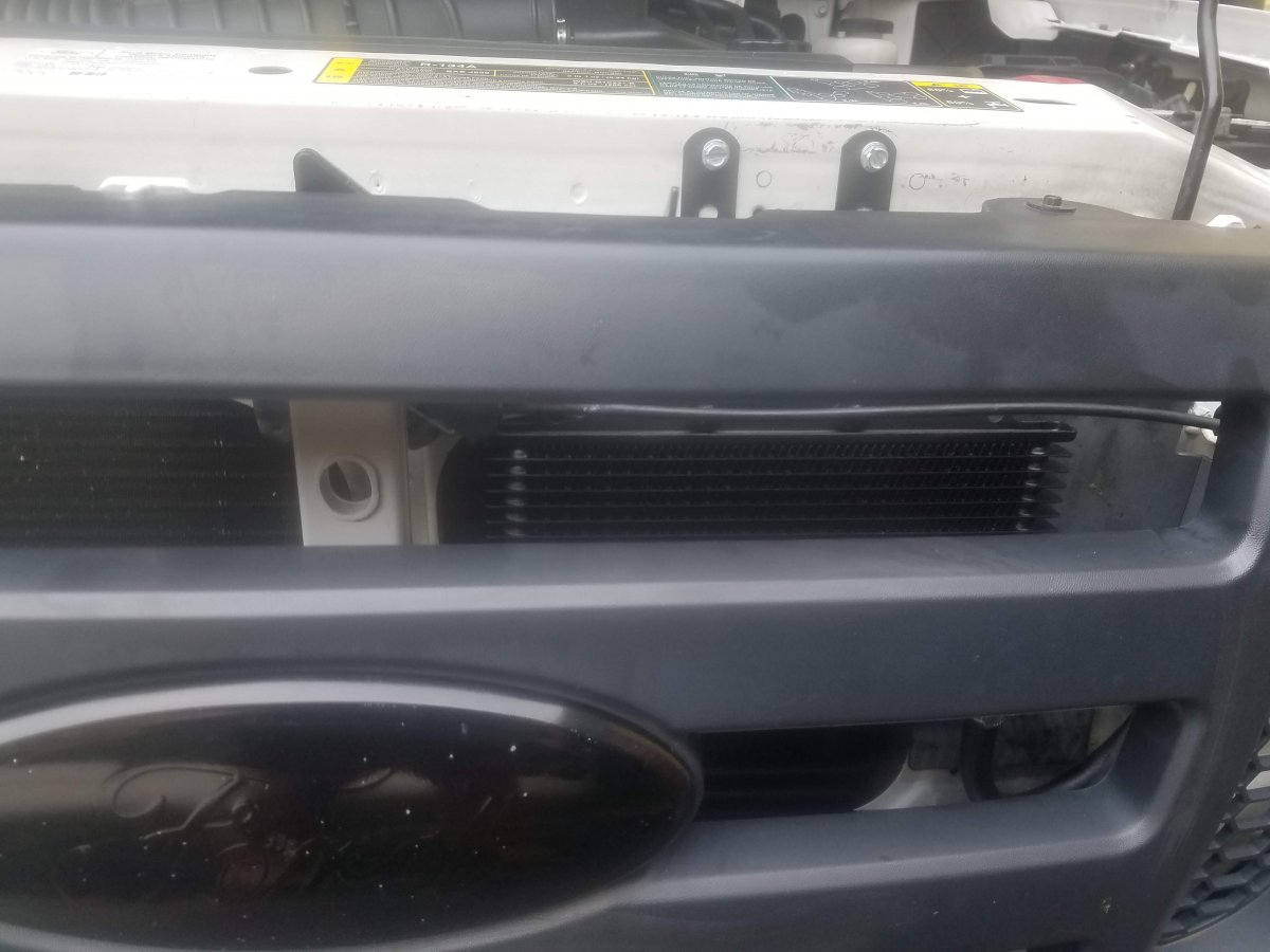

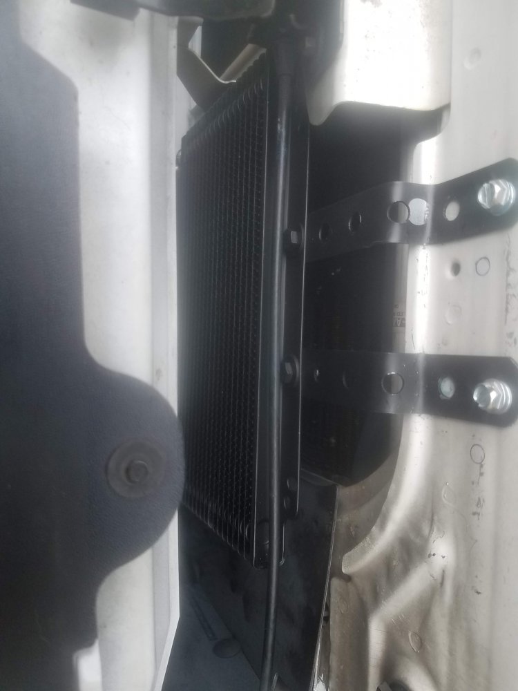

It will probably take me some time to make my way to this, but does anyone know of a good write-up on this sort of installation?
I don't see one in the tech section and didn't take any pics during installation of mine but it's a fairly easy install, a universal cooler works fine, you just need adapters for the transmission hard lines that fit a Ford radiator. Mine isn't fancy, I just used the universal "brackets" that came in the kit and with some clever bending it mounted good enough to the rad support.
