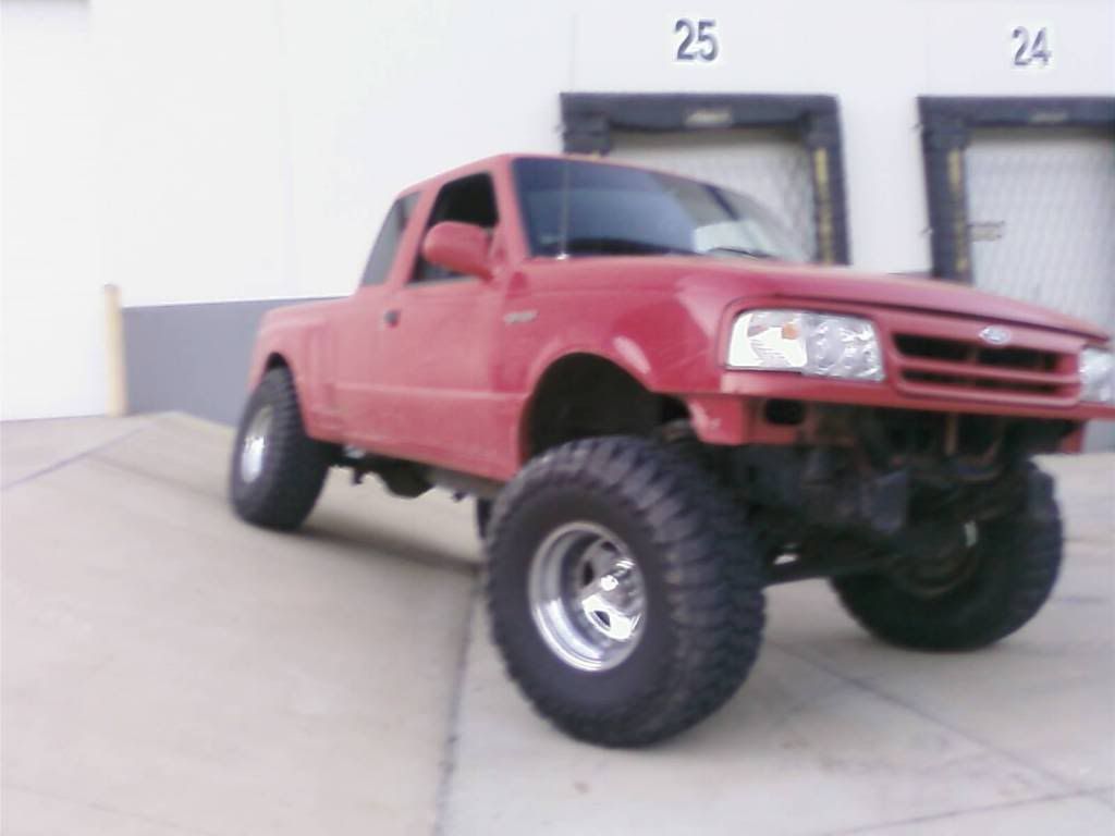

just put the locker in
real muddy
sorry pics are a little blurry, i took them with my phone
letme know what you think! sas soon to come!
nice truck any specs
Looks Awesome!!! what is the offset of the rims and do the tires rub???
that looks wicked, and if u dont mind any suggestions, im goin to suggest a strip of diamond plate between the tailgate and rear bumper to cover the gap
Hey thanks a lot guys! my wheels are 15x10 procomp steelies.The back spacing 3.75 and the tires dont really rub unless im making a real tigh turn.I plan on maiking some brackets to raise the back bumper here soon. my buddys dad has a bunch of scrap metal around so hes gonna grab me some for free.
Right now im running 4 inch rough country spring with a leveling kit and blocks in the rear 4.56 gears with powertrax no-slip locker.No worries i am complete up to suggestions.My future mods include a 4x4 counversion/solid axle swap(still in decision of whether to go eb dana44 with 31 spline explorer 8.8 with disks or full widths), rear bumper lift bracket,gap covers, biller grill and chrome looking grill
