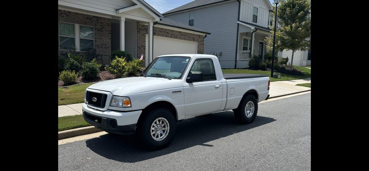

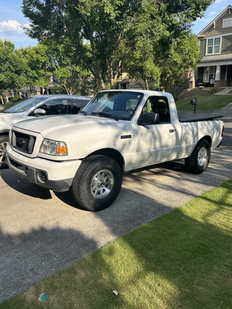

New here. Just got a clean 2011 and leveled it with method wheels. Wanting to pick some brains

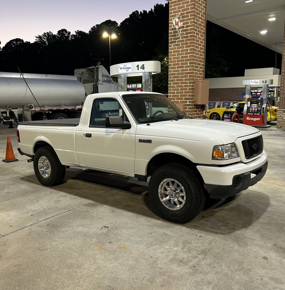

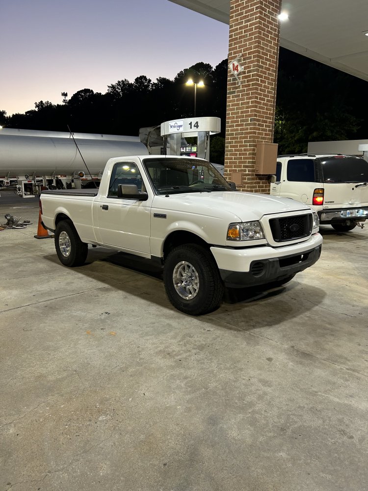

Ended up doing a one inch spacer and 5100s. Rides buttery smooth now.

1 inch is the way to go. That would look good in any driveway, welcome.
