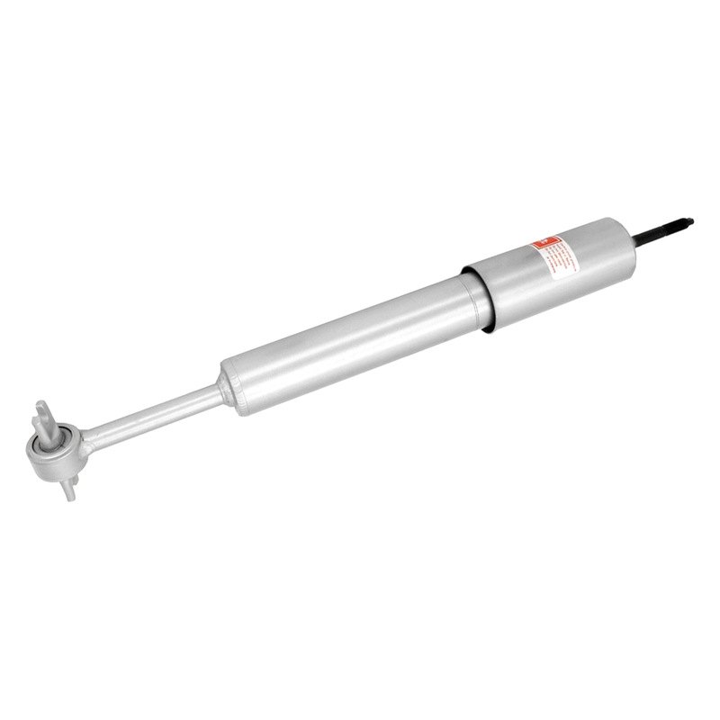

Hey guys, as the title says, my 2011 4x4 has 2.5'' front lift (changed and cranked torsion keys).
Now, I have the problem that my OEM Ranchos were to short and are now dead.
What companies make a strut that fits onto my truck, but is longer (3''). Be advised, my strut has a skinny part at the bottom to clear the shafts
Picture for info only (i have the OEM Rancho RS5229)
Nobody that I am aware of makes a longer than OEM shock except rancho. I forget model number but rancho makes one that's 1" or something longer than the stock ones, and that's about as much as you will get shy of manually searching shocks lengths and travel
