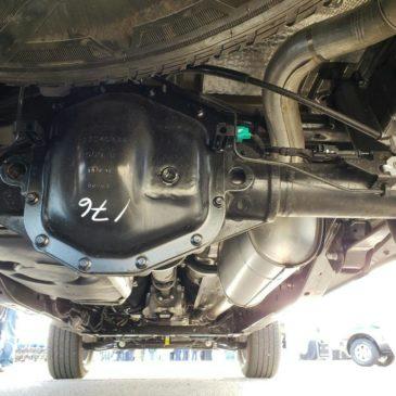

The only gear choice at the moment is 3.73:1.

And with the ring gear welded to the carrier I haven’t heard of any regear options.
My impression was that only the front differential had the ring gear welded to the carrier. The point remains the same though. Unless you can find someone with the skills to remove the old ring gear and weld on the new one, one can't do anything with the rear axle.

The thing I found last week doesn't really say which one I guess... shows a pic of the rear for what that is worth.
