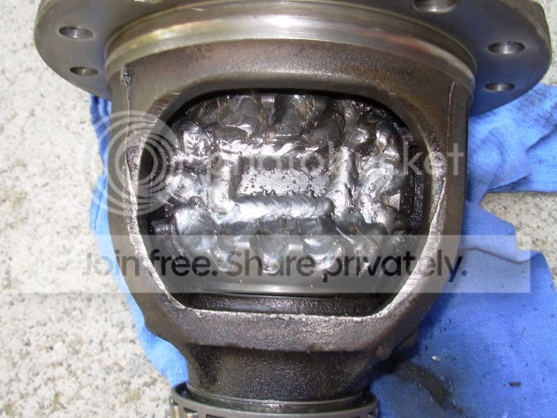

where the heck are the pics showing progress on the king pins and welding the diff?:dntknw:
Are they not showing up for you (red X's)? Are any pics showing? I can see em fine :icon_confused:

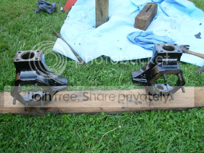

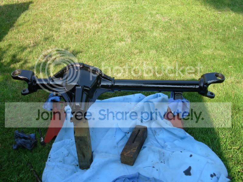

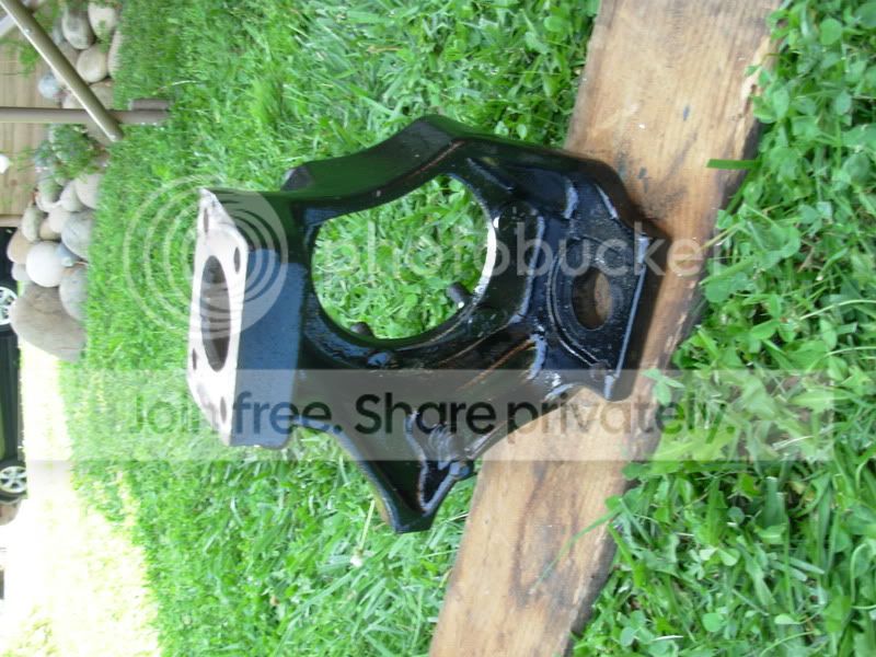

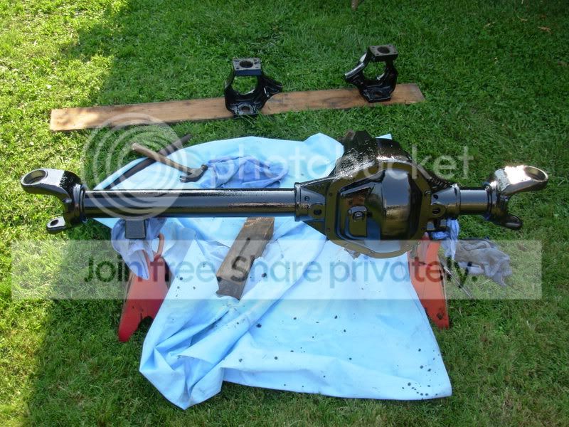

Got a little done this weekend. The housing and knuckles are painted. I used a special paint called Chassis Black. It seems to be really great stuff for keeping out rust. It cures by absorbing moisture from the air. Just as an example of how it works, i had a small container of it that sat for a while between coats and after about 2 hours, the top of the paint was a rubber-like layer that was about 1/16" thick. I pulled it off and the good paint was still there under it. Anyway the top layer cured to a rubber-like layer that stuck together really well. When it cures to the axle and itself, it should be great for keeping out rust. Its sensitive to UV rays the color will fade with time unless topcoated, but im still debating whether or not to bother. If i was to topcoat it i would probably use bedliner but that stuff isnt cheap. Anybody have any input on using bedliner? Would it be worth it? Anyway, here are the pics!
And i also got the carrier cleaned up with the wire wheel. Looks pretty snazzy now 8)

try clear coating the axle, maybe that will prolong the uv brake down on the nice looking parts.
I may try that. I am still debating whether to use some roll on bedliner as well for durability...

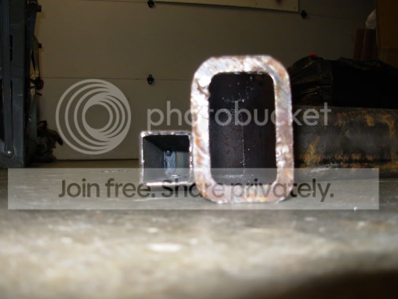

Have all the axle parts ready to go but first i need to build a truss for the axle that will serve as a mounting area for my panhard bar and hydraulic assist steering ram. Built one out of 1.5"x.120 wall square tubing but it just wasnt beefy enough. So i headed to the scrap yard and picked up some 2"x3"x.25" wall tubing. Heres how the two compare:

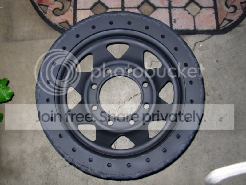

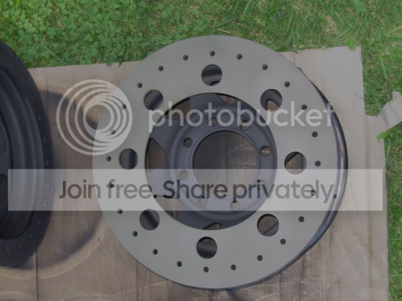

Also i have the beadlocks all painted and ready to go on the wheels. Heres the wheel:
And with beadlock ring (its olive ddrab green, darker than it looks in the pic):

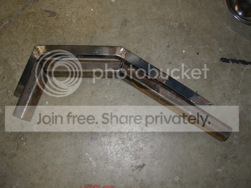

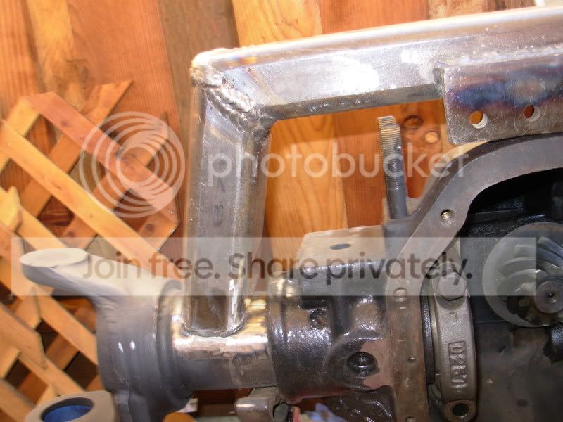

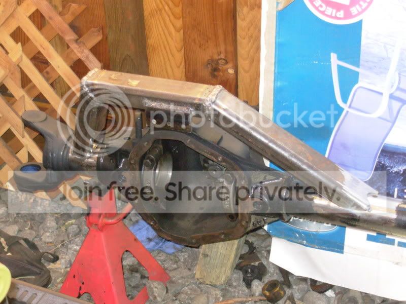

Well the truss is tacked in to place. Its all ready to finish weld in but some stuff came up today so i couldnt finish it. Heres how it stands now:
Clearance for the square tube that will bolt up like leaf springs:

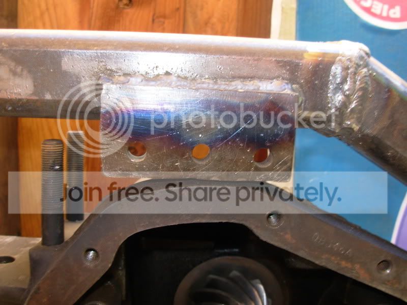

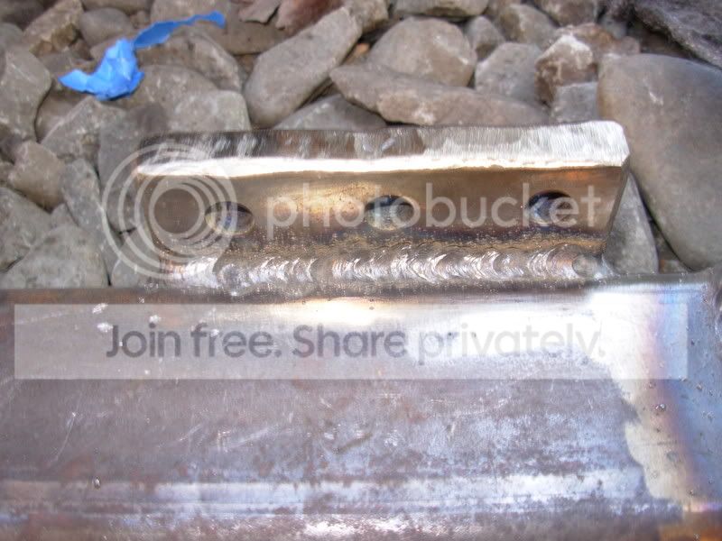

Also got the plate that will bolt up with the differential cover drilled and welded in with innershield wire:
Flush with the diff cover mounting surface:

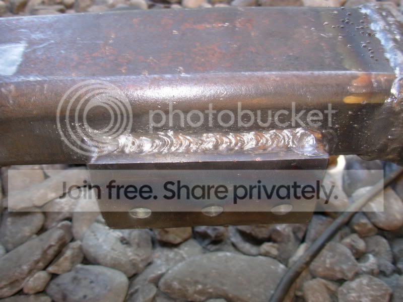

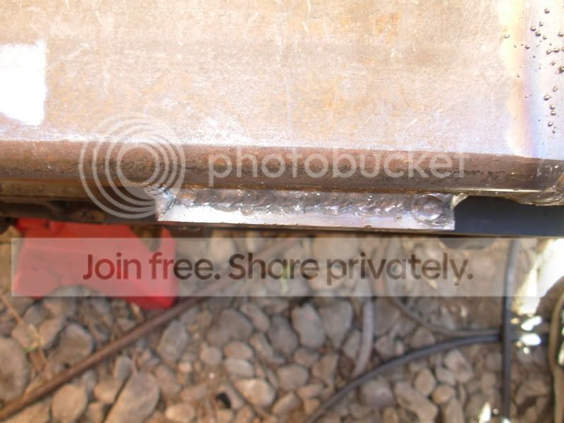

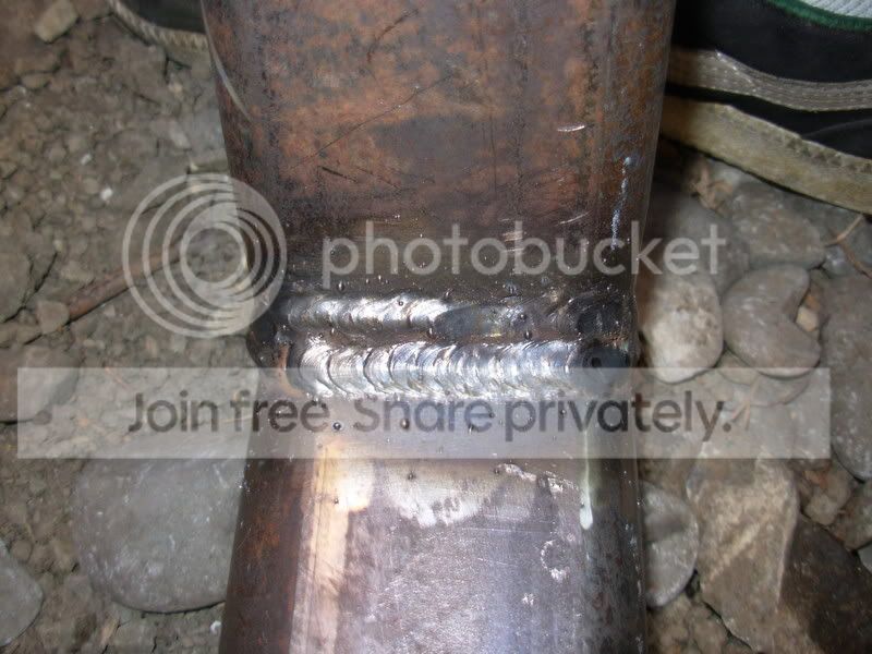

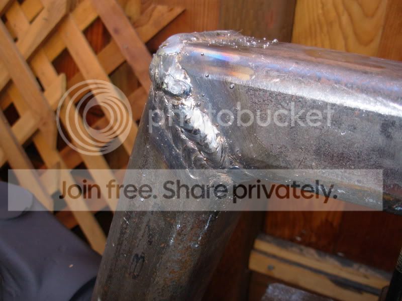

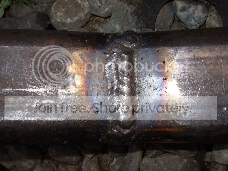

And heres a few pics of the welds (first one is worst of all the joints) on the truss just for kicks and critique. These were done with solid wire and gas, 3 passes at each joint:
