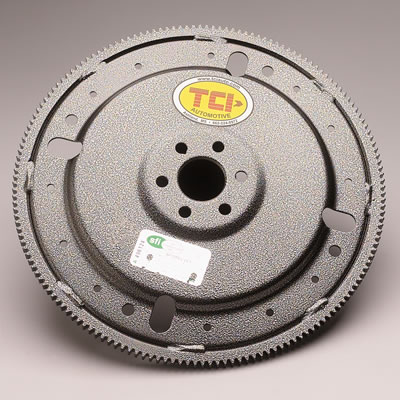

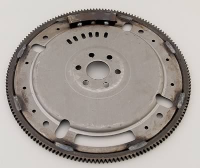

Top picture is stock flexplate with weight, bottom is a neutral.
