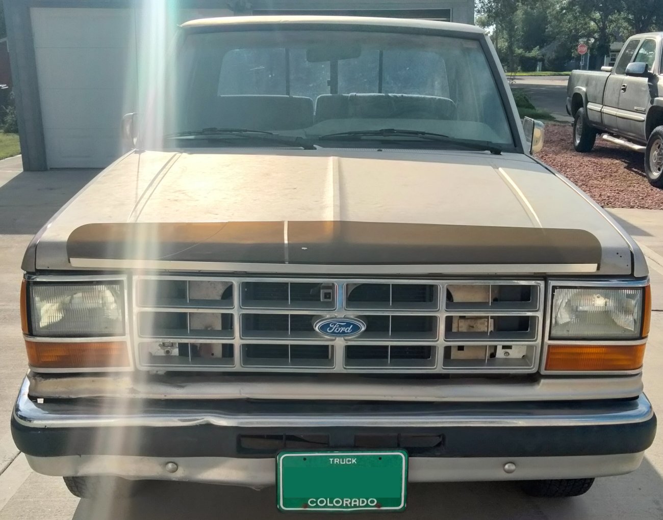

As many of you know I squeeked getting the paint done on the last decent weather day of the year (unheated, uninsulated shop) - and I mean really squeeked.
Before
After

Example: There is a big long nasty scratch on the drivers fender - can't see it, can't feel it, but the instant I put the sealer on it showed.... I stopped and sanded it way down, past the grey sealer, the tan base coat, down into the deepest layer of thick tough factory primer, thought I had it and re-shot sealer over it... instead of a 2' long scratch I have a 4" scratch and said "gonna live with it, snow is about to fly, gotta get this done"... well that kind of being rushed showed up 3 or 4 times elsewhere.
During cut&buff I also burned completely through the clear and even through the basecoat in 3 spots, you can see 2 of em in the hood above - right on the edge where the hood meets the grill.

The hood shows the absolute worst of my body skills.. I started on the roof and spent forever getting the 1000 hail dents out of it, then worked all around the body leaving the hood till last(the hood was the worst, figured my skills would be better by the time I got there)... I got pissed and frustrated and sick of banging away on it and started bondo... same thing hood was dead last and eventually I said "F it, it will be what it will be!".
