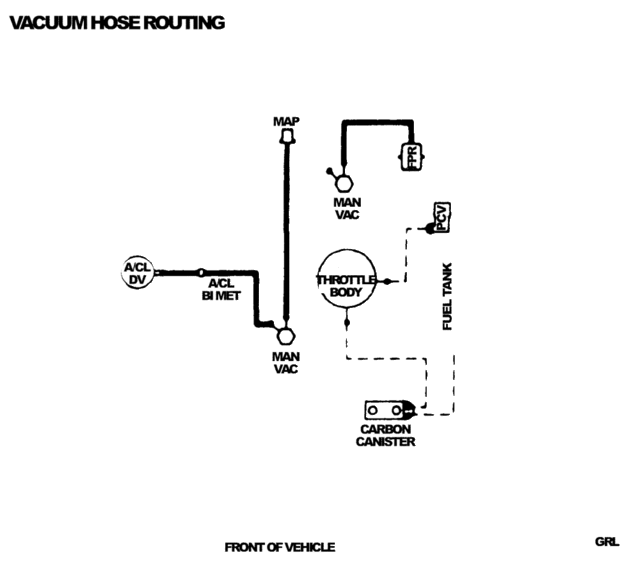

I think i found my problem. I knew the vacc line was supposed to be out the back of the FPR. After looking at pics on the 2.9 online i seen where its supposed to go. Somebody had a line going over the other side of the valvecover running up to where the FPR line is supposed to attactch.
I unplugged that that line and used to for my FPR and did it right way.
I can hear that there is another vacc line leak when it runs after taking it off of that valvecover. But it runs smooth as can be....no bucks, no stalls.
Does anyone know what that other side is? I will try to snap a pic.

Here, this should help...
The PCV valve that was on there has 2 nipples. one that goes to the throttle body and another one that just leaks. I bought a new valve and it didnt have 2 nipples just the one that goes to the throttle body. It did help lower the idle.
but now after driving it another 50 miles all symptoms are back. Should I just get a brand new FPR? When I pulled the vacc line off the backside there was no fuel...ive read other postes and they always seem to have gas in the hose.
But i guess that doenst mean mine is not bad right?
Thanks for the diagrahm lost bushman!
