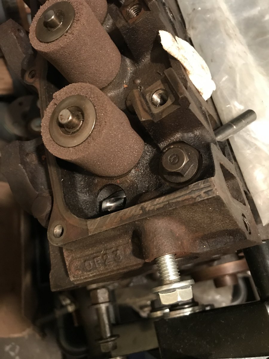

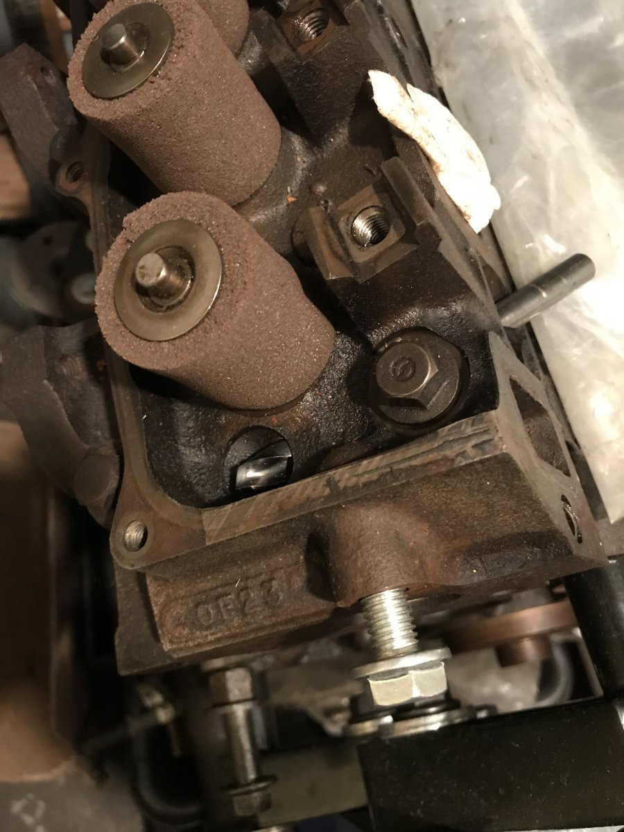

here is a pic of the oil drain at the rear of the drivers side head. that's a 3/8" drill sticking thru it.
you can see if it were not flowing oil would soon be flooding the springs & seals.
kindly ignore the custom low pressure valve springs. ( I have many unfinished projects )
The oil drains were definitely open. Minimal oil on top of head.

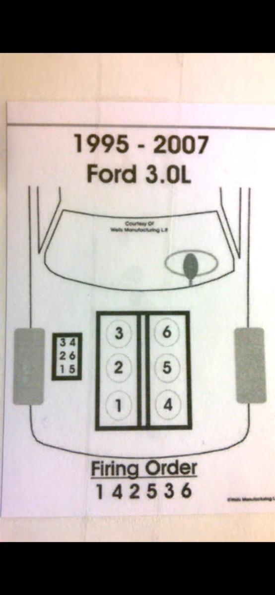

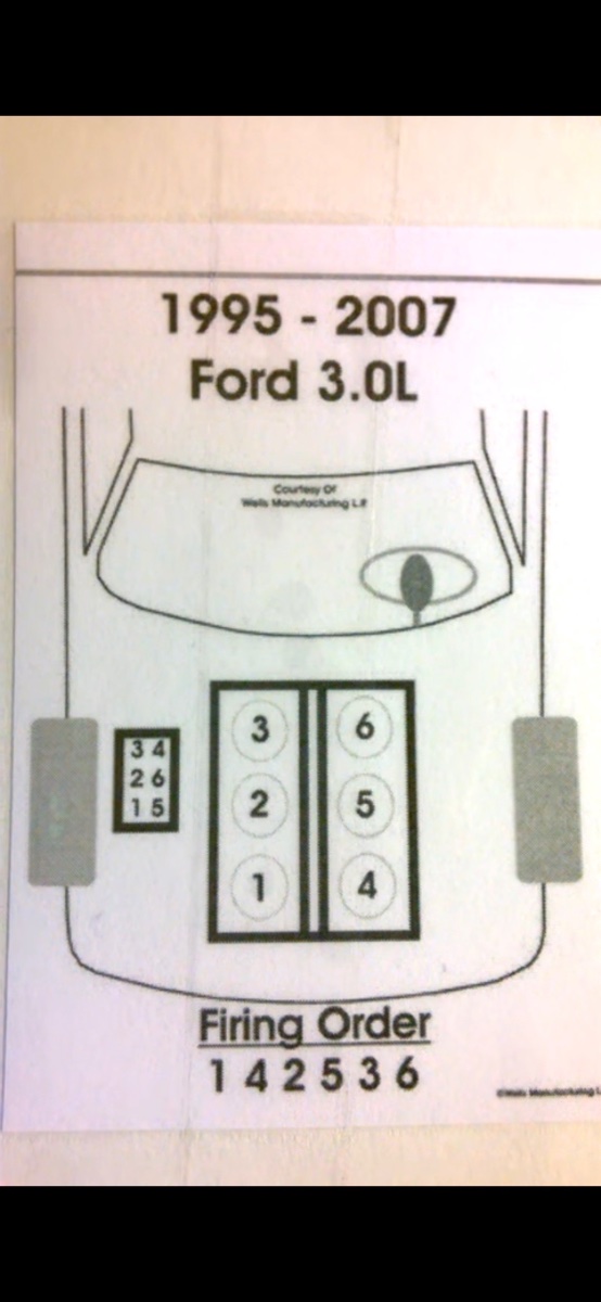

the firing order is 142536. thats left-right left-right left-right going from front to back. various valve cycles do overlap.

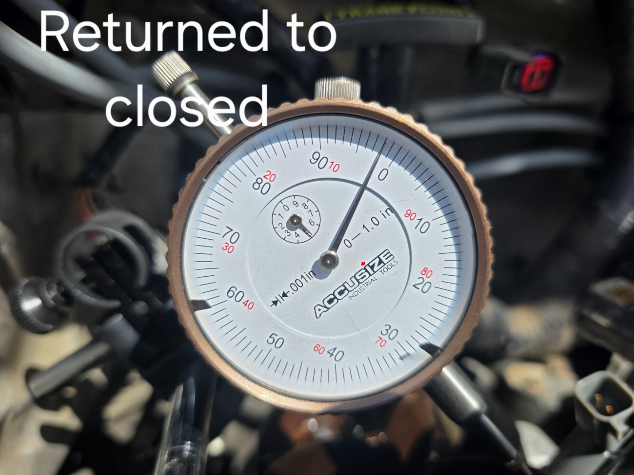

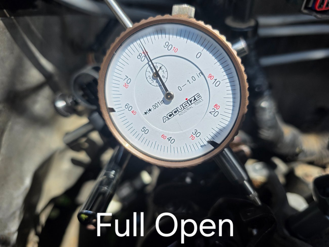

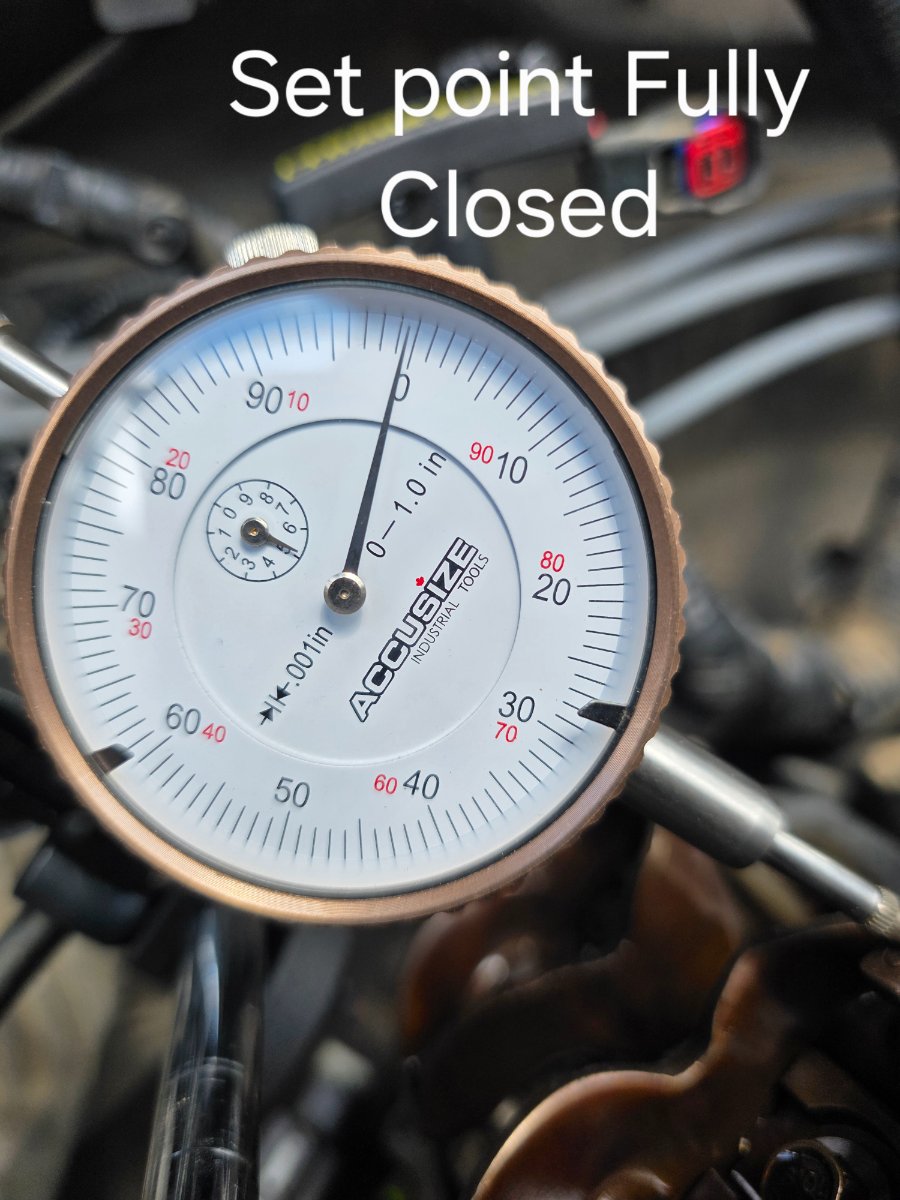

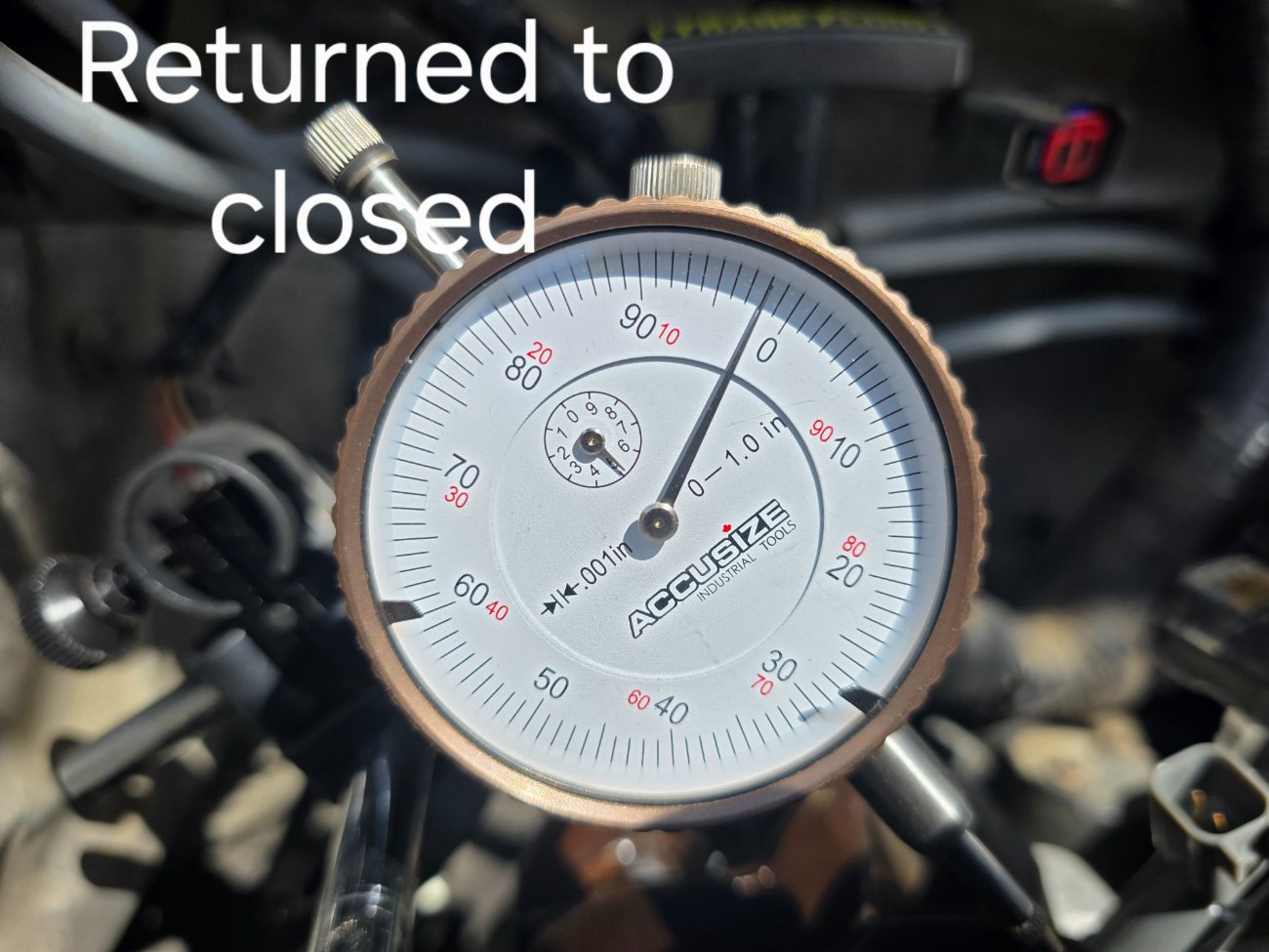

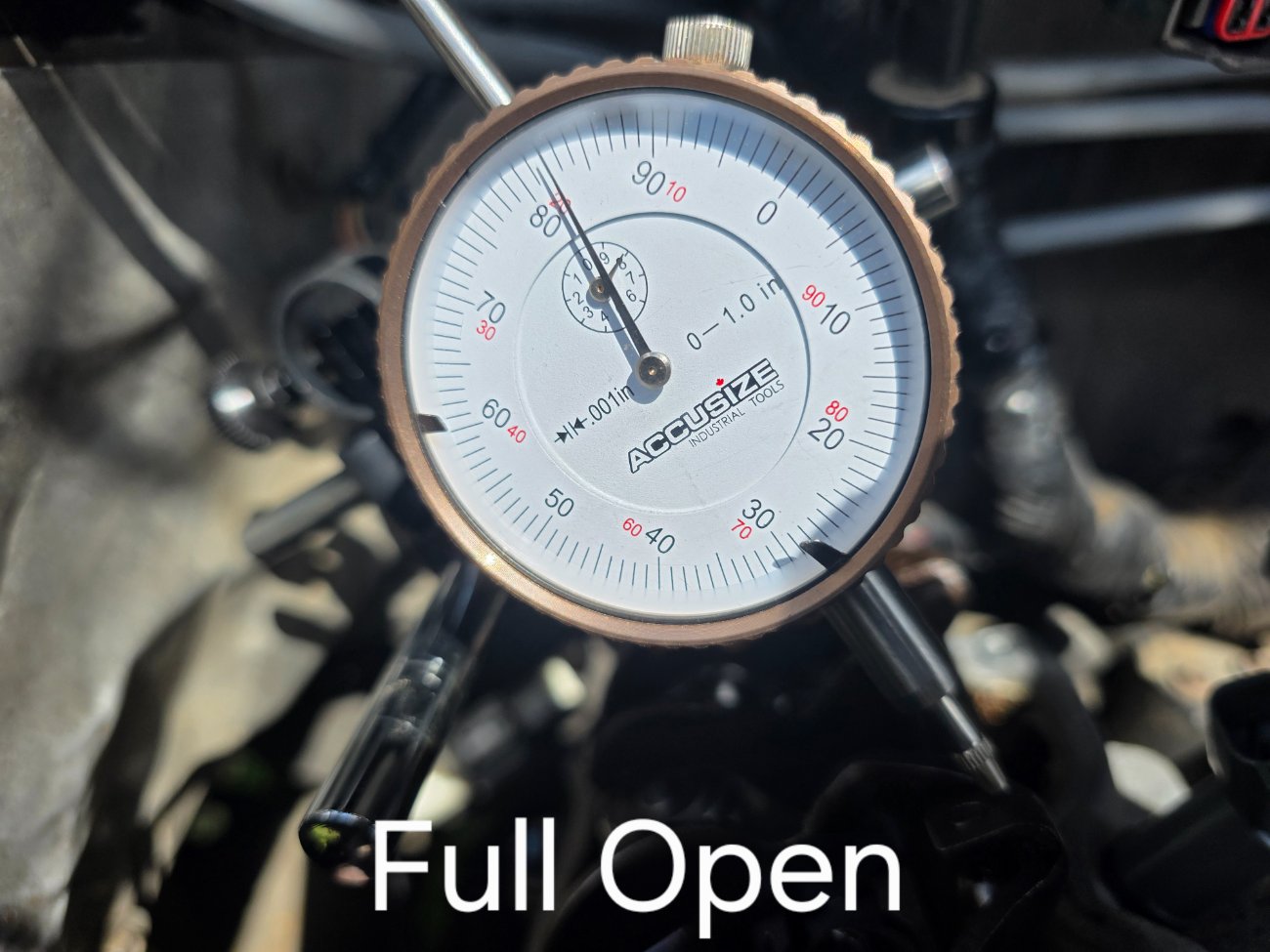

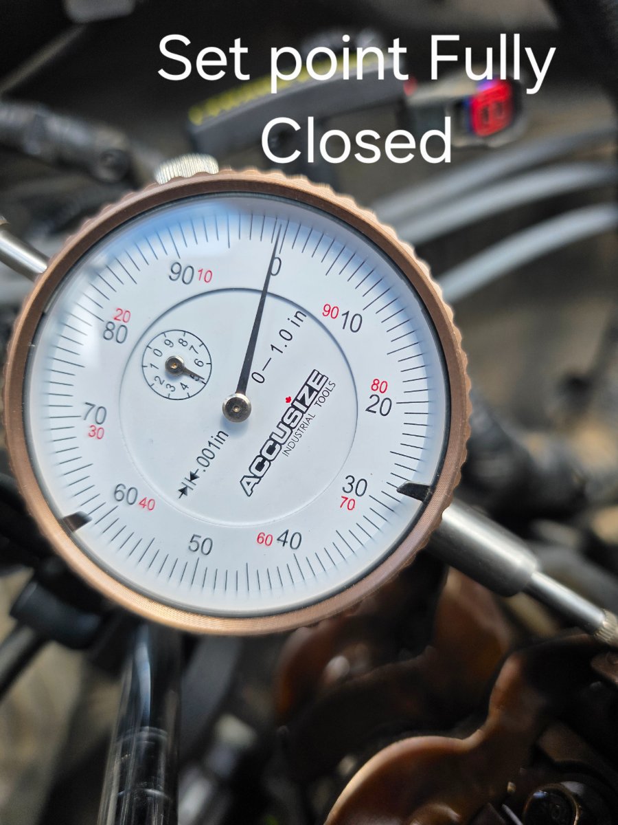

So far, I've rocked the crank back and forth and made several revolutions by hand. Engine barely makes any noise at all. No clunks, cranks, pings. Really nothing to indicate breakage. Set up a dial indicator on Cyl 3 valves, and got some measurements. 3 exhaust- 0 movement
3- intake .290+/- (I say that for 2 reasons, 1. The hydraulic pressure bleeds off at full open. And 2. The indicator base or joints flex a little every time) I assume the bleed off is by design. But we know what they say about assuming.
Next up, I'll pull the pushrod and use a borescope to check the valve seating.
EDIT: Found bent pushrod, verified lifter was moving. Getting a new pushrod.

good work.
hopefully it's just a matter of installing the new pushrod and reassembly.
