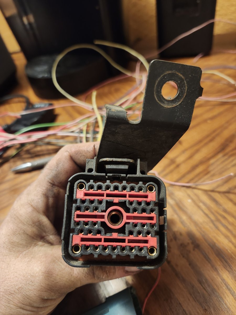

I need a pinout of this connector so I can finish a wiring conversion. Thanks in advance 1999 2.5

Looks like the c124 which is the main engine connector.
The site referenced by @franklin2 has both the engine wiring diagrams and connector pinouts, for that year and engine, they appear to be right out of the Ford EVTM. Usually I'll make a table, with pin number, circut number, and wire color then go through the diagram and figure out what passes through the connector and what pin it's on then make a note as to where it goes in my application. There is no diagram that specifically calls out all of the wires in that connector by function, takes a bit of homework.
