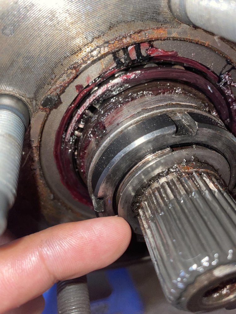

So I got a 1997 4x4 and the hub crapped out on me at the beginning of the month. Shop was dragging their feet and I finally get it towed to my place since they said they can't find hubs for it. I need help finding what the part number/name is for the set of outer washers on the spindle. It's the last thing I need before I can put this all back together. Thanks

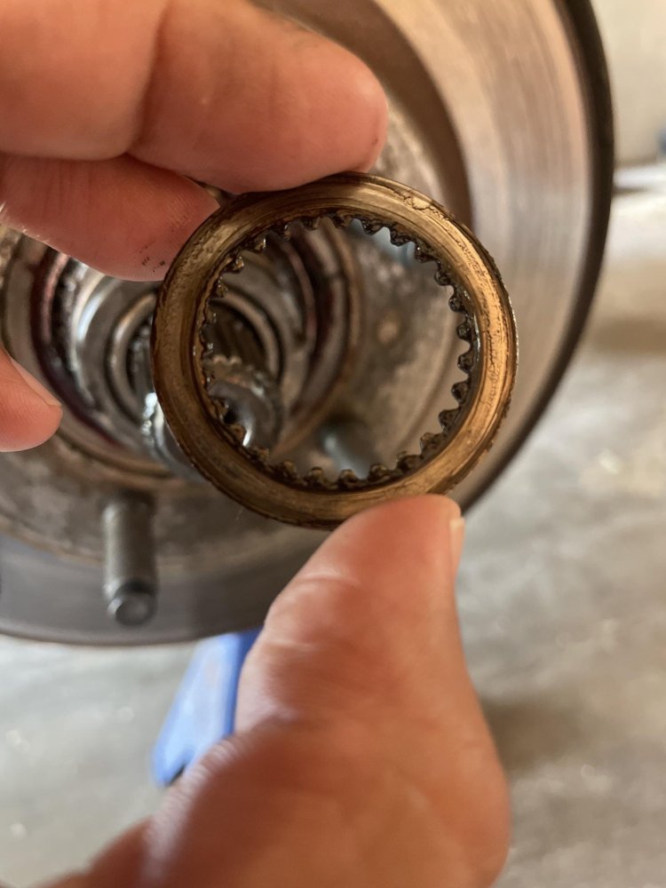

Hopefully @Curious Hound or @85_Ranger4x4 can help you out. I seem to remember there being a discussion about that washer being hard to find.
X510-9
I got mine from the JY. Probably only came in the hardware kit, I don't think Warn is making stuff for the TTB D35 any more.
They spin with the axleshaft and hold the shaft from coming out of the knuckle assembly. They wear against the end of the spindle and there is no real way to lubricate them. There may be thin shims between that thrust washer and the c clip to keep things snug.
IMO it looks pretty normal. They have a sucky job with no lubrication.
I know @Shran has commented on them in the past too.
Junkyard. Or maybe Ford.
grease them and the axle shaft c-clip or it’ll wear quickly with the hub locked.

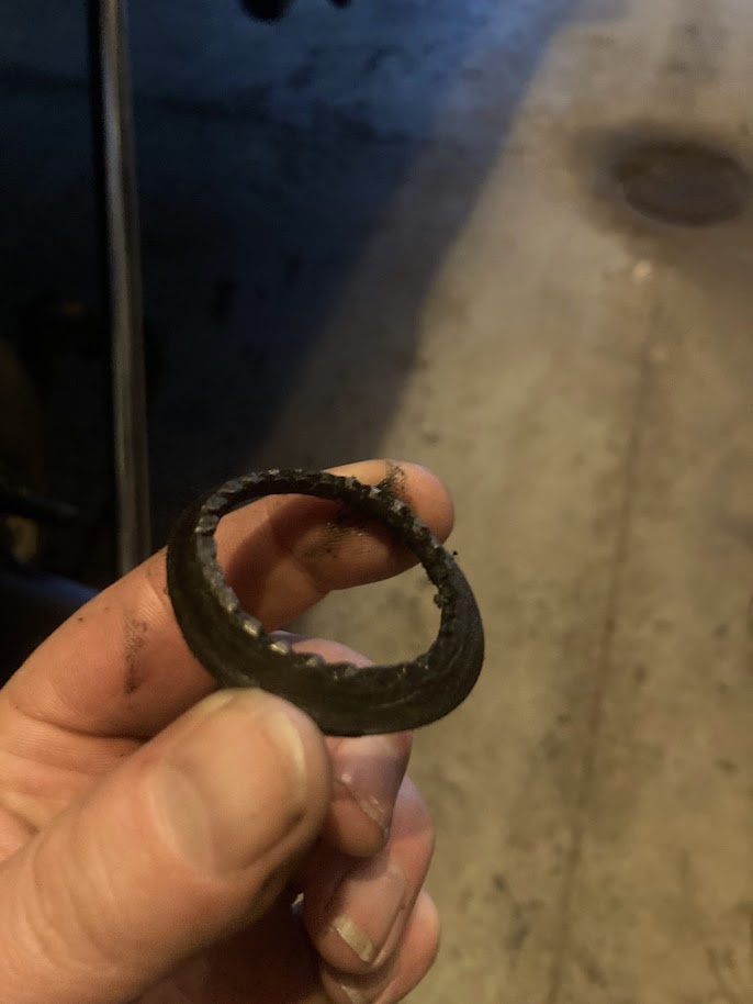

Hey thanks everyone, especially @Curious Hound. Found the parts on Bronco Graveyard as "D35 Spicer OE Axle Spindle Thrust Washer" and "D35 OE Spicer Outer Axle Snap Ring". Oh and those photos are of the good one. Here's what the bad side looks like
