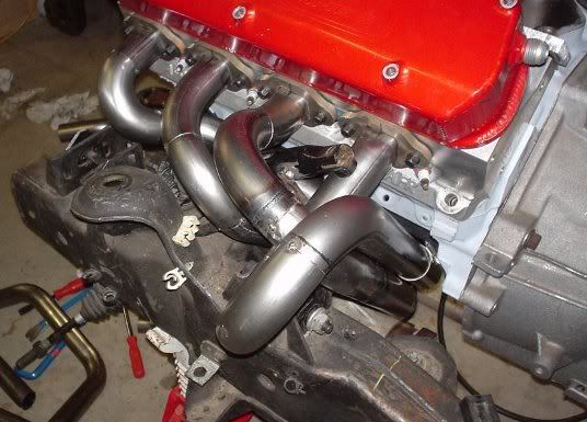

My headers should be done ceramic coating on Friday, but here is some motivation in the meantime...

I got mine kit from Tubular Automotive out of New Jersey. 1 3/4 inch primaries and 3 inch collectors. I did fenderwell because the lower control arm mount was in the way. Truck's been cleaned up since these pictures
picture.php
picture.php
picture.php

Delayed as usual,but started last weekend.
