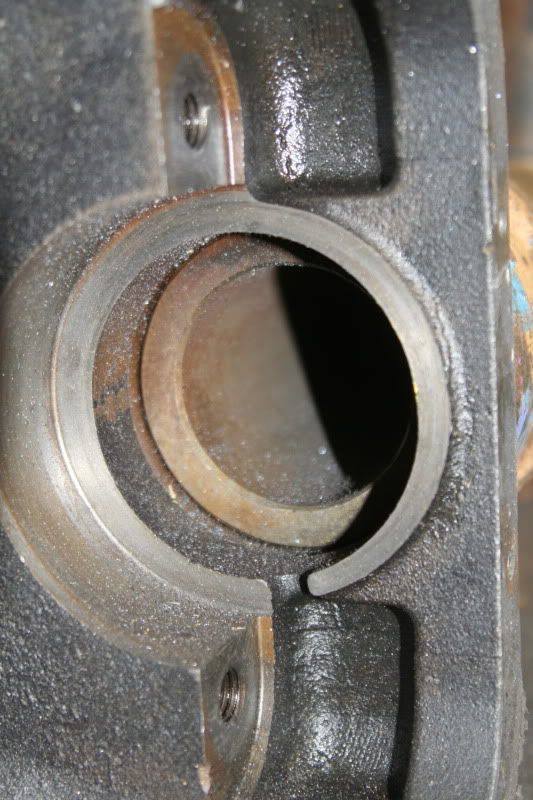

I got the housing stripped, steam cleaned and cut up. I cut 3" off the long side and 1/2" off the short side (trimmed the axle splines down to get 1/2" more on each side)

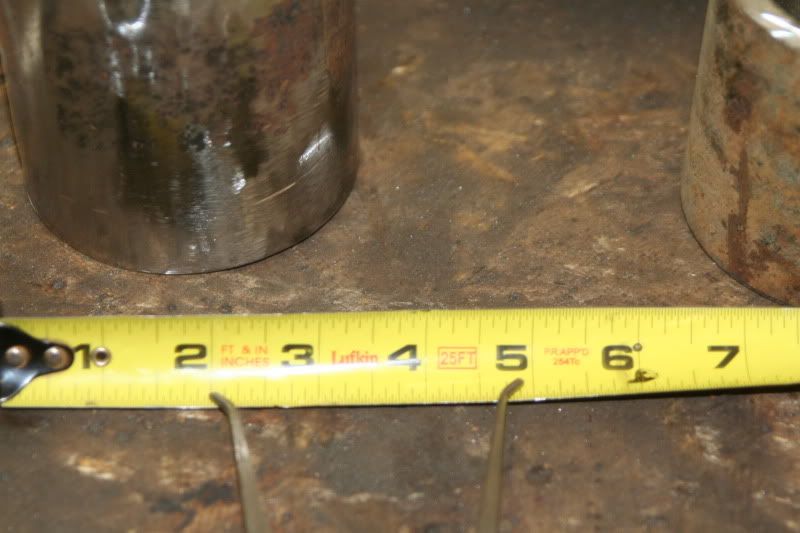

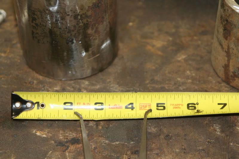

Something interesting about the Sterling...the inside of the axle tubes tapers as they leave the center section. The measure 1/2" thick 3.5" diameter where they are pressed into the center section

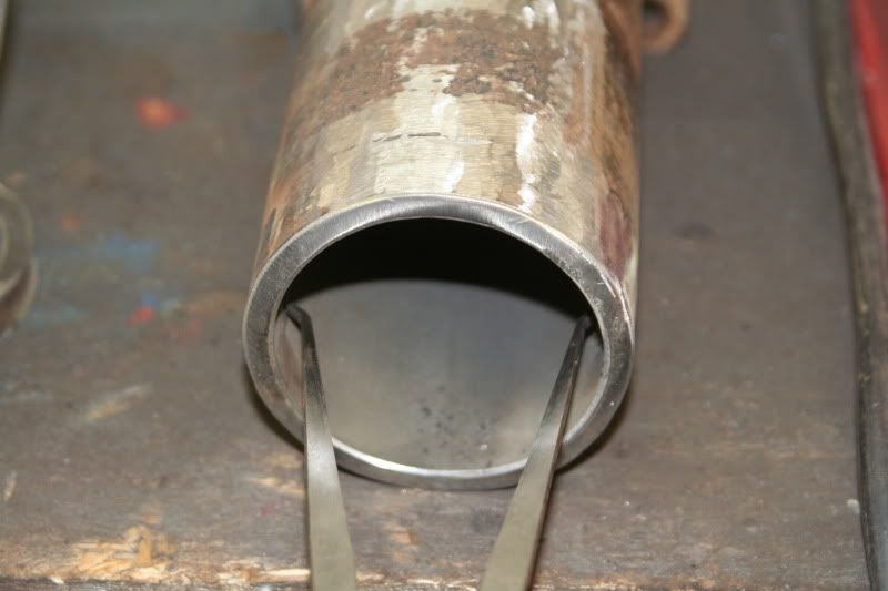

And where I made my cuts the tubes are just a hair over 1/4" thick!
Kinda odd to me...
I'm going to be machining a sleeve to fit inside of the tubes that will get plug welded to the tubes and then the but welds will get buzzed up.

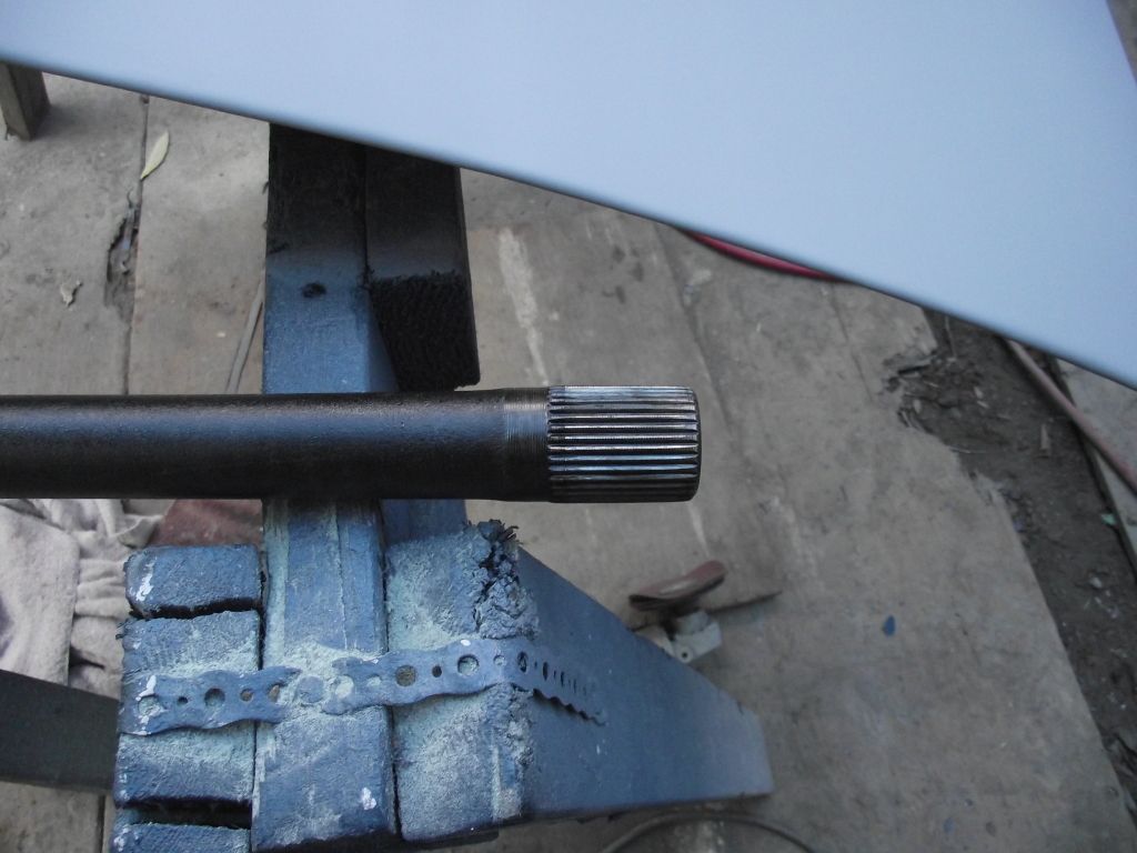

ryan,i've got one concern with your rear axle...i've measured several shafts to see how much free spline there is left to slide the axle in further.
you can see the dark bit of the spline on this one is all that wasn't engaged,and those i've measured have from 1/4-3/8'' available.
the base diameter of the shaft behind the splines is larger than the root diameter,so the shaft won't slide in further.what will happen if nothing else is done is that when the shaft is bolted into the hub it will have from 1/8-1/4'' of compression...not a good thing.
check these measurements carefully,especially if you'll be looking at an aftermarket carrier like a detroit or some such thing.don't want a massive failure on the trail from a load on the side gears.
