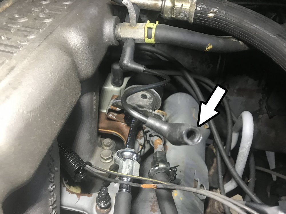

I have an 88 Ranger with the 2.9L engine. I have this mysterious vacuum line that does not have a home. Any advice on what I am missing where this connects? See photos.

Thats supposed to be plugged into the port on the back of your fuel pressure regulator.
I thought I recognized that truck from Youtube. Welcome aboard.
Rusty is right about that vacuum line.. That should fix your idle/surge issues you described on Youtube.
