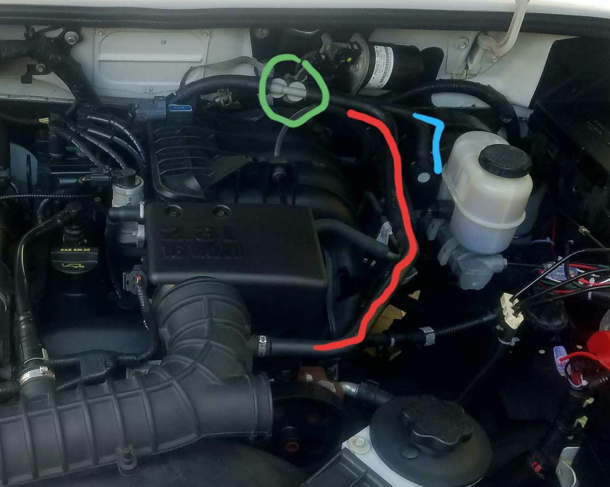

Also there's a line from the brake booster I cannot figure out the purpose of.
The red line comes from the air intake hose (non vacuum) but T's into the line from the manifold (under vacuum) that goes to the brake booster (blue line) WTF is the point of the red line. How can there be a non vacuum line connected to a vacuum line?

A Ported vacuum hose hooked to a regular vacuum hose?
WTF indeed
That is an odd setup, AND on a brake booster hose to boot, putting a "T" on the brake booster hose was always a "no-no" in my book, also PCV valve hose.
Plenty of other vacuum hoses to tap
Whats the vacuum diagram on the rad support show?
No vacuum diagram under the hood. They don't seem to put that crap on newer vehicles. :rolleyes:

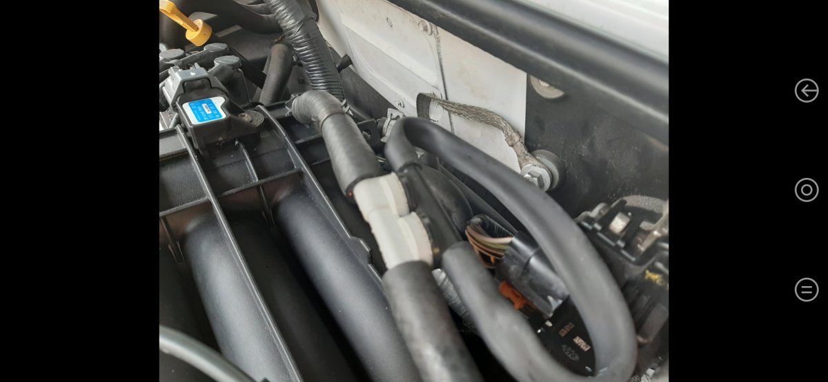

Here is the fitting/check valve or whatever it is that splits intake vacuum and air intake tube.
The loop of hose on the black half is just what I used to plug it off because if you leave the black ports open its a massive vacuum leak. (You can see the hose is collapsed from vacuum pressure). The grey section goes straight through to the booster.
The second pic is the nipple where the line would normally connect to the black part of the strange fitting. (also plugged for now).
This is what it looks like when its hooked up the way it was before I took it apart...
Yes, then that's a check valve
Maybe the vacuum drop in intake was too low during acceleration or cruising at high altitudes so they added Ported Vacuum to keep brake booster "topped up"
Ported vacuum is only high when regular vacuum is lower
But that check valve may be leaking, or reversed, there should be no vacuum on the "black ports" with engine at idle, check valves should be closed
If Ported Vacuum exceeded regular vacuum then check valve would be pulled open and Ported Vacuum would add to Booster vacuum

Figured out the stupid check valve. I had the ported line from the air intake tube and the intake vacuum line reversed so the check valve was working backwards causing a leak. :rolleyes:
And from what I can tell by fiddling with how the check valve opens and closes in 3 directions it must be to keep the vacuum pressure balanced between idle (high vacuum) and heavy load (no vacuum) by switching between the two ports. There is NO mention of this thing in my factory ford workshop manual... NOTHING. I did notice running direct to the manifold without the check valve in place the pedal would kinda drift from firm to soft based on engine load, with the valve connected properly its always consistent. Maybe the duratec has a weird vacuum pattern that requires this mess?:dunno:
