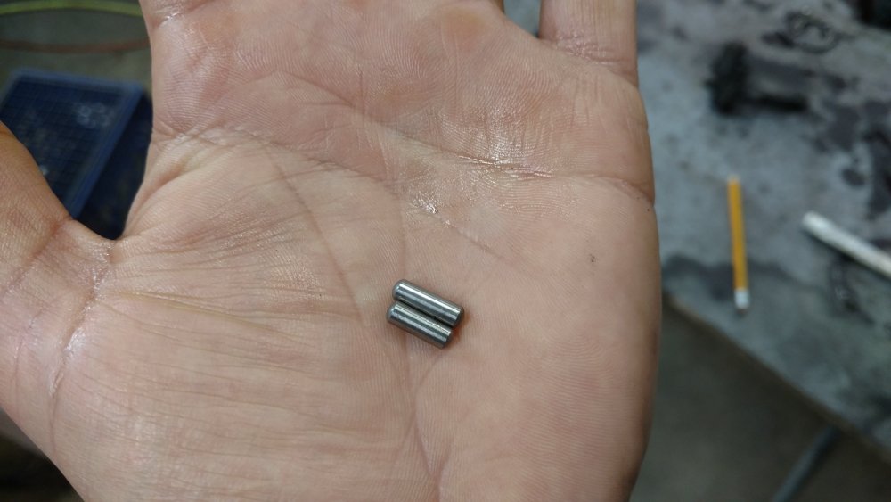

Finally got my under carriage pressure washed, truck put on the rack and transmission pulled out. When I opened up the trans I discovered the synchro collar for reverse and 5th gear was rounded off and should be a easy fix but what has me worried is the two small pins I found laying on the work bench after I rolled it over. They are .156 in diameter. One is just over 1/2" long and the other just under 1/2". The exploded view doesn't show any needle bearing rollers this size. What are they ?

Those look like shifter lockout pins or detent pins. Did you remove any parts off the shifter cover?
I did remove the button sensor on the drivers side of the cover that has the long pin under it. Unless those were stacked up behind it.
They look like detent pins, possibly from the 5/R assembly.
The center shift rods use short fat pins and the 5th/rev use a ball and spring. Ends are slightly rounded on the mystery pins so that rules out roller bearing.

Update. Transmission back in with just replacing a gear slip ring and broken synchro dog springs. Trans works great so far and mysterious extra parts are still setting on my work bench.
