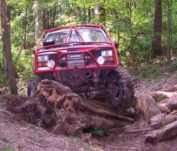

my stock explorer...

just a few mods...

nice rig dude love the cage and....also the 8 lug bolt pattern...:headbang:
yup...all stock...
200ft of 1 1/2 tube .120 was in stock...for cage and front bumper (bbpfab.com)
16ft of 1 1/2 .250 tube for front links...was in stock..
8ft of 1 1/2 .375 tube for front steering/tierod flip and trackbar..was in stock..
box tubing for tranny crossmember and rad arm links was in my STOCK scrap pile..
2x4x.120 rect tubing for sliders/rear bumper/hitch..in stock..
Stubbler from 4xfab.com #01 was built using stock ranger planetarys and a CHUNK of stock aluminum...
89 ford f250 STOCK sterling axle
75 Ford HD250 STOCK d44
Onboard VIVAIR was IN stock at 4wheelparts cleveland
STOCK scuba tank was in scrap pile at my house and works as good stock onboard air tank..
Stock 15in 8lug rims from summit...
stock top removed..all glass except front windshield removed..
2 yards white canvas was in stock at the fabric store..
subframe was 15ft of stock 1/2in gasline that lowes STOCKS...
Stock airbox used in snorkel...
its all stock...:taunt:
