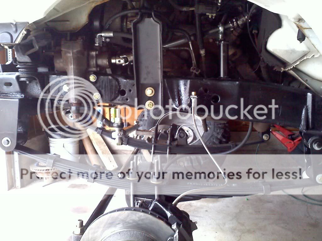

if you get a chance, the next time youre out snapping pics of your truck, could you hook me up with a pic to the backside of your driver side ubolt? trying to see how you went about notching the webbing. seen a few people just throw on a ubolt and it looks to be bending inward, not too fond of that idea
Thanks for the props on my sas. Great job on yours. How did you get around the vss in the rear axle? The 98-00 ranger has the vehicle speed sensor run through the abs tone ring in the 8.8. Without it your speedo wont work and your tranny might not shift.
I have not have had mine on the road yet. from what i have read, the trans should still
Shift. Hopefully by the end of next week i should have it going.

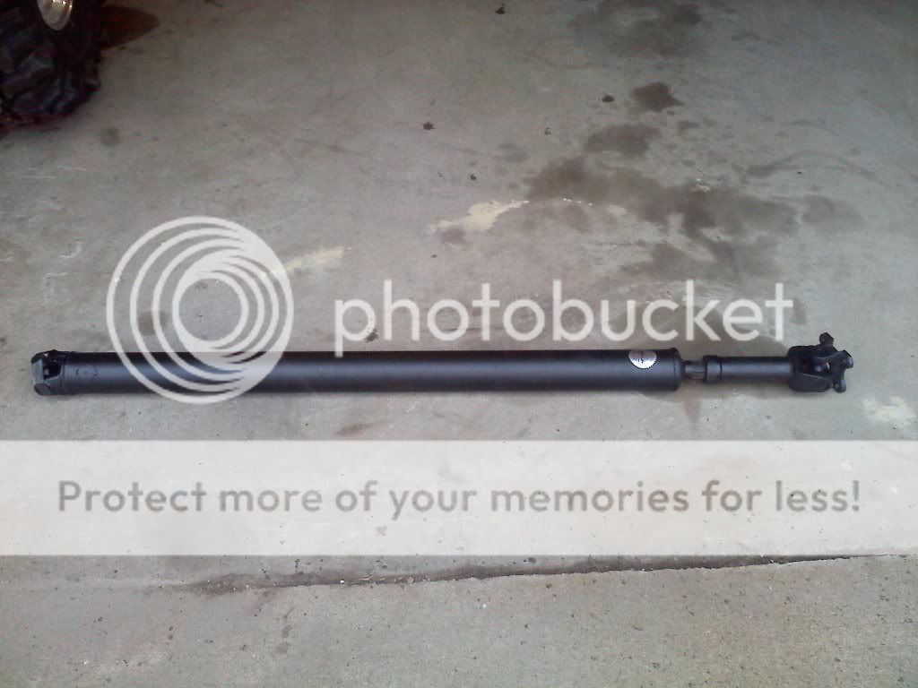

and picked up my rear drive shaft also on thursday

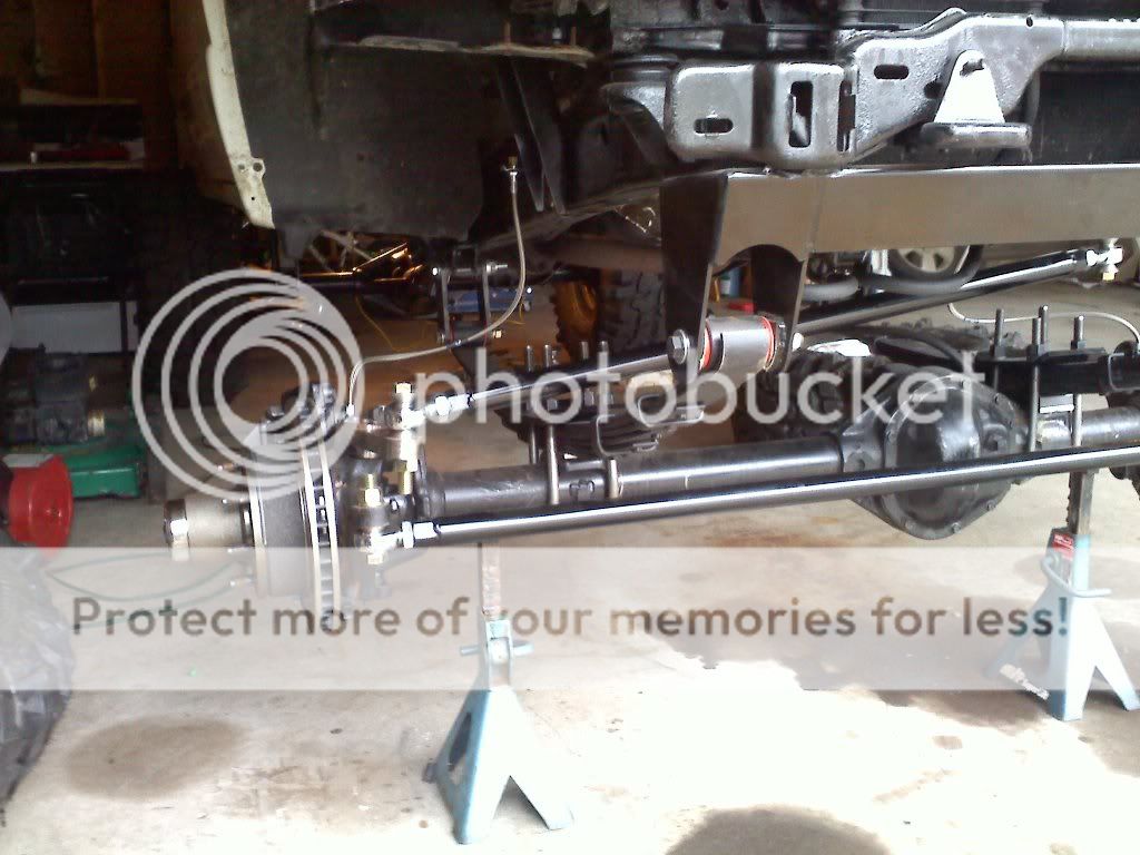

Got my upper shock mounts on and the brake lines mounted.

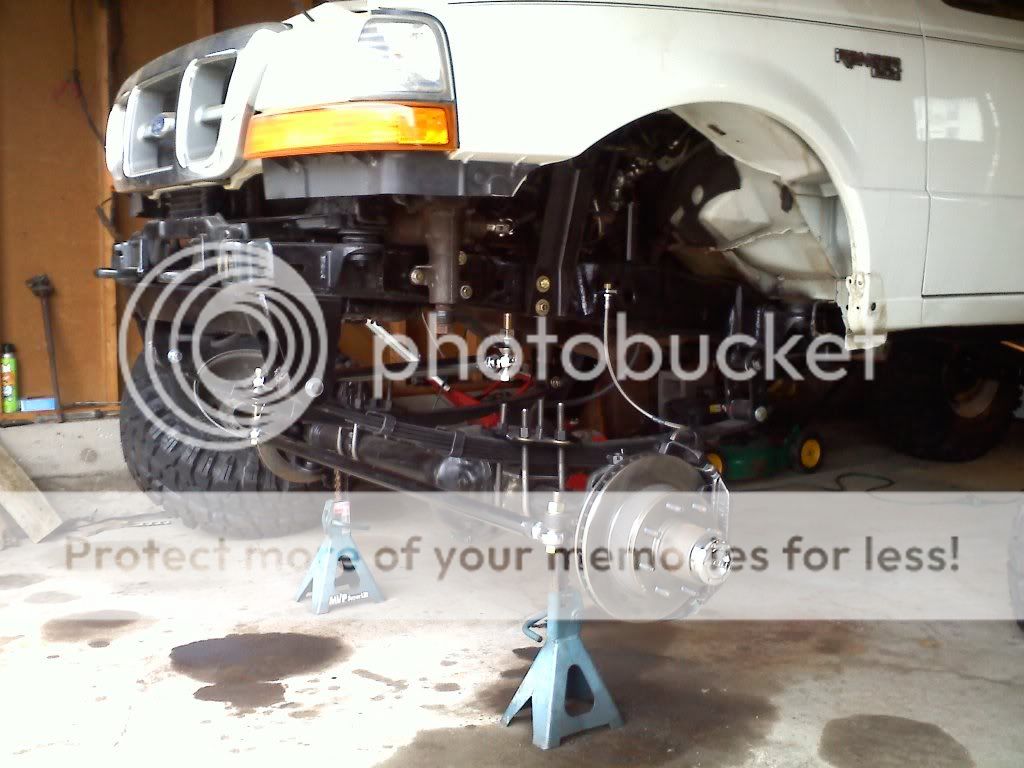

Got the rear on also
My SAS Ranger
Now just have the hard lines left to do and get shocks.

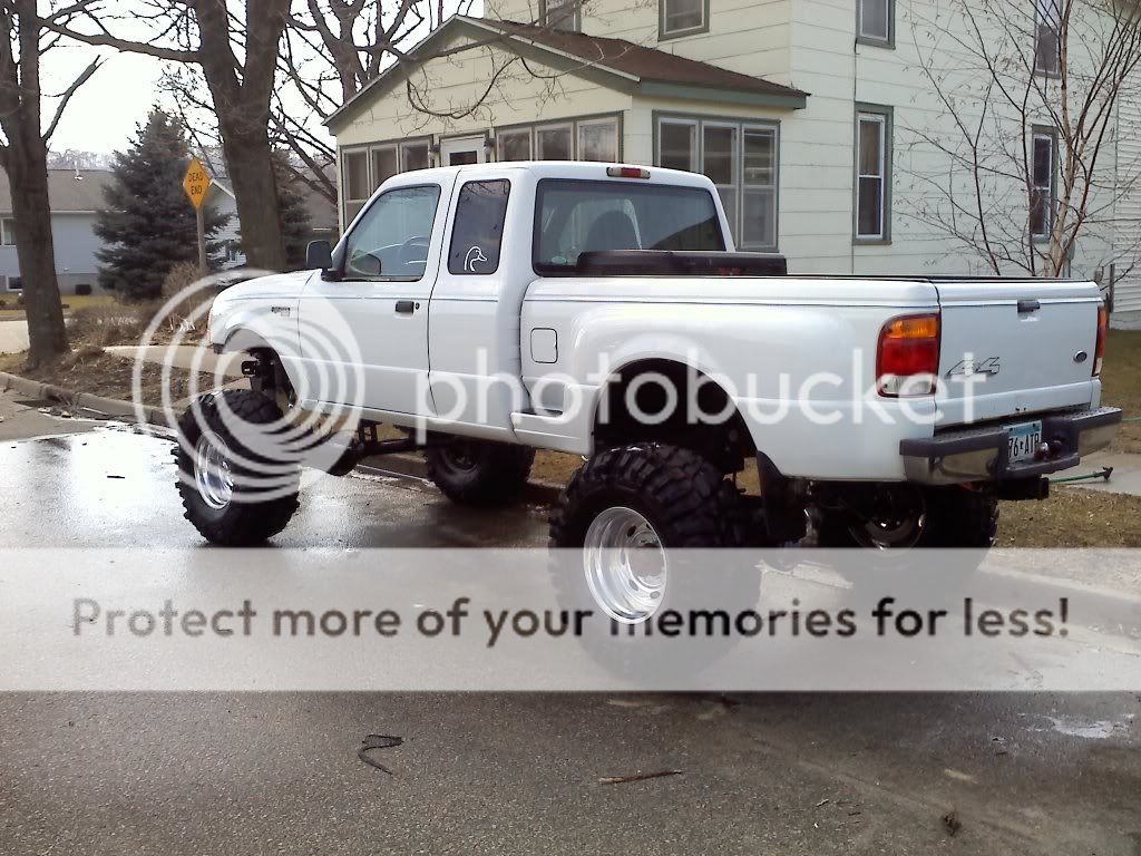

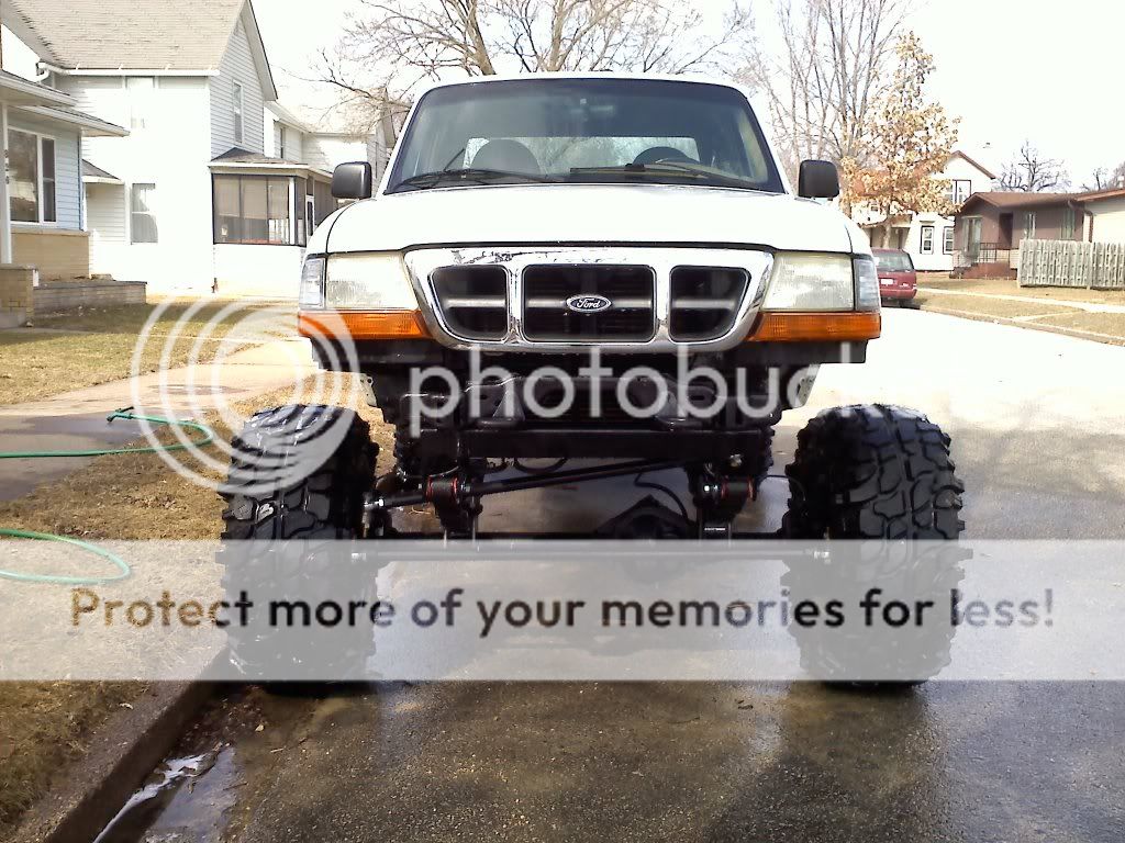

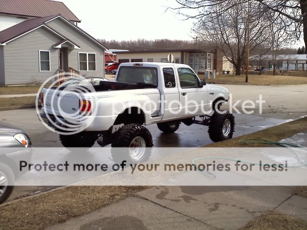

Got her out today, did a few shake down runs around the block to see how she felt.
also gave a bath after being couped up for nine months. Got shocks ordered and should be here next week.

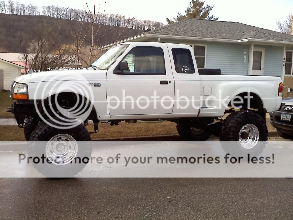

heres a few more
