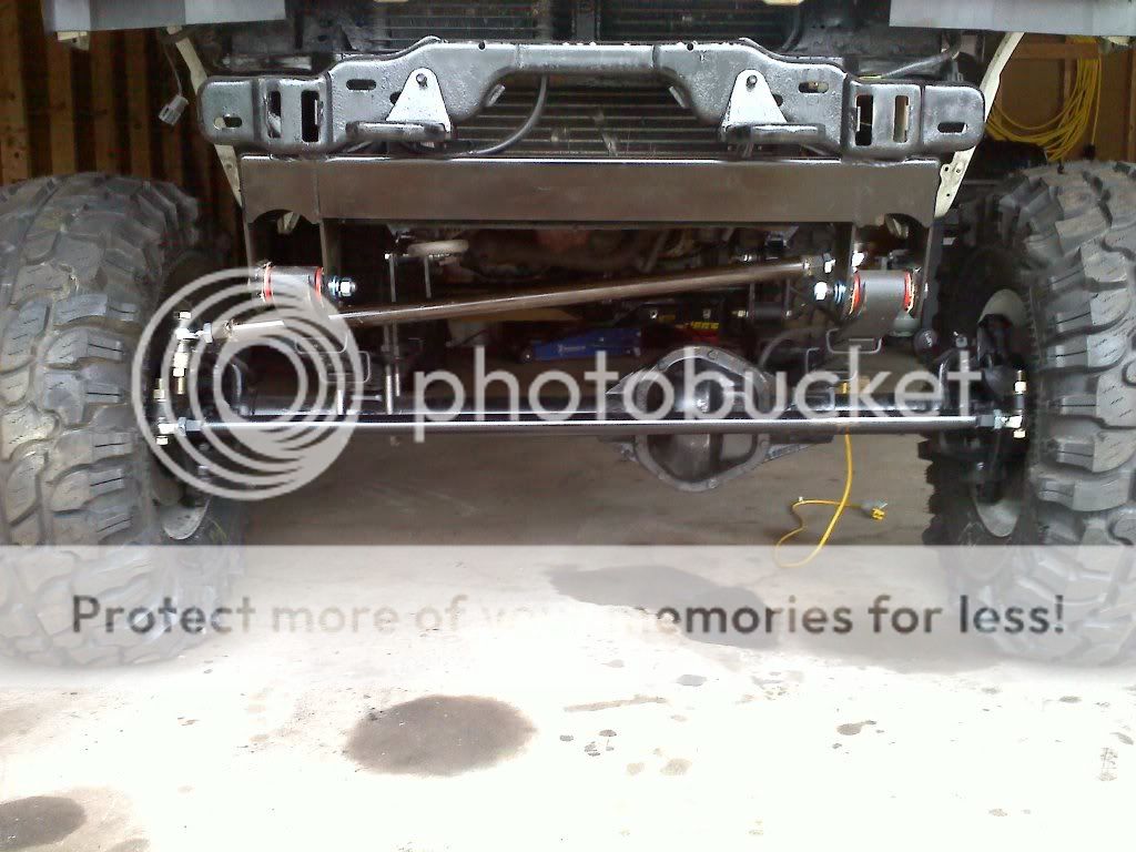

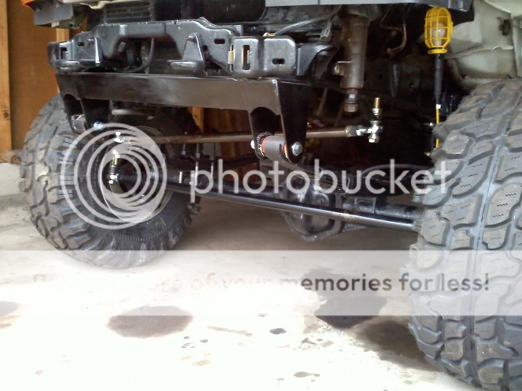

Since u have a 79 dana 44 u can have the pass. side knuckle drill and taped for a high steer arm. That what i have done. sent mine to sky manufacturing and used their highsteer arm. I also used ruffstuff 7/8 heim steering kit.
Not any more update, drill bits to dull to drill threw my plate for my steering box mount so i had to pick upsome more bits today.
So you went with heims even though everyone says it wears out extremely fast and gives very loose steering on the road? I think that's the route I'm leaning toward. It's hard finding someone in my town who can ream out my knuckles and pitman arm. At least I can drill it out on my own for heims. Throw up some pics when you get some progress done
Got the frame plated and sleeved . The box is mounted.
That looks great man. Amazing rig. My favorite one so far. Did you go with 3/4" bolts for the steering or something smaller. Wasn't sure if there is enough metal to hold a 3/4" bolt and still be strong
I've looked at these pictures at least 5 times in the past 10 min haha. Love the look of this truck
Thanks for the comments, I did go with 3/4"Bolt. Their seems to be plenty of material left to be strong enough.
