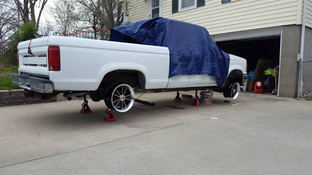

First order of business.....bought some Ford shop manuals, and removed the awful 20s and dry rotted tires, sold for $200

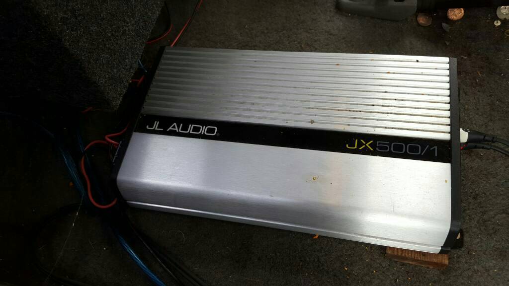

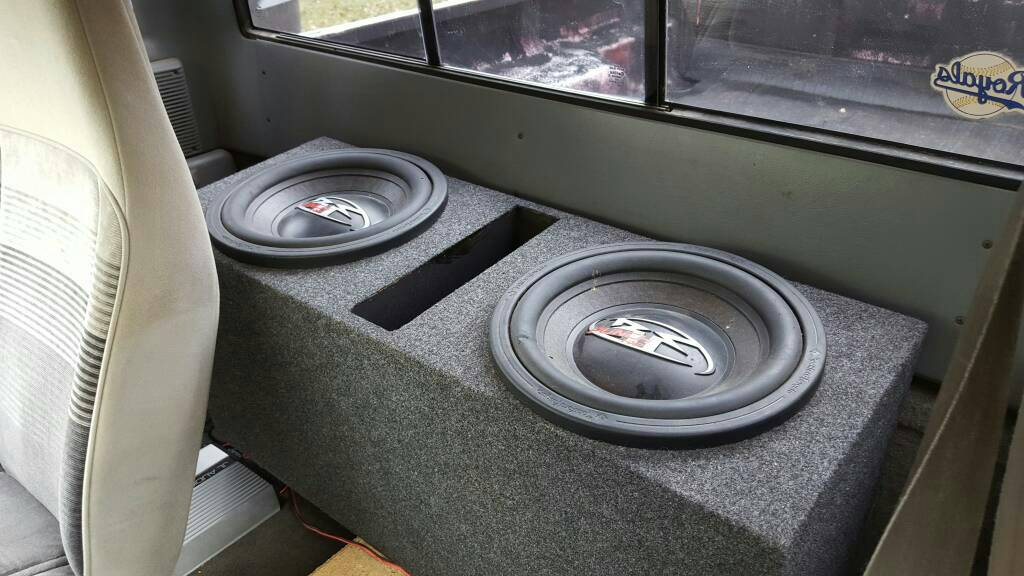

Also sold a nice JL Audio amp and 2 Rockford Fosgate 12" subs with box out of it.
Suited up

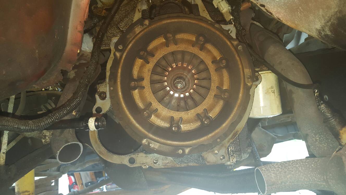

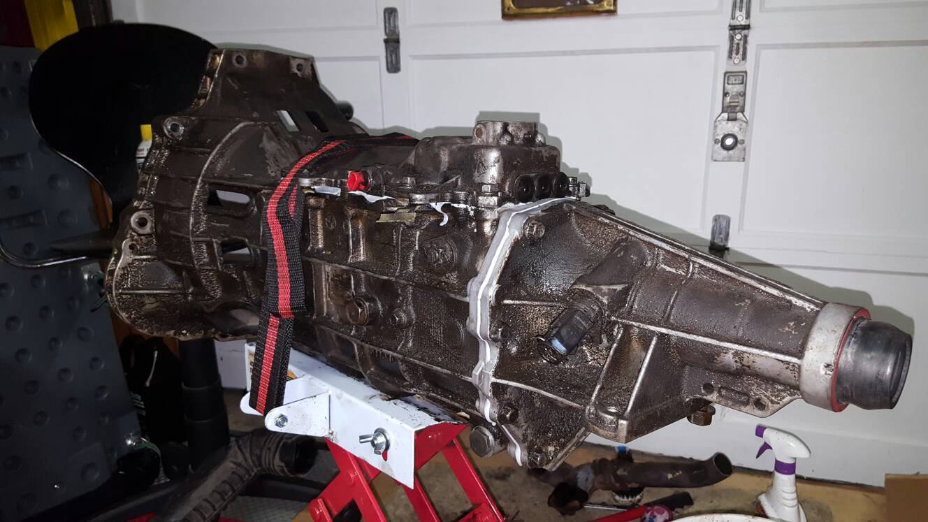

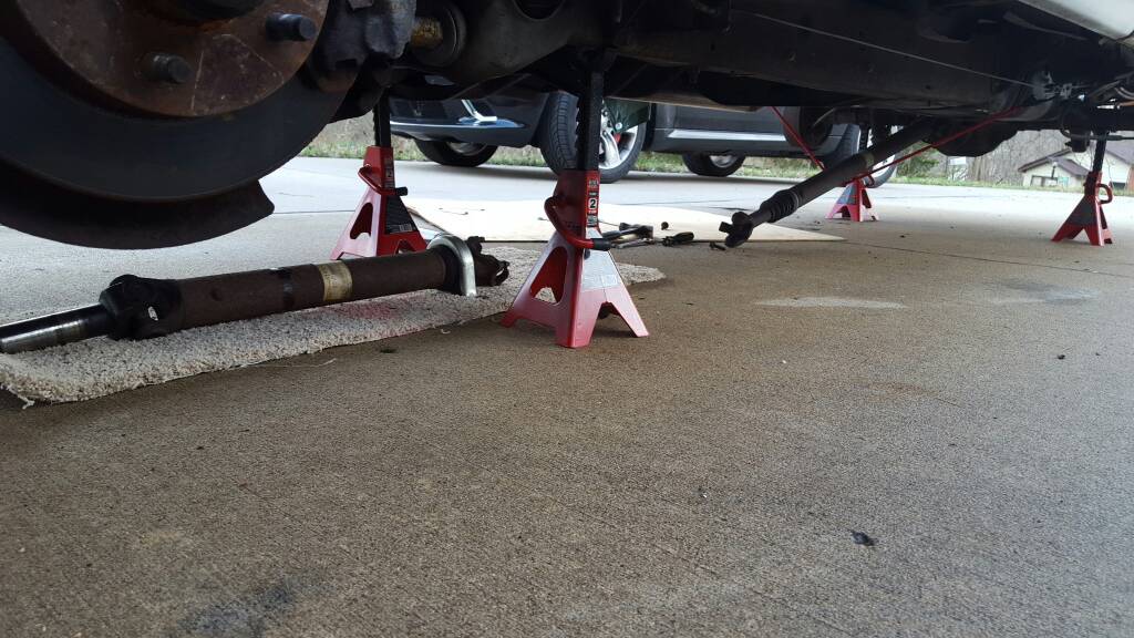

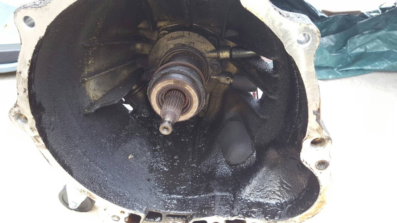

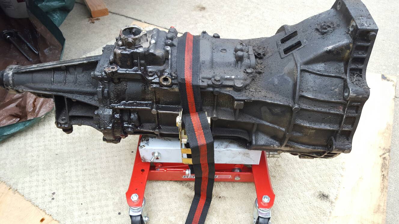

Pulled shifter and dropped trans

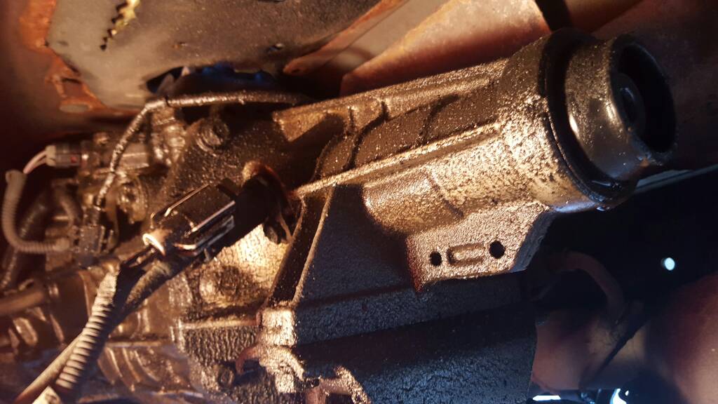

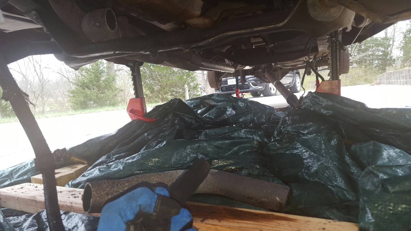

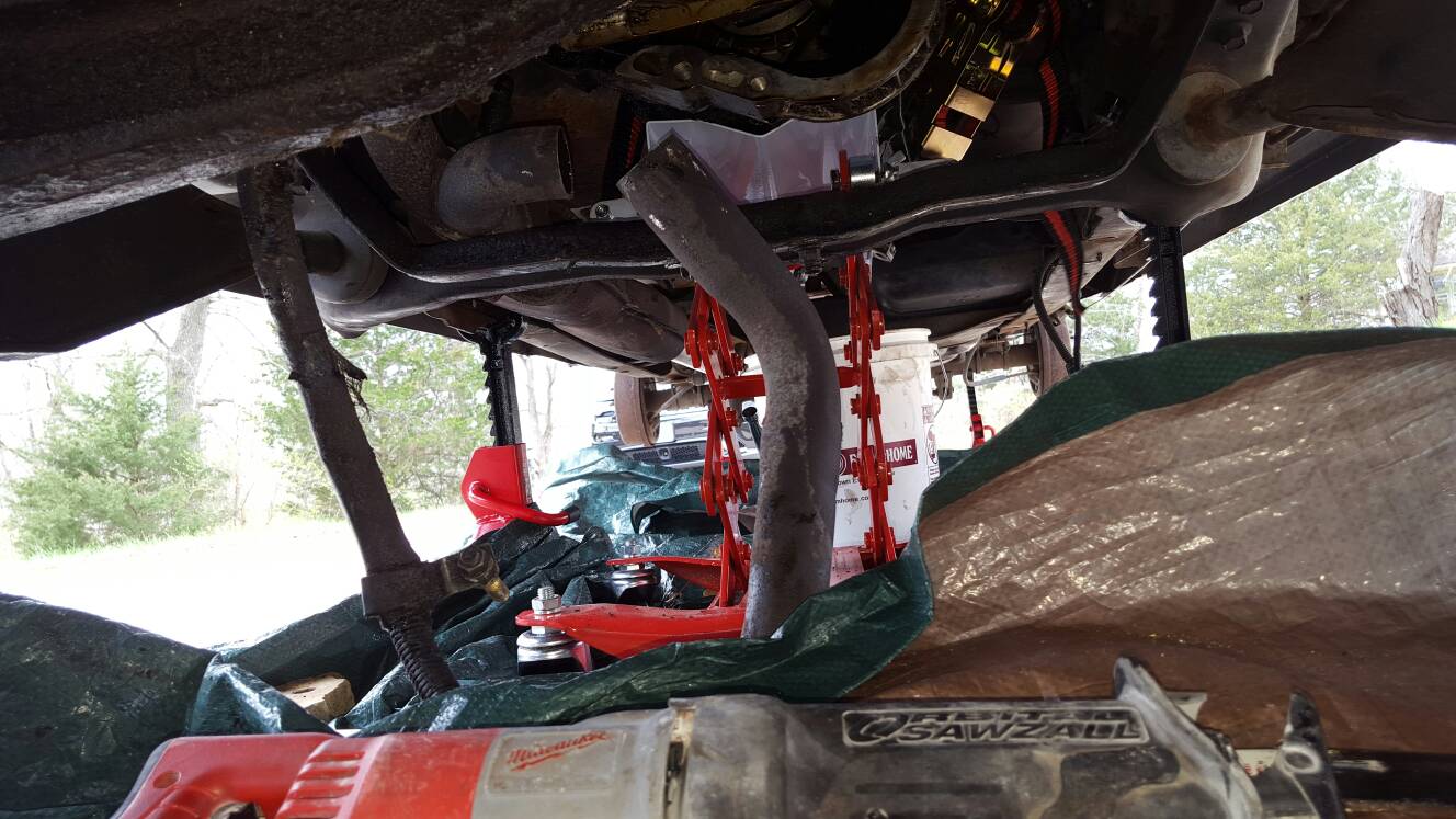

N. A. S. T. Y!

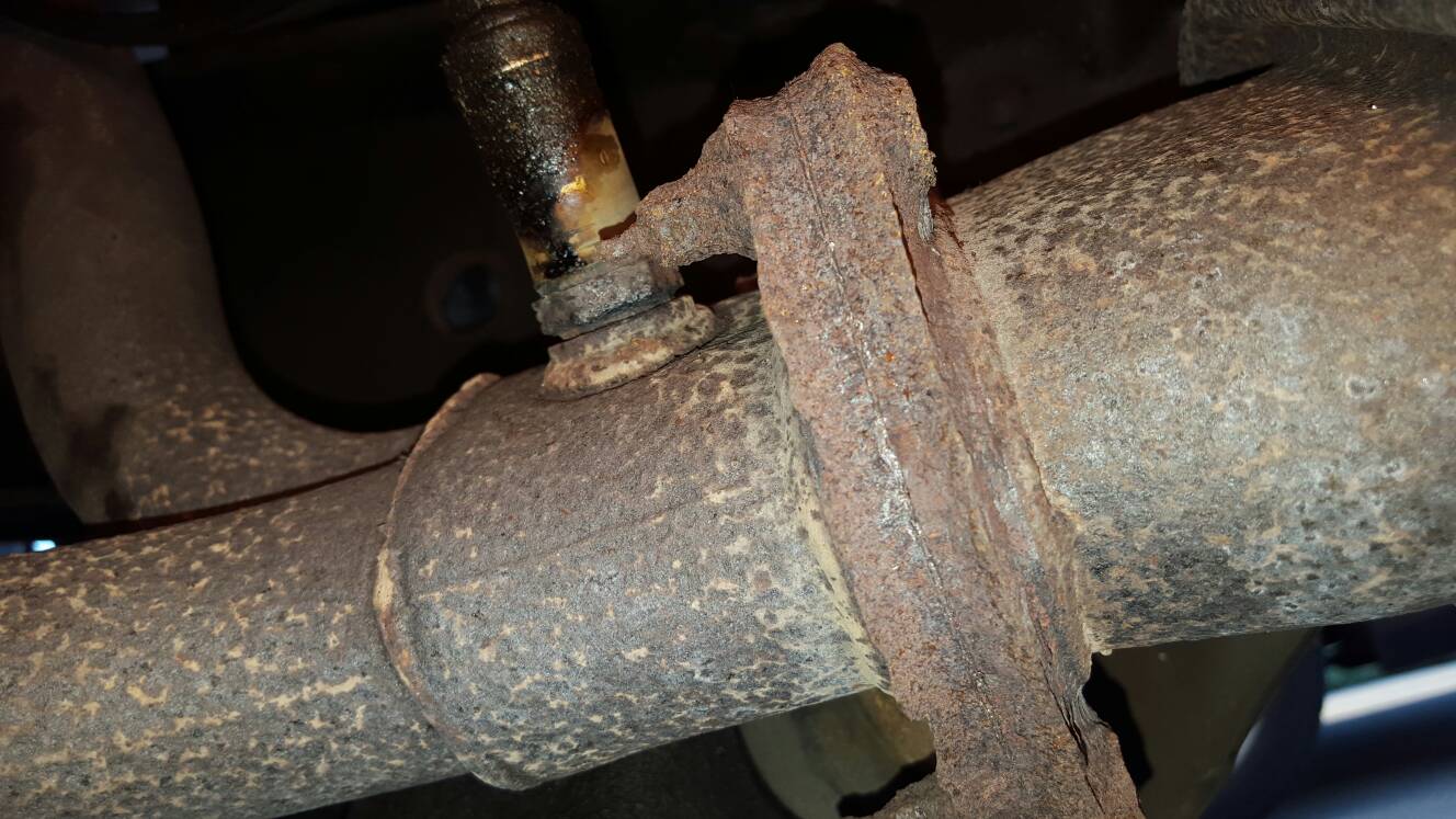

F this piece of exhaust in particular.

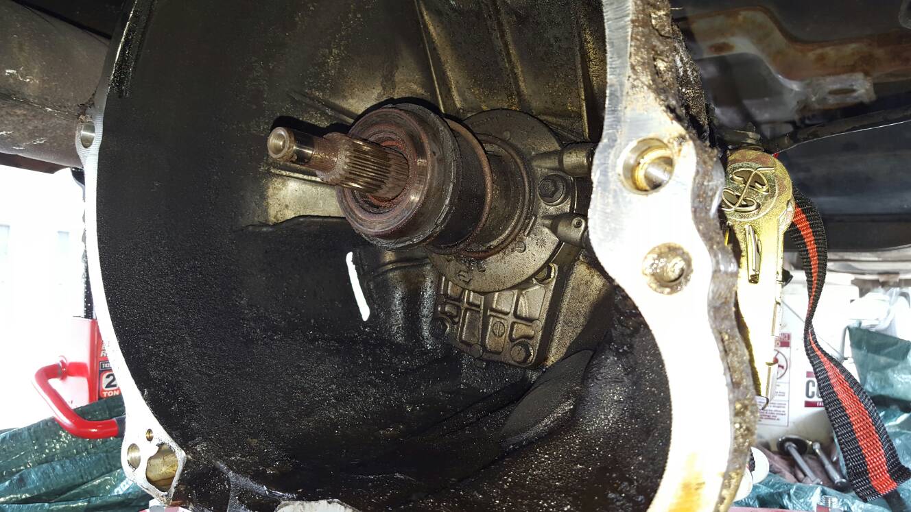

Drained it, found a decent shard.

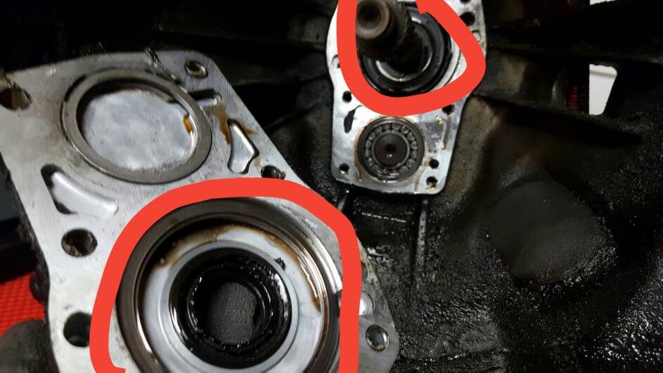

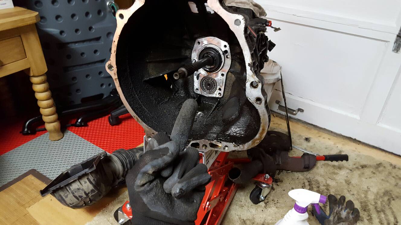

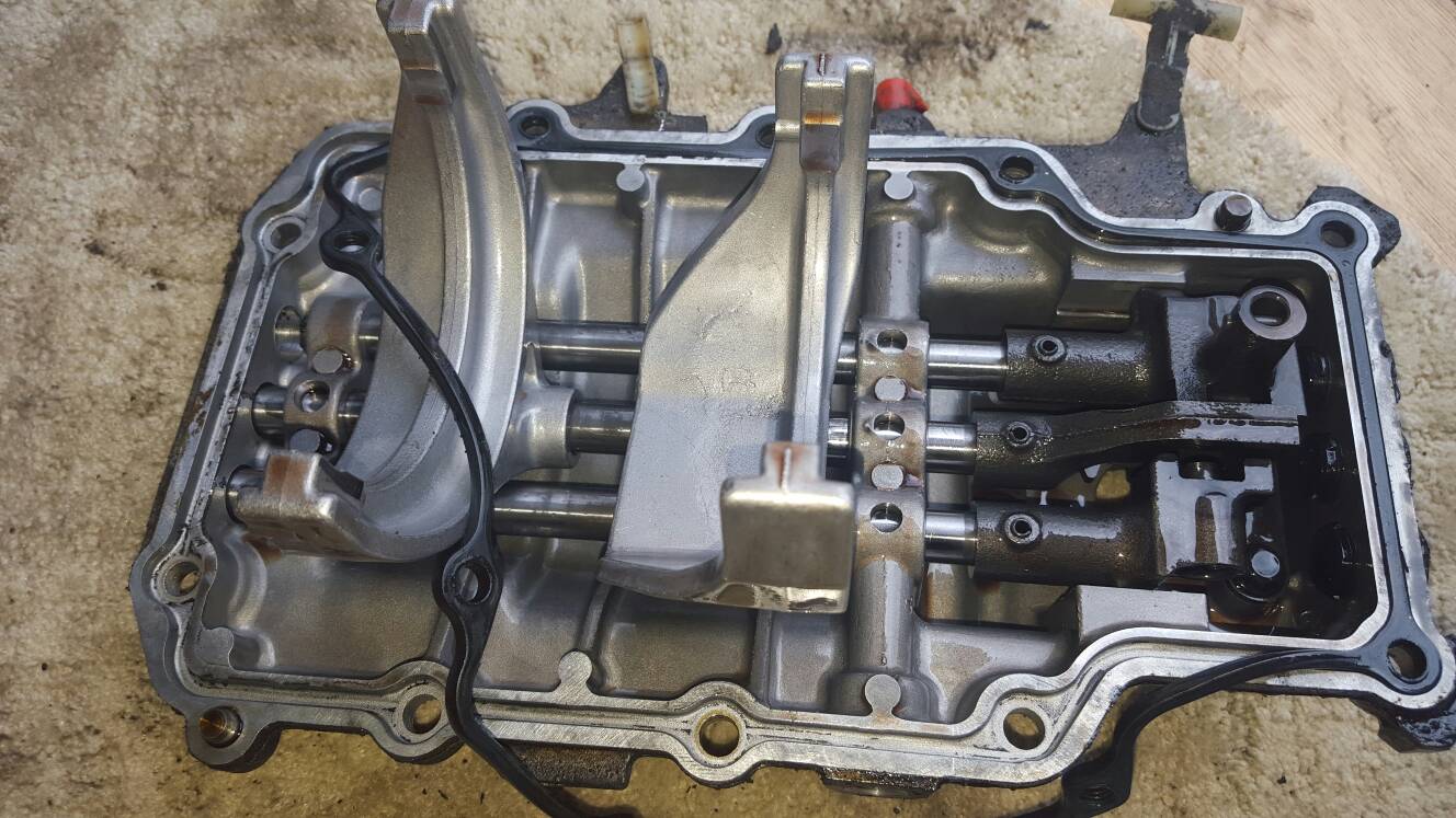

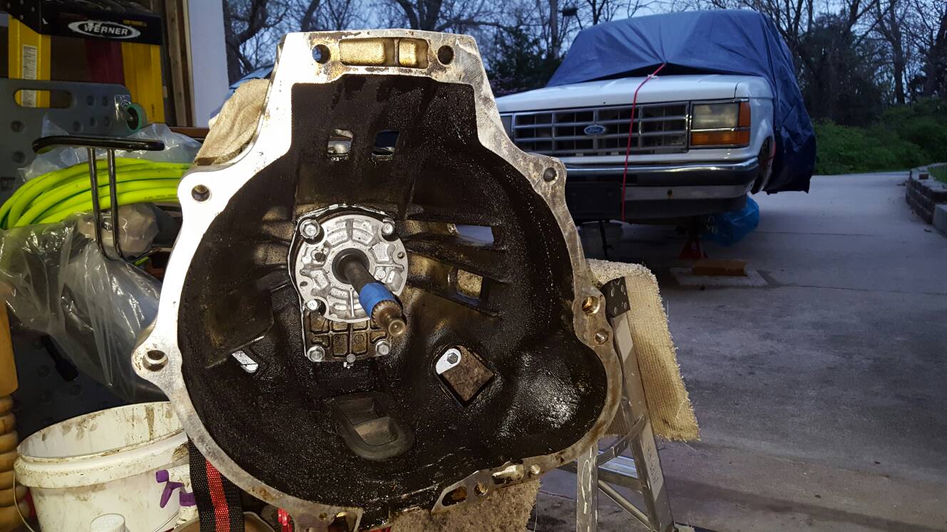

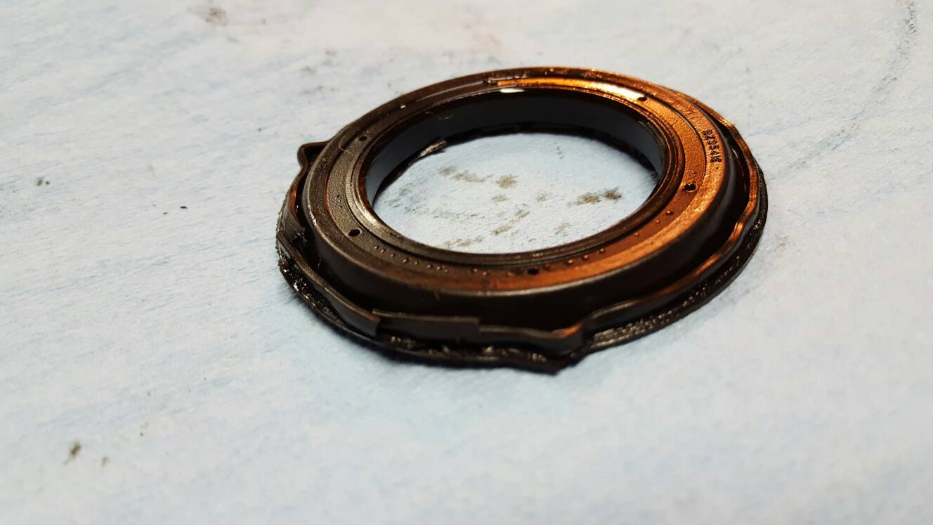

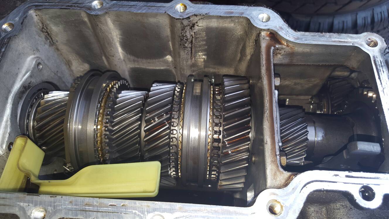

So I opened up the trans. Looks mint so I decided not to rebuild the M5OD.

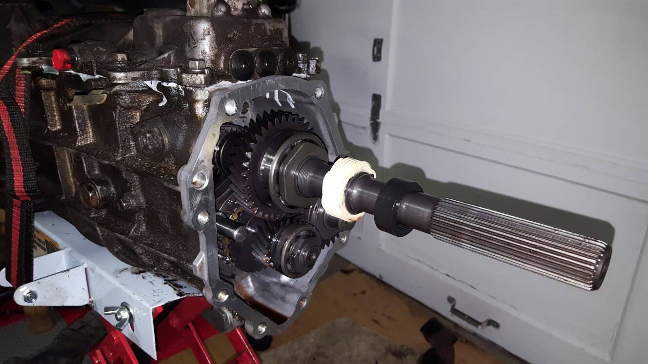

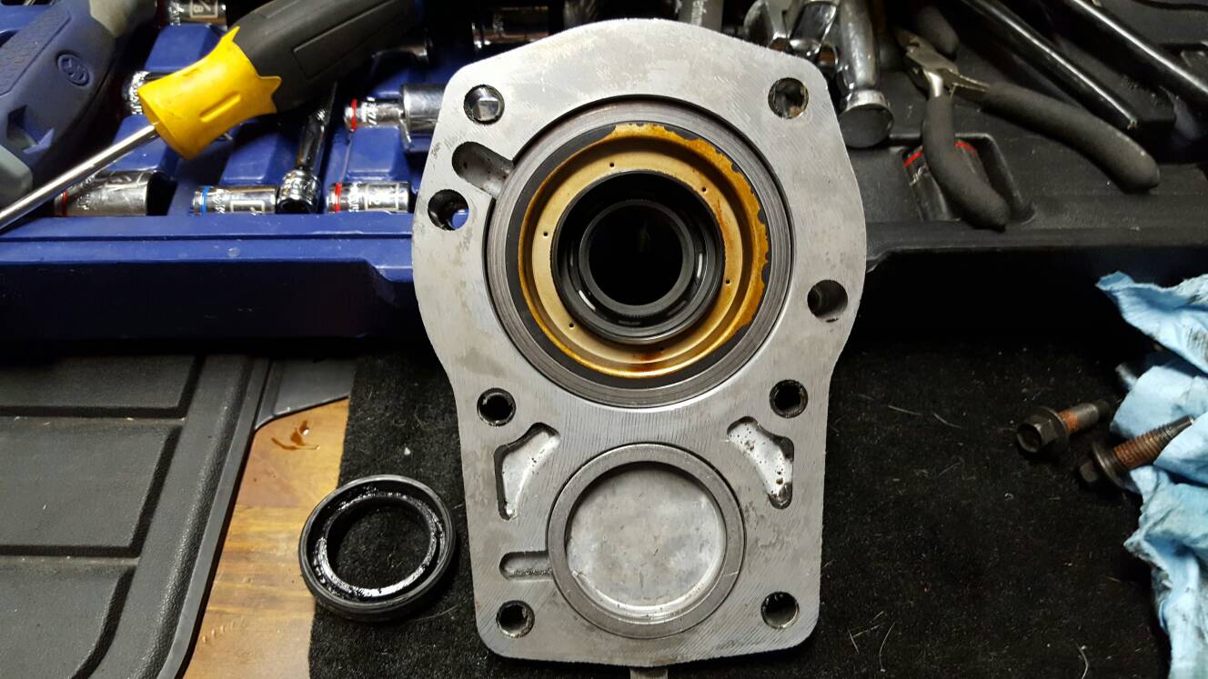

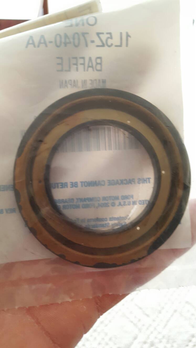

Bought new input and output shaft seals. There is an oil baffle behind the clutch slave cylinder that is back ordered til middle of May, luckily found one of only two in the whole state.
So happy!
While resealing the top and rear, I found the rest of the shard
Realized it was a shim from the shifter.
So that made me feel better about my decision to save $400 on trans rebuild kit. I believe it was damaged, and simply fell in when I removed the shifter

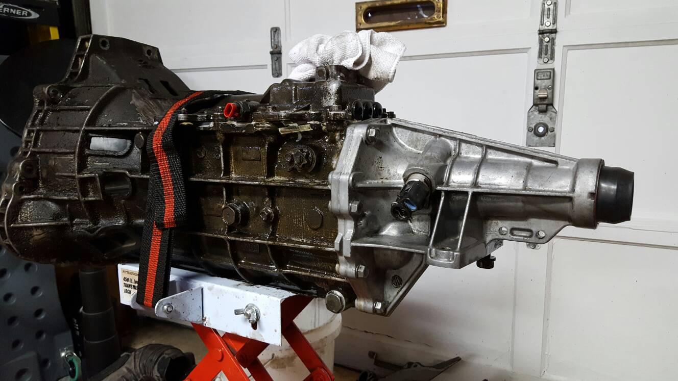

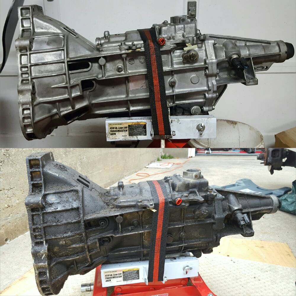

Cleaned it up and sealed it back up

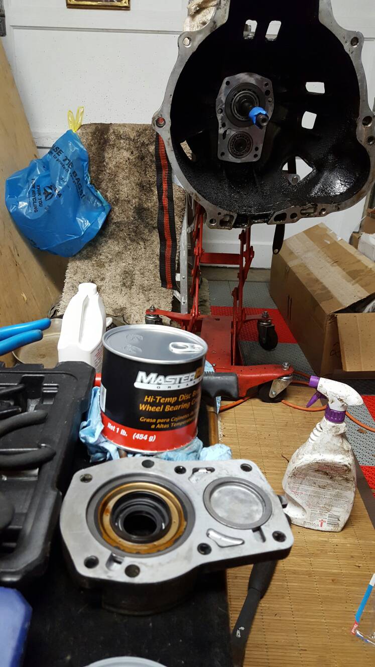

I just received the elusive unicorn baffle so I've yet to install it, input shaft seal, and new clutch slave cylinder and throw out bearing. I'll be ready to install once that's done.

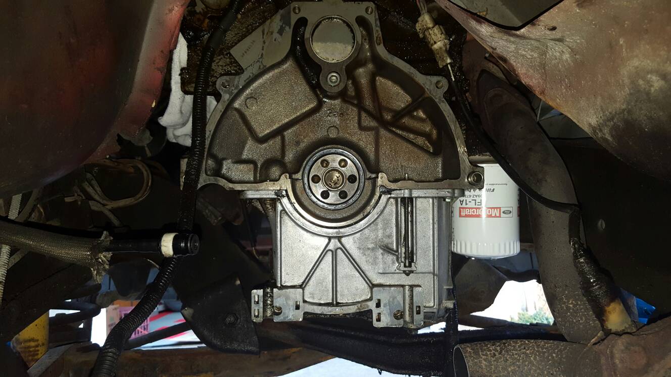

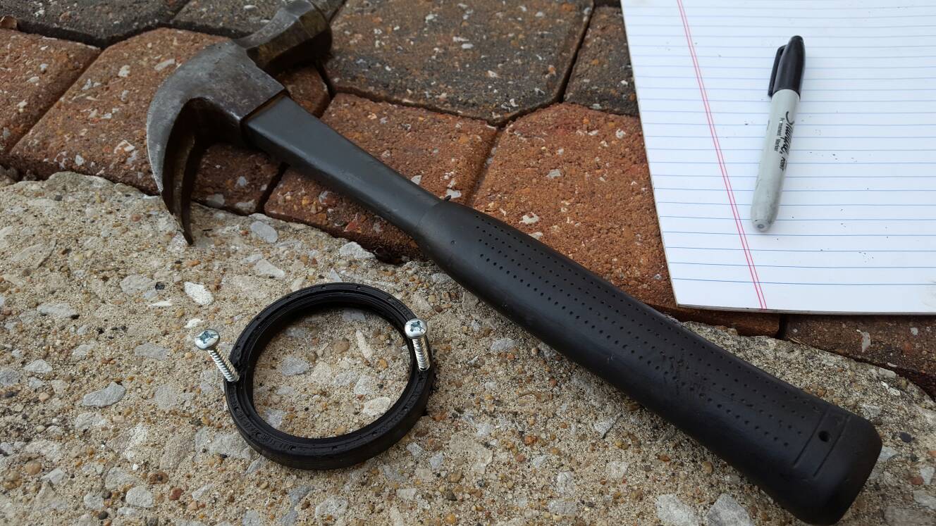

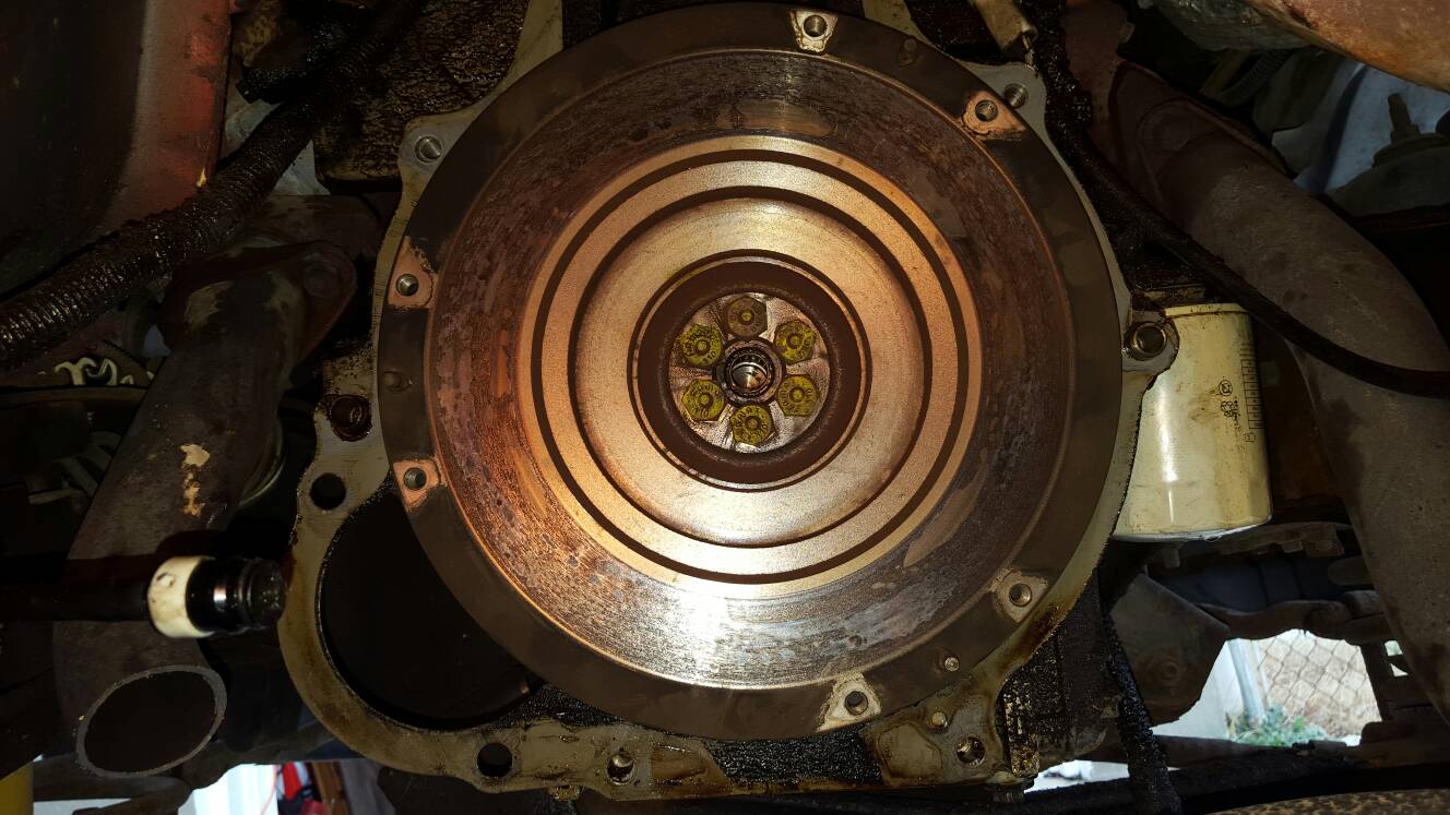

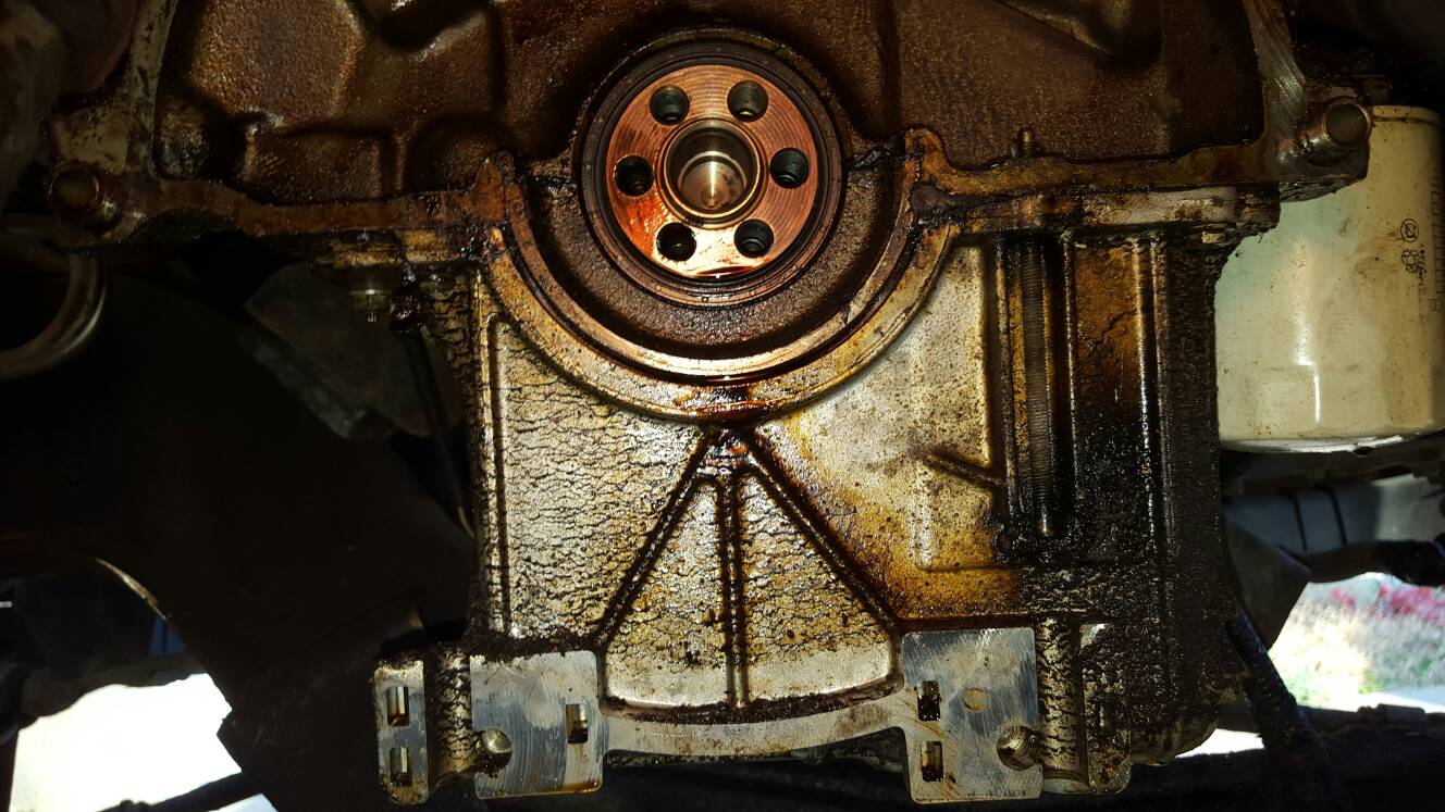

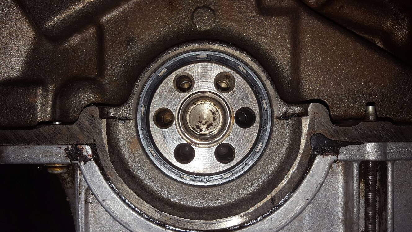

While trans was out, installed new rear main seal
Trust me I'm a professional....lol actually Ford shop manual said to remove it like this
Cleaned this up too

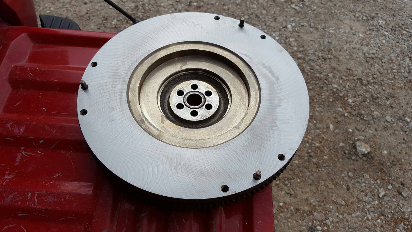

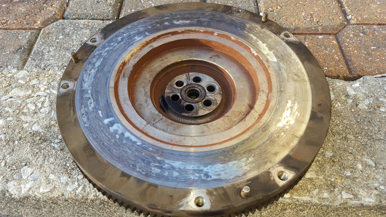

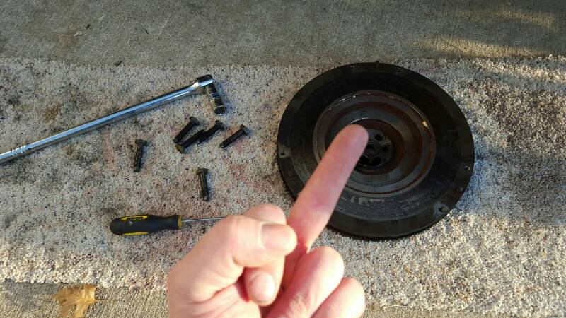

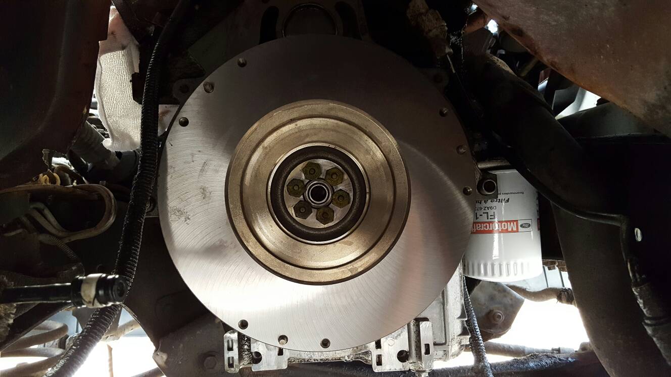

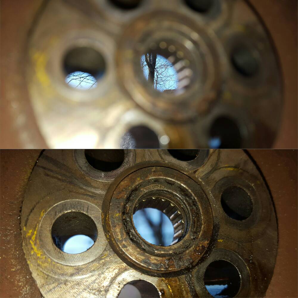

Had flywheel turned, and installed new pilot bearing
Artsy fartsy

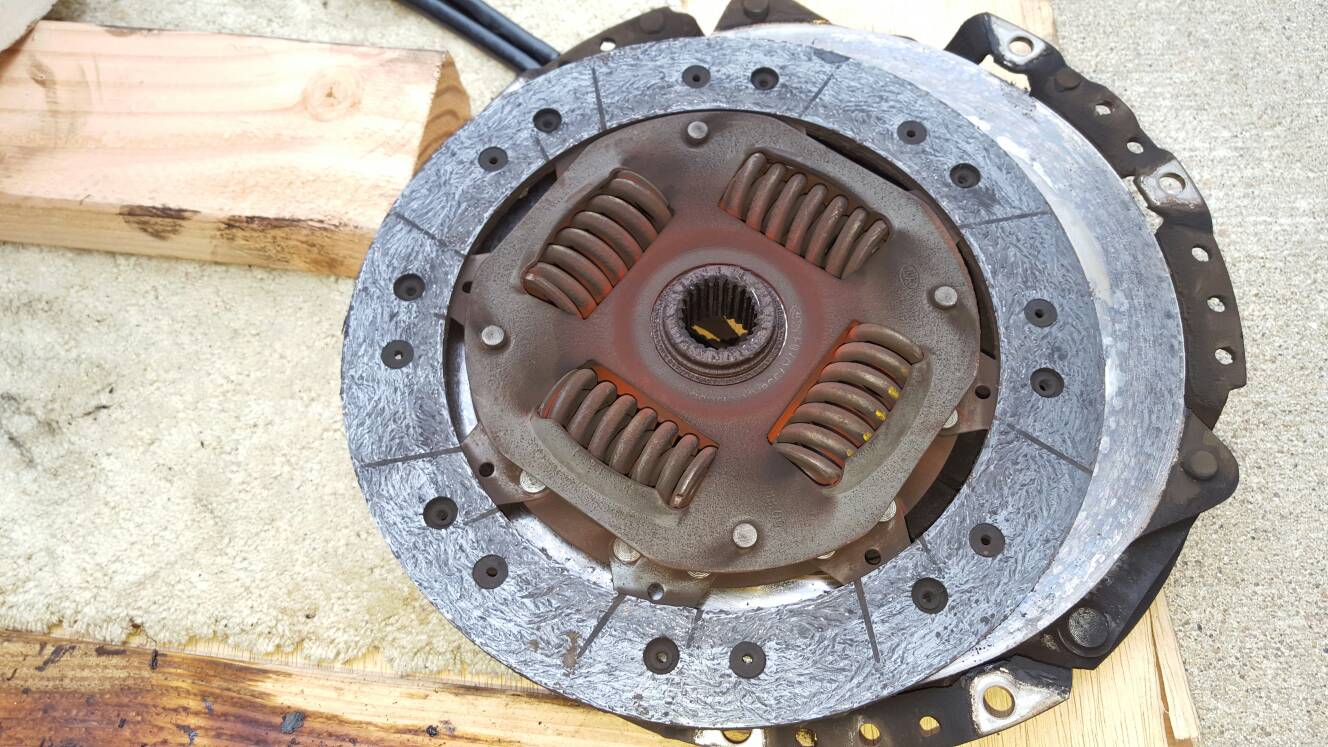

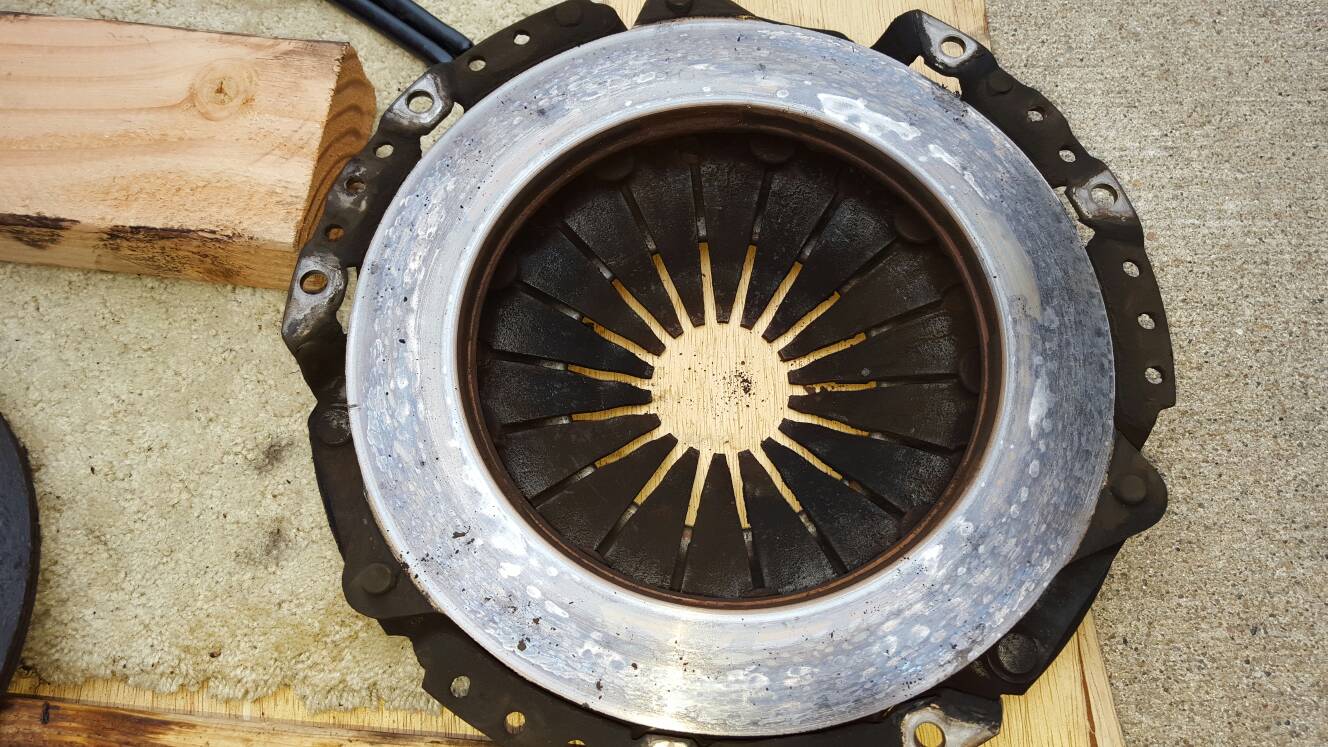

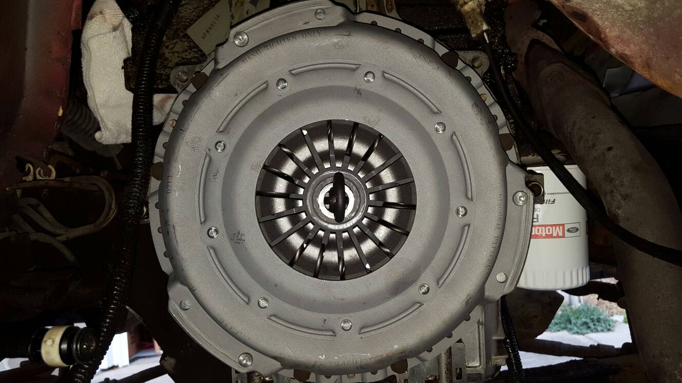

Installed new clutch

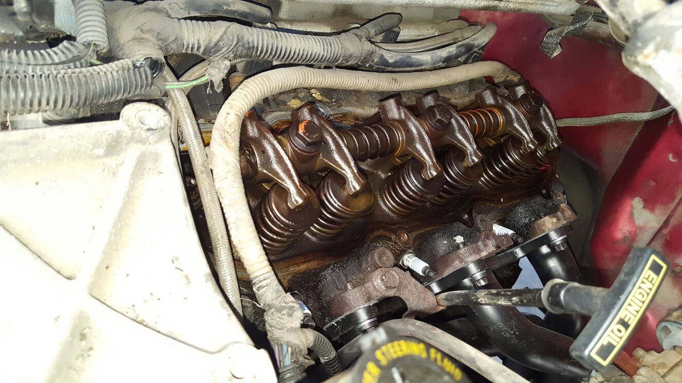

While I was waiting on trans baffle, I started under the hood.

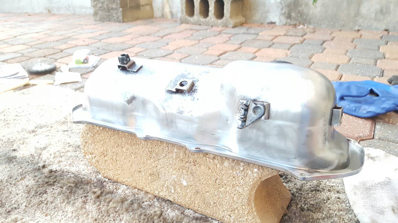

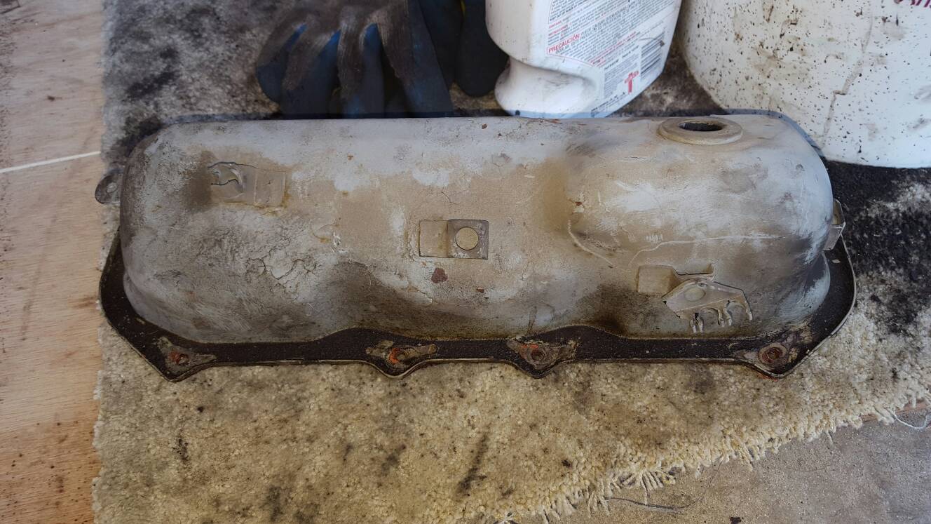

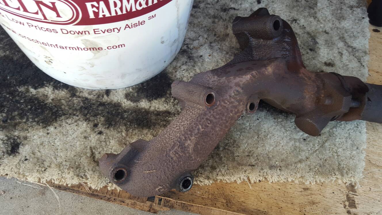

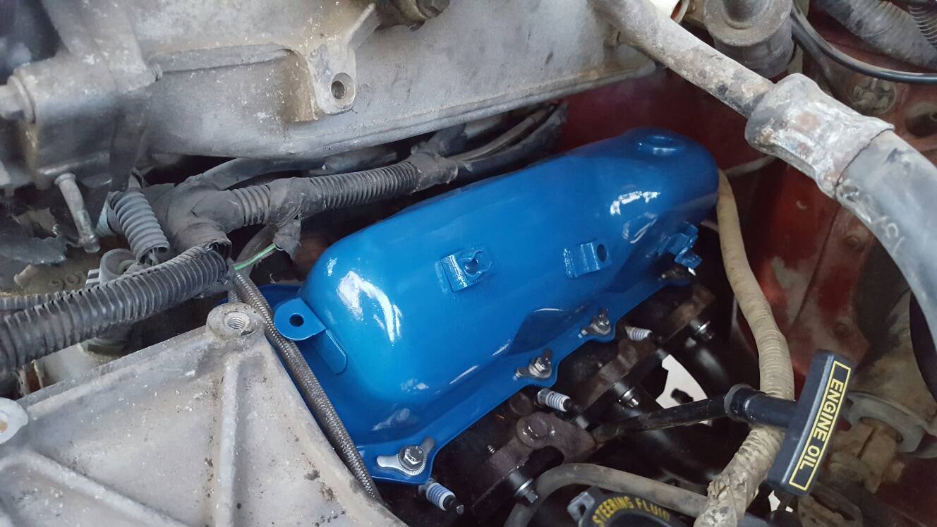

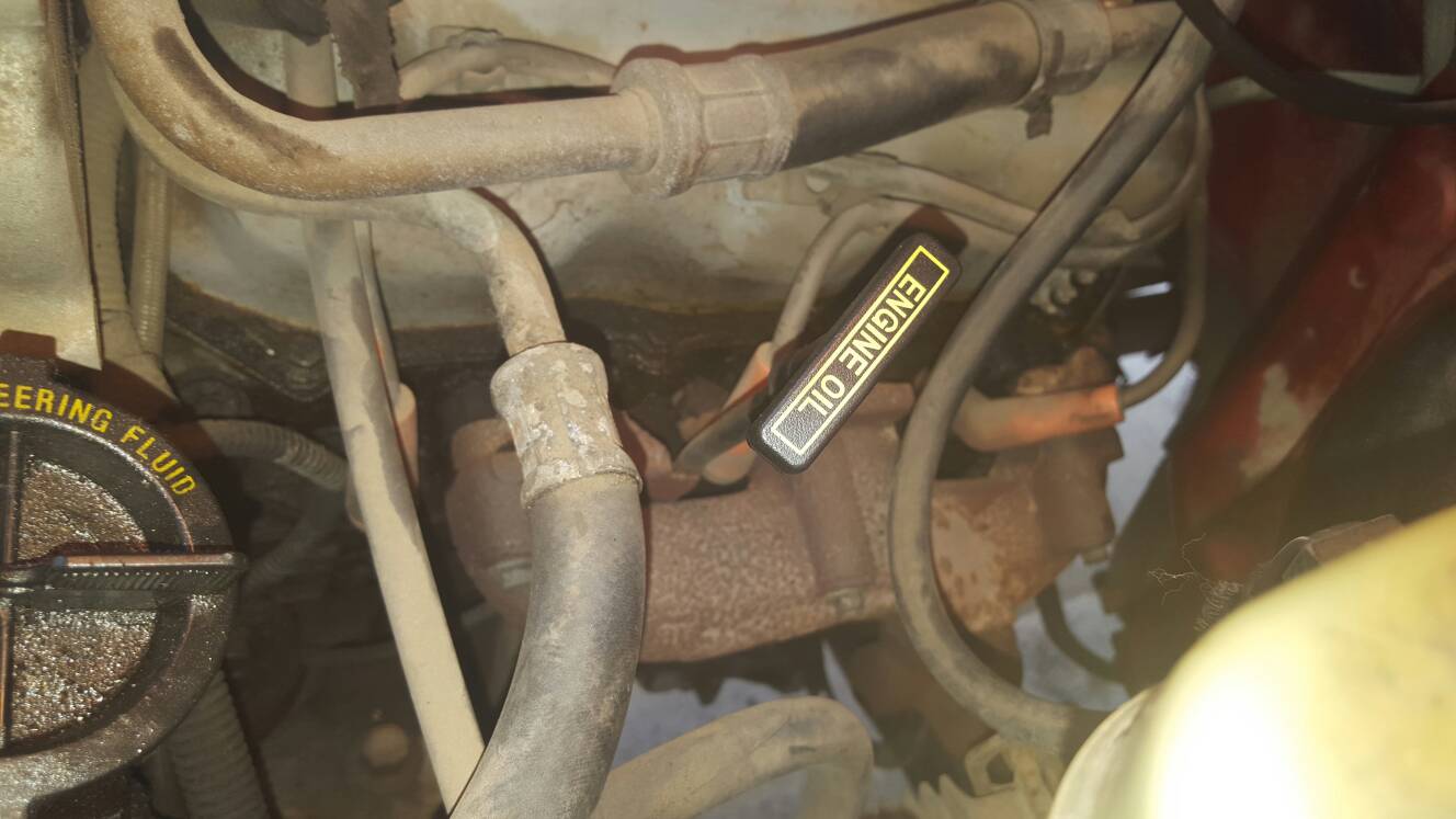

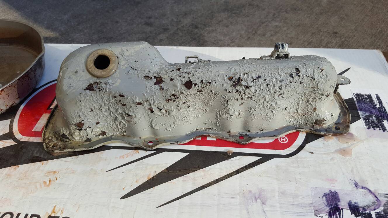

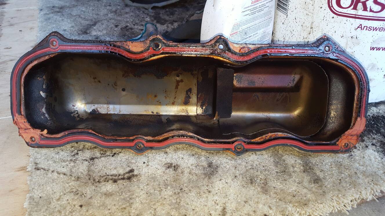

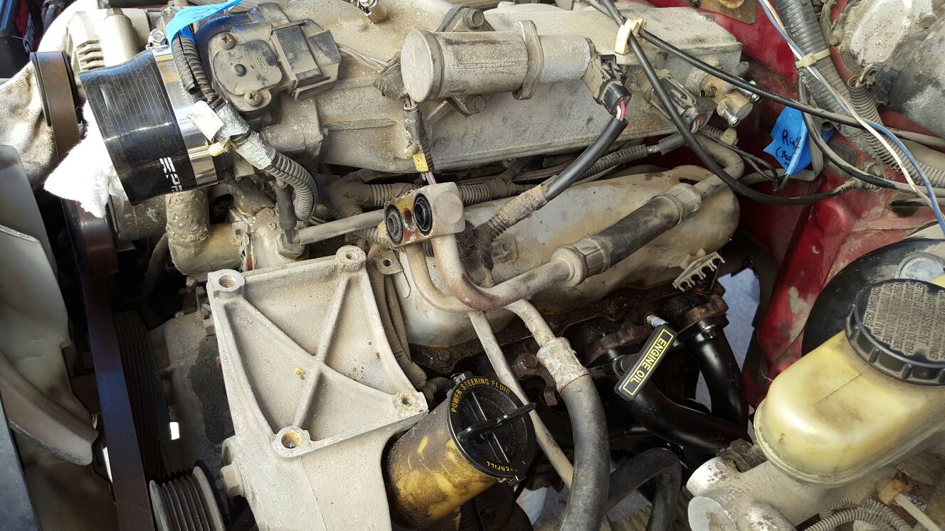

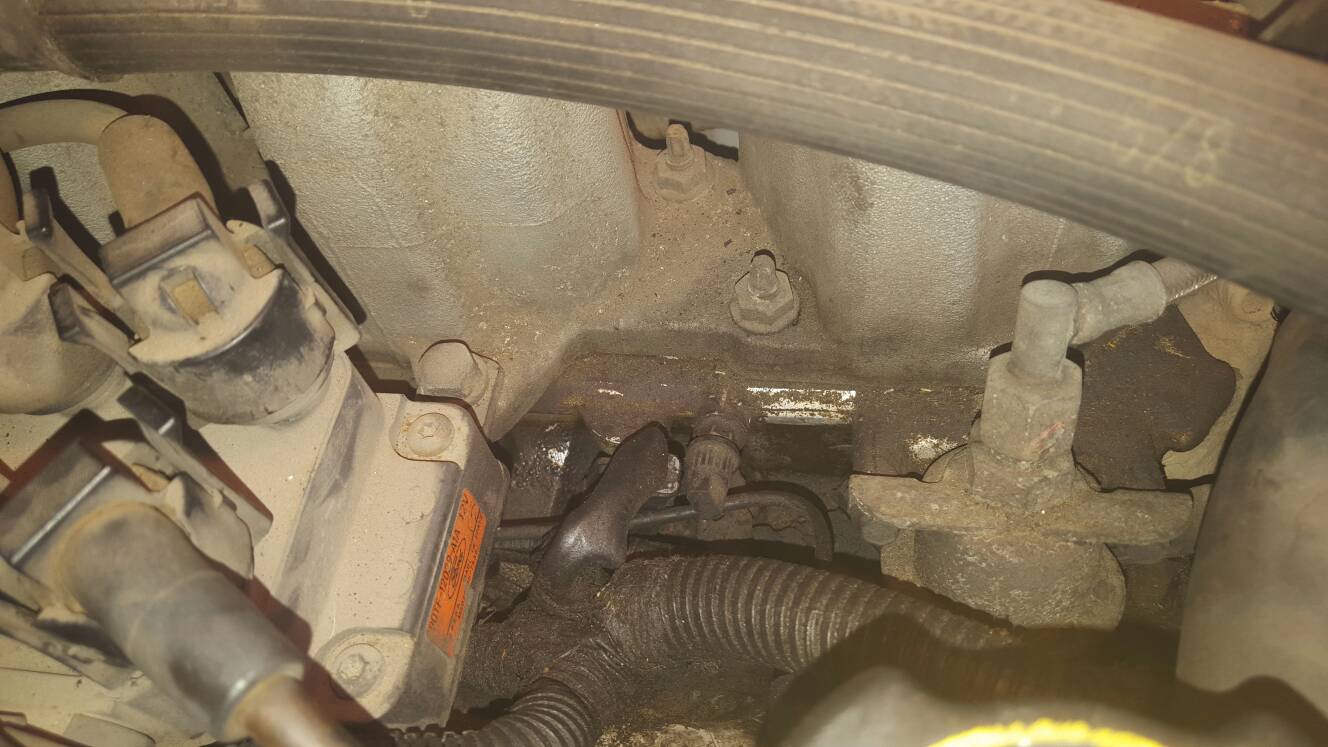

So far, have gotten only the driver's side headers and valve covers completed. Needed rocker arm gaskets BAD.
It ran rough, so I decided to replace the catalytic converters while I was at it. But....

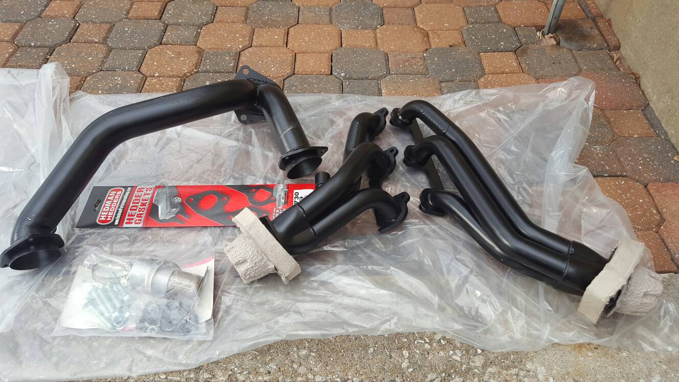

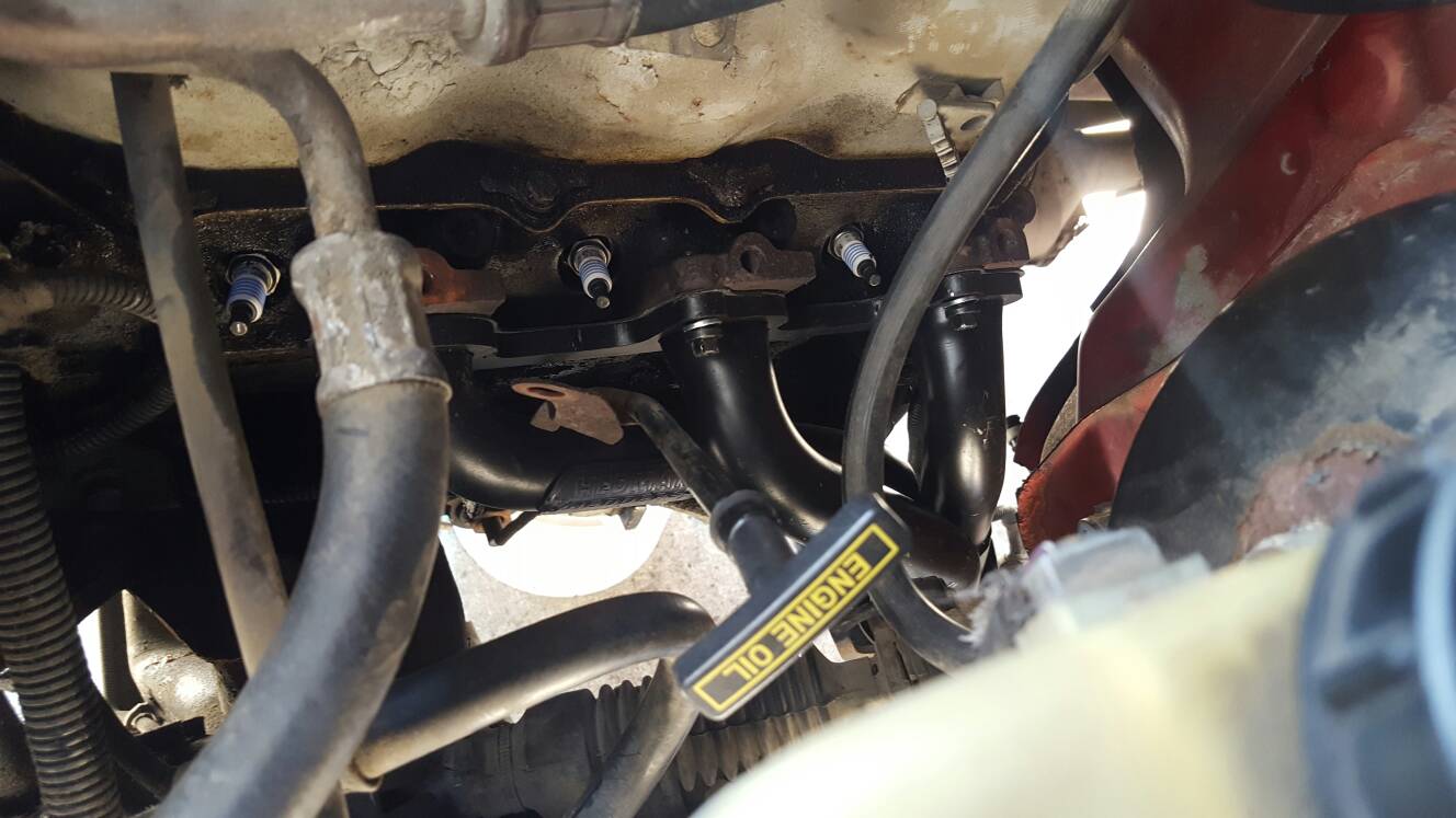

So why not new headers to make it easier to install, plus have completely new exhaust all the way back

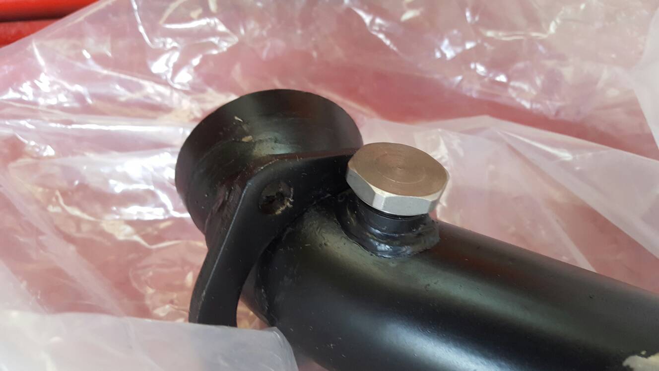

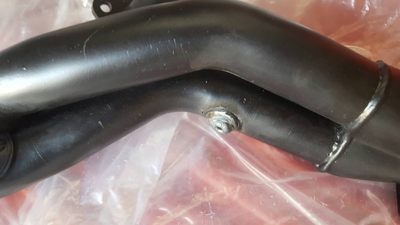

Some 4.0's have egr valve, mine doesn't. Had extension cut off and welded, also had to plug O2 sensor in left side of y-pipe (mine is on right side)
The Ford shop manuals were invaluable to me here. So much to remove, and this is the easy side!

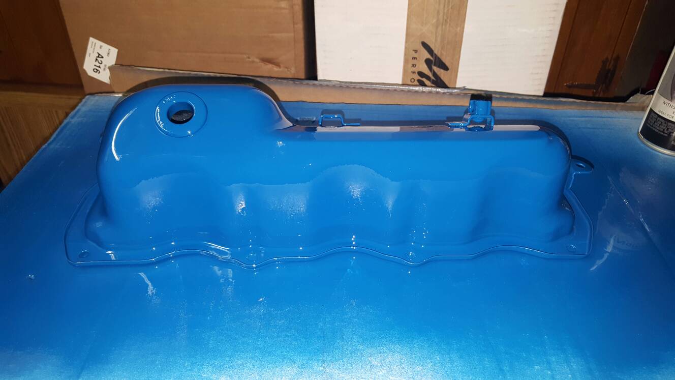

Cleaned this up too.

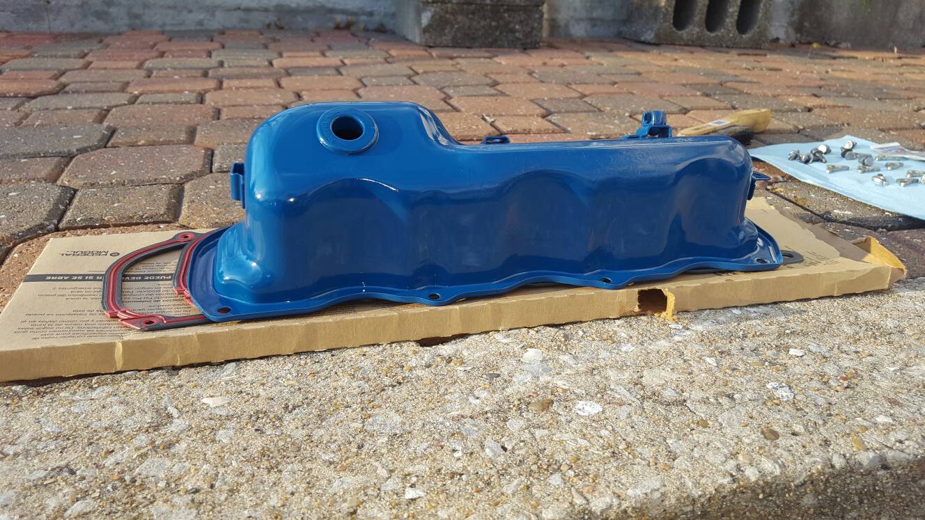

Old Ford Blue
Of course I had to polish the bolts too.

Well Mr. Matthew, for a self-proclaimed "Not a mechanic" you sure do pretty work.
One heads-up that I ran into when I installed my headers, which are the same set you have there, don't bolt them fast to the head until you have the Y-pipe bolts started. I was unable to get the Y-pipe to even line up with the headers bolted down. The guy I talked to at Headman was clueless, but another member on here gave me the secret.
Although, and this is just me, if I was working with a 2wd truck I'd ditch that Y-pipe and go true dual.

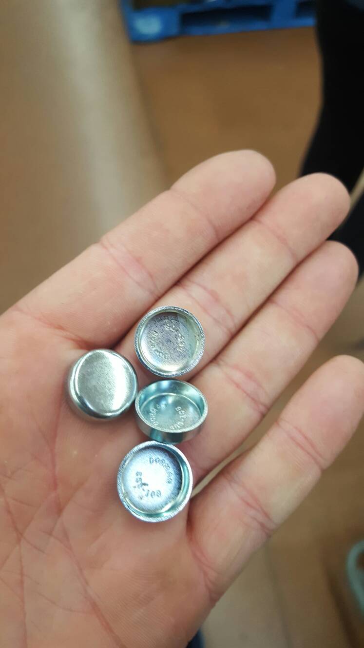

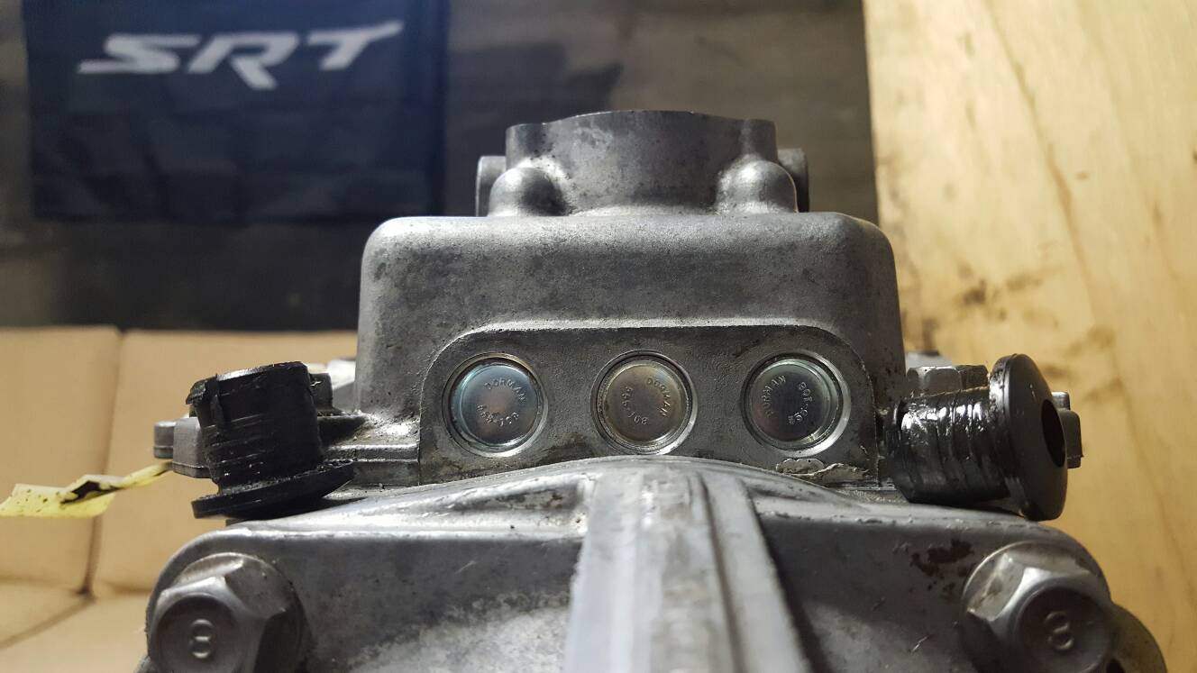

Did you swap the 3 rubber plugs at the top of the tranny by the shifter? They are most famous for leaking out of there. Mine does and I can't wait to fix it when I have the tranny out.
Not yet but I believe I found the part number for the metal plugs that pop in to replace the rubber plugs. Will definitely be doing that, I forgot to mention. Thanks for the heads up!

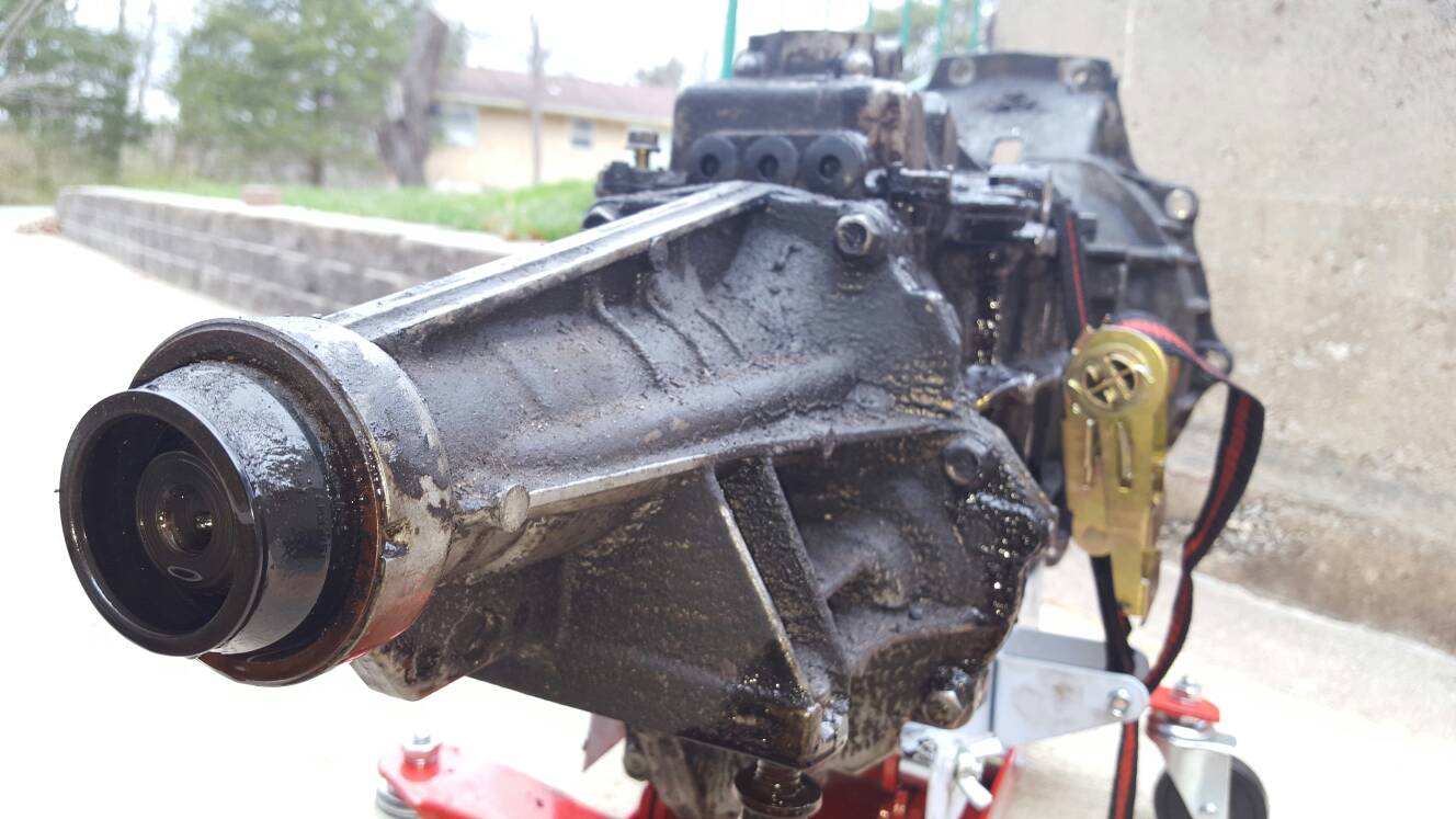

The last piece of the puzzle to get my trans back to 100%
Thanks for the reminder @Kirby N.
New baffle, and new input shaft seal installed. New seal and ready to clean. Then install new clutch slave cylinder and it's ready to go in.
