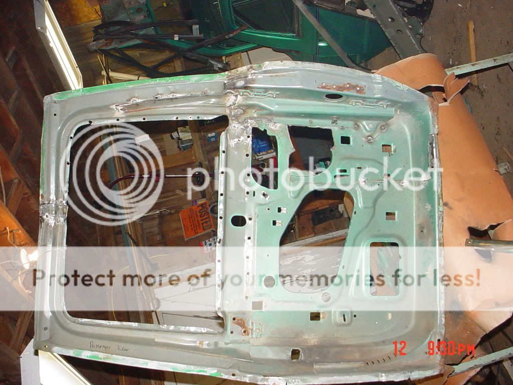

door passenger rear
:icon_welder:Well, everyone sorry about the length of time since last post. Winter hit us with 70mph gusts the Sunday after Christmas . Took part of my Roof so I had to repair that what fun being on a Roof for 8 hours. The Sunday before my Family hosted the Christmas party for the relatives what a day that ended up being 2 plus feet of snow at least it was a white Christmas.

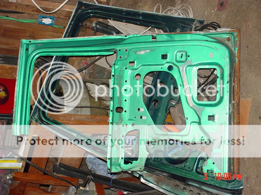

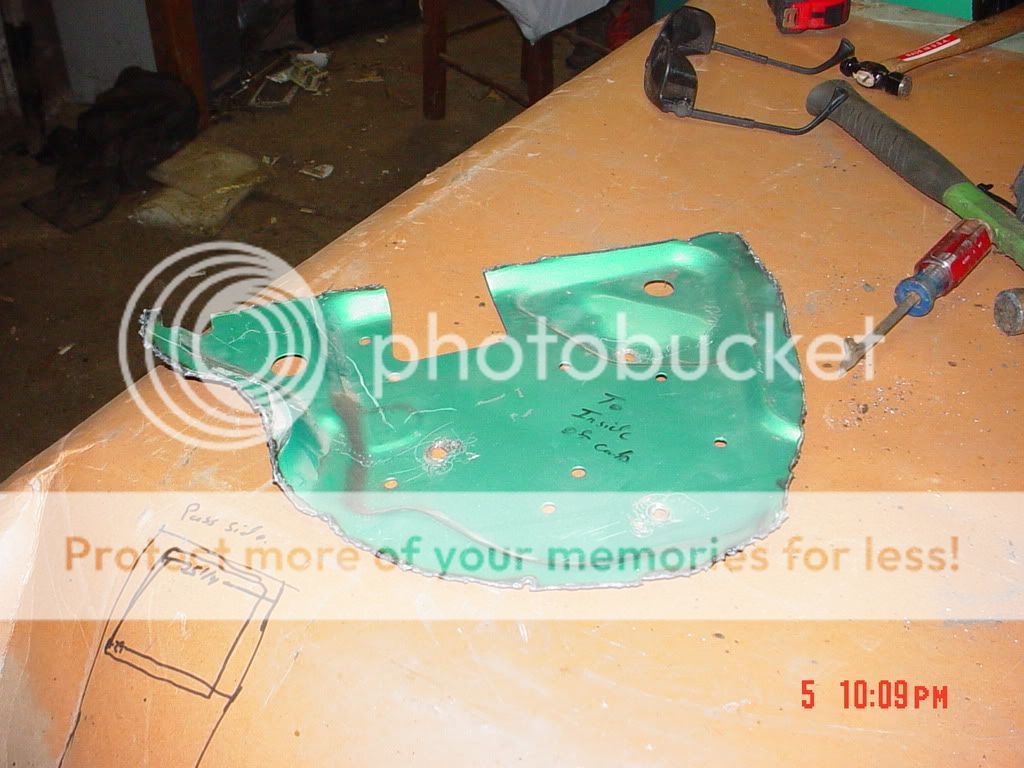

Ok with that said, lets see the progress after looking and thinking for a long time at the doors also getting my stomach not to churn about cutting the doors up. I started with lobbing off the front of the door for the rear pass side.
my new project QUAD CAB

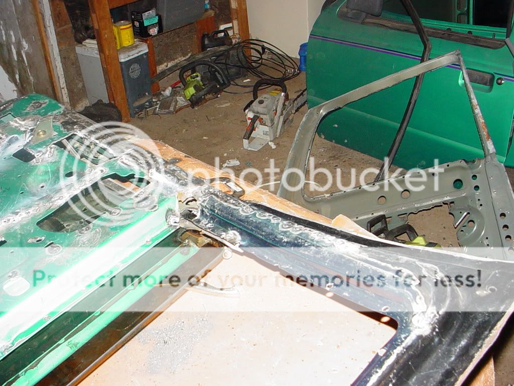

Next I cut the rear upright support off the black door to use for the front of the rear doors and started forming it to the front of rear door

Next I looked at the explorer door and noticed the upright support and cut that to use in the front f the rear door

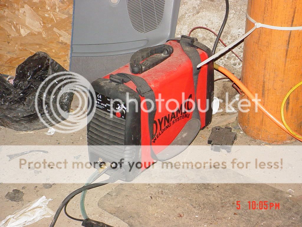

Here is a pic of the plasma/ tig welder

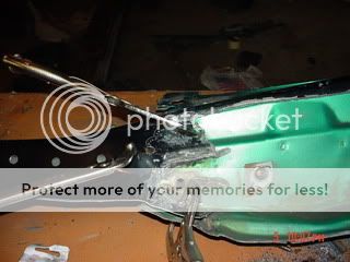

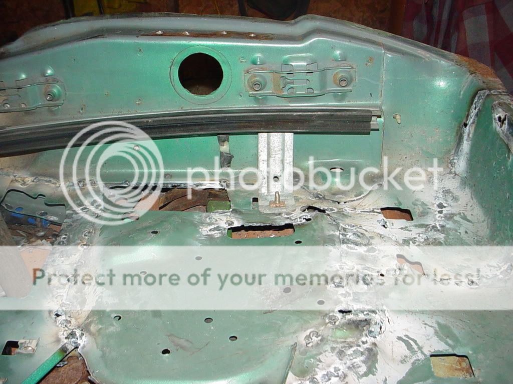

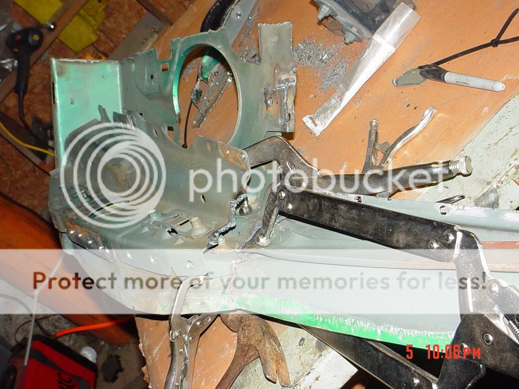

First we have the forward post welded up side
From interior side

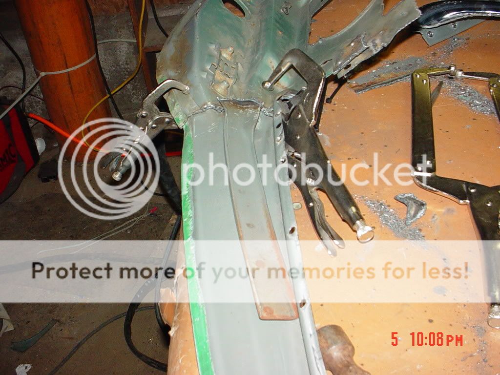

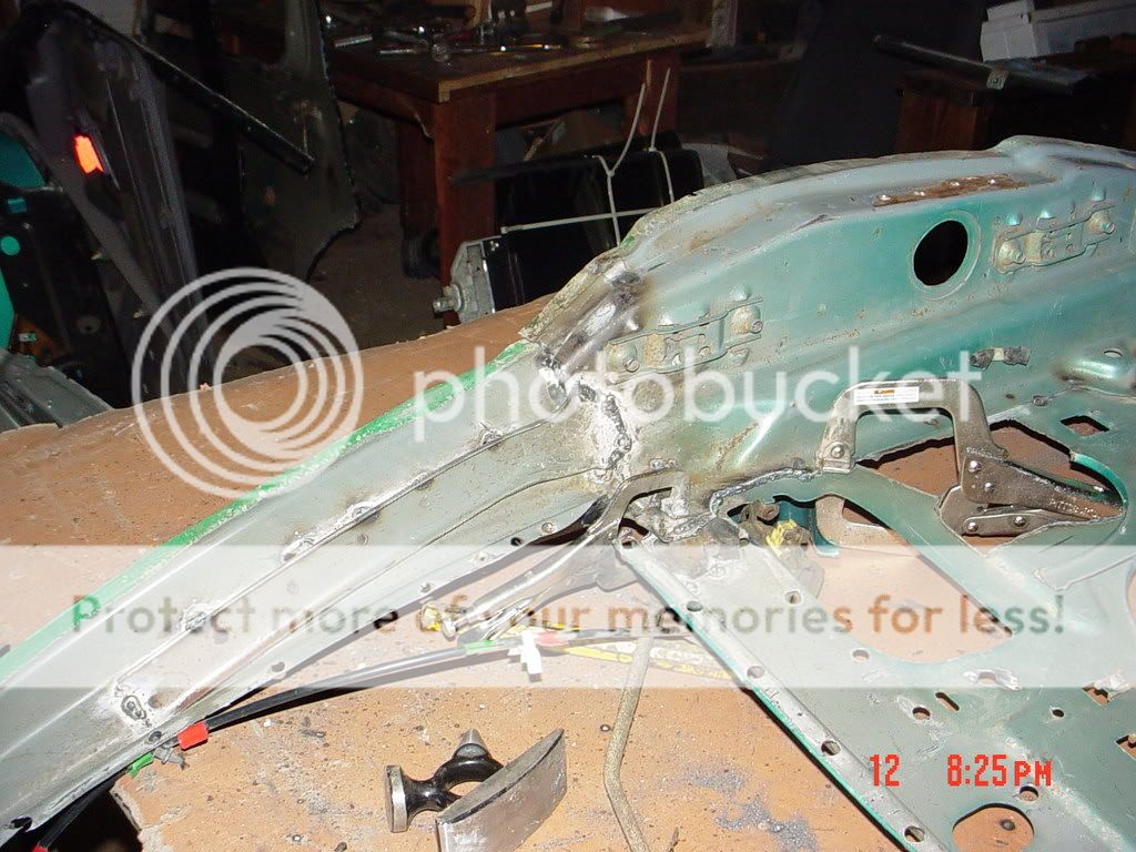

The support welded in on front interior this support really stiffened the door post

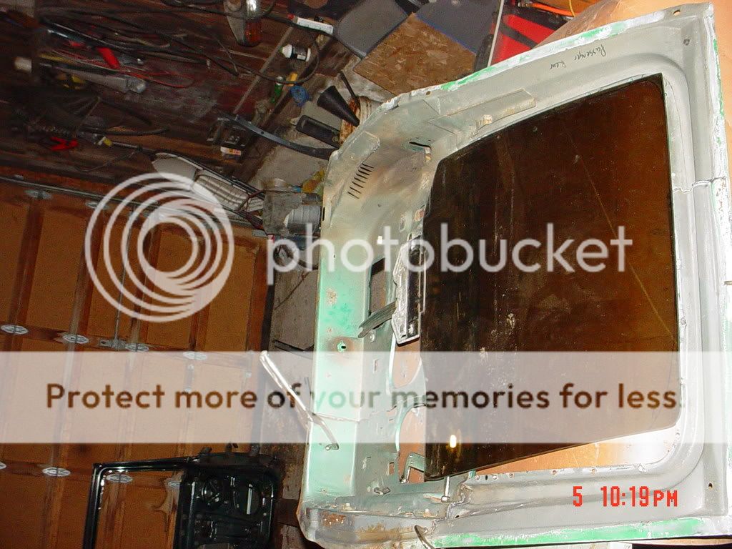

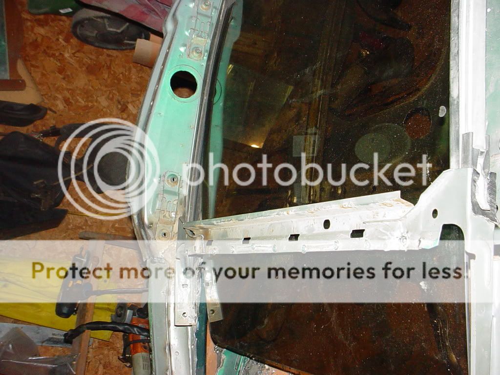

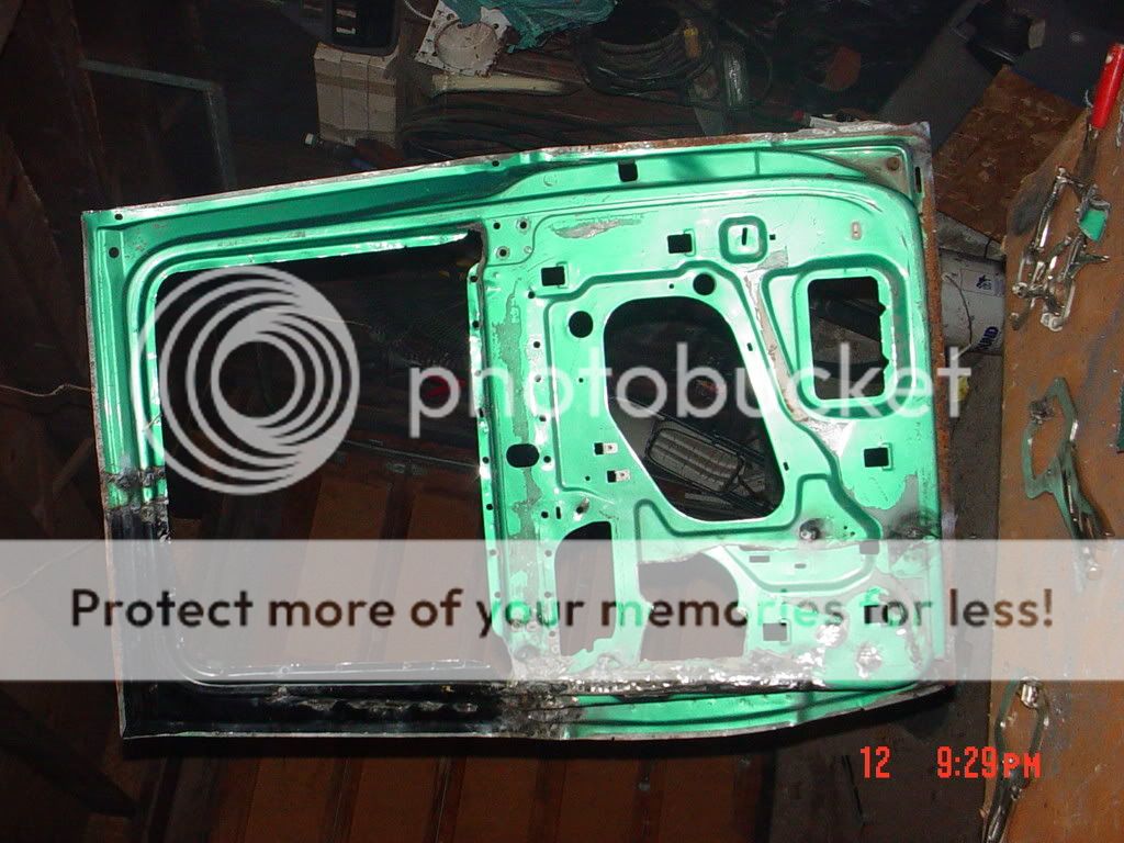

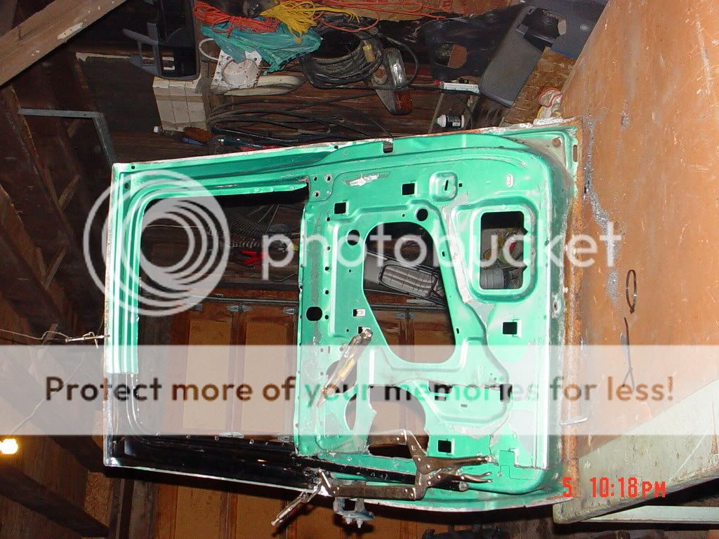

Here is the door tacked together

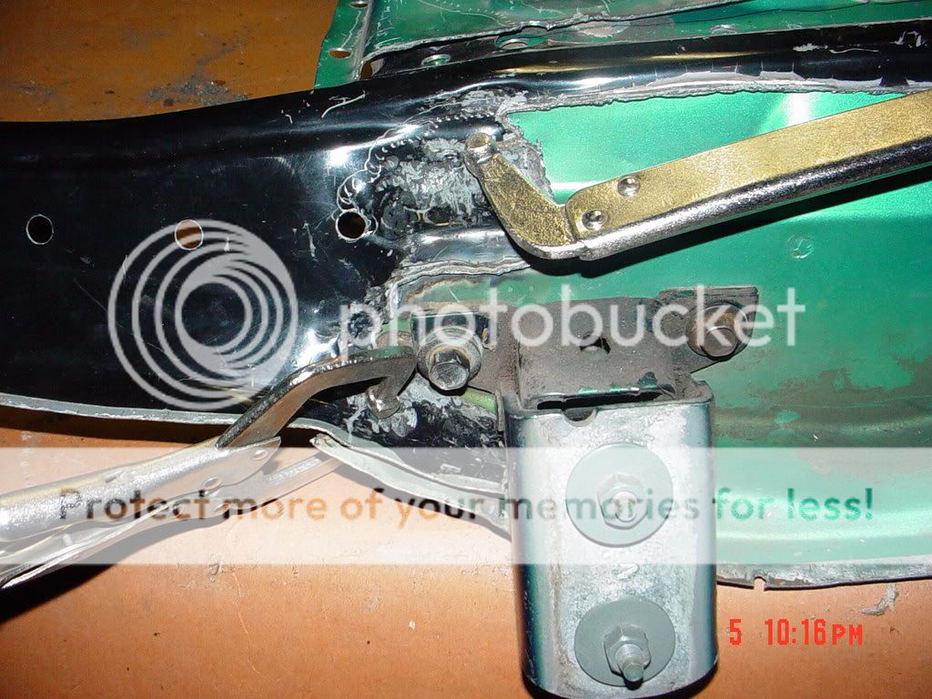

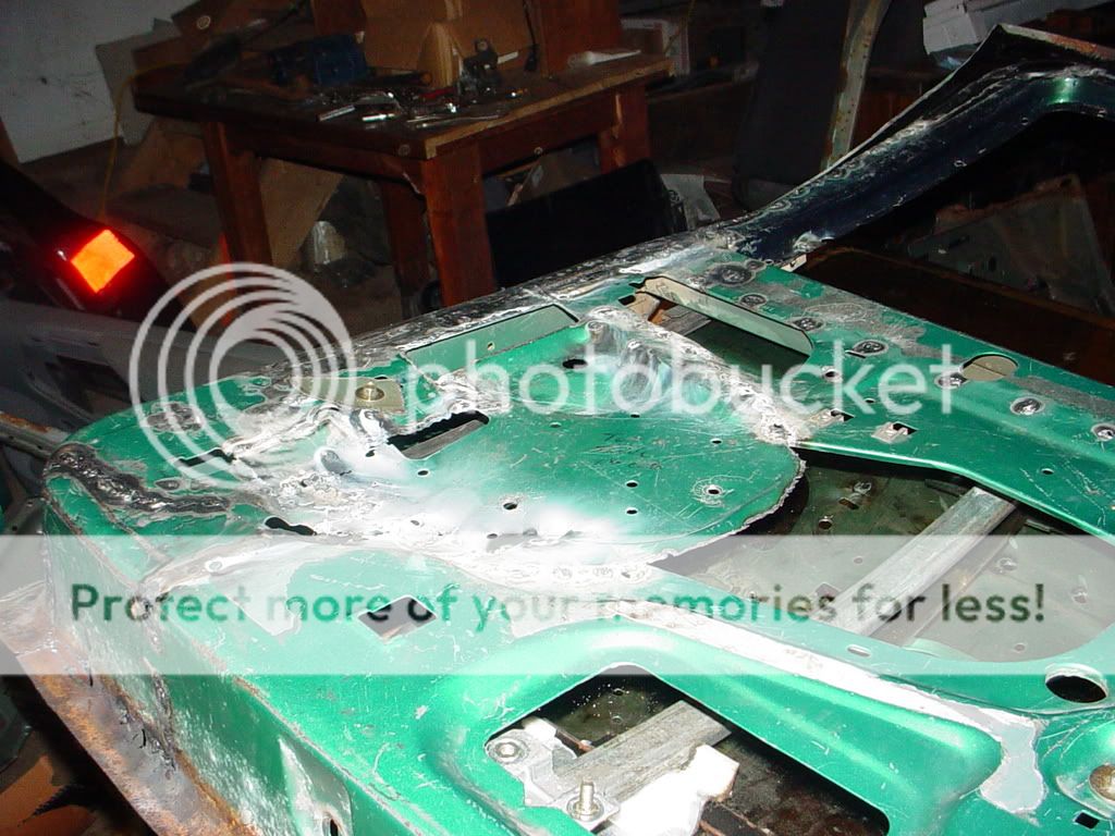

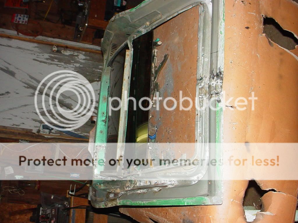

Next I welded in the lip from explorer door to get proper curve for window edge

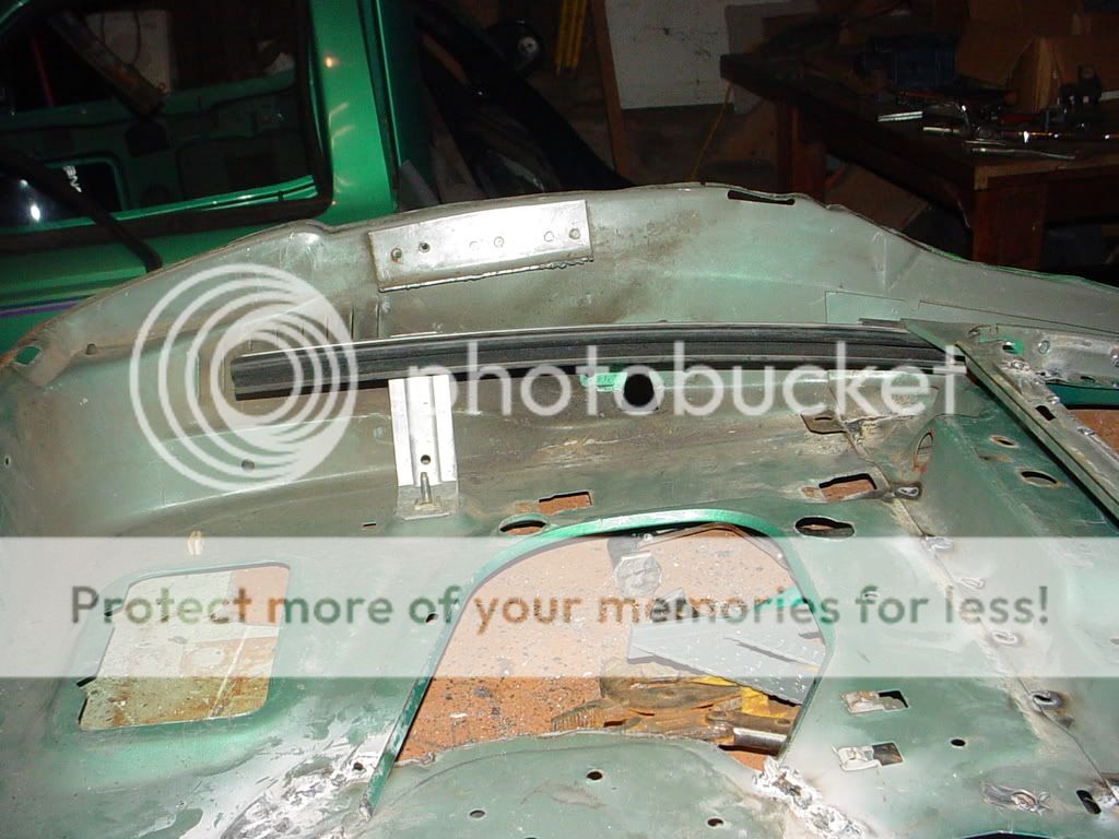

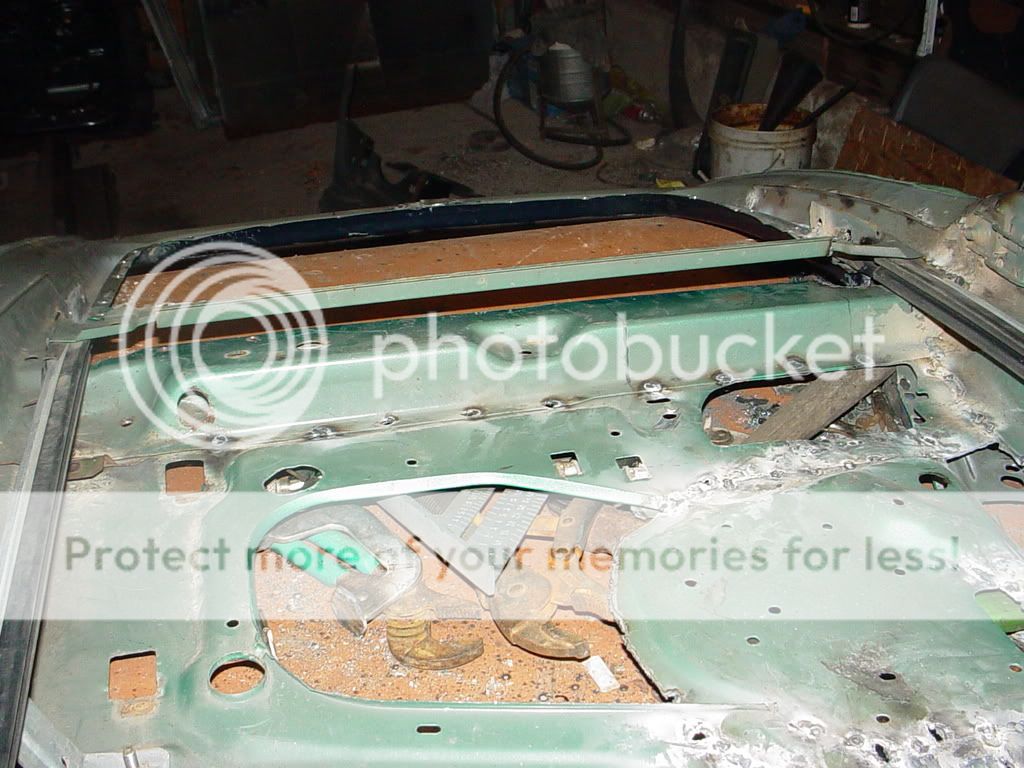

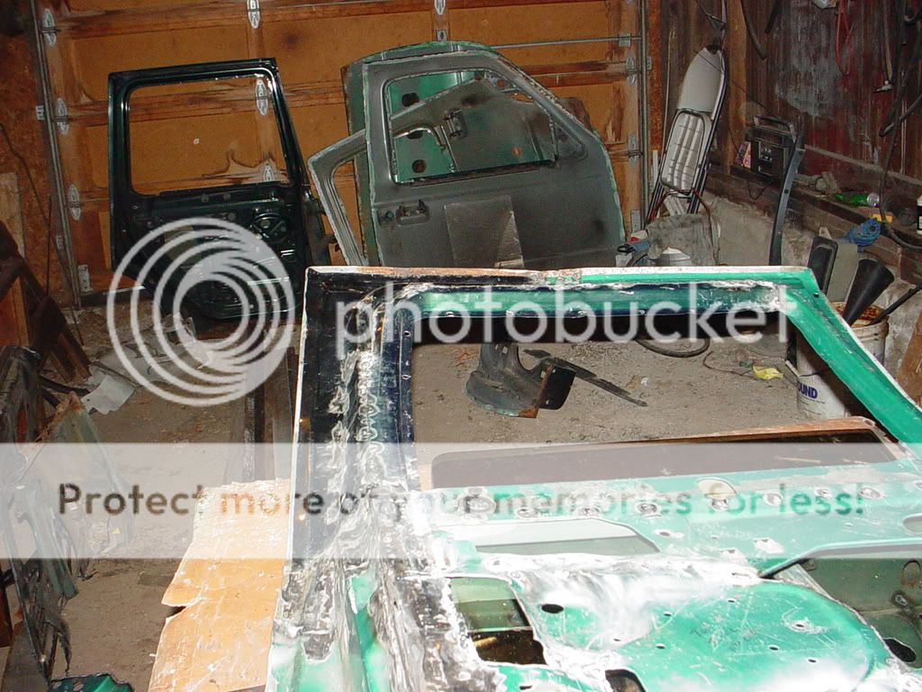

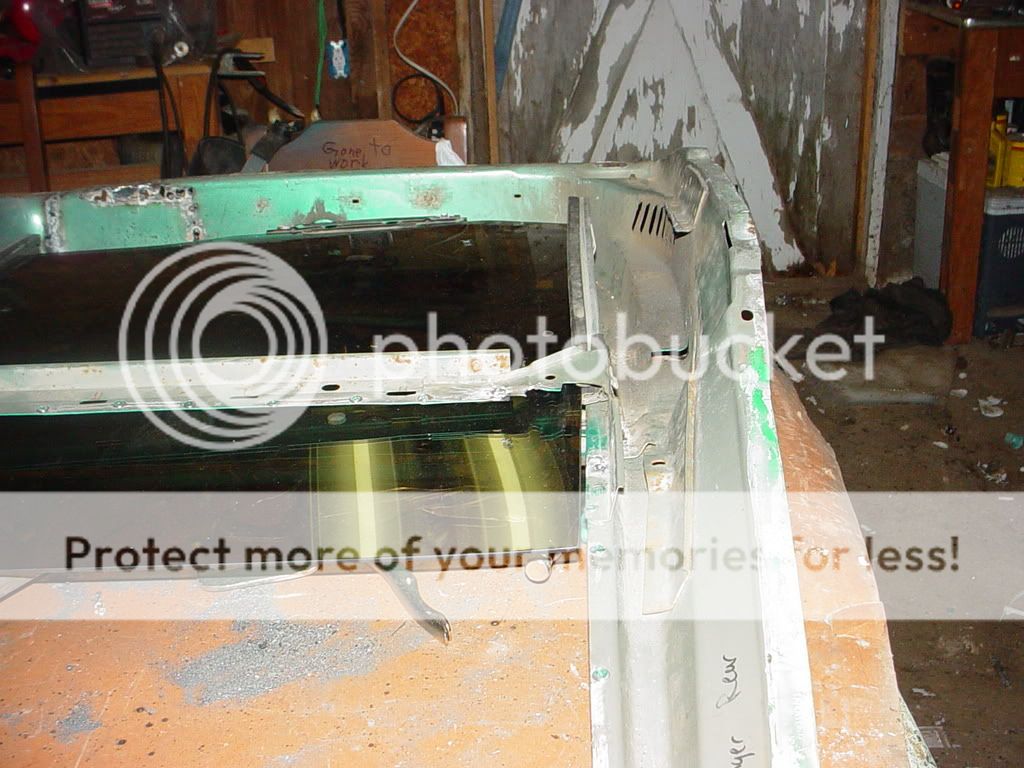

Next and currently working on the track for window

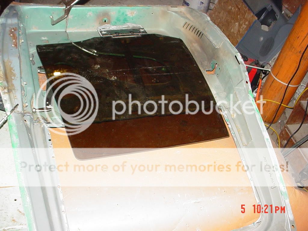

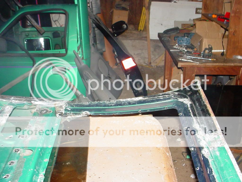

The tracks have to be adjusted so the window rolls up flush with the door

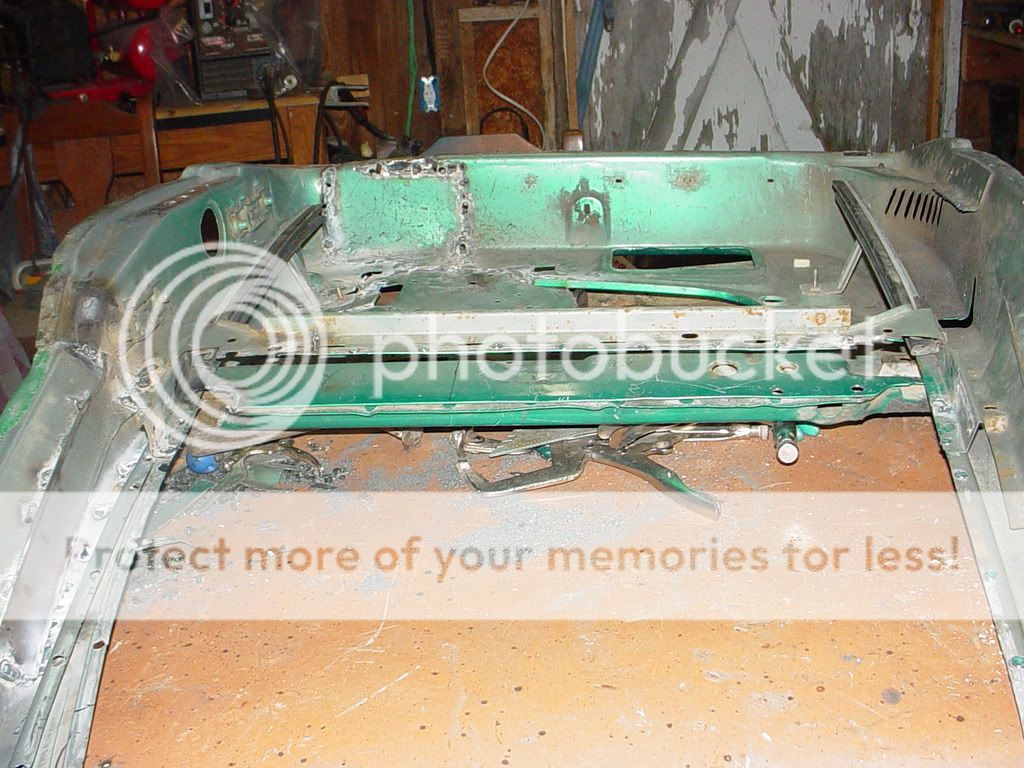

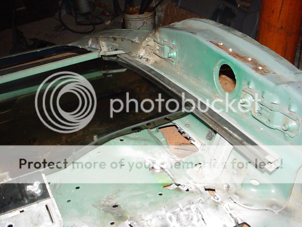

Here u can see pretty much the whole door
