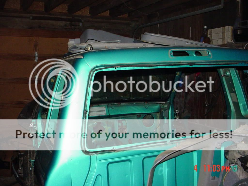

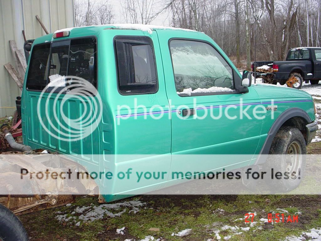

This is going to be the back half of truck. Snap a line all the way down on each side of the ¼ windows there is going to be a seam this will allow the rear seats to recline a bit.

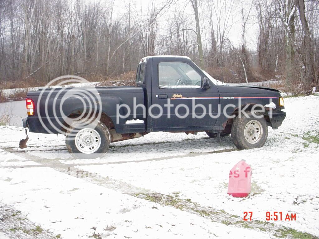

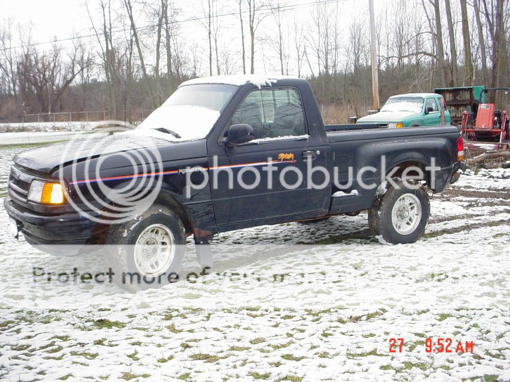

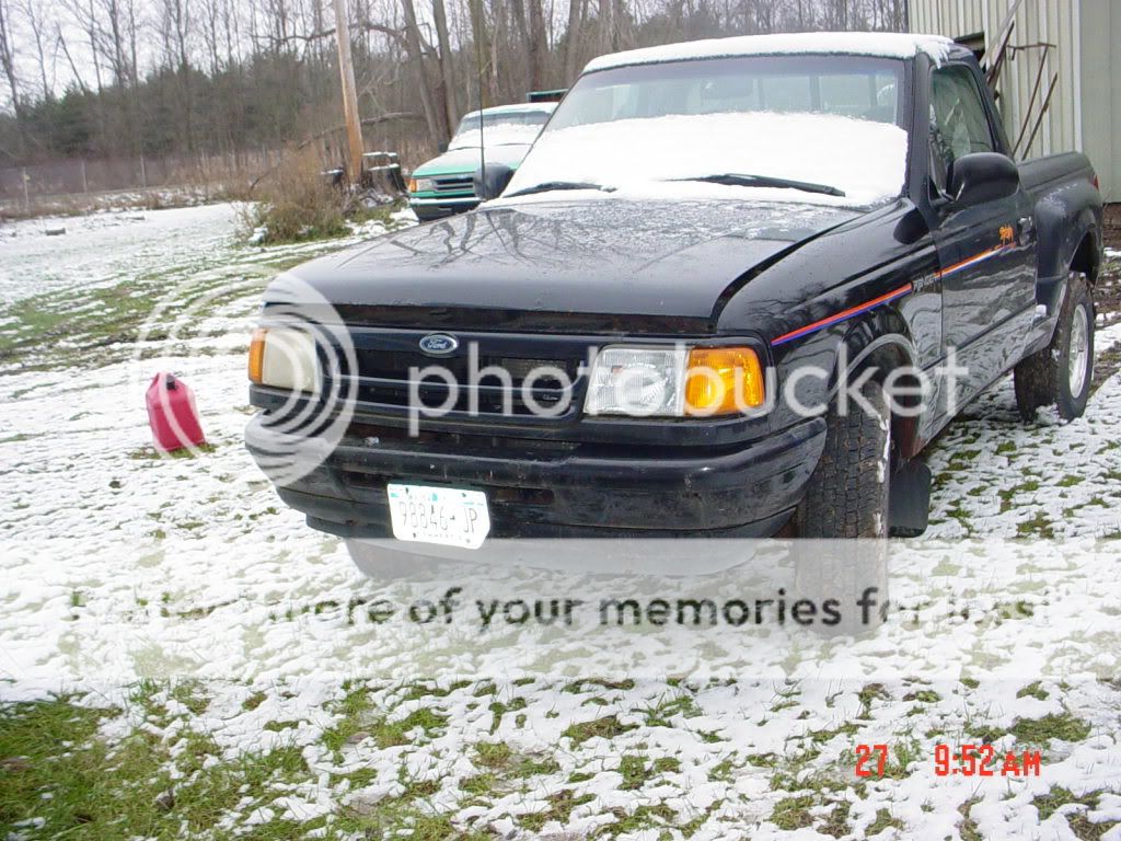

Not a bad cab to start with

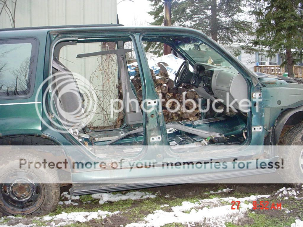

Front end

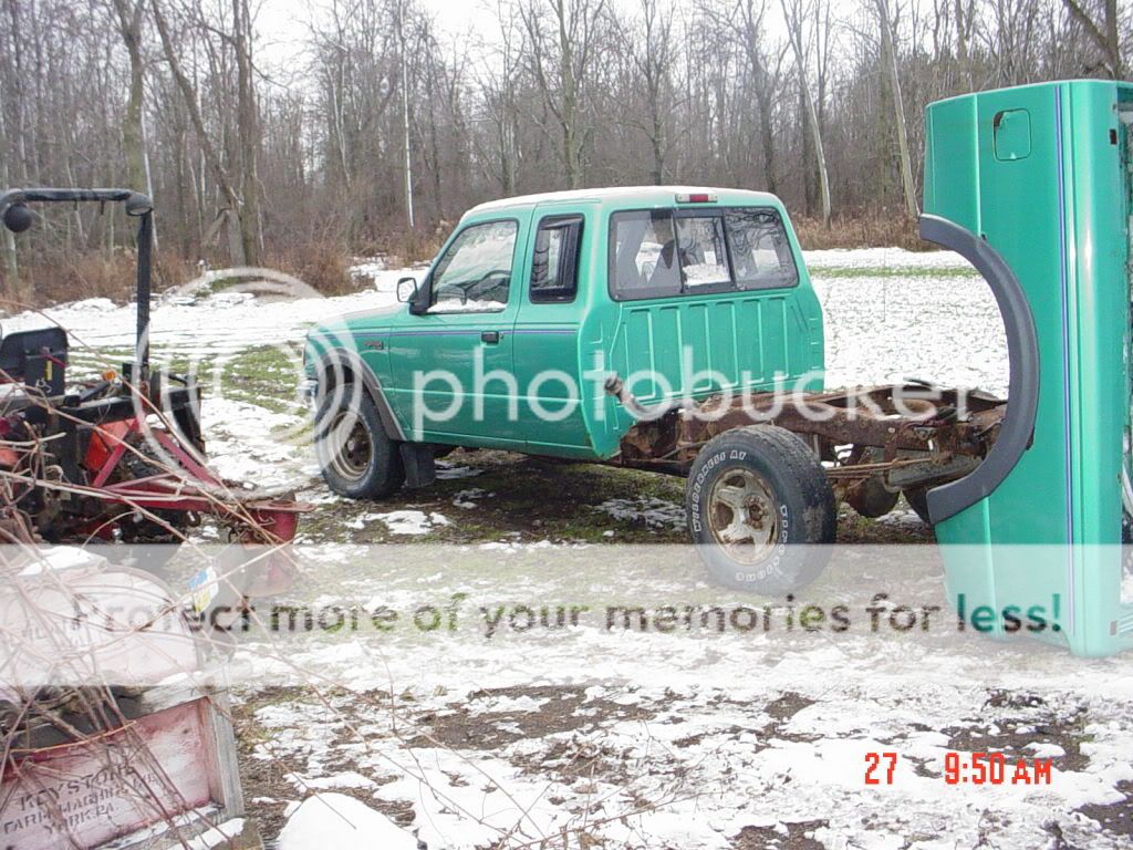

The donor for the front half

So your cutting the entire front end of the Green truck?
And using it's doors as the back doors and the blue truck as the front end and front doors?
Are you going to cut the doors so they're square?
I'm confused, that seems like a lot of work...
yes square green doors use explorer rear windows for them( moveable portion not fixed window)

how com you're not using the front of the green cab, rather than the front of the black cab?
Probably more metal left over for the door with the Supercab than with the Regular cab.
That's my guess anyways. Also, the green one has no rust that I can see, and the black ones rusted.
that is correct rust fre it will ne easy to repalce a hole door when i paint or rebuild the lower portion oppose build a hole door. however i might have a line on some doors from a quad cab either mexico or england
the green core support is hosed i think the black one is better i do not know till i get them both to bare metal also i want the rear power seats to recline a bit. in the standard cab they stay prettymuch straight up . this is being built like a quad cab should be with comfort for all

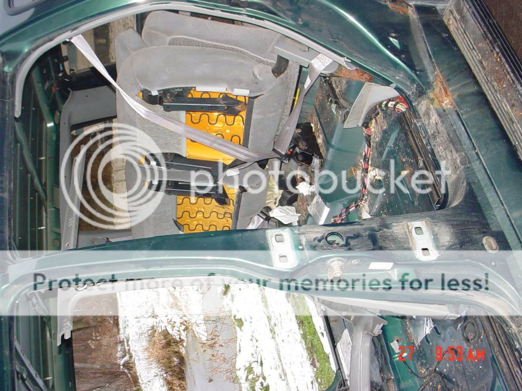

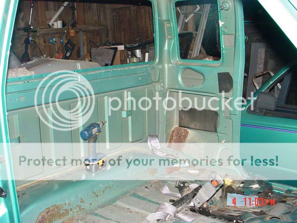

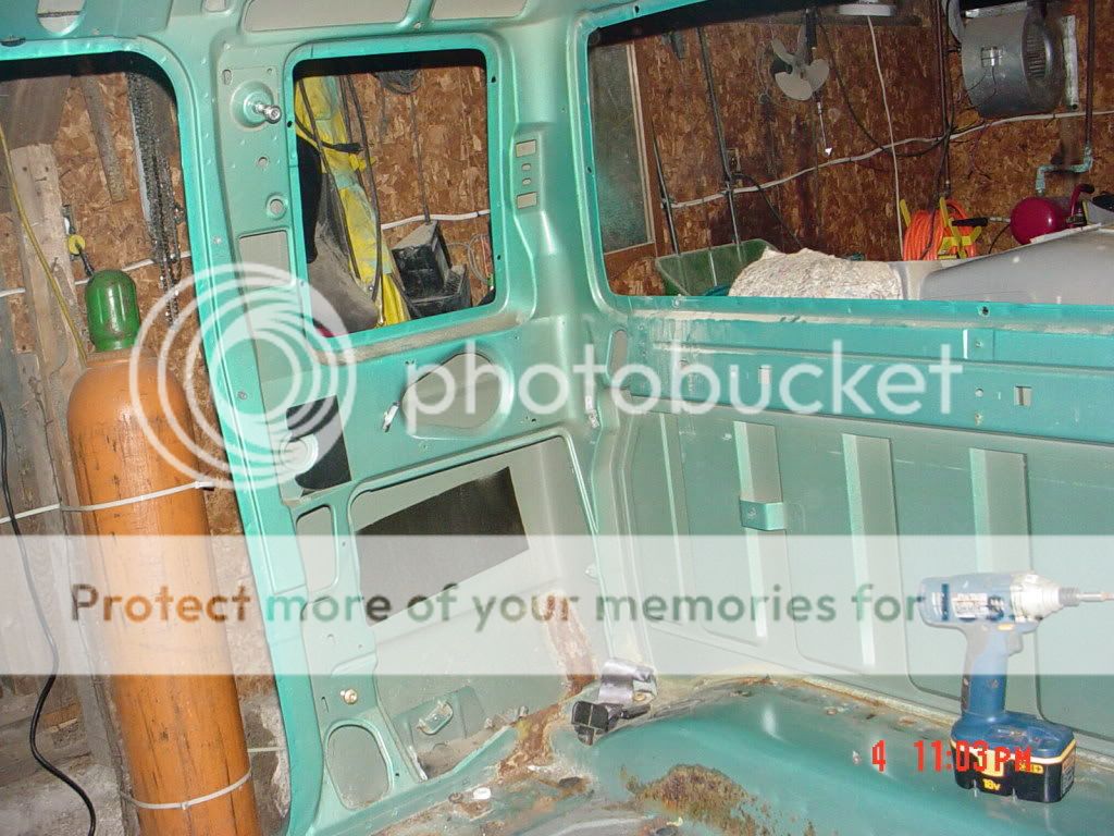

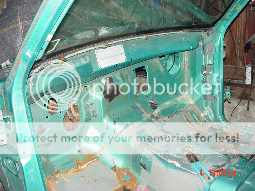

ok we (daughter and i ) got the cab gutted except for windsheild take a look
my new project QUAD CAB
a little surface rust nothing a little sand blast can't cure also a few hole in the driver floor we can take care of that also
