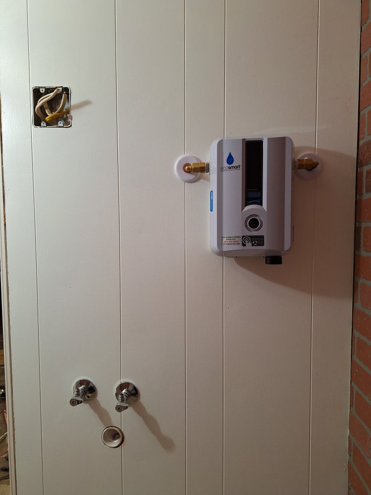

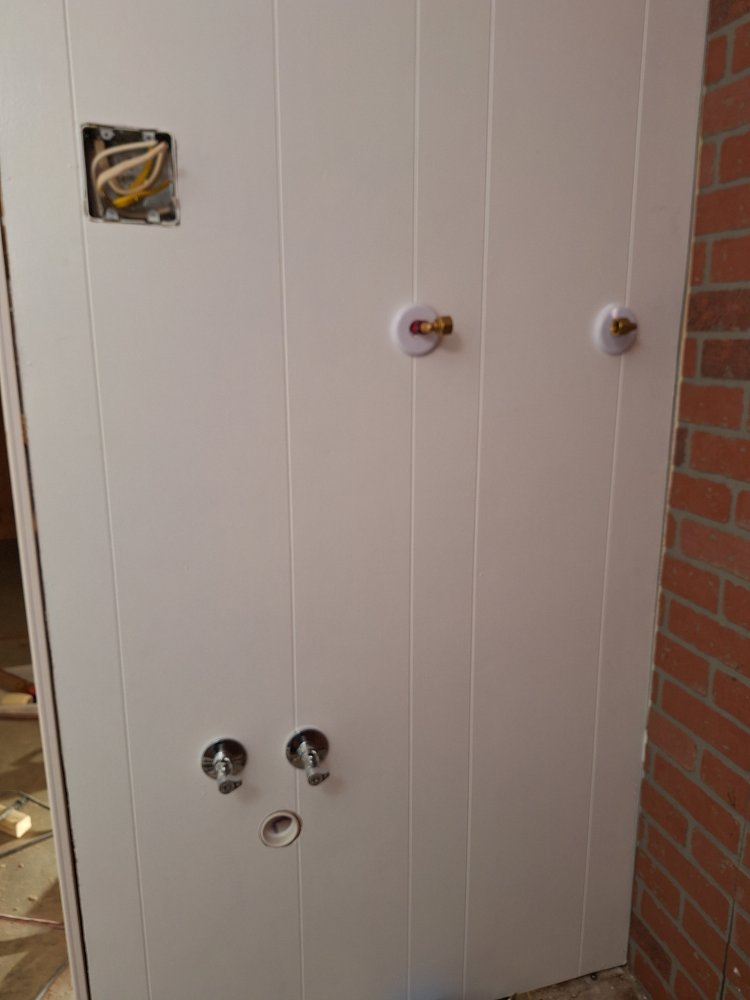

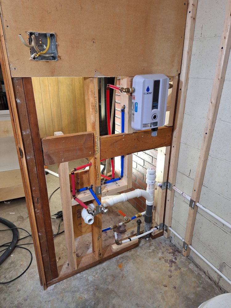

What are the red and blue feed lines higher up on the wall for, what will they feed?
That's where the tankless hotwater heater is going. I was originally going to put in in the vanity on the other side of the wall, but I didn't have the required clearance around it, so I put it inthr bathroom and mounted up on the wall away from small children.

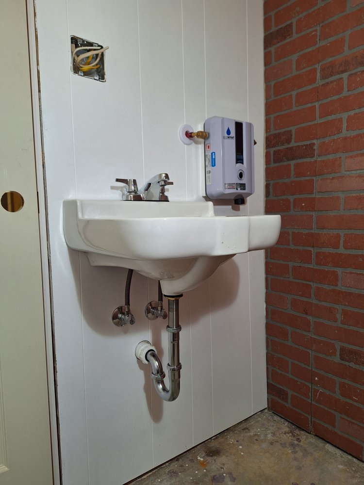

Work continues:
I re-used the sink that was in there and replaced the faucet and drain. There wasn't room for a vanity so I didn't see any point in wasting money on a new sink.
Today is probably the first time this sink has had water flowing through it in a decade or more. Still a lot of work to do.
I wish whoever originally built this bathroom would have put the sink and toilet on the same wall. This is a really poor layout. I would have to put up a 2x4 stud wall up behind the toilet to run the sink drain, and there isn't enough room between the toilet and cinderblocks for a 2x4 wall.
Probably could have had the drain pipe simply go left into the wall or had a cabinet under the sink?
Ya, probably. I'm probably going to kick myself for not moving it to the other wall, but as much aggravation as this project has caused me, I'm not starting over now. It's still better than having to walk out and go to the house.
. . . and it's even better than peeing in the alley, I suppose.
Your work really looks good, Jim. You should have been a plumber; you'd be rich and retired by now.
Afterthought, but wasn’t the toilet wall the original back wall of that building? And then there was another addition?
I’ll bet you the reason the sink is on the wing wall is so they could run the feed plumbing on the inside of the building and not one of the outside walls.
Not important, just a thought.

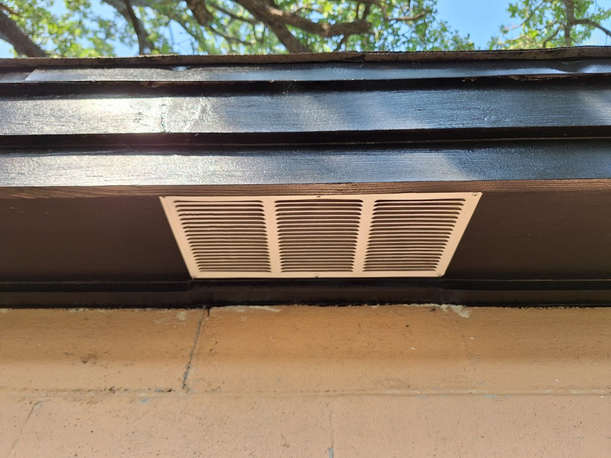

I replaced the old eave vents with new ones. The new ones are twice as wide, but I could only find them in white. You can't paint them because the have a screen in them to keep bugs out, and they'll get plugged up from the paint.

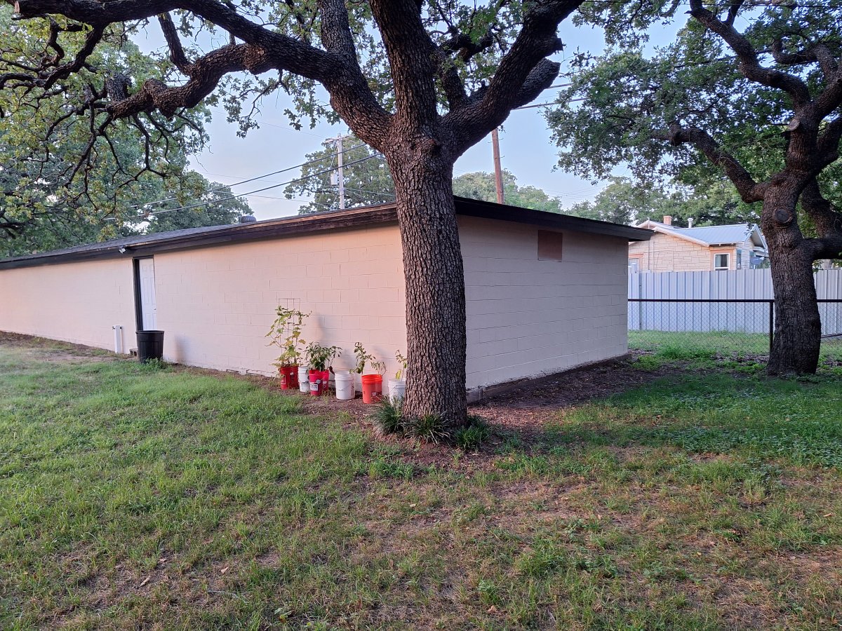

Finally got rid of the artwork the previous owner's grandson left a decade ago.
I didn't paint the plywood square because I plan to reinstall an air conditioner in that opening.
Goodbye pink paint!

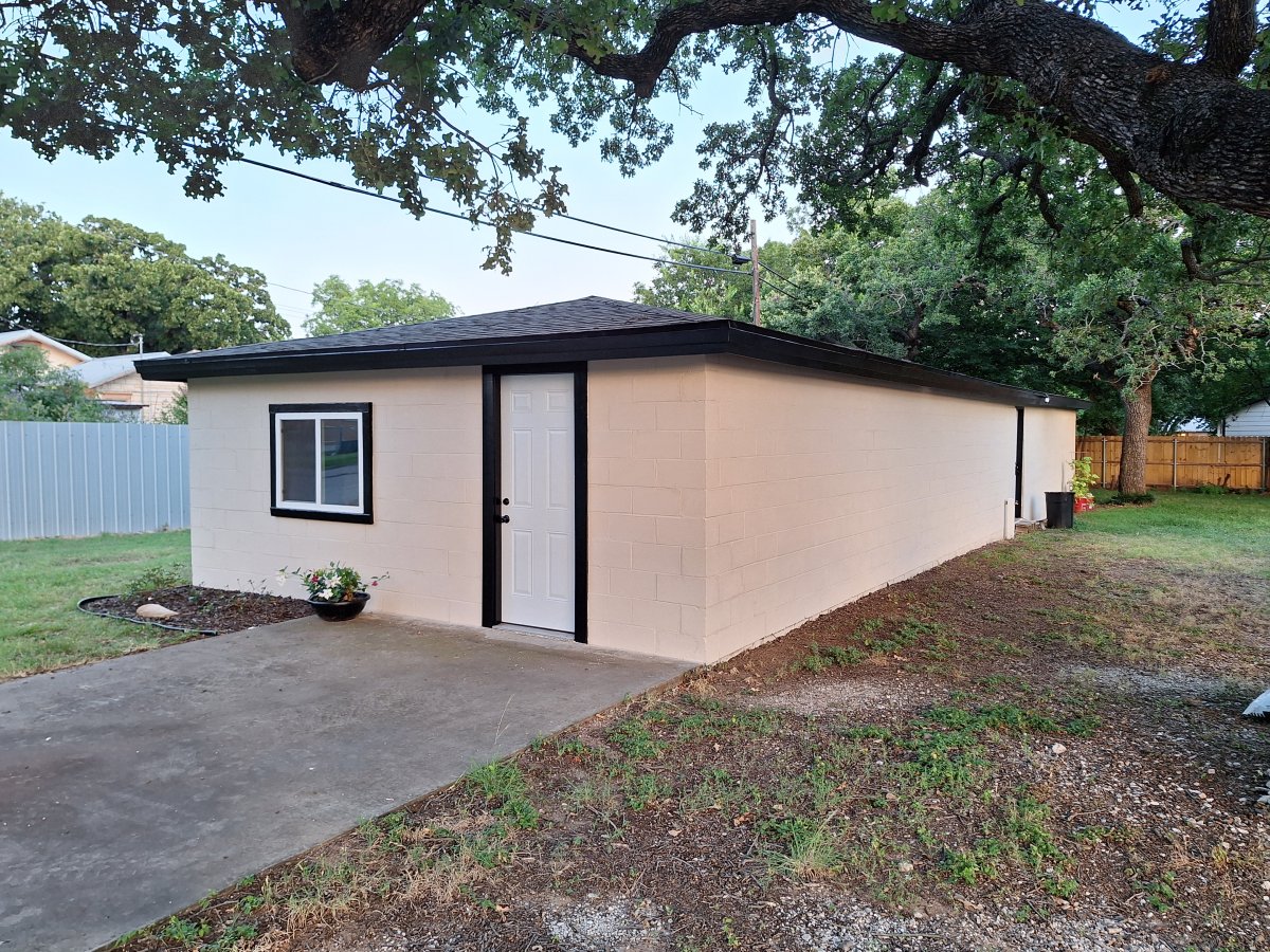

I finally got the whole thing trimmed and painted. I repainted the black trim around the doors and the front window.
It's actually a decent looking building now. Next spring I'll landscape around it.

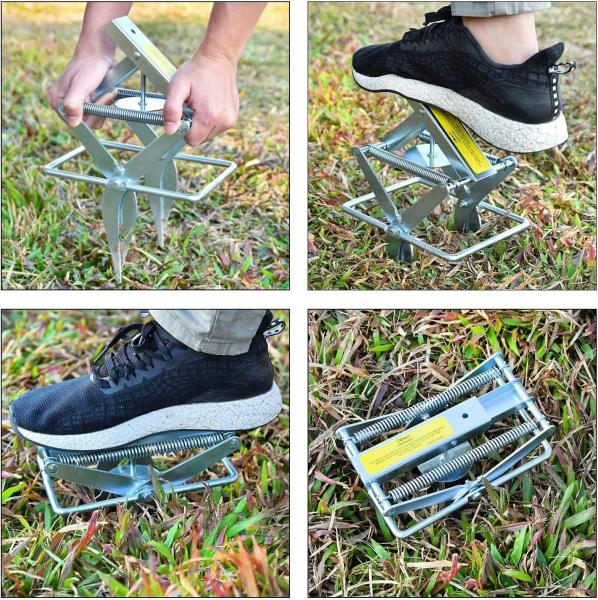

I bought this Scissor Trap / Mole Trap on Amazon because I couldn't find any stores that stocked it:

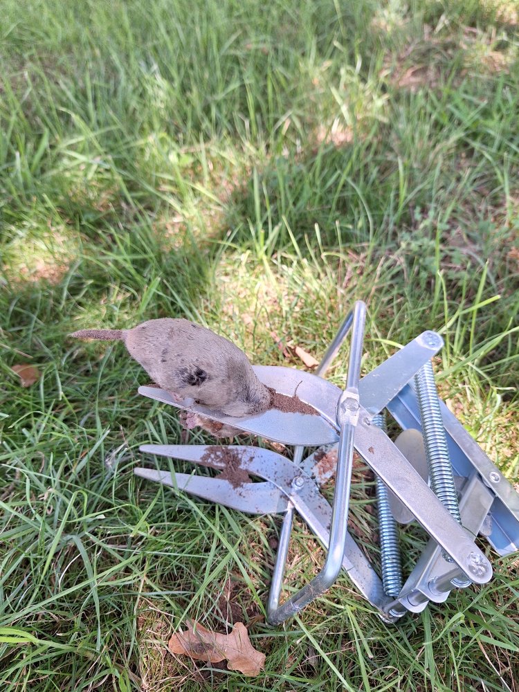

After I choose my spot, I pressed the raised dirt from the tunnel down with my foot, and then stuck the trap in the ground. When you set the trap, it opens up a pair of scissors. When the mole digs through the dirt it pushes up on the trap which triggers it.
I set the trap again just in case it has a partner in crime down there somewhere.
Finally nabbing this thing after months of trying to get rid of it made me feel like that was the best $26.00 I ever spent.
Damn you do nice work. I'm sure the neighbors are happy too.
You even got the varmint. I've never had any luck with that.
