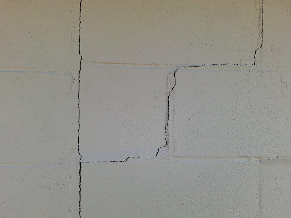

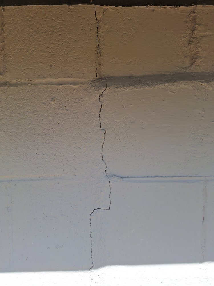

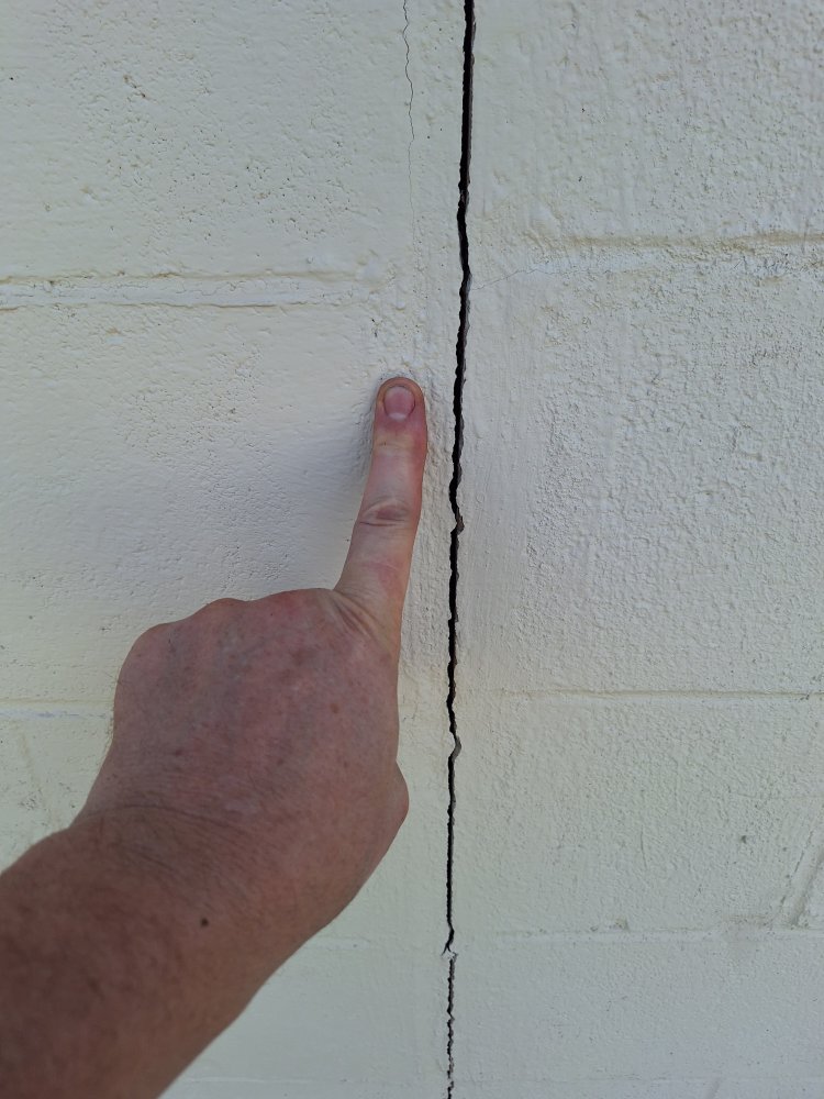

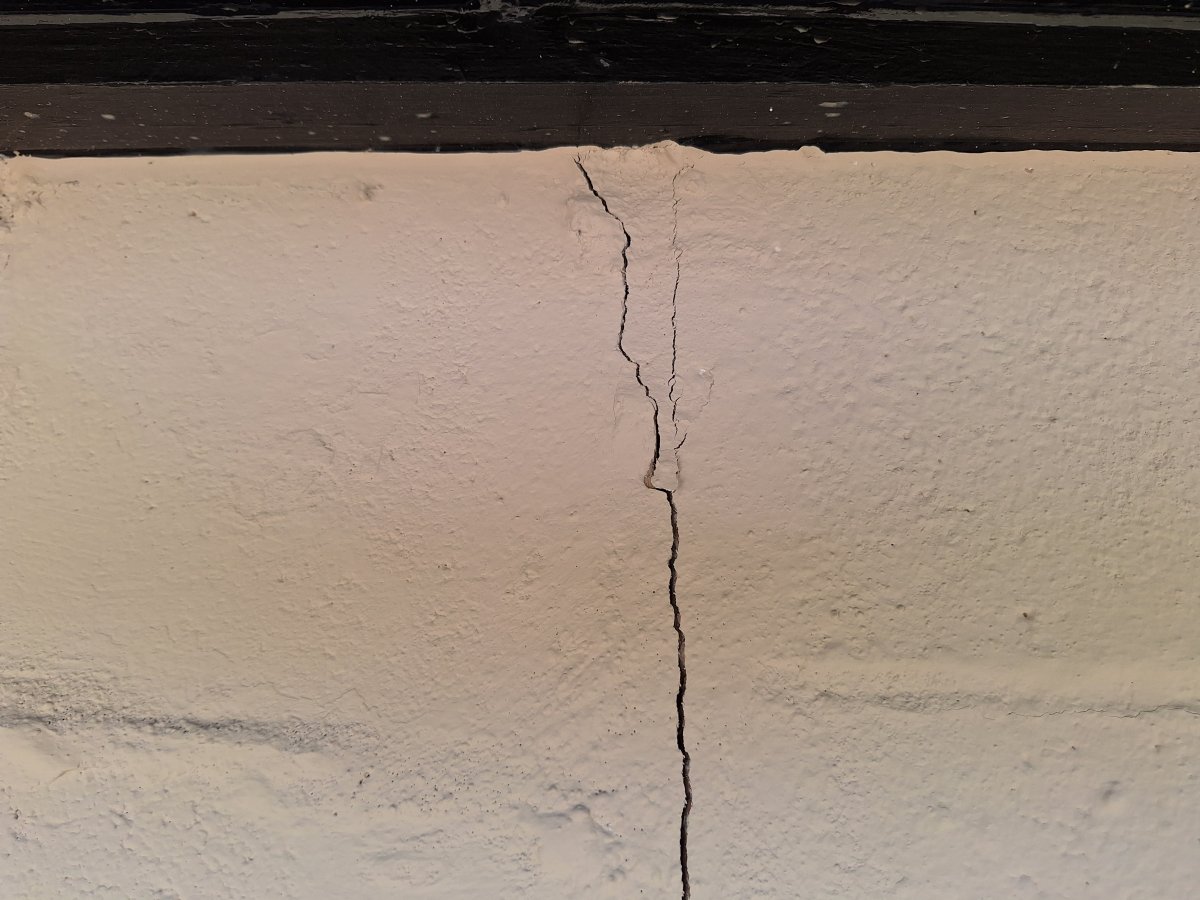

I don't know if I need a structural engineer or what.
Remember that gap on the side of the building I filled with mortar? The building is separating here.
I checked it because I noticed the mortar filler cracking on the opposite side of the building.
I don't know what to do at this point other than filling the cracks. I don't know if I could anchor these two walls together with some metal and bolts, or what it's going to take.
It's a cinderblock building with a cinderblock addition added on to double it's length.
Is the crack where the addition was added? Maybe post a picture of the whole side of the building and indicate where the crack is.
Having said that, I’m guessing your frost line is about 12 inches like Atlanta. If they didn’t prepare the soil under the addition properly, and they didn’t put the footings down about 18 inches, it’s possible that just from changes in moisture in the soil (no rain or a lot of rain), you can get an uplifting or settling of the dirt under the building, especially if there’s a lot of organic content in the soil. If it’s just a slab with a turned down edge, and they didn’t remove the topsoil and replace it with clean fill, this will happen every time.
From everything I’ve heard, I don’t think you have any structural problem, certainly not anything worth the expense of digging it all up. Trying to attach the two halves of the wall together would never work. If you think about it, each end of the building is probably a several tons. If they are levering relative to each other, there is no plate or bolt or system you could put in that would hold half the building up or down. You would most likely just move the crack over.
Hence, in my opinion, it’s a cosmetic issue and not a structural issue. I would just get a very good quality caulk, and caulk the crack, and see if the caulk stays in place.
If the caulk pulls lose, and the crack is vertical from top to bottom (vs stepping with the blocks), you could simply hide it with a piece of trim, like a 1 x 4 or a 1x6. If you do that, when you put it up to hide the crack, only attach it to one side of the crack. It would be like an expansion joint on a bridge. If you’re worried about moisture getting in, just put some weatherstripping on the back of the board. It will rub as the building moves, but it’ll keep 99% of the rain out.

It depends how much everything is moving. If that's where the addution was tied in, it probably should have been done with an expansion joint and certain tiny bit of mibemwnt expected due to the different ages of the 2 sections if building.
My 1 cent; if it was a primary residence and relatively newconstryction, I would want some kind of high quality fix applied. But, as an old outbuilding, as long as it's not falling down, I would just accept it as a minor nuisance. If you don't have water coming in through walls, roof or floor and no big trip hazard of a floor crack, it's too much hassle to repair properly in my opinion.
Up here there is a water base caulk called "Big Stretch". Iirc it can expand up to 1,200%. I would chip or cut the crack bigger to get to fresh concrete and fill with that caulk, using a backer rod.
Butyl rubber caulk. It's what you see along storefront windows where they meet the structure or sidewalk. There's a lot of movement between masonry and aluminum.
You have to clean the crack well, pressure wash if possible, let dry thoroughly, then gun it as deeply into the crack as possible, 1/2" is ideal.
It appears you foundation is sinking. I noticed the split gets wider the higher you go. How's the foundation? Do you live near railroad tracks?

IDK. It's a pretty even crack. The rest of the building is good. It's just where the block buts up against the old block.
Found this today:
Q. What is the best way to tie a new block addition into an existing block building?
A. Dowel the new footing to the original building with at least two #4 rebars. You’ll need to dig to the bottom of the existing footing, drill it horizontally, and grout in rebars that extend about a foot into the new footing. The new footing should be at the same depth as the existing footing and on undisturbed soil.
At the wall connection, vertically fasten a 3x3x1/4-inch angle to the original wall with expansion anchors (see illustration below). Provide a bond breaker on each leg of the angle, and break out the end webs of the new blocks. Then, pack the cores with mortar around the angle, and seal the joint between the new blocks and the old wall with a good elastomeric caulk. This will provide lateral support to the wall, but will allow some minor vertical movement without cracking.
I suspect whoever added this addition thought they could just but the wall up and mortar it without anchoring them together.
