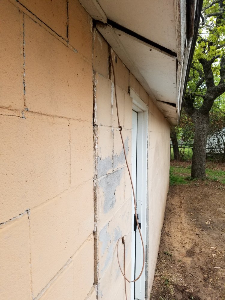

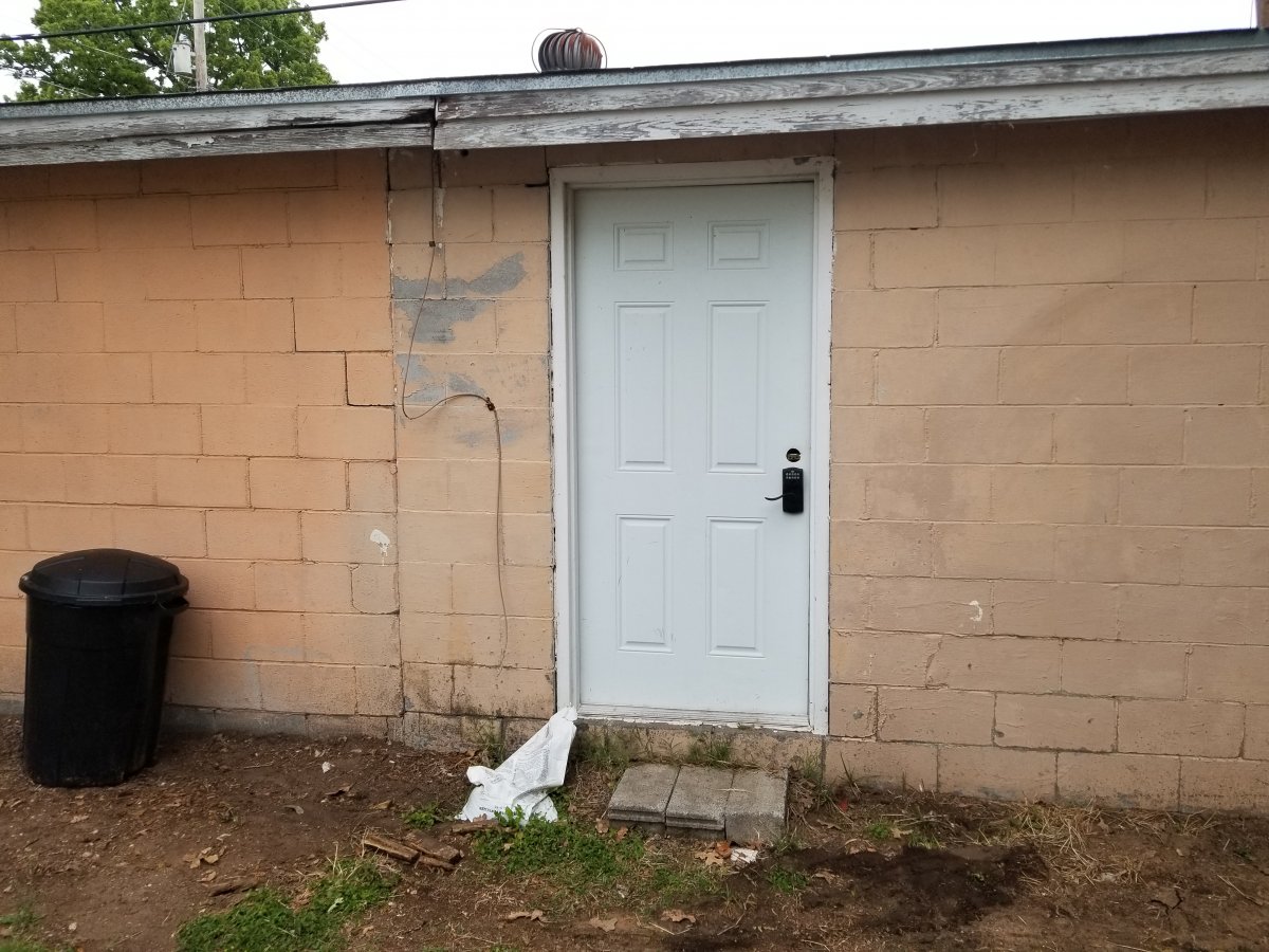

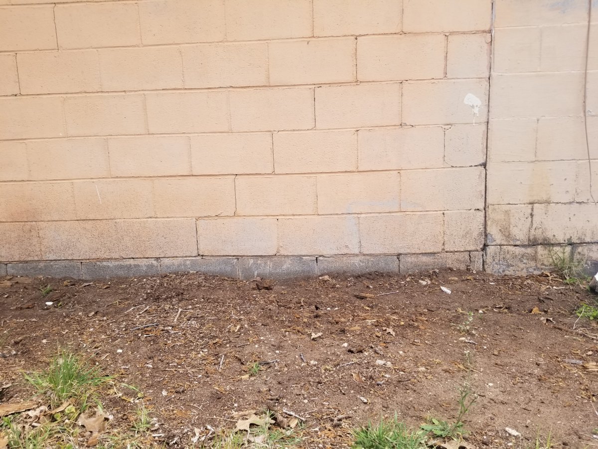

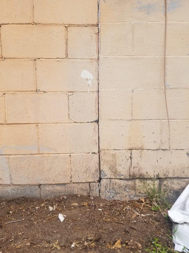

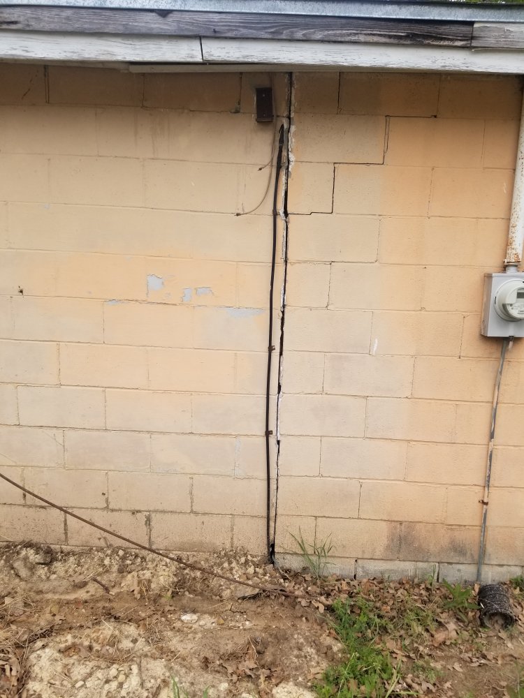

The walls where the original building and addition meet are messed up.
Alley side (original building to the right):
Opposite (house) side (original building to the left):

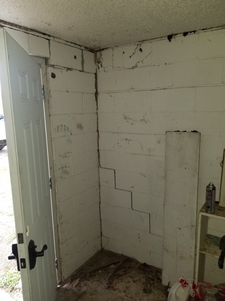

Inside side door:

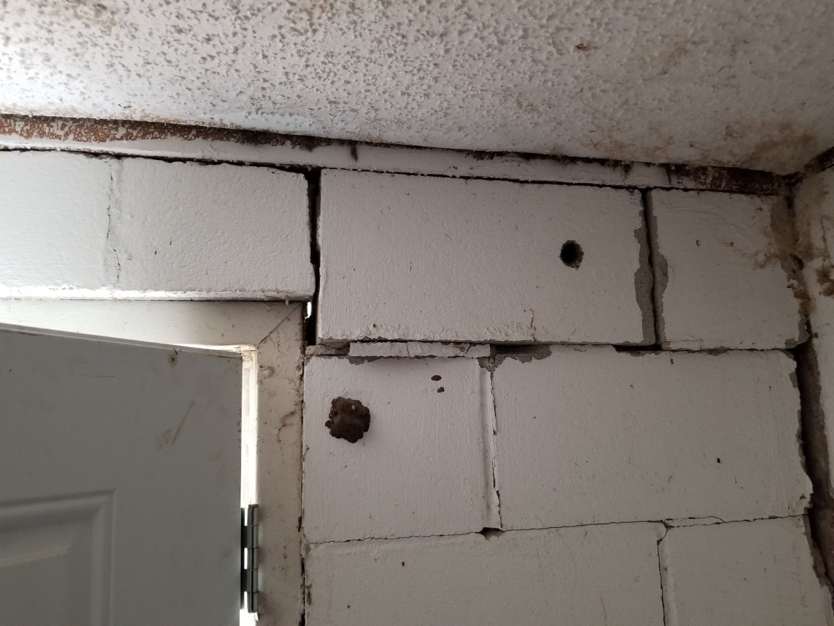

The door doesn't have any kind of header:

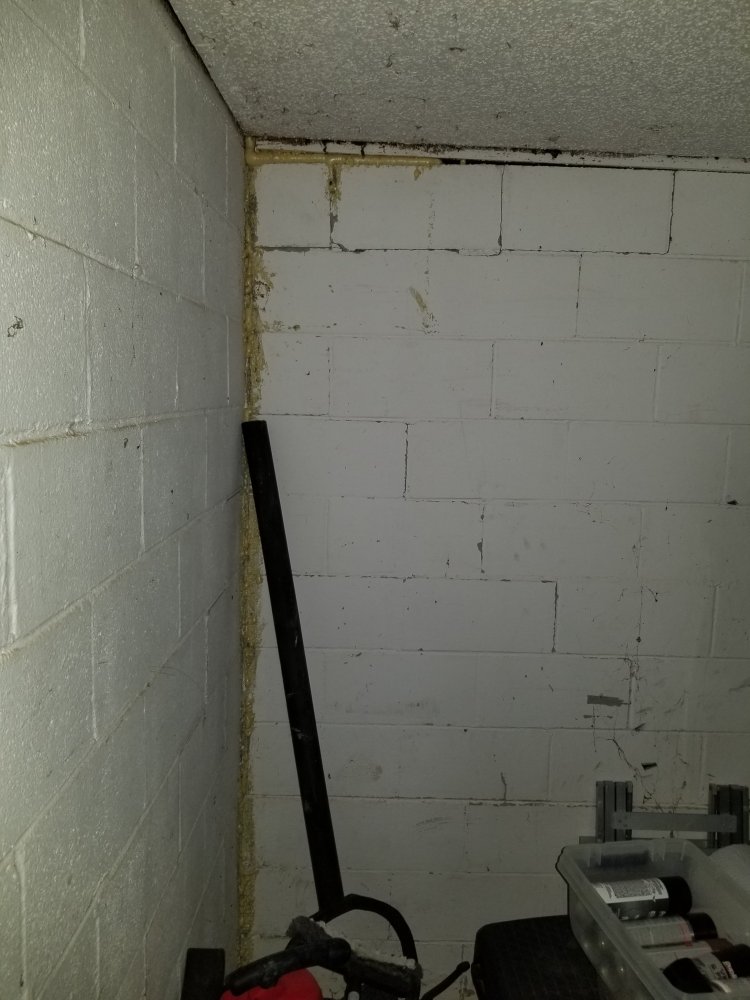

This is the inside corner where the old and new building meets on the alley side. Someone filled in the separation with spray foam.
58900
This looks like it's sagging (original building house side):
58901
The wall to the left of the door has pushed out:
58904
58905
That is a lot of issues... I would seriously consider a partial demo on that area and integrate a new pole barn into the better part of the building.
You are going to shell our some serious cash keeping that building together...
AJ
Now now fellas, don’t scare the man!!
From all the pictures you sent before and now, it’s obvious to me that the front half has been there for dozens and dozens of years, and the addition has also been there a long time. To me it looks like the addition foundation preparation was not as good as it could be. Now having said that, the stairstep cracks diagonally up the block are not that big a deal. If those buildings have been sitting there for decades, And that’s all the cracking you have, that’s not bad. If you had a serious foundation problem, those cracks would be big enough for you to put your fist through them. It’s very common in residential masonry and I wouldn’t lose any sleep over it.
What you have to look for is down along the floor. You’re looking for horizontal cracks in the blocks or in the first level above the floor in the mortar. If you find any, are they on the inside and on the outside, and is one of those cracks much wider than the other crack. That would be the indication that the wall is tilting. That is still completely manageable, but you may want to temporary support the walls as I described before when you pull the roof off.
The other thing you want to look for is cracks in the floor on the inside, but specifically cracks that run along the wall where the foundation may have cracked and the wall is tilting out. All concrete will crack, and diagonal cracks or cracks across the floor are no big deal. But if you have a crack that runs along the wall, again, you could probably figure out if the wall would be tilting in or tilting out. But it’s still not that big a deal, it’s just something you have to be aware of and manage it when you do your remodel.
While I’m thinking about it, if you do any kind of addition that butts up against the existing slab, get a hammer drill and drill about 18 inches laterally into the side of the existing slab every so many feet (I’ll know the distance when we know the plan) and have that rebar extend into the new slab pour. That will keep the slabs level if there’s any settlement in either foundation.
The stairstep cracks could also be a result of the foundation not being deep enough, not being below the frost line. So when you get extreme cold and the water freezes in the soil, it can push the floor up a little or actually tilt the wall a little. But if it hasn’t fallen down in all this time, if you’re careful, you shouldn’t have any worries.
And things like no header over the door, that just goes on the list of things to do when you buy materials and you actually do the work. Are there headers above the double doors on the alley side? Are there headers above the window and the door on the street side? Again, easy to fix, and actually fix correctly, when you do the rest of the work.

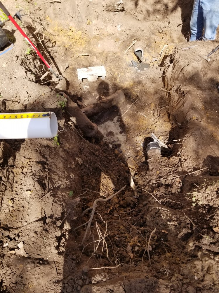

The sewer line runs under that addition. A plumber dug up the line and replaced 5 or 6 feet of it because a section was cracked and began leaking when they uncovered it. More importantly they were trying to figure out why there was water standing in the line. When they broke the line open crap started pouring out. The plumber was concerned that the building may have settled and flattened out the sewer line making it lose its slope. All is good for now.
Is that sewer line for the crapper in that building or for the house too? If it’s the house too, now would be the time to address it if you’re concerned (water shouldn’t be standing still in the pipe!). That’s a pretty easy job too.

Here's a pic of the new piece going in the sewer line:
58914

I think one of my biggest questions is how do I fix the walls in this building? How do I either raise them back up and close the gap, or keep it from moving any further?
They’ve probably moved as far as they’re going to go. Might move a little during construction. Once everything is set, like I said, pressure wash, dry, and the structural caulk or epoxy. Then paint, trim.
