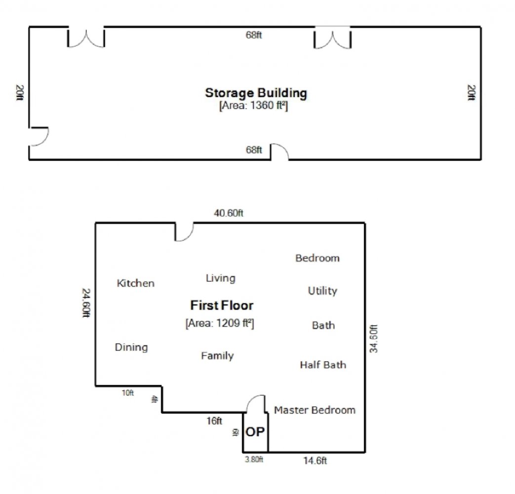

I'm finally closing on my house on Wednesday.
I don't think the ceiling in the 'storage' building is 8-feet. I'm hoping by summer I can find someone to raise the ceiling / roof and open up a wall and put in a garage door. It's a conder block building. I'm guessing they'll have to extend the wall height so I can get the ceiling height.

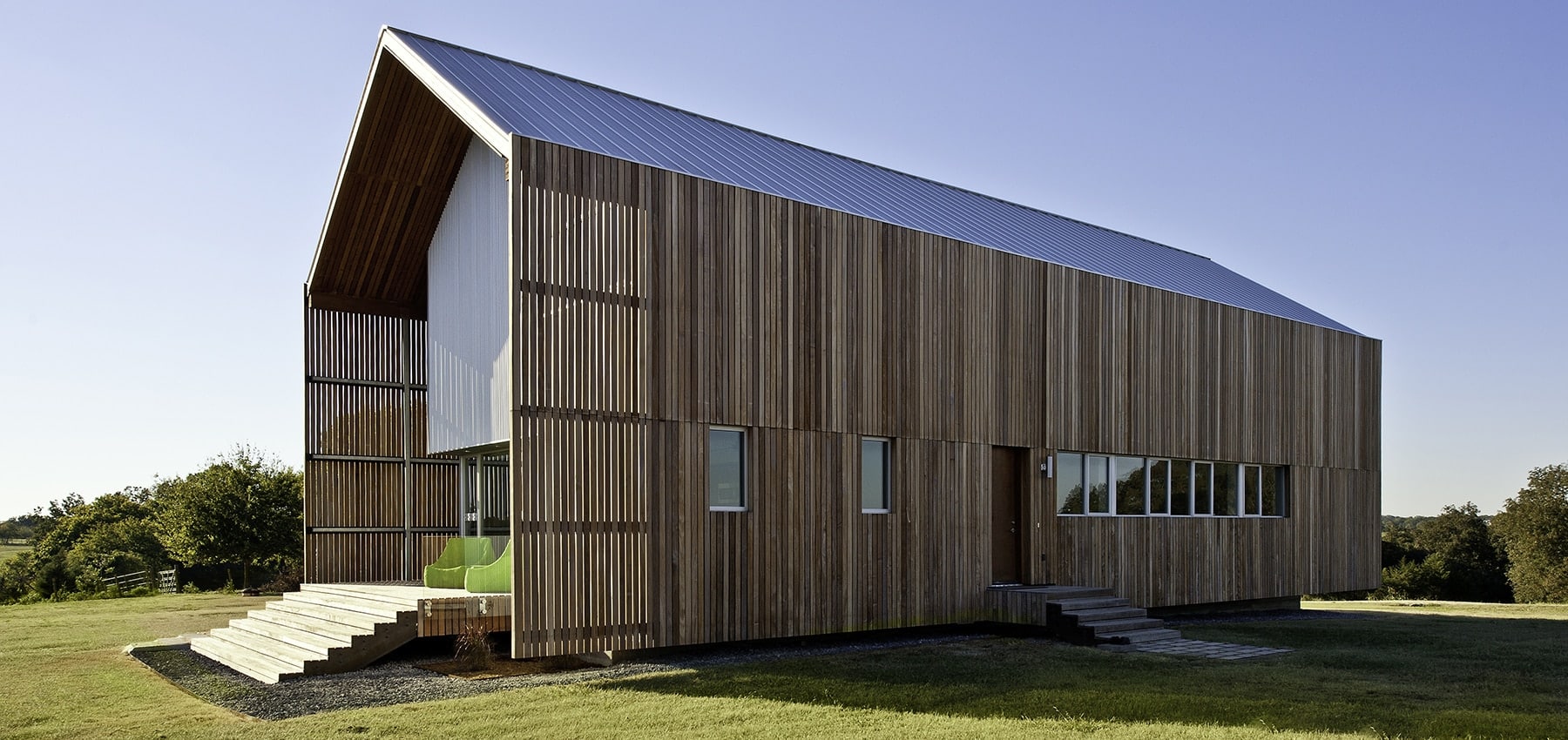

Theres a interesting place near my parents, Ive only drove by, never been inside but from the looks of things its a huge machine shed with a 2nd story. , Id guess 60x90. It looks like the bottom half is all machine shed/shop while the 2nd story is living space. Neat concept but Id wonder about diesel fumes creeping into the living area when a tractor is being ran.

First things first. Before proceeding with any modifications check out the foundation and the condition of the cinder block walls. You may be throwing good money after bad. As big as that tree is, and it's close proximity to the building, there may be issues.
Assuming everything checks out structurally, have you considered just raising the side wall / roof on just half the storage building?
I'd do that, discard the existing roof and trusses in that end and then install attic trusses in that area. That would give you a bunch of storage space. and the building would look oh so much nicer with a steeper pitched roof on the end also.
I'm also, curious if the building has trusses or rafters?

I noticed a spot where some of the block look like they're push out may an 1/8 inch. With the exception if some cracks in the mortar there, I'm guessing it can be fixed.
The ceiling is drywall so I have no idea what's up there. I had wondered if I could use a different rafter for more ceiling height or if it would be cheaper to frame in a short wall on top of the block wall and put the rafters on that. I've also considered adding a few courses of block on top of the old block, but not sure what would be the cheaper option.
I figured I'd get estimates in the spring. I just want to get an idea of what my options are.
