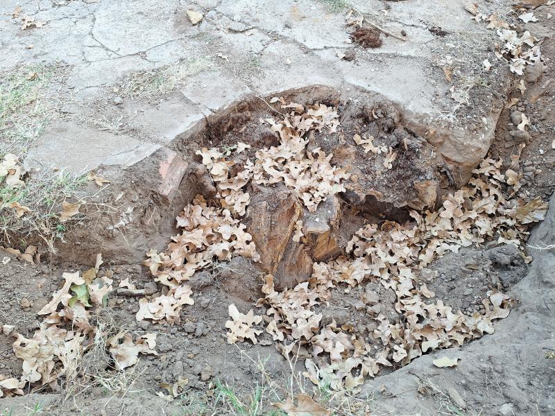

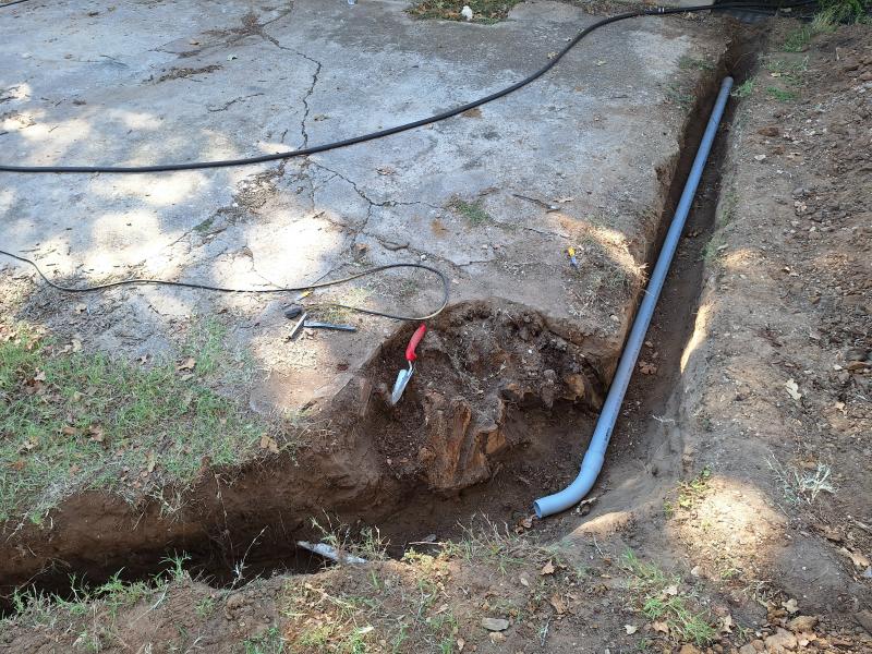

The Driveway Stump
Then we have the driveway stump.
The concrete had been poured on top of the stump. It actually butted right up against it.
My New House & Workshop

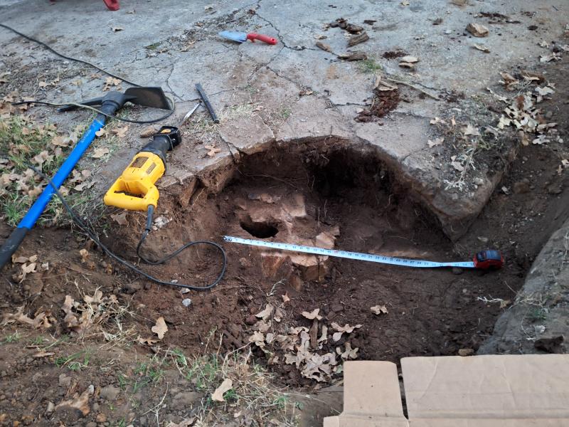

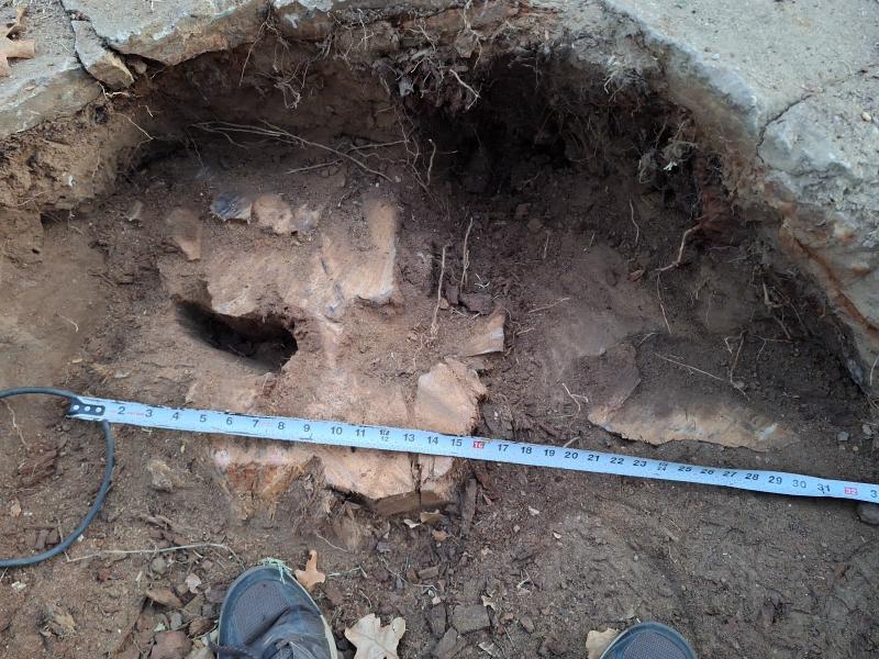

I got a blade for my Sawzall designed to actually cut up stumps and roots and was able to cut it down to about 7-1/2" to 8" below the concrete. I can't tell if it's two trees side by side but together they're close to 3-feet in width.
I think I've cut out as much as I can cut out. I'll never get it all out, so I don't see any reason to cut it down anymore. From here'll probably fill it in with stone. I'd like to fill it with stone and then cover it with 2-inches of concrete level with the concrete around it.

That was a bunch of work with a sawzall. Probably tje best, most economical tool for the job. Still, a lot of work.
All the stuff you did is great, first class. Congrats!

Feel ya on the stump. I cut out a 8" elm tree last year to put in a chain link gate and the stump was the worst part of putting in the entire fence. I think I went through 10+ sawzall blades and a couple chainsaw chains. There was a whole bunch of rocks embedded in the roots and eventually I just got frustrated once I got it cut down to about 8" below the ground and buried the rest of it.
My luck it will probably sprout a new tree at some point. I hate elm trees.

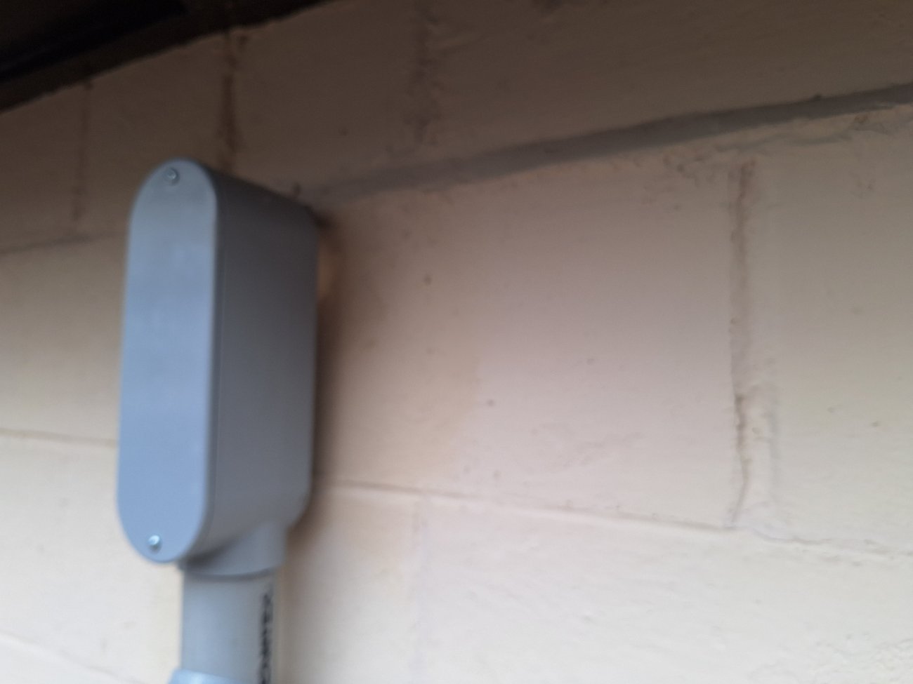

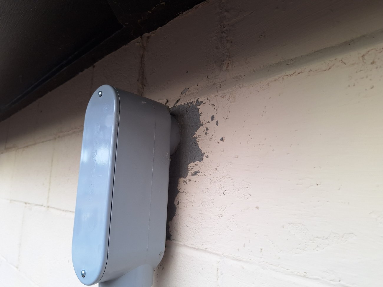

I filled the void with expanding spray foam, left anout a 1/4" between the foam and the facw of the brick, and then went around it with Sika Concrete Gap filler. It's in a tube for a caulk gun, comes with two clear tubes that screw onto it, and it mixes like JB Weld as it passes through the tube. This stuff sets fast. Like... you better be ready and know where you're putting it fast. The second tube is the 'you took to long and the first tube hardened up' tube.
I filled the void and spread it out with a putty knife. It's gritty and hard as cement. Strong stuff. After it dried I painted over it.

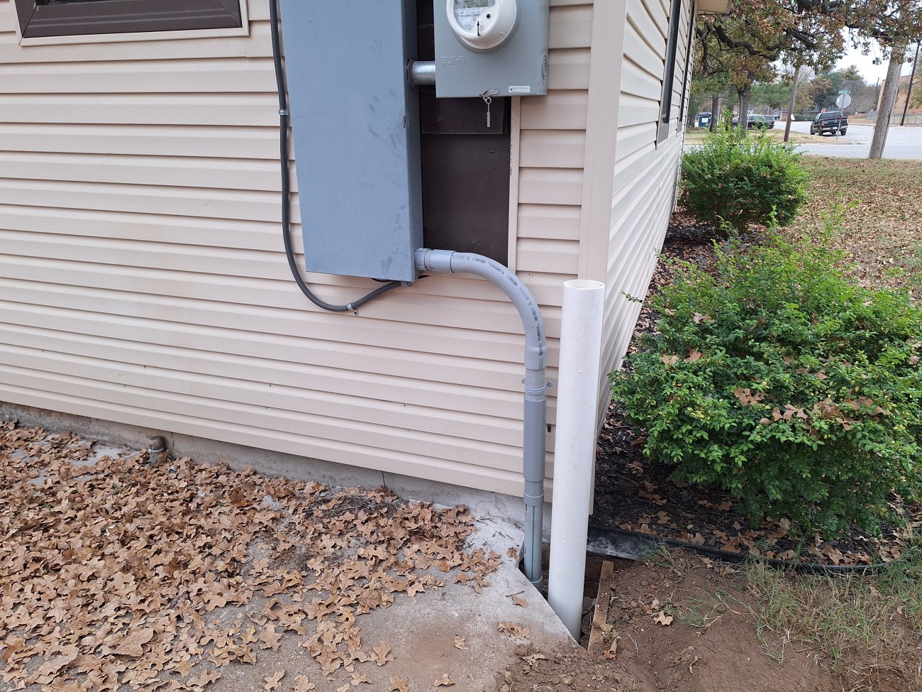

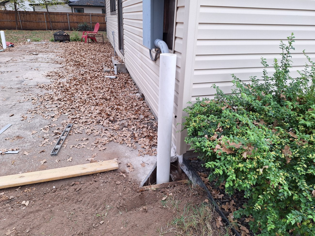

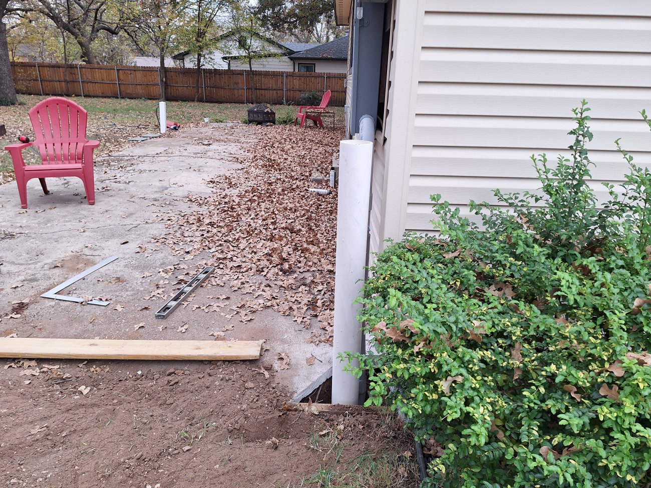

I decided to pass on making a bollard, then as I was walking through the shop, this piece of 4-inch PVC caught my attention.
Damn. Decisions.
Damn. Decisions.
Well, the crunch as you hit it would probably be enough to get you stopped in time.
I don't need it for me. I know I won't hit it, but you never know who's going to pull into your driveway at 4am.
