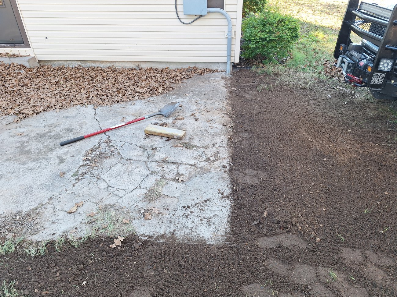

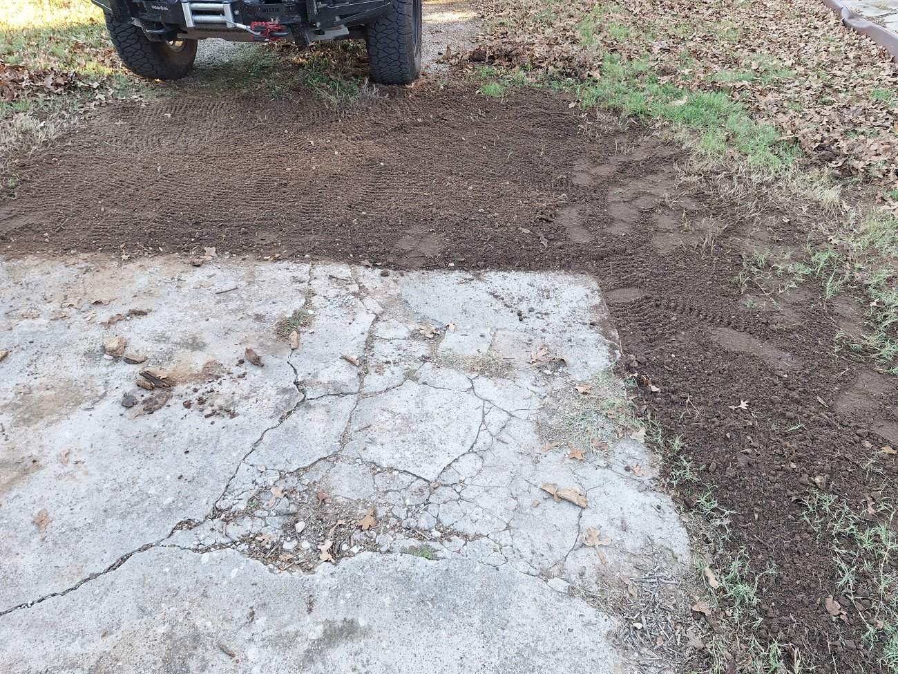

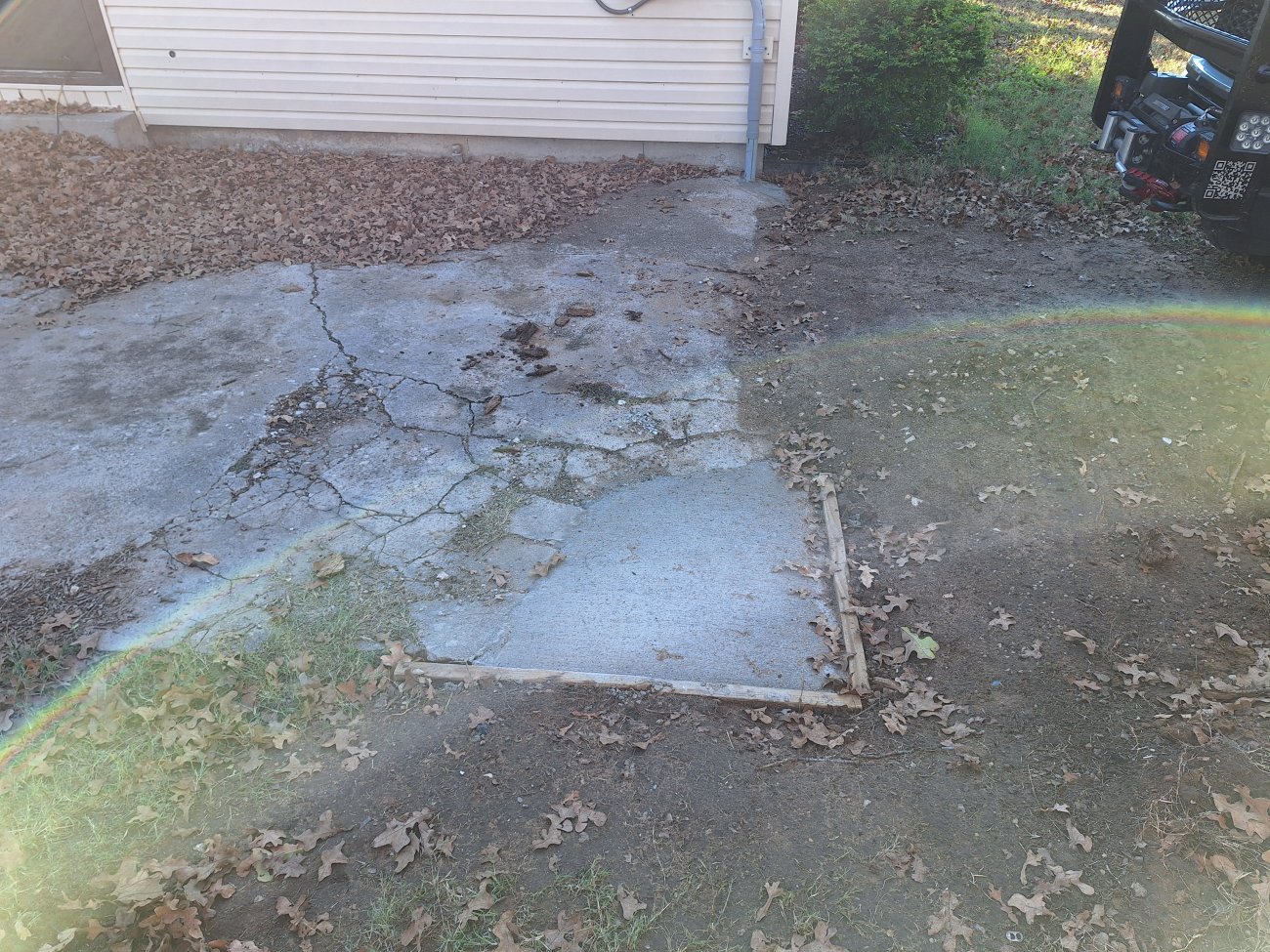

Seems crazy to fill this hole in with concrete when the concrete around it is so screwed up, but I just don't have the money to rip up the concrete around it this close to Christmas.
This whole corner is kind of sunken down. I wanted to make it level with the rest of the concrete, but then it would have stuck up to high.
Maybe I'll dig up the other broken sections next year. Reminds me of a highway job where they cut up and repair the bad sections before pouring a new road surface over it.
The concrete's only 2-3 inches thick. I dug that hole 18-inches down and left an 8-inch space between the top of the stump and the bottom of the old concrete. I put in a layer of broken concrete at the bottom, then gravel, and then topped it with 4-inches of concrete. The bags of concrete that went in that hole weighed more than I do.

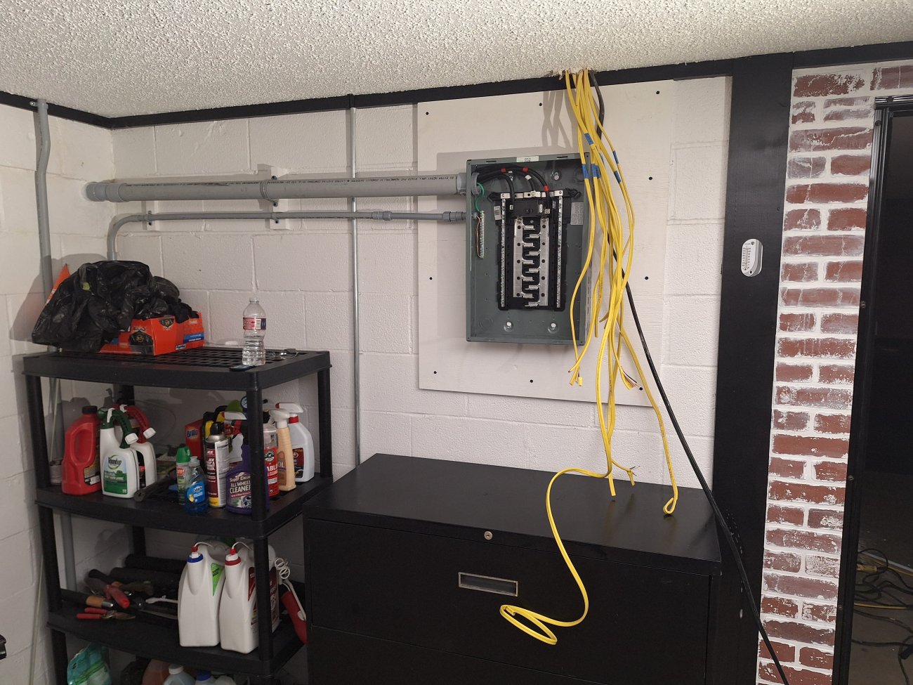

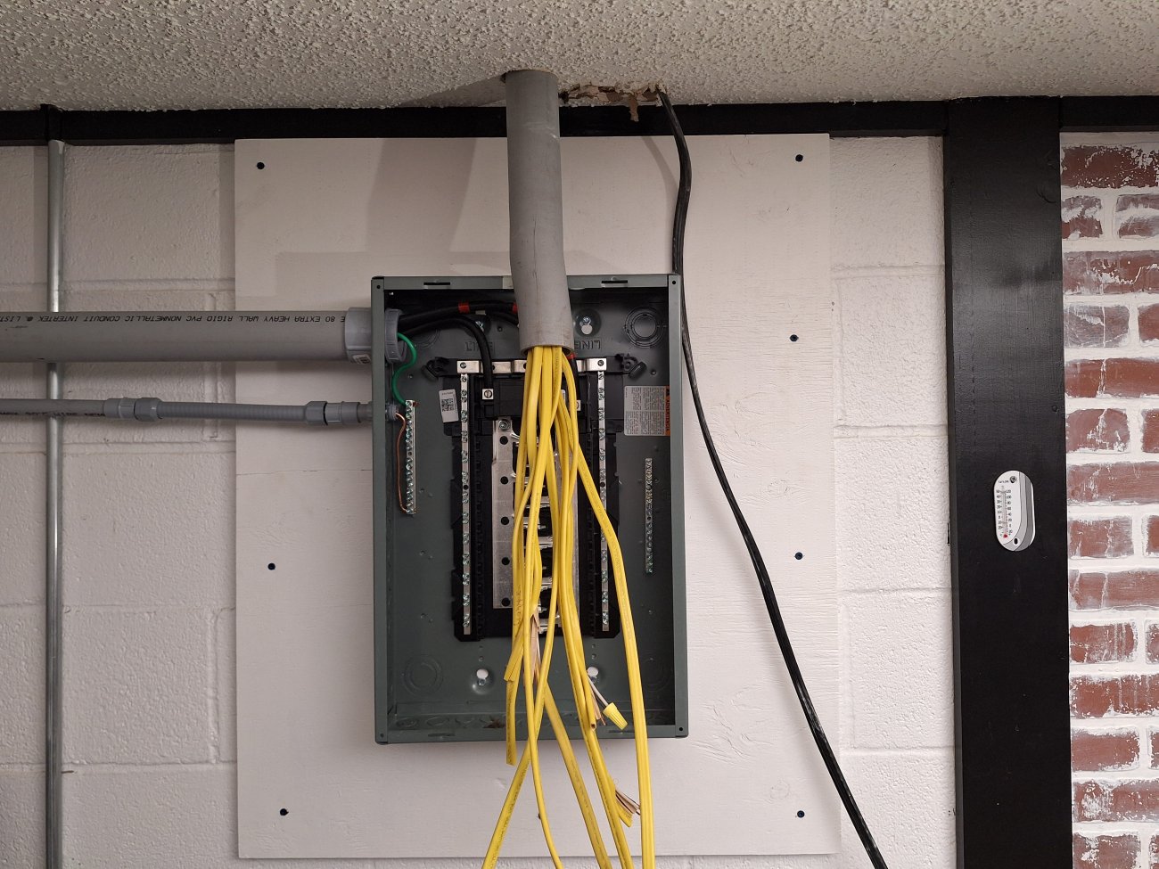

Do you have any short pieces of 2 inch left over? Technically, you should not have any exposed romex inside the building, especially a garage. You could run a short piece of 2 inch from the panel up through the ceiling and try to fish those wires through it. Or 2 pieces of conduit. Problem is, your panel probably only has one large knock out in the top middle.
You could even take two 1x2's or something and screw them to the wall above the panel, and then screw a piece of plywood or luan over them, or even a piece of sheetmetal, and put the wires in that. Just something to cover them over. If you did that, you could punch the individual knock outs out of the top and use individual romex connectors for the wires.

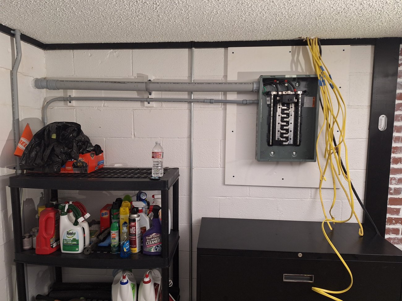

Ya, I've been working out how I'm going to do this.
The panel has plenty of knockouts on top along with a big one in the middle
First I was going to use some 3/4" conduit and have about 6 of them running between the box and the ceiling, but I have to move away from the wall because the conduit will run into a ceiling joist.
Then I decided to use a section of 2-inch PVC from the middle that will clear the joist in the ceiling. I wish I had put that 2-inch in before securing the panel. I have to make the hole bigger. It hits the joist when I stick it up in there at an angle.
I guess I could cut the conduit in 1/2, stick 1/2 up through the hole, and then drop it down into a coupling to connect them.
The conduit is 15-inches long, and I currently have (9) 12/2 runs in there. From what I figured out, the limit is (8). However, since the conduit is less than 24-inches, the nipple rule says I can go 60% instead of 40% and run (12).
Or.... I could remove the jacket from the wire and be fine in any of those requirements.
The black wire is 8/2 for the thankless water heater. Not sure yet if there's room in the 2-inch conduit if I get rid of the 12/2 wire jacket. If not I'll stick it in some 3/4" conduit.
Once this is all done I'm going to have to repair my ceiling where I originally pulled the wire through.
Stripping the covering on the romex would give you plenty of space like you said. But that covering is a excellent place to mark the circuits on the wire using a sharpie. If you stripe the covering off you will have to mark all the wires somehow, and since you are going to use ground fault breakers you can't let the white wires get mixed up either, they have to be kept with their black wire.
Ya, all of my romex is labeled. if you go up in the ceiling access where the junction boxes are the wires going in and out are labeled.
If I strip the covering off I'll do them one by one. Tape them together with some electrical tape so I can keep them sorted, and put some painters tape on the ends with the runs labeled so I know what is what.

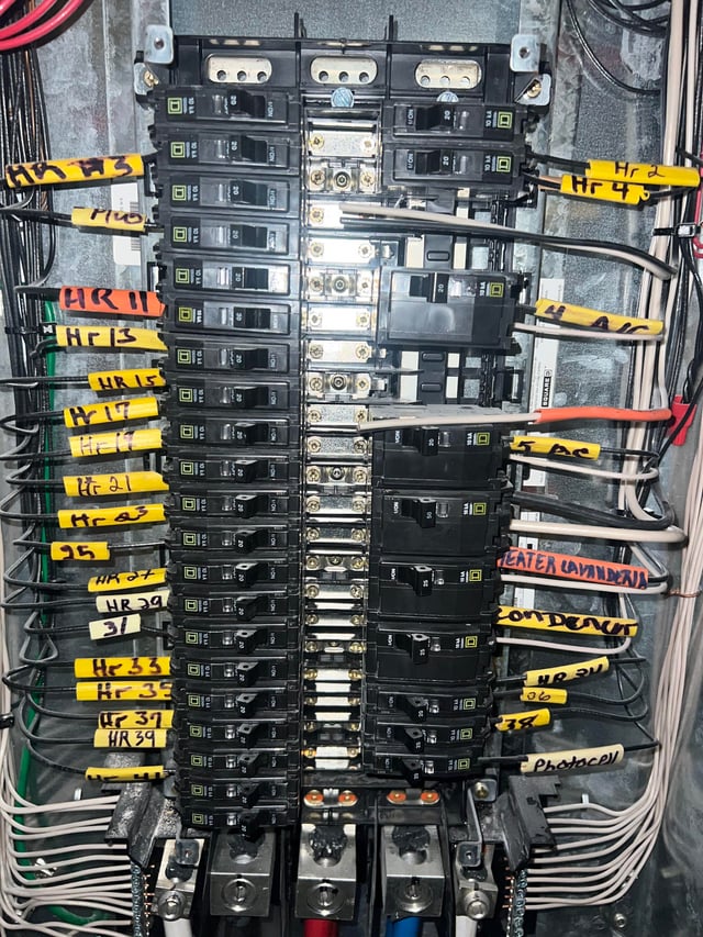

Jim, a handy thing that many electricians do these days is to use a bit of the romex sheath with the circuit written on it. Without me getting verbose, see photo below.
My New House & Workshop
To get your panel looking neat like that takes a lot of practice and planning on what circuit are going to go to what breaker. I am not very good at it, but a guy I work with is. He even has tricks to make the wire very straight before he bends it into the nice neat square corners.
Ok, I'm reading that I can't remove the jacket from the romex and run it through the conduit because the wires aren't individually marked. So, I guess I'm back to having the 9 runs coming through the 2-inch conduit using the nipple rule and I'll run the 8/2 through a section of 3/4".
You CAN strip the sheath from the romex and run the wires through a conduit. But you must use a romex clamp to fasten them where they enter the conduits. I've done it many times. Conduit fill and conductor derating rules still apply.
