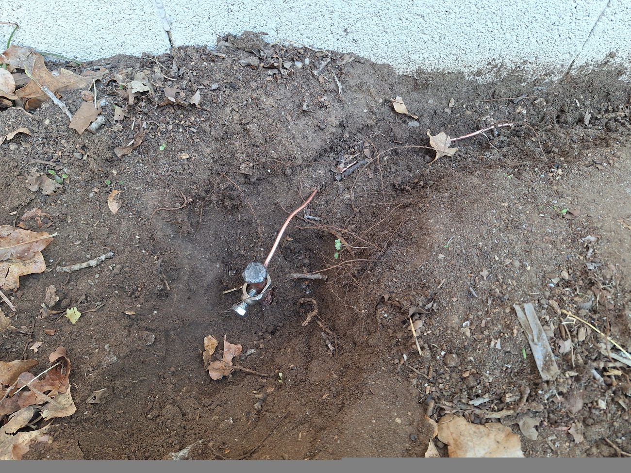

I'm happy to report that I broke out the Jimmy Hammer (step aside Jack) and finished driving the ground rod. Good thing I slid the clamp on when I started. The top is all mushroomed out. The ground rod is all covered up with dirt now. No, it's not a mound.
I feel like I earned my Electricians Ground Rod Badge. In my mind it's a copper bar with a lightning bolt in the middle.

I dislike, despise, loathe, hate, detest and abhor driving ground rods. I never bought a good hammer drill with "hammer only" mode. So I never had an easy ground rod exceot one time. That was in sandy soil and I had to drive 2 of them. I pushed the first one almost 3 feet into the ground with my hands before picking up the hammer.

Here in TN we can just throw the ground rod in the ditch haha. While the ditch is dug we would run our ground line and attach it to the rod then lay it in the ditch. Inspector never said a word. Actually one of them laughed and said " well code dont say horizontal or vertical." Just say 6 ft rod buried.
That's genius. Where were you two days ago???
It's not allowed everywhere. Getting the rod deep into undisturbed soil gets a better "connection" to ground. Think of ot as a tighter, cleaner connection wuth less resistance.
