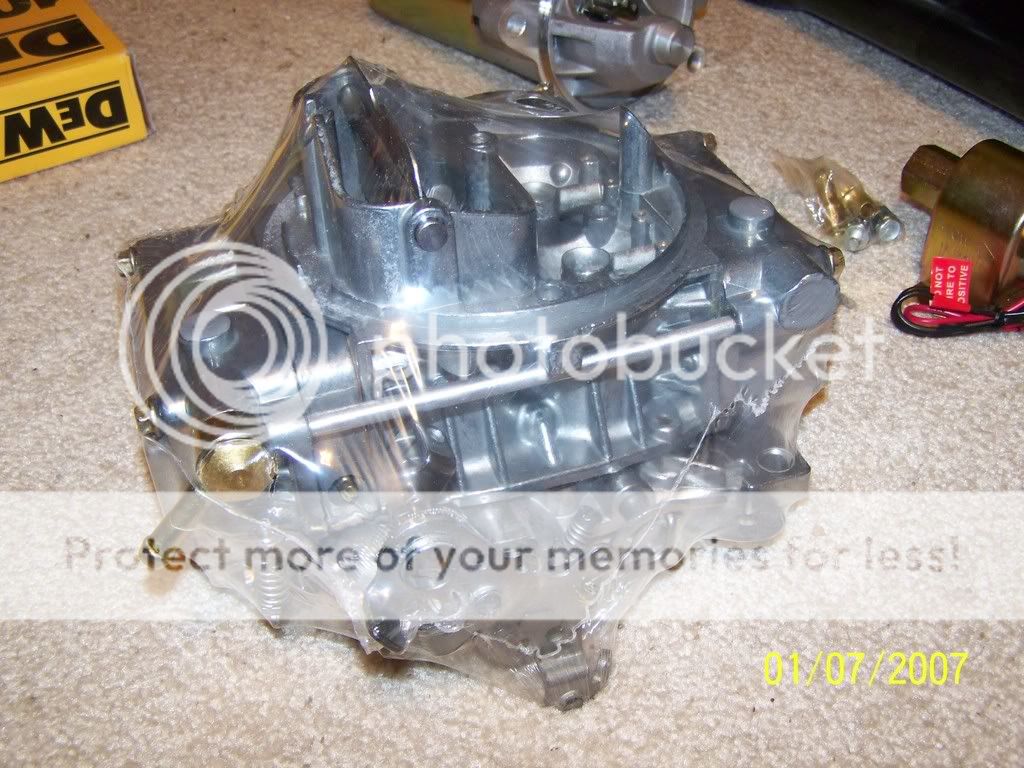

Tri-Y headers, electric fuel pump, ac delete kit chrome, power steering bracket billet, 8mm accel wires, mini hi-torque starter, ignition box for my duraspark dist, carb, and alternator

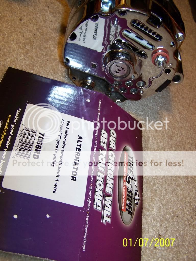

my chrome Tuff Stuff alternator, 100 amp 1 wire :) :) :)

Holley 600 4bbl carb :)

i also have valve covers chrome ordered, altrenator bracket chrome ordered, ignition coil chrome, and a chrome fuel pump block off plate. the only things i still need is a 16" electric fan and an oil filter relocator kit
One problem I see you headed for is all the accessory brackets you've bought. The A/C delete is for a serpentine system. Not sure about that P/S bracket. The Alternator bracket I linked you too was for a V belt. But if it all doesn't work, don't feel like the Lone Ranger. We've all been thru that. It's part of the process. Kinda the reason I advised you to pick an application a few posts back (or was it on RPS?) and stick to it.
i know, i ordered the alt bracket yesterday, thats why i never ordered one. well and i knew that the ps pump bracket wouldnt work you told me so, but i didtn think that the ac delete bracket mattered, well ill make my own if i have to

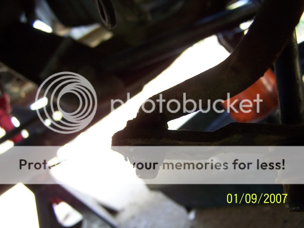

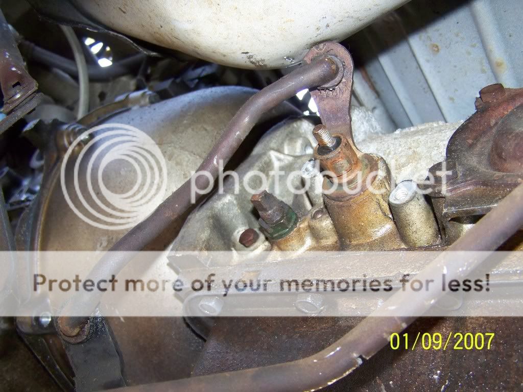

how do the links come apart? the dont have nuts on the backside... it looks like they press together, and they have like a rubber peice on the back where one link goes through the other
EDIT: this is all thats holding me up!!!!!!!!!!!!!!!!!!!!!!!!!

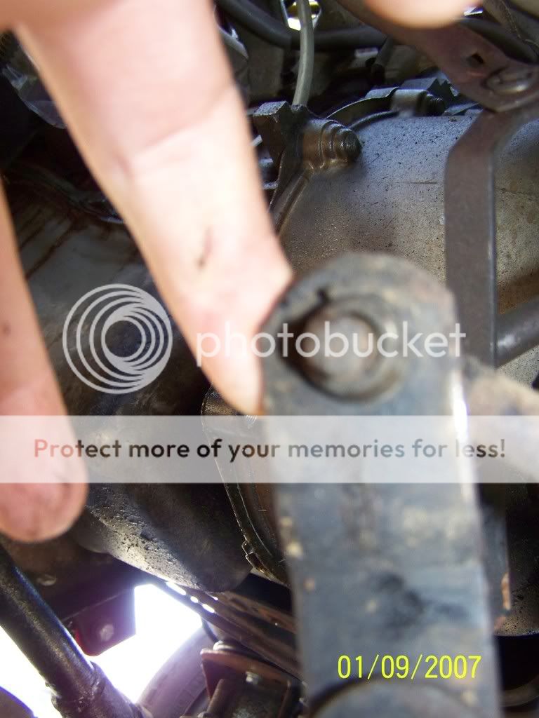

heres how they connect together
My motor swap
i didnt know it come out blurry my bad, but its not a nut

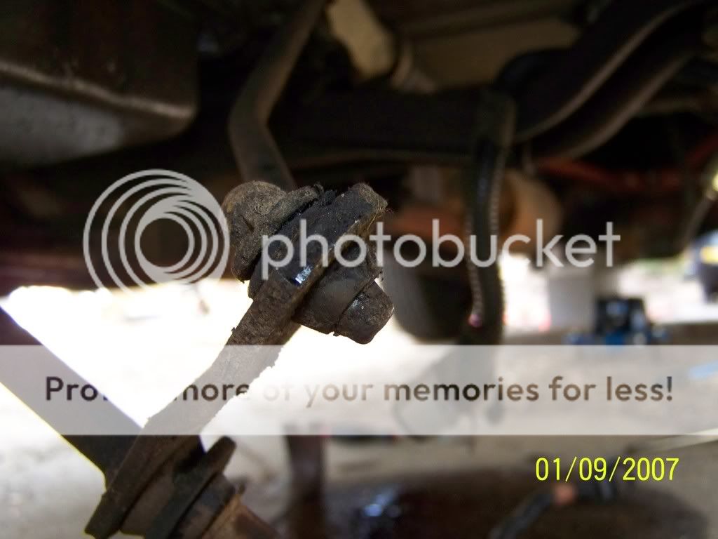

heres a great pic
My motor swap
if i get this one off, i can pull the motor

shot of wd-40 and pry it apart.
its a press fit into the plastic bushing
hmm ok cool deal. well i started to pry on the last one i had, the one above the neutral safety switch, and the bracket coming off the tranny broke, so i can take the motor and tranny out now.
