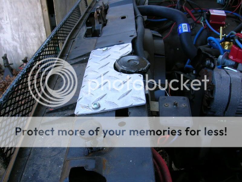

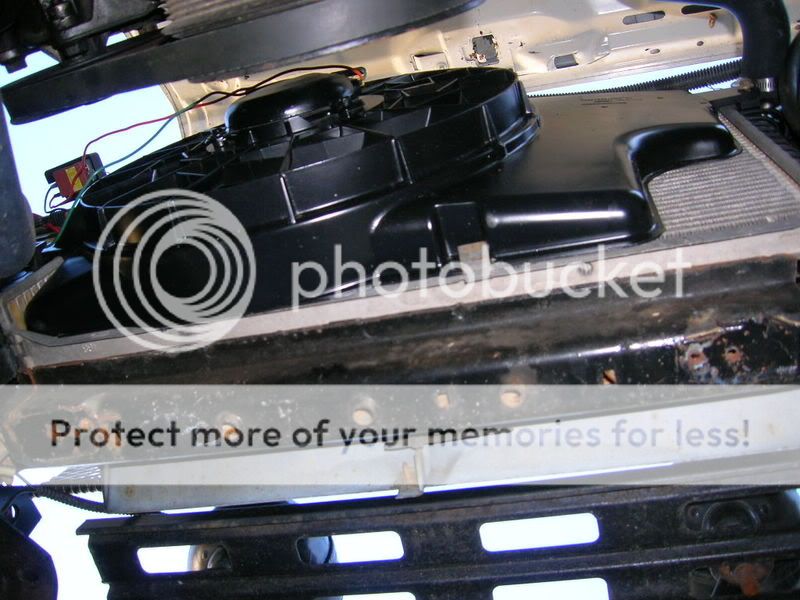

i used the serp belt setup from a crown vic.
My motor swap
My motor swap
My motor swap
My motor swap
My motor swap
I used the same setup from an 88 Vic. Only thing that's needed to make it all work is lengthening the alternator wirng.
Why not run a Holley 300 carb?? Looks like your makin' progress tho!
well i already have the v-belt pulleys. but how could i tighten the belt from the ps pump to the crank? the one for the alt, crank, and waterpump it will have a tension thing on my alt bracket...
