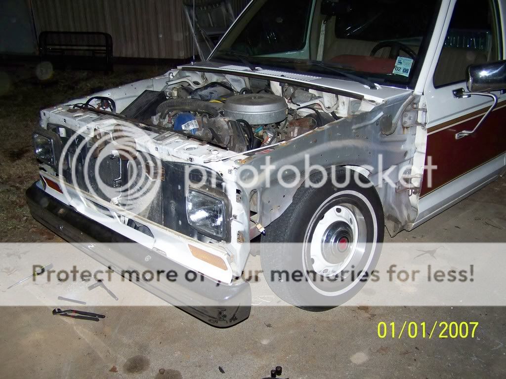

anyone? im looking to order the carb tomorrow. i oulled all the front sheetmetal tonight, gonna try and pull the motor and tranny tomorrow

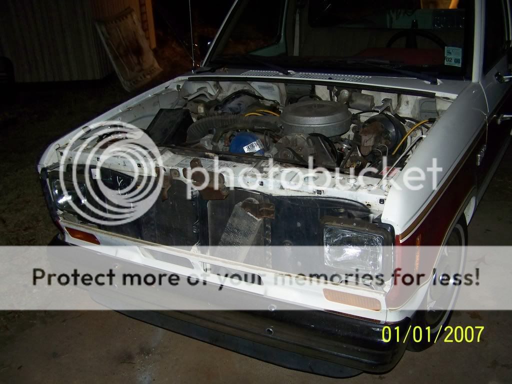

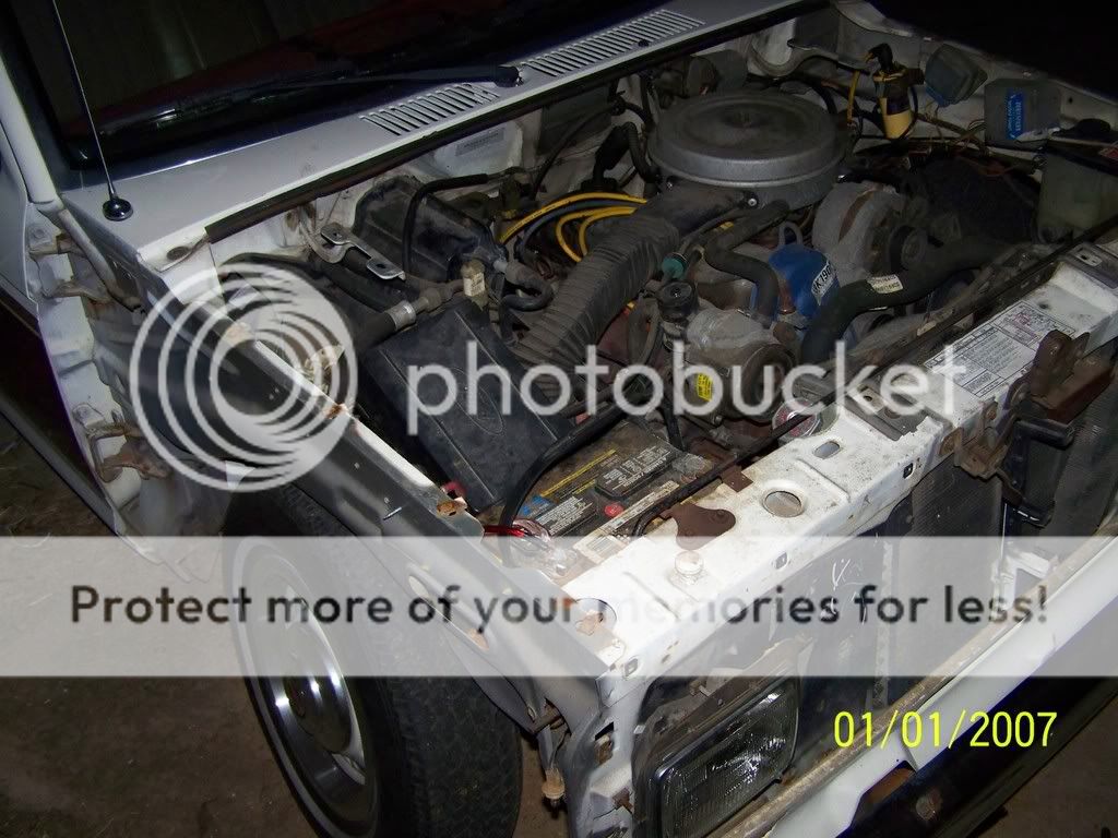

well the teardown begins!

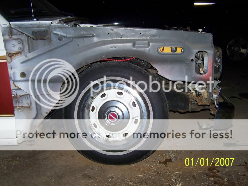

Are you taking out the rad. support? If not you did'nt need to take that other stuff off. IMO.
That support will come out if you drill out the spot welds, not hard at all.
I think he just pulled it to protect it while he is working on the truck.
well i was really doing it to pull everything off so id have ALOT of room. but to protect it also. i forgot that it was spot welded.
well i guess i can leave the core support in. i just need to figure out where to start and how to go about pulling this motor. i guess the 302 and tranny will go in with the support in

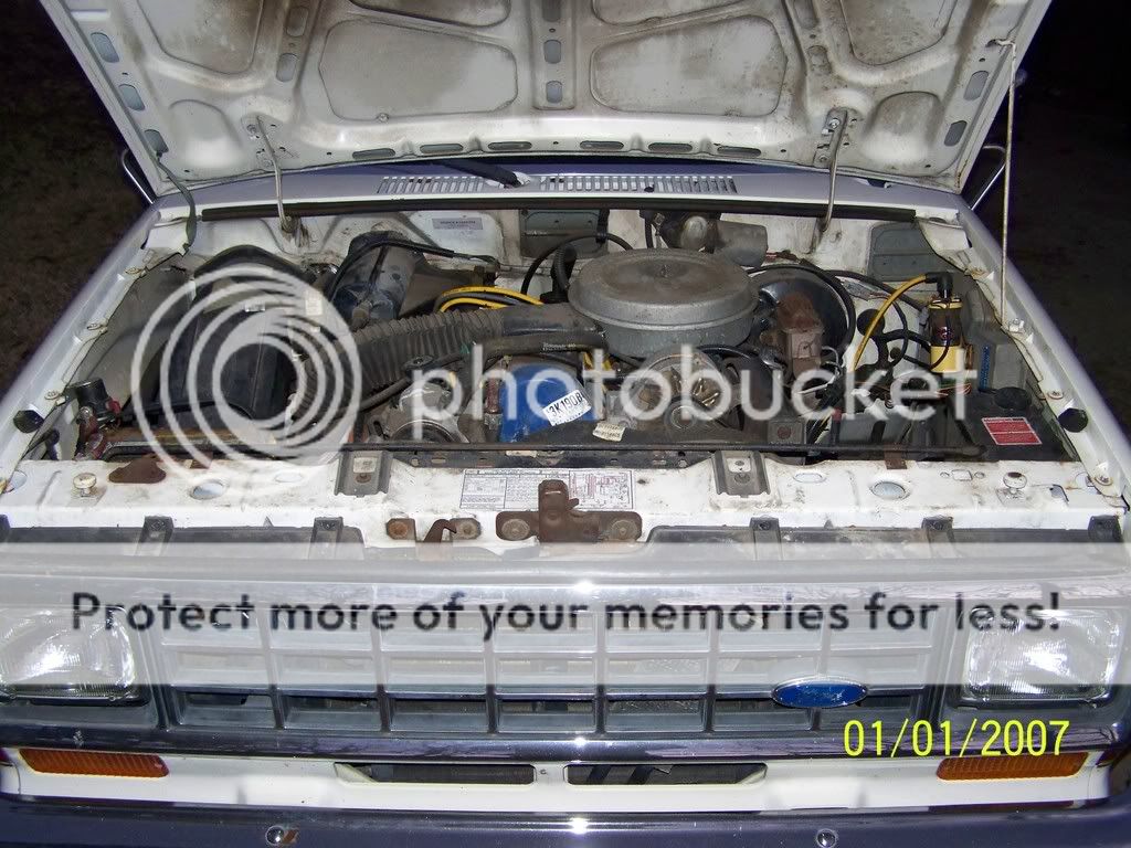

well now im off to start pulling some motor stuff. i guess ill start with the radiator, condenser, and stuff? work my way back?

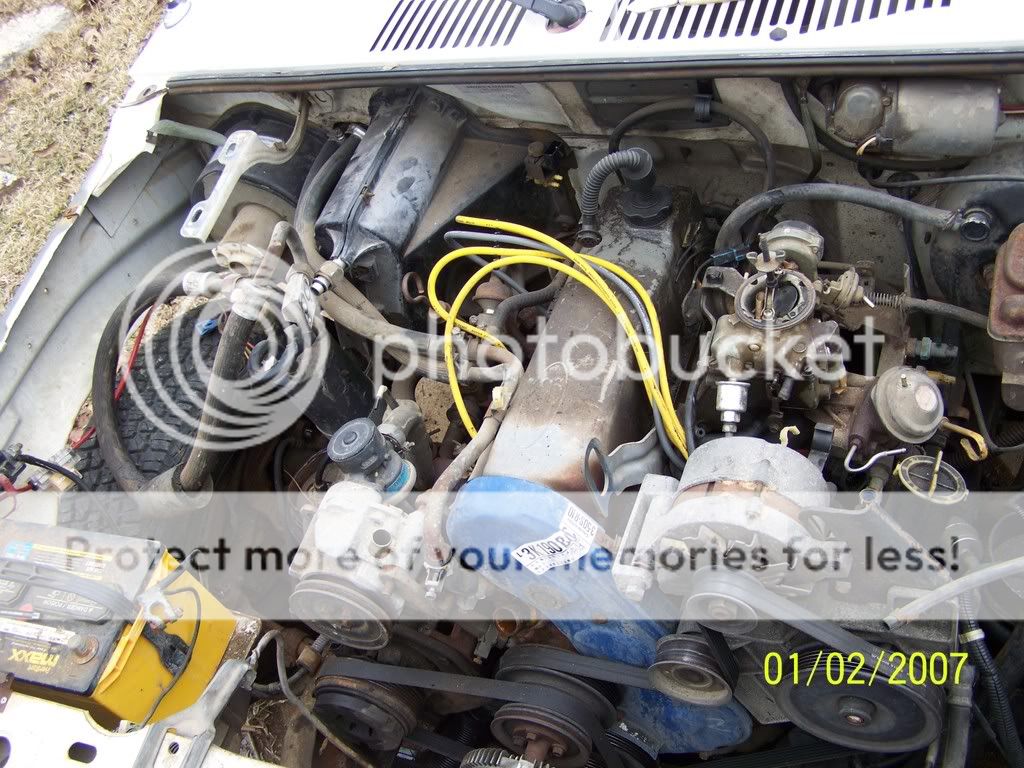

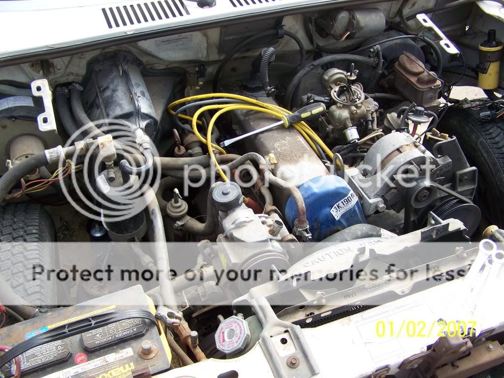

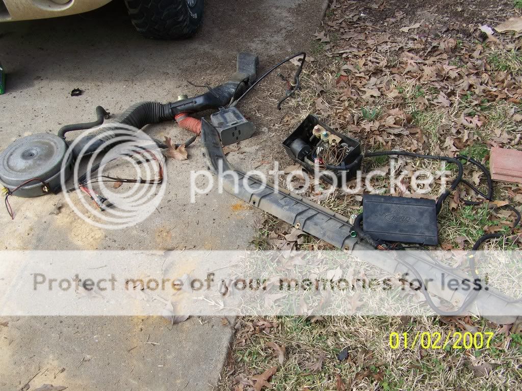

ok well i started by taking out that big OLE ugly smog box thing. you wanna talk about some vaccum lines? good god! i spent an hour taking out vaccum lines
heres a few

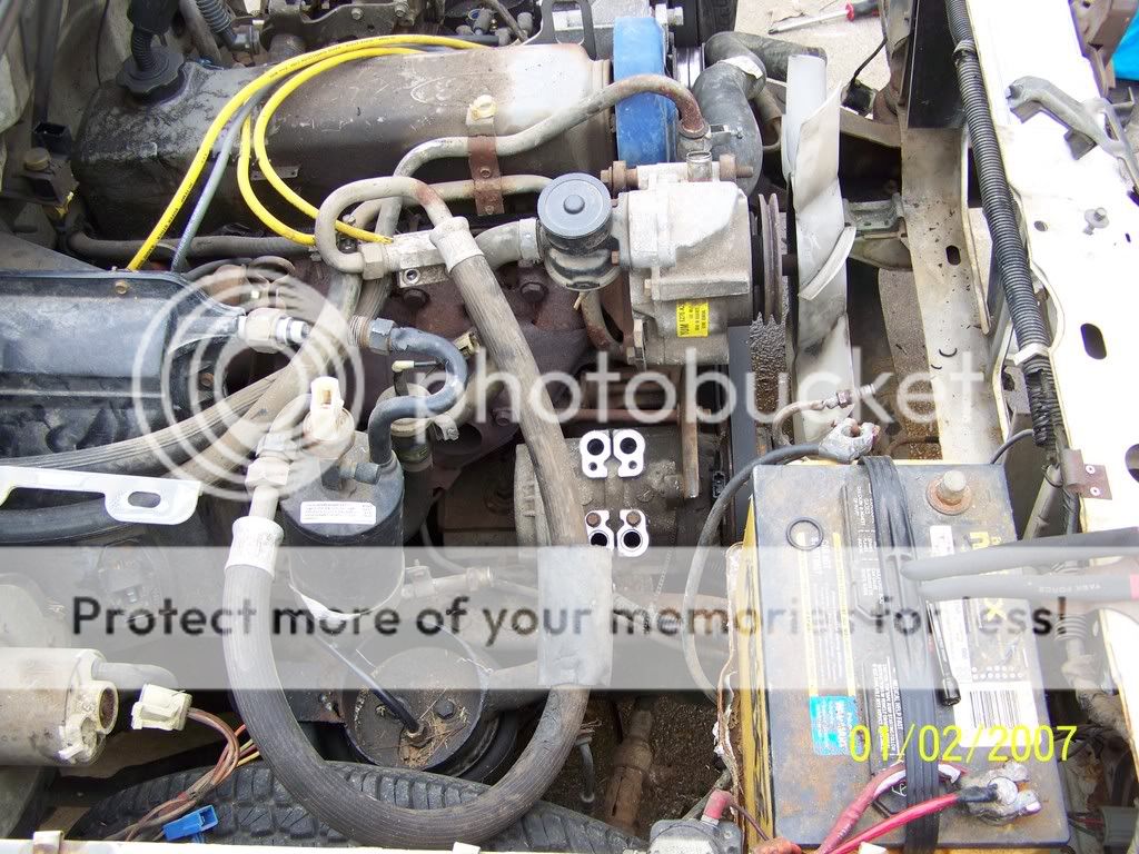

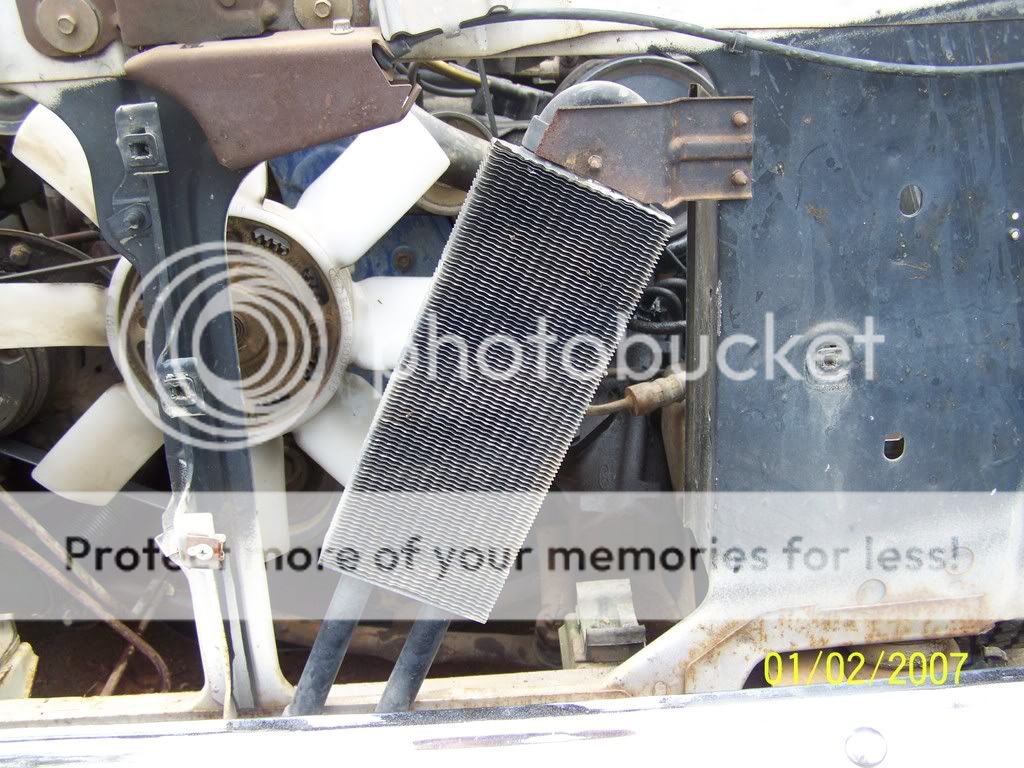

is this the transmission cooler? should i reuse this for the v8? or would the lines go to my new 4.0 radiator?
now i removed the ac accumulator i guess, took off a few other lines, these lines are STUCK STUCK! vaccum, heater hoses, smog hoses, any freakin hose is tight! i have busted all of my knuckles just taking hoses off

are ya'll reusing those top brackets for the radiator?

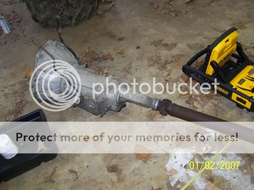

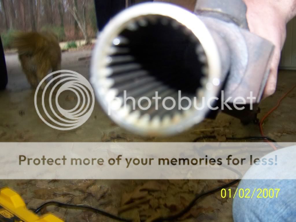

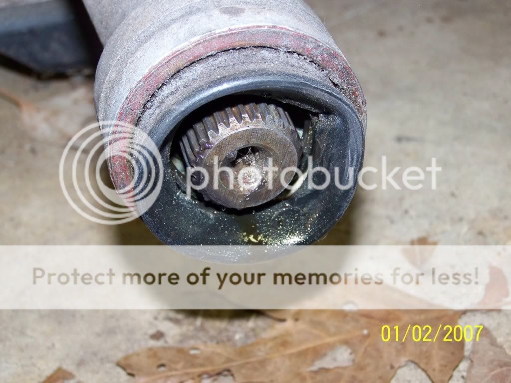

c4 tailshaft...

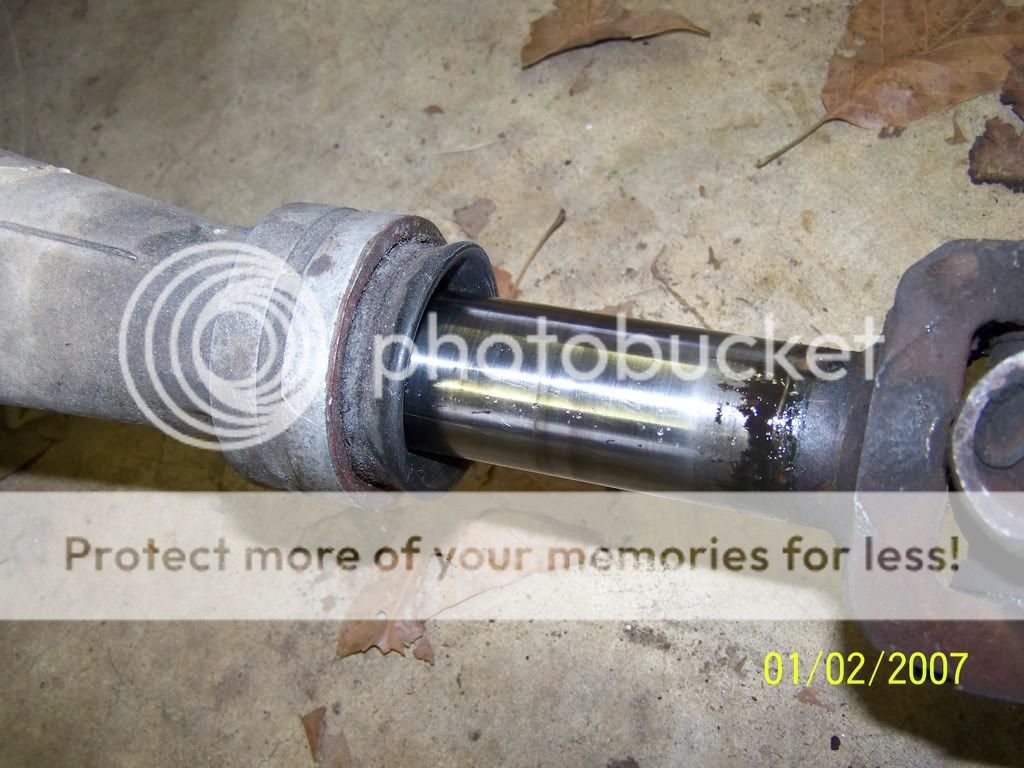

the yolk on my driveshaft... (dont mind my neighbors dog, i cant stand him! lol)
CRAPPPP!!!!!!!!!
JK it fits perfect! so whats this mean? does this help on know what kind of tranny it is?

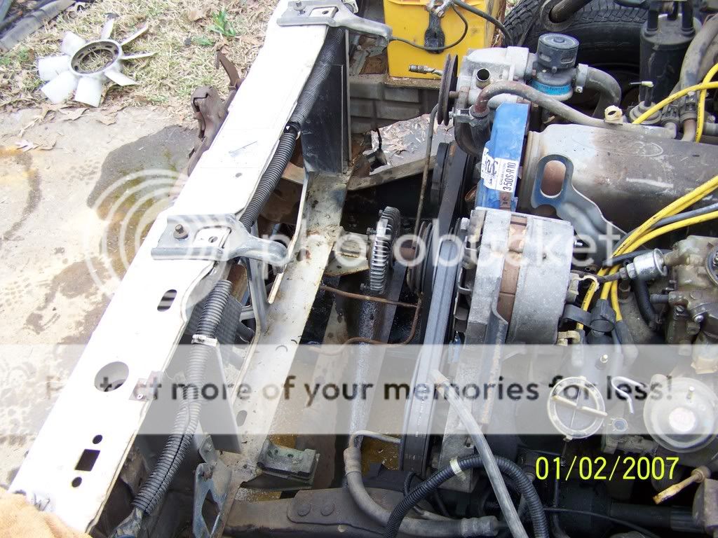

ok well i have the batter ground to the block off, power steering undone, heater hoses off, radiator out, starter wire off, vaccum off, electric wires.
now i have to unbolt the 2 tranny nuts, the 2 engine mounts, and the freakin exhaust! how do yall get these off? i was thinking about just cutting it.
anything else that i missed? i wanna see if theres something else i need to undo before i try and lift it

What carb did you go with. I use the auto lite 2 barrel that's on it. It has to be the best off road carb ever built. The damn thing will run on it's side. For a slammed truck I guess that's not so important.
The vacuum lines? Pull them all, You don't need them. On the new engine all you need is 1 for the carb., 1 for the brakes, 1 for the distributor and one to the tranny. The rest you can plug. Make sure you plug them or it will run like poo.
