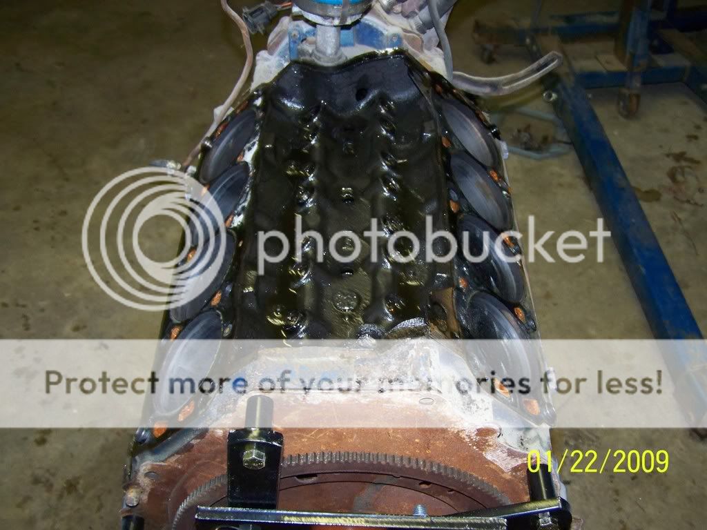

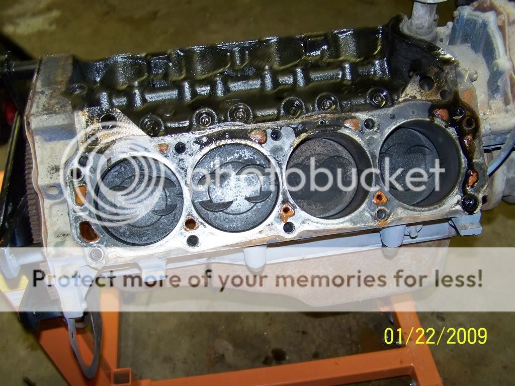

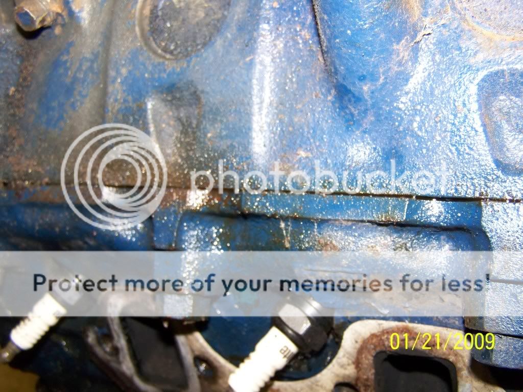

ok now i think the drivers side head gasket is leaking... look, its more than it was before

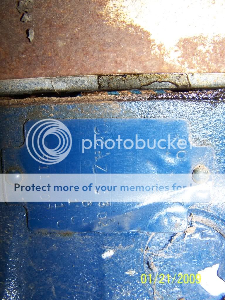

and i also tried to read some of this thing
it said Oklahoma something authorized remanufacturers. 302

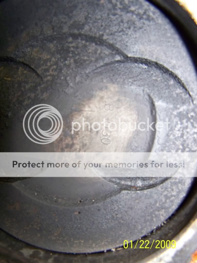

Looks like it has been rebuilt. It's been bored .03 over and the main and rod journals are both turned down .01

Nothing wrong with cast pistons. Unless you're gonna spray it, even then they'll hold up some time before you see a problem. Your tag tells me you've got a Fred Jones reman 302. They were Ford's authorized remanufacturer of motors and other parts for years. Their dealership is(or still was last time I was up there) downtown off I-40. Right next to the cotton oil mill.

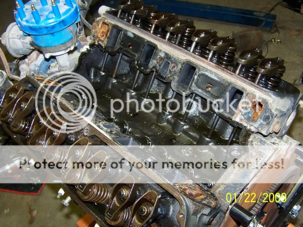

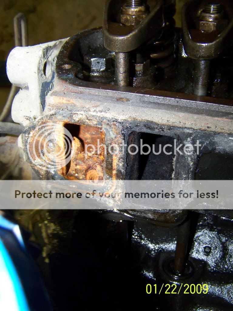

front water jacket

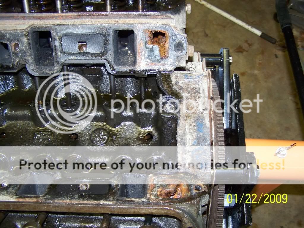

the intake

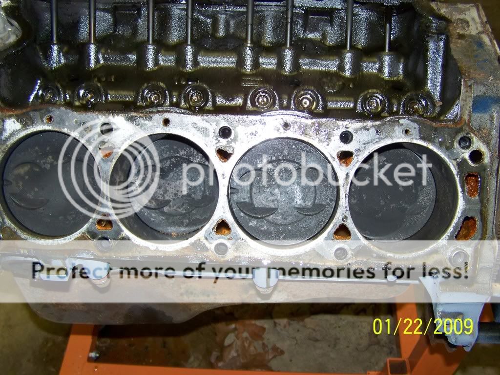

driver pistons

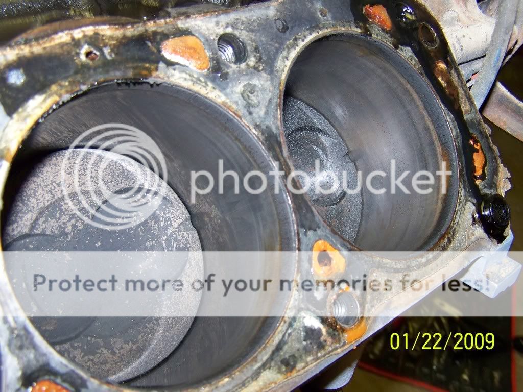

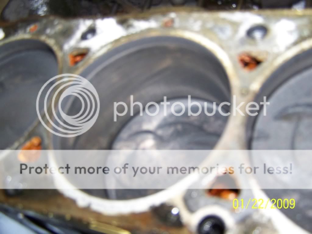

cylinder walls, sorry its blurry, that look clean. i just dont know what i can clean it all up with without hurting anything

B 030? bore .30?

why did u think your head gaskets are leaking?
well before i turned the motor over to take the oil pan off, it was leaking oil from the drivers side head, and besides, i can put them back on easily and torque them down correctly. isnt it good to make sure the gaskets are good?

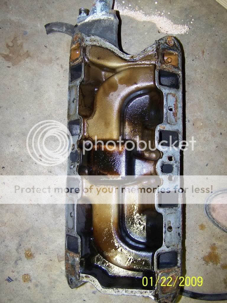

what can i clean all this with? carb cleaner? starter fluid?
water jackets look pretty rough.
this my opinion take it for what its worth.you have it down this far,go ahead and finish pulling it down, have the block dipped and get cam bearings installed,get a kit and rebuild it.
its money in the bank.
Use spray carb cleaner for the insides. The head to deck surfaces will need a stiff wire wheel on a drill to get the gasket residue off. Once that's all off, turn the block till the cylinders are facing down and flush the stuff that got into the bores and pistons with more spray carb cleaner. Then water. Blow dry it all. You'll need a case of cleaner to do all this. You may want to send the heads to a machineshop and have a valve job done to insure the valves will seat properly. The outside of the block can be cleaned with oven cleaner and water to rinse. Just be careful to not get that stuff anywhere near the pistons or in the crankcase.
Yes, that is what the tag had on it also.
