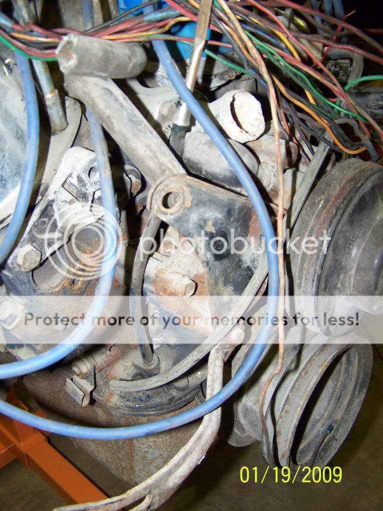

well i just looked at my timing cover and it goes through it. not directly into the pan. idk we will see when i pull it off

Just where else would the dip stick go but other than into the pan? Do you have any idea of what cam is in it? What heads? Pull a valve cover to check the casting numbers. Hard to tell just what you will have on a 40 year old motor. Yes a stock 289 will be slower than an equivalent 302 but will fast enough with that gearing. Find out what you really have before throwing money at it.
but 289's much slower than 302's? i know it depends on the mods... but this one isnt stock, not super modded either. mild. i just hope itll still be quick
That 289 has a front sump oil pan. That is the reason your dipstick goes through the timing cover to the front of the oil pan. You will not be able to use the pan in your ranger. As said above your best bet is a 79-80 mustang pan that is a rear sump. It has the dipstick that goes into the driverside of the pan. If you want I can take a picture of the one that I have and send it to you.

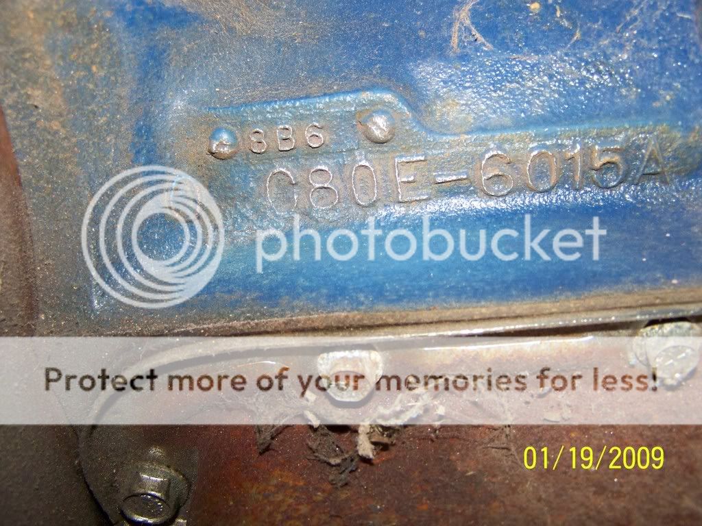

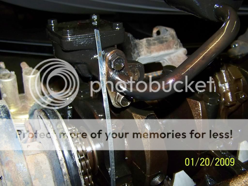

well i feel like an idiot now, :icon_bounceblue: i cleaned the numbers this time. pics shall show...
that was scary! lol

302???
Well the good news is with that casting number, does appear you do have a '68-69' 302 block! Sorry to be so cranky before.

Could be either a 289 or a 302 with that block. Depends on which crank and rods are in it. "8B6" tells me the block was cast on Feb. 6, 1968. As Frank pointed out, your front mounted dipstick ain't gonna work with a rear sump pan. A peek inside the crankcase when you swap pans will tell you exactly what you've got and if it's got forged pistons. And do not toss any of those parts off the motor, they're all worth cash on ebay. That aluminum bracket on the front of the passenger side head brings about $15-20. The accessory brackets and pulleys go for about $40 or more.

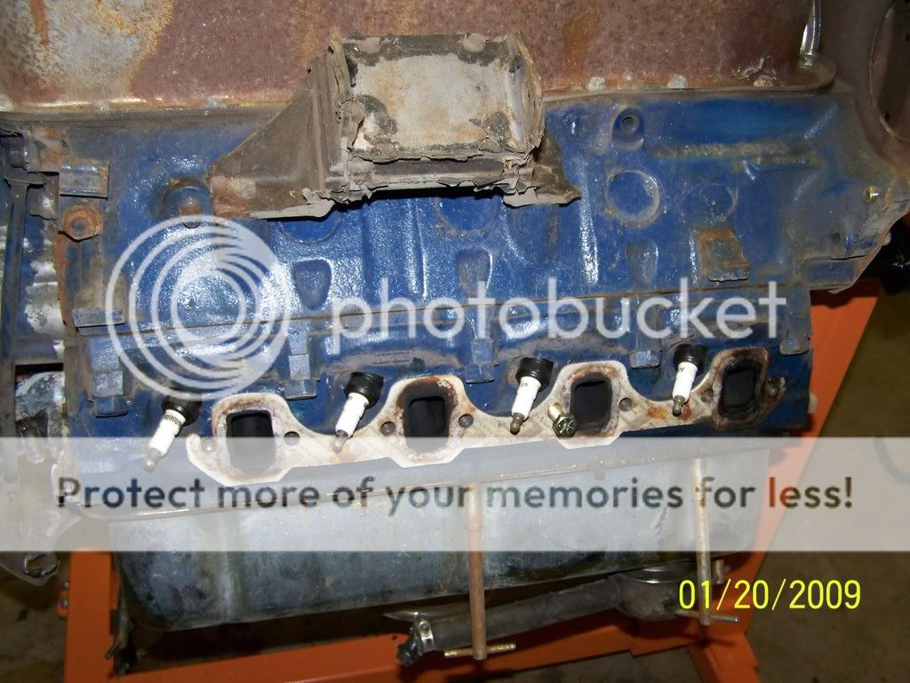

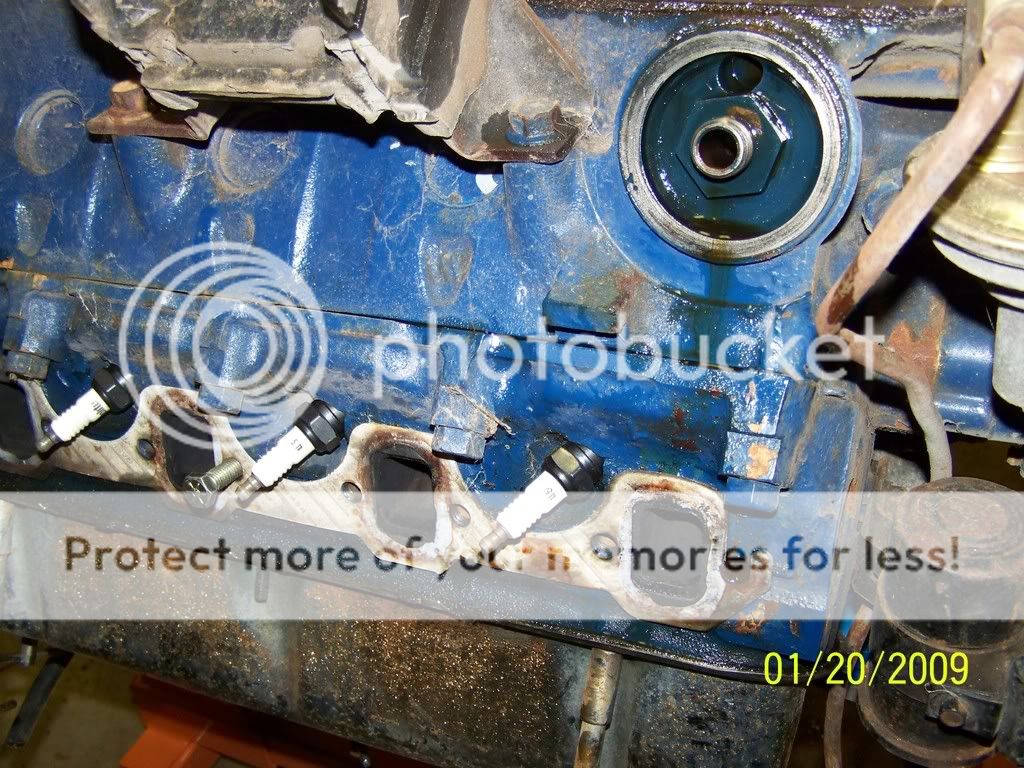

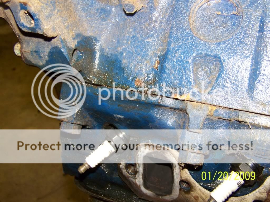

ok well i see a few leaks from the head gaskets, only the drivers side. im not suprised, i mean it sat up for a while and they are just gaskets. no biggie

they shouldnt be bad changing should they? i mean i didnt wanna pull the heads off, but i deffinatly wanna change both of them...

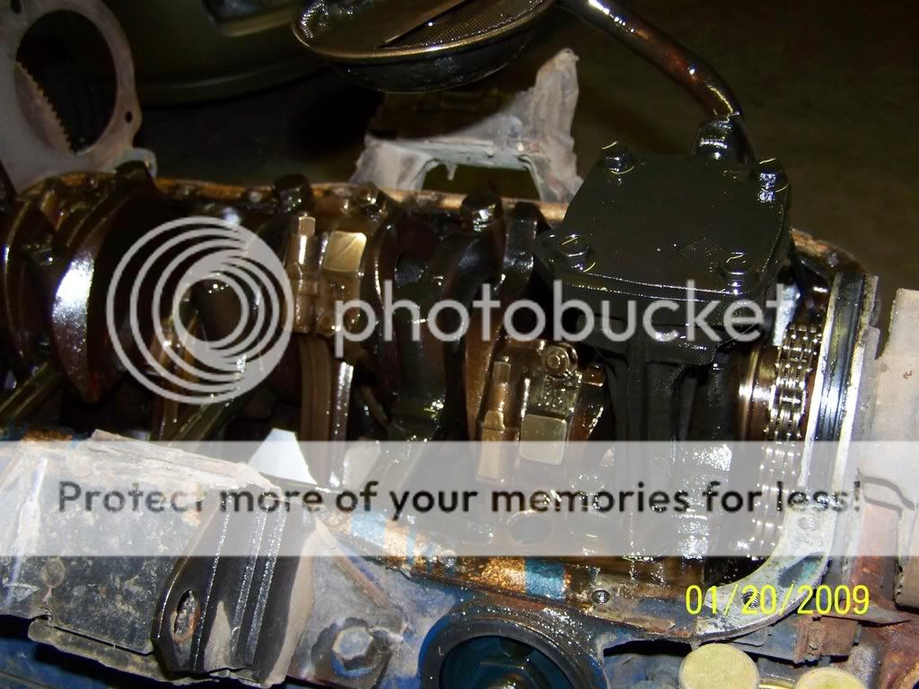

now off with the oil pan.

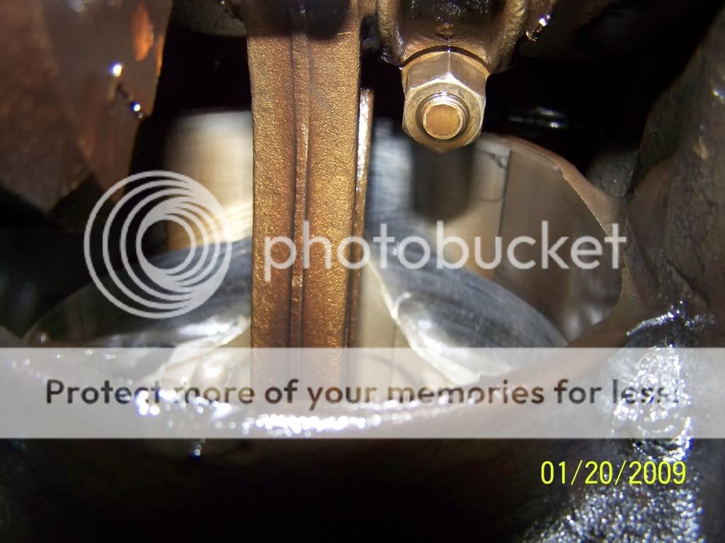

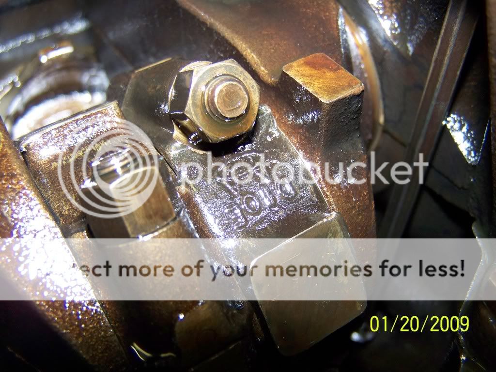

i didtn know what ya'll would want pics of. so i just snapped some. anything in particular let me know, ill get them for you
