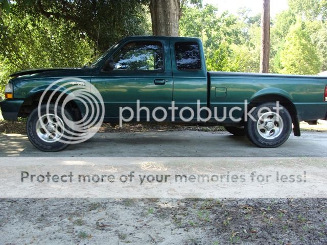

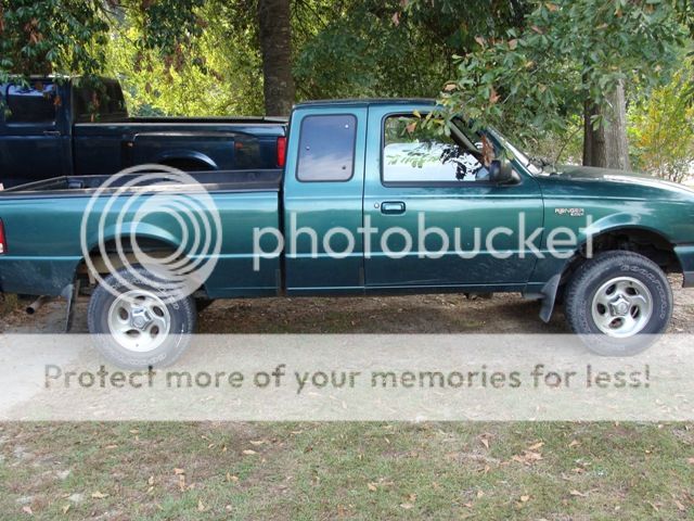

This is my first late model Ranger. I usually get into First Gens. But this one is proving to be worth the time. When I got this Ranger it was rather beat down. The interior was nasty and it ran horrible. It was clear the truck had not been maintained very well. Being since I cannot afford a 4x4 right now I have been using this one in the woods and on the trials. Even with an open diff and no T-case it has gone everywhere I have wanted it to. I have to drive around my friends in jack up 4x4’s when they have to get out and lock in the hubs. I have only gotten stuck once and that was my fault for not paying attention. If I had a traction aid I think I would have gotten out though. So, I am doing to some minor mods to make this truck fit my lifestyle a bit better. I am using a lot of parts and pieces I already have as well as parts from the salvage yards and seeking out good deals on the rest. Plans include an 8.8 swap with a traction aid and disc brakes, minor suspension lift, 31 inch tires and several other mods along the way.

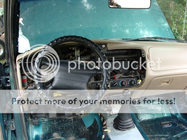

Being since I hate sitting in filth, I started with the interior. The seats were beyond salvage so I stripped the parts I needed off them and scraped the rest. I used a set of Eddie Bauer 95 F150 bucket seats I had laying around. I tore them down to the frames and used the tracks from the Ranger seats. They turned out great. Once I get new seat covers I will post photographs. I gutted the rest of the interior including the dash. I scrubbed, scraped, and disinfected everything. I hung the carpet up and saturated it with a powerful cleaner. After allowing it to soak for a while I sprayed it down and repeated the process until it was clean on both sides. It even smells good now. A couple of days before I started this project a friend of mine accidently busted out the rear window. He replaced it though. While it was out I pulled the headliner and cleaned it as well. While everything was out I insulated everything I could. I had a roll left over from another ranger I did a few years ago. I have no need for a cigarette lighter so I converted mine. I got a 12V cap from a Ranger at the salvage yard and modded the bezel to make it fit. I had to use an O-ring as a spacer but it turned out great. It looks like it came with two 12V outlets from the factory. I also sprayed foam under the cub holder bezel that the shifter goes through. I did this mostly to keep my drinks a little cooler for a little longer. I have noticed it is a little quieter in the truck now. But I think that is also because of the insulation I ran throughout the interior. I have not done the doors yet. That “should” be the final step in the interior portion.
