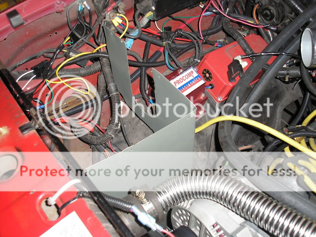

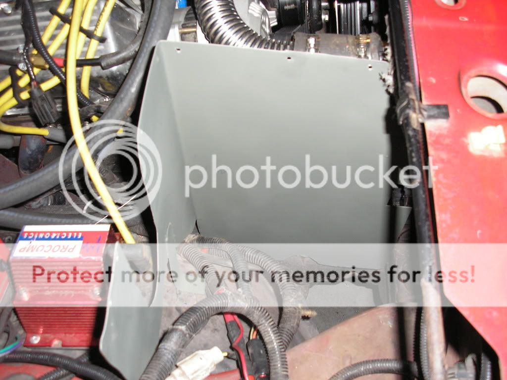

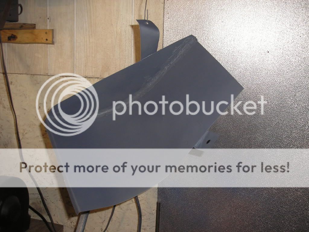

Well, I've been working on this air box and I think I've finally found a design that works. I just hate sheet metal! :annoyed: Put a 100btu's to it and it burns through............
Anyway, I got the etch primer layed down and took some pics(before the camera battery died.)
You can't see it, but the cover is also made too. Again, battery died.

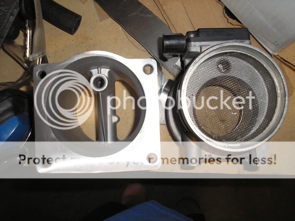

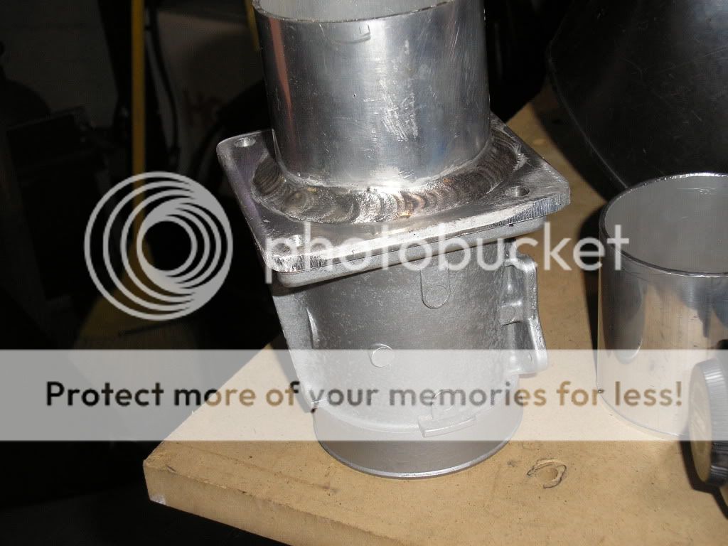

I also bought a 70MM MAF housing to replace the very restrictive and turbulant 55MM stocker. The "new" one is from a 1994-1995 mustang, flange style.
BIG DIFFERENCE!! :icon_thumby:

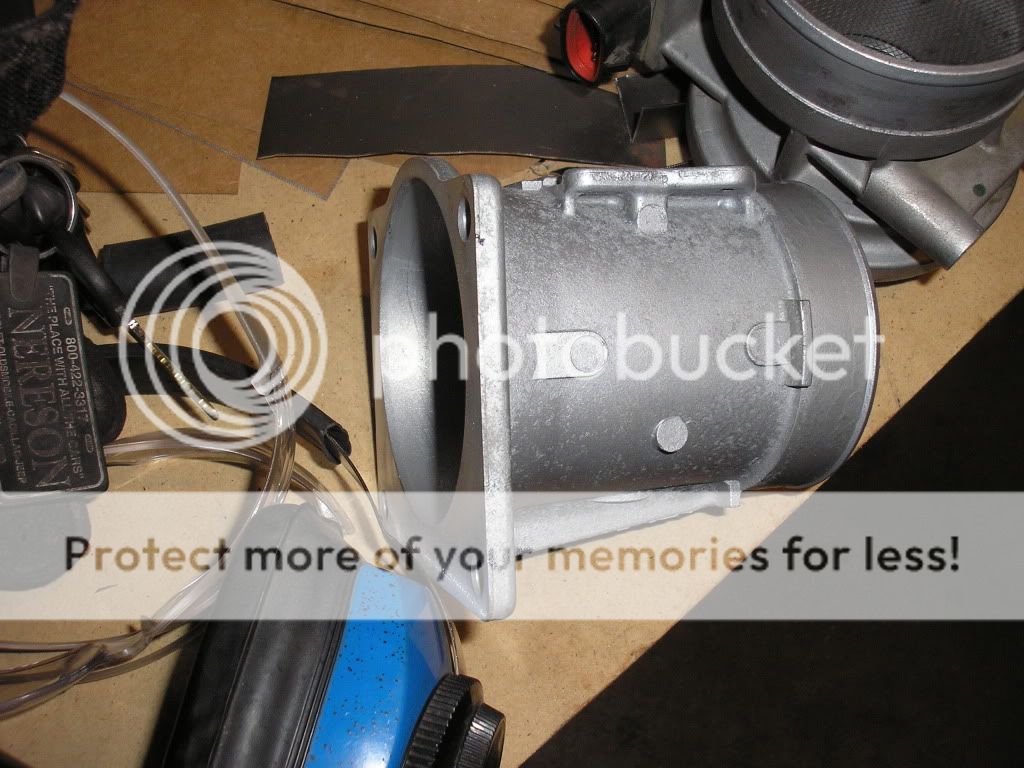

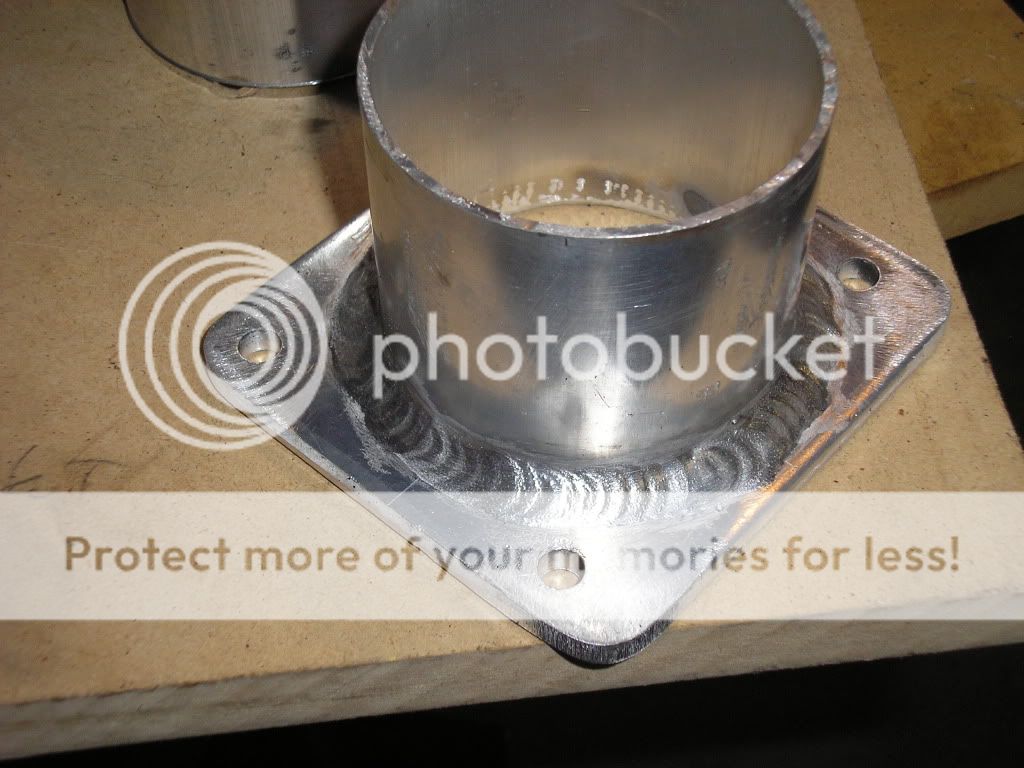

Now, you might ask yourself "But how is he doing to connect the tubes together when the MAF housing is a flange style? It can't be done! It's not like he has access to aluminum scrap and a TIG welder or anything..............."
:D
Problem solved!

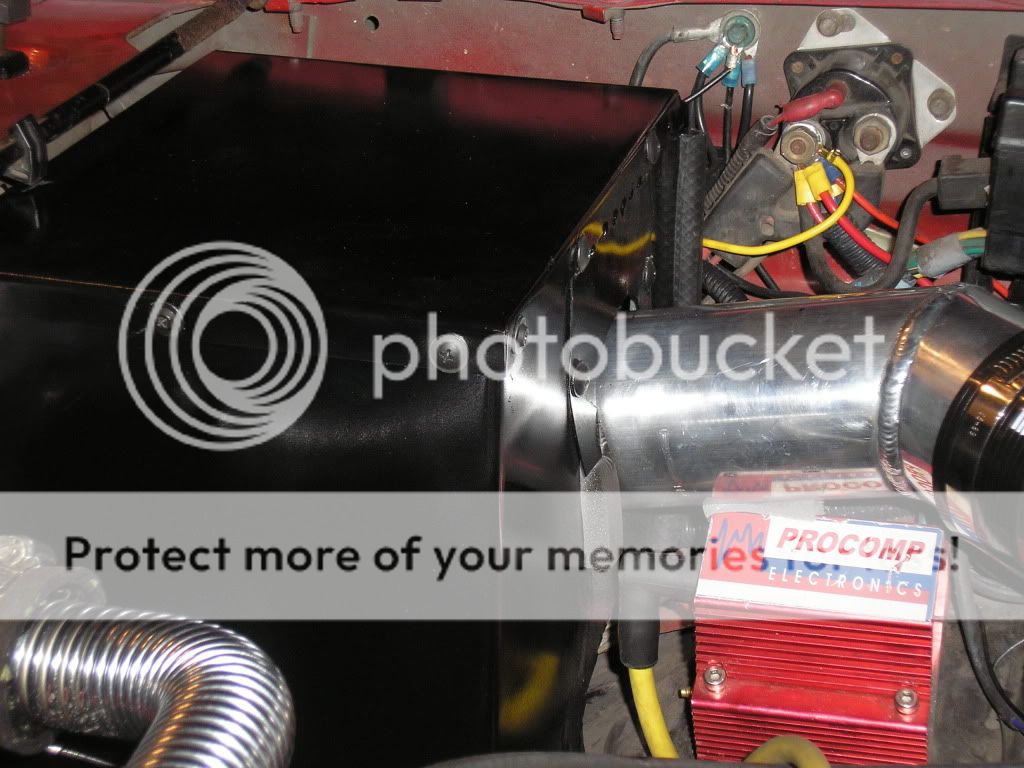

Done!!!
And my "snow shovel" in primer!

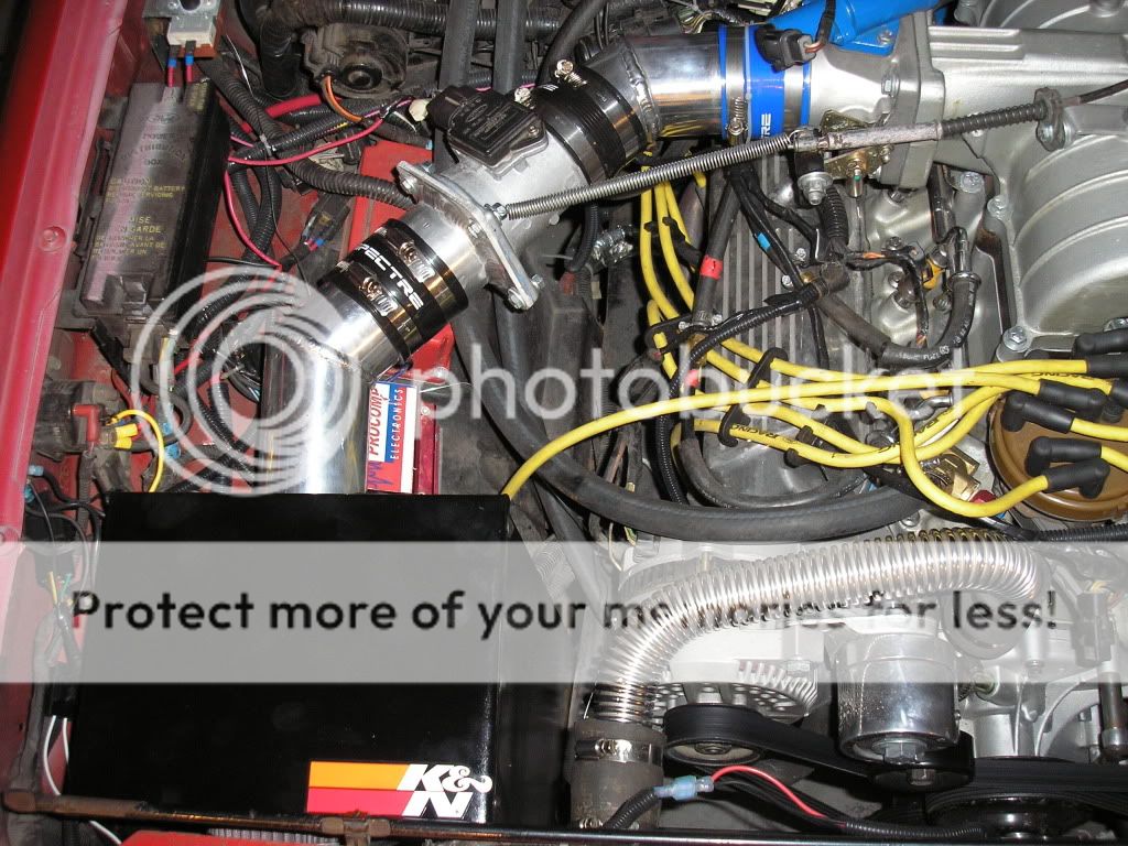

My overall shot of it. I think the K&N sticker is in just the right spot! :icon_thumby:

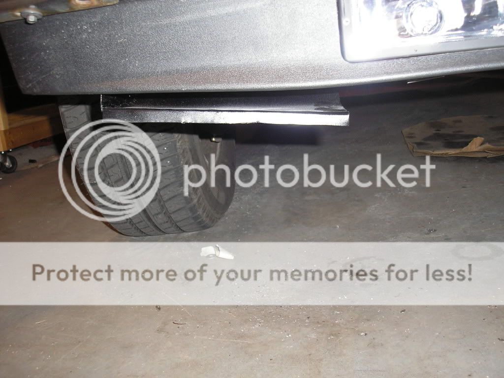

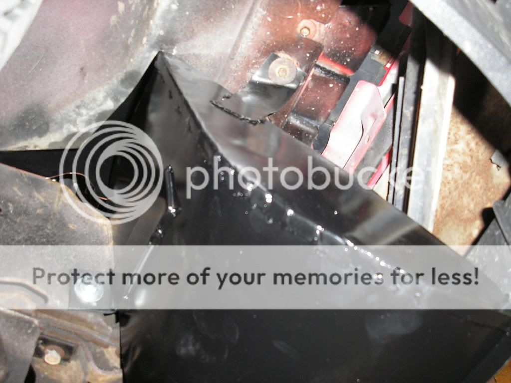

About an inch of exposed scoop.
And it curved up and directs the air right into the box. As close to "ram" air as I'm gonna get.
