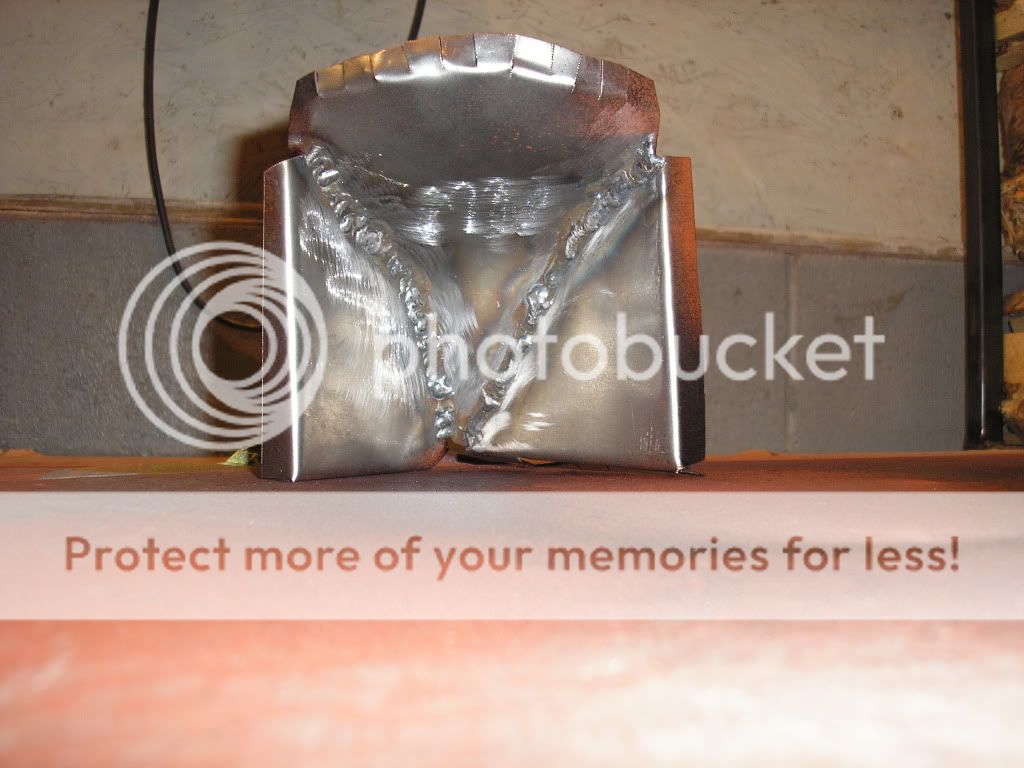

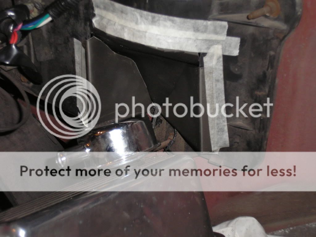

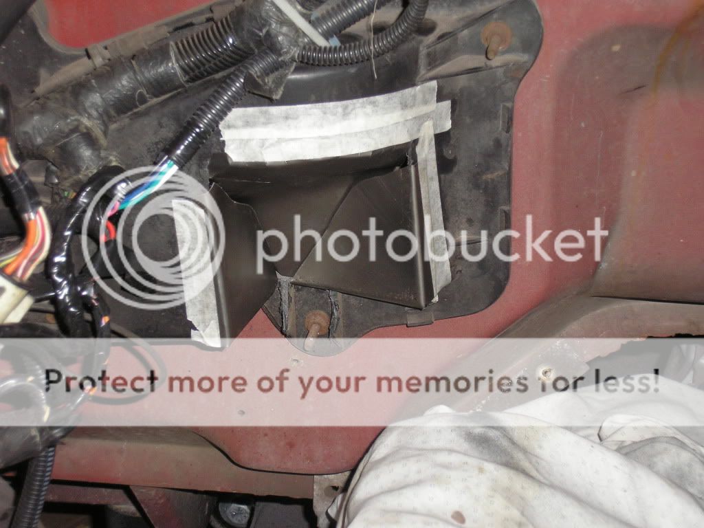

Well, some more pics are in order. First is my air box cut out the make room for the valve cover when we finally drop the body 1 1/2". I made extra room so that the breather has room to.......uh.......breathe.
This has been, by far, the hardest thing I've done to the ranger. Hard to work with sheet metal, much less when I have to weld it. The openning is so awkward that I almost lost it!!

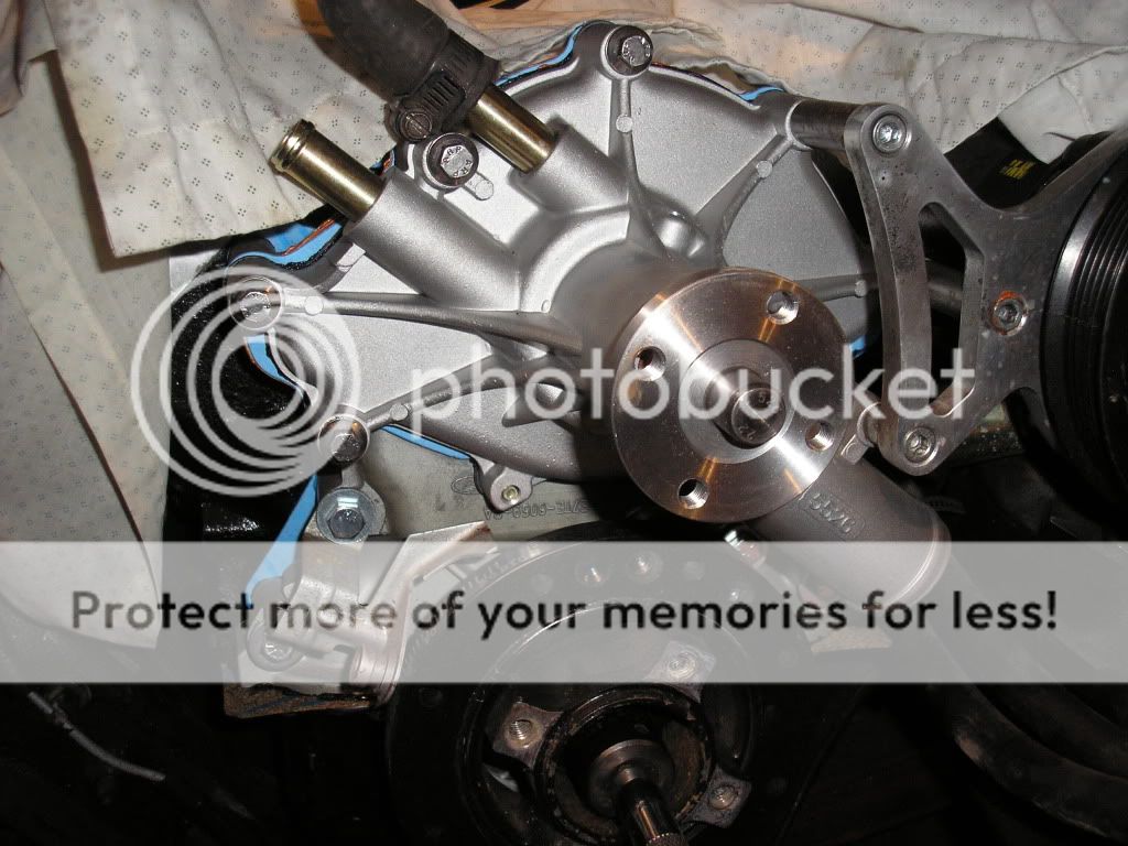

And a picture of my brand new waterpump.

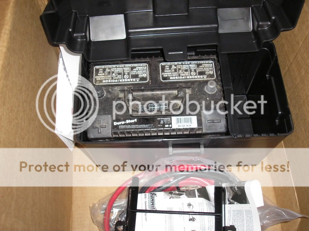

And my new battery relocation kit from Summit Racing. Putting the battery in the box and sacrificing the factory tray for my cold air intake filter.

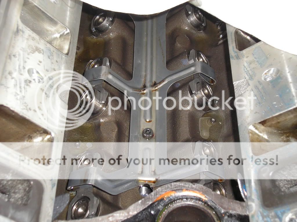

And a nice, clear shot of the once-flat-tappet-now roller valvetrain. Even though the F-150 from where the block came from wasn't roller, the block was already tapped to accept the spider tray. Sweetness!

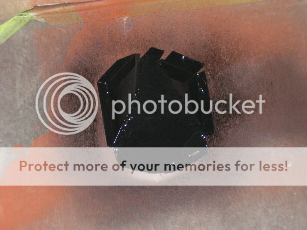

And I welded up my air box mod. I reeeeeeeeeeally hate sheet metal:annoyed:, but at least it's done and the "inside" is painted.

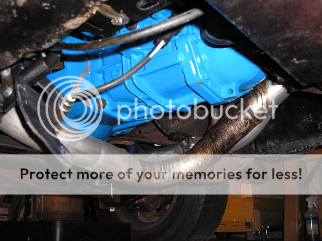

Well, here's the tranny installed:
There's some leak issues on this one, but I'm hoping a few miles of Bars Stop Leak will plug up the holes.

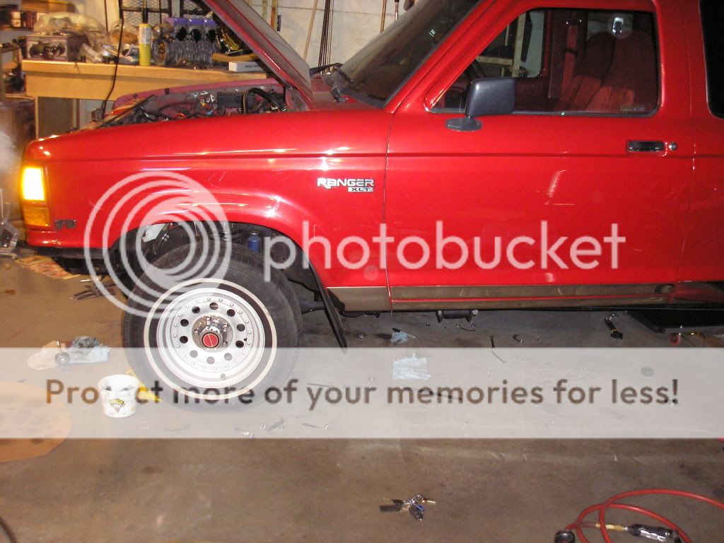

And my brother and I dropped the cab last night. Only clearance issue is one of my exhaust dumps is a little over 1/2" away from the cab's heat shield, but I should be OK.
The pushrods came in today, so my brother will be putting the motor back together. I gotta find a good spot and mount the battery box in the bed. Then after the engine is all put back together, I can drill out the spot weld holding on the battery tray and convert that little valueable space into the air cone's new home.
Mount the battery on the passenger side. For weight / traction reasons. Good luck on your battery tray, mine was a lil biatch coming out. Oh, and nice waterpump hardware btw.
I opted for the battery to be mounted on the passenger side at the back(for easy access) and you were right about that tray. :annoyed: 2 hours went by and I finally "hulked" it out of there.
