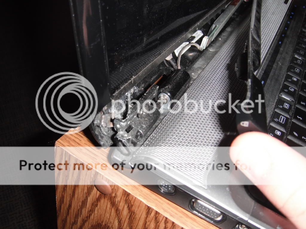

this sucks.. is it repairable for a price less than my soul?

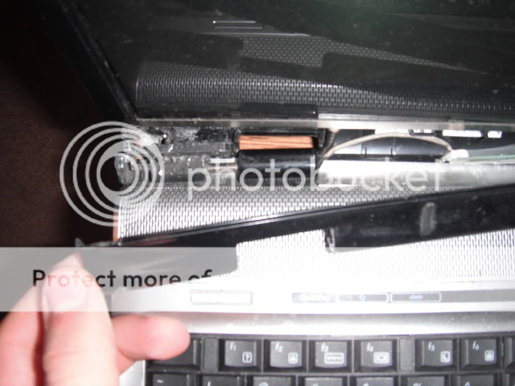

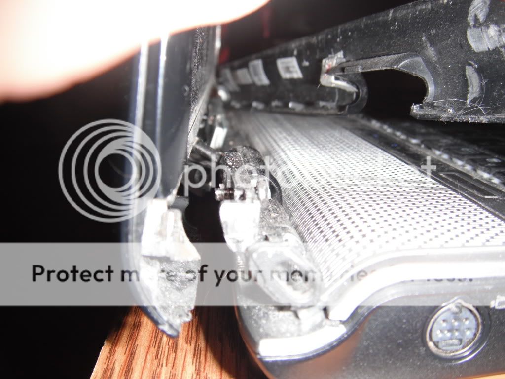

Actually I'd estimate that as THREE major parts.
1) an LCD back cover (the screw pillar that the screw that the front bezel and the hinge mount to is busted off)
2) An LCD front bezel.
3)Switchpanel/Hinge cover
And two minor parts
the HINGES which are obviously galled and sticking or the plastic stuff wouldn't have broken in the first place
and though I can't see it in the pictures there are metal strips on either side of the LCD which are screwed to the hing and the one on the side of the messed up hinge is likely bent beyond easy straightening...
And it seems a few screws are missing.
All stuff you can get on ebay for $70 depending on how patient you want to be about buying and shipping.
And two minor parts

Open eyes and LOOK.
I have several Dell's and they are the same (form follows function) as that, but the bezel screws
go SOMEWHERE. that "somewhere" is THROUGH the Hinge and into a screw pillar (with a molded
in place brass insert) the piller is CLEARLY seen as snapped off.
As a Note:
It's NEVER, NEVER, NEVER "just the bezel" the broken Bezel is a symptom of a broken screw post
in the back cover which is in turn a symptom of a sticky hinge.
Replacing "just the bezel" will result in breaking another $25 bezel
This is a common problem, with recognizeable symptoms with PICTURES so you can SEE what is
actually broken, but you have to look at the OP's pictures...
As for the guy who said "just break it off" the WiFi antenna is in the back cover too...
"breaking it off" might just break something else, probably something you need.
