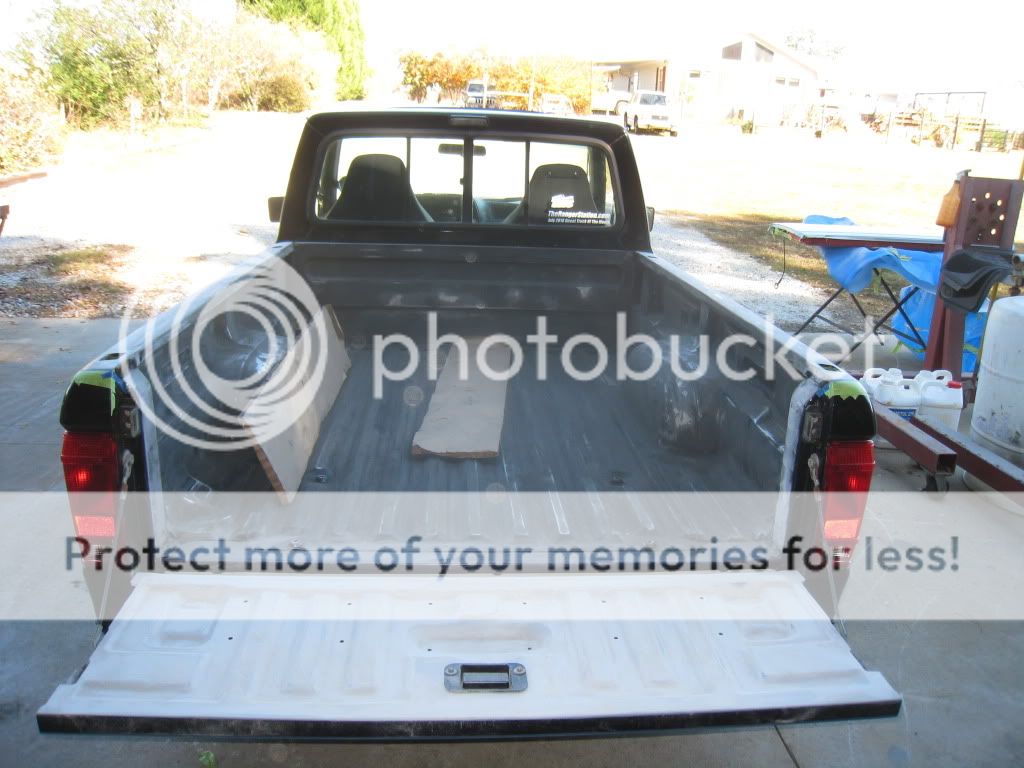

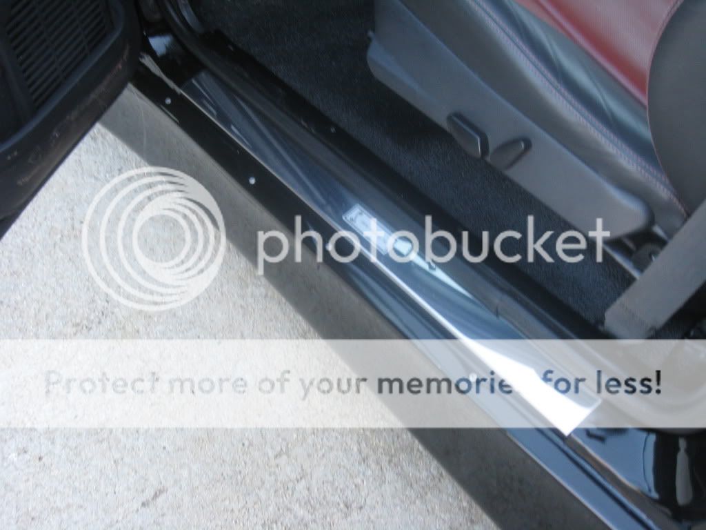

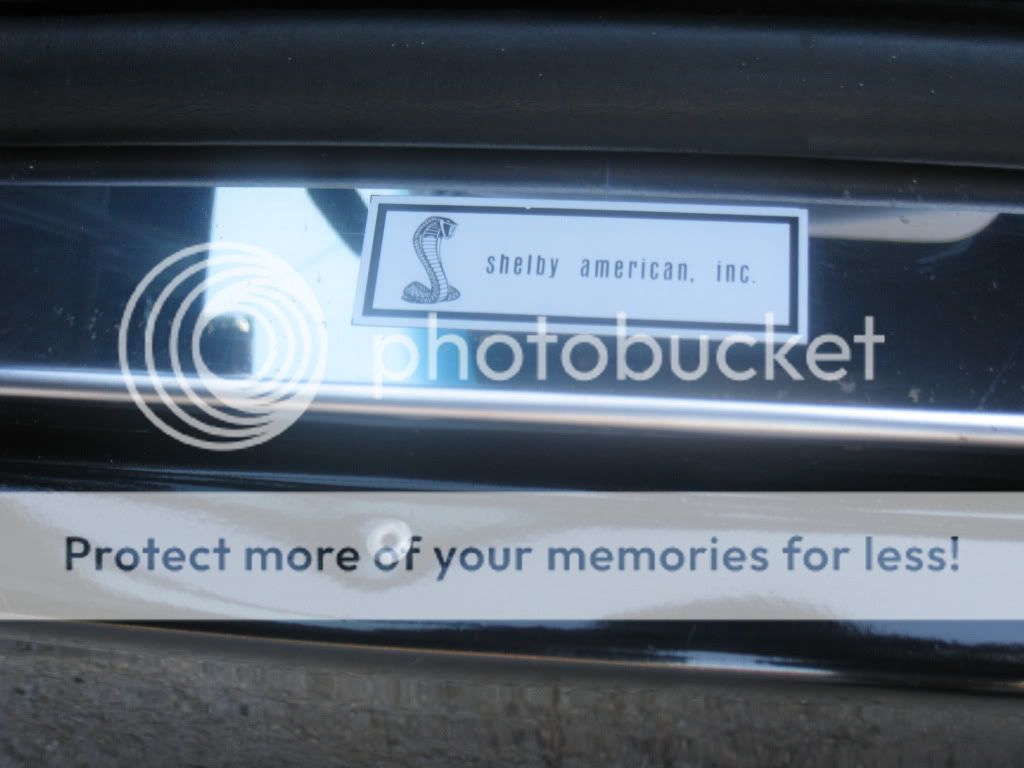

Added a few items to the truck... No major deal but adds personality. Plans are to do the spray in bedliner and build spare tire carrier under truck.
here is a thought about the spray in liner that I have. Right now in the can it is clear. It can be tinted to any color. So my thoughts are to lay out a Cobra in the bed floor and paint it with liner... the only thing is it would take many weekend to complete because of dry time... So the whole bed would be black except a cobra in the middle of the floor...

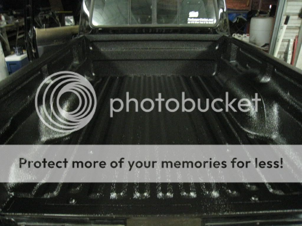

It would have been gold... Decided it was too much to deal with and with the weather turning cold I am ready to get it done so solid black she goes... But it would have been cool...

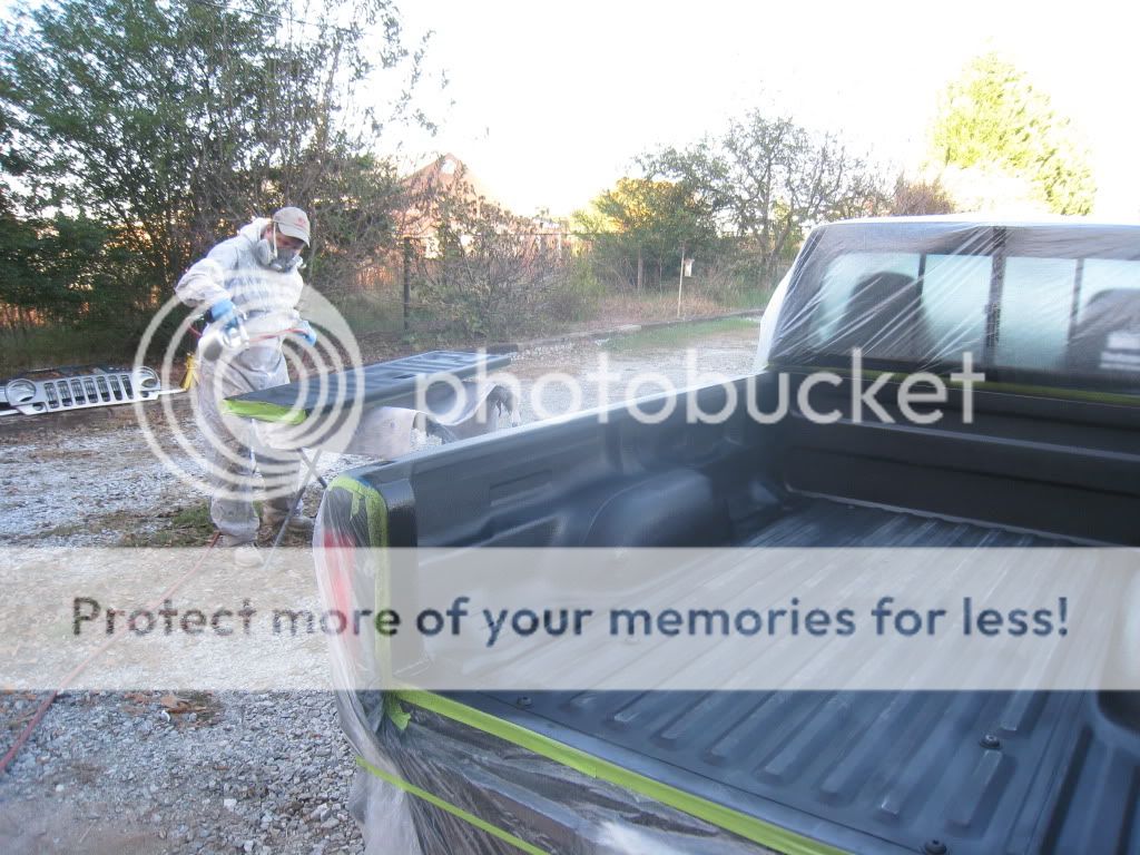

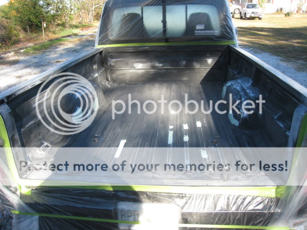

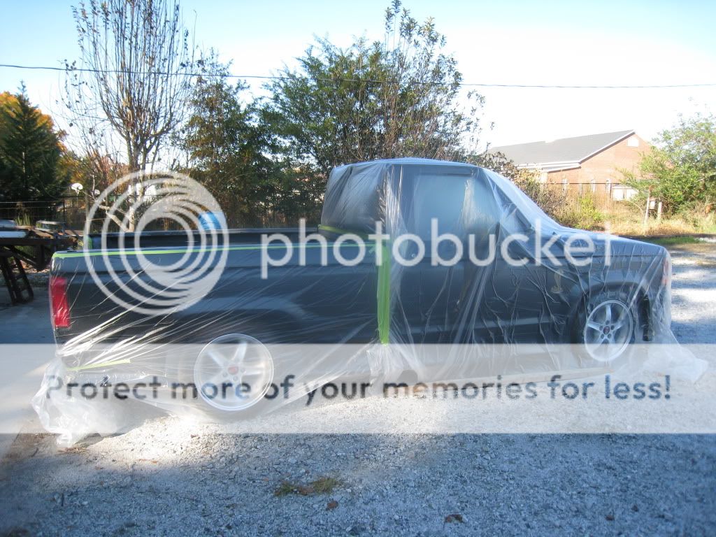

Nice to get a big task done for a change... I have never sprayed any of the other liners you can get from the parts store but I have seen trucks with it sprayed in... I will tell you SEM has the best you can get. Others I have seen look more like thick paint to me.. The down side you have a pot life of 20 min after the hardner is mixed in. So mix a little at a time!!

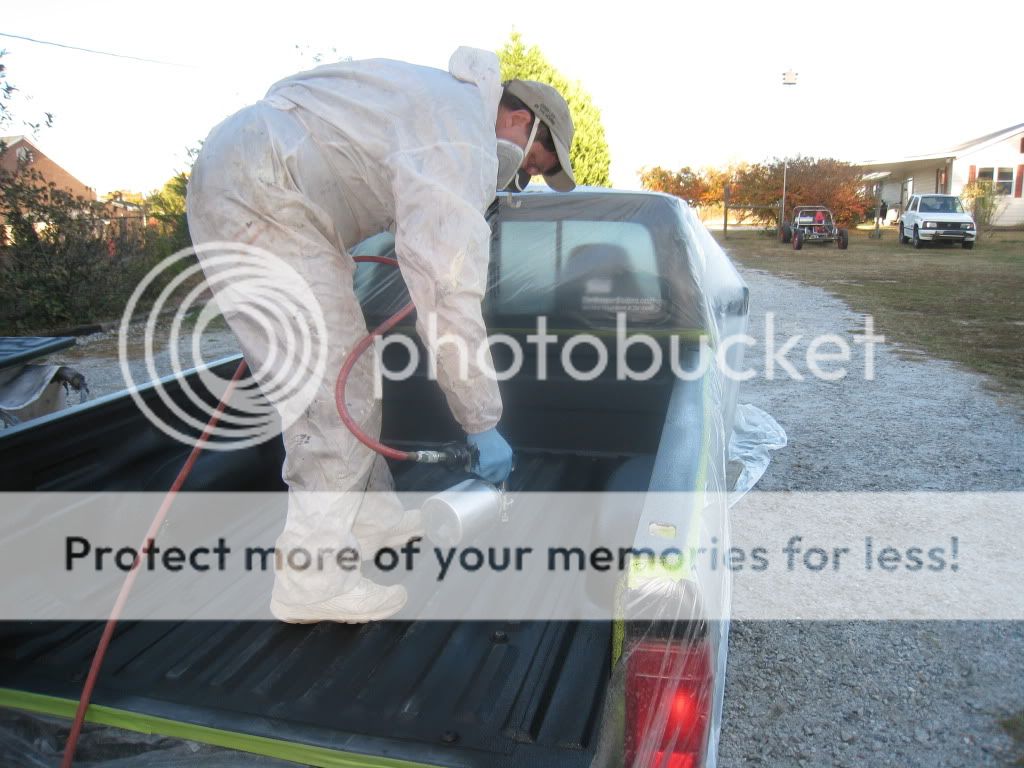

Thanks Bud!! I would imagine you are talking about a Binks #7.(Man Those are old school!). It isn't big enough for this stuff.. You can use a body Shultz gun but the correct gun to use is this one.
http://semproducts.com/Catalog.asp?prod=158 This thing is like a garden hose :icon_twisted: Oh yeah keep in mind it comes in two flavors.. Clear that is tintable which is what i used (i got it free) and black..
Tints 8 to 1 part color and then 2 to 1 part hardner.... Black just mixes 2 to 1...
I doubt you would want to roll this stuff on.. Not sure if it can be or not though However I wouldn't attempt it even if it can be done...
