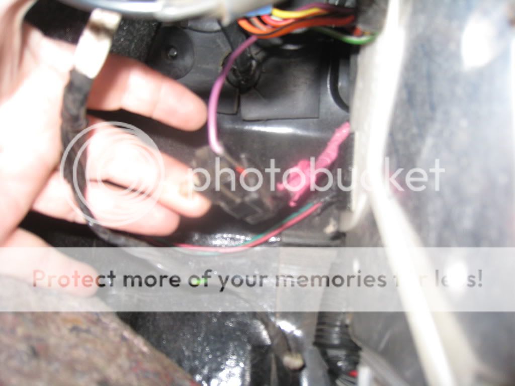

Finally!!!!!! I figured out the problem! Here is the deal. Over by the ECM there is a wiring harness that is wrapped in pink tape. It has 5 wires going into the pigtail that would accept a 4 prong pigtail. 2 of the 5 wires are grey with black stripes. the pigtail that plugs into it has one purple (I think) Wire. the other three spots in the pigtail are blank. Back to the 2 grey with black stripe. They both go into the same position on the pigtail. one was pulled loose and had the tip exposed with bare wire. Cranked the truck and checked the voltage on the exposed wire. 0 volts. Checked the other and had a reading. Since it didn't go anywhere I cut it out of the pigtail and wired the 2 G/B wires together and taped back to the harness to protect it. Cleared the codes with the Snap On scanner and test drove. Tested again code 111 No codes present. Test drove again about 7 miles or more and tested again. FIXED! I knew that wire was loose since I put the wiring in last year but thought it was no big deal since it didn't go to anything since the pigtail that connected to them was blank.
I would have never thought that would be the issue.. Like I said I knew it was pulled loose I just reconnected it as a last resort since nothing else worked. Goes to show usually the fix is somthing stupid simple. BTW if you clear the code and rescan it with out a test drive it comes back no codes present so code 245 was there on the first road trip... I only discovered it after the road trip to the air museum when I scanned it due to horrible fuel MPG the CEL hasn't been on sice the new 02 was installed...
