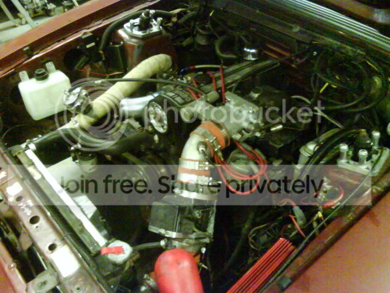

if your gunna build a 2.3...turbo is the only way to go.
my old set up.
320hp and 380trq, all on stock computer and 100% stock longblock.
