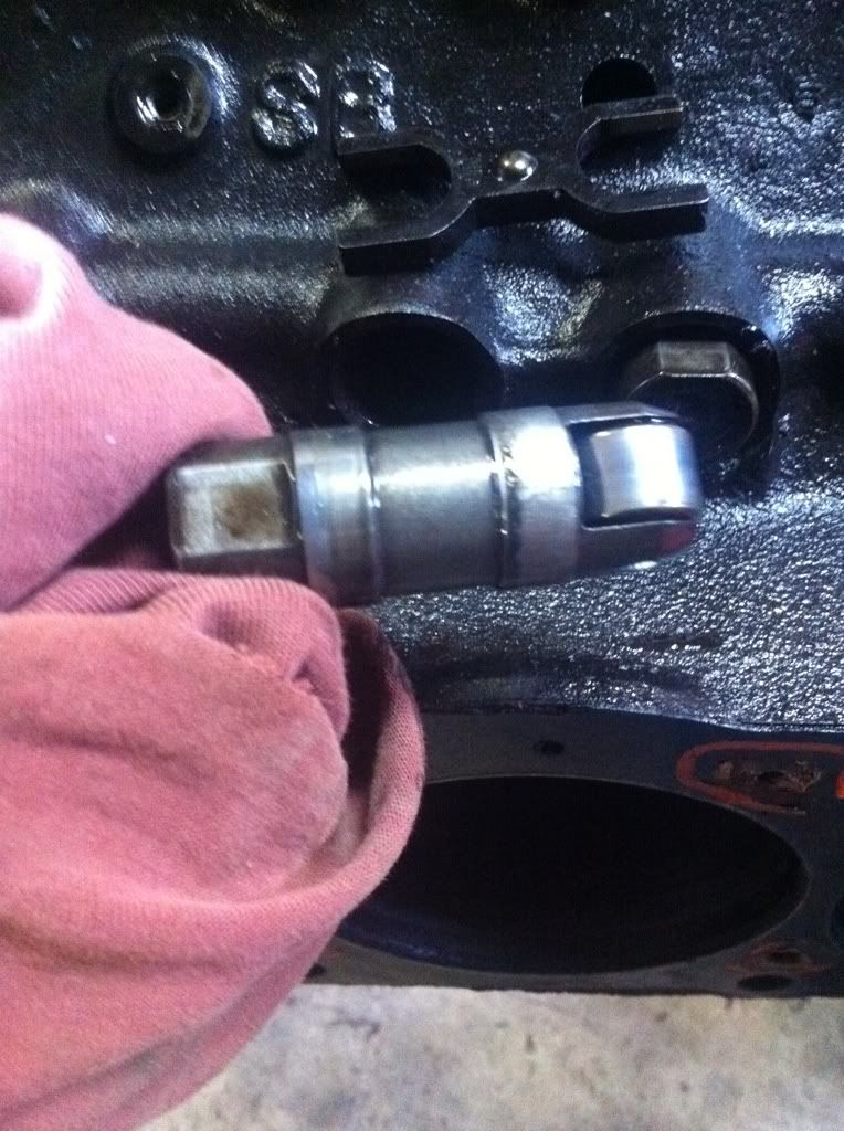

lifters.. is there any way to tell if theyre worn or due for replacement?
pistons are a mess, whats the best way to clean them up?
i know these parts for the lifters got up wrote on 1 side of them, but do it matter which lifters they belong to or if a certain end is facing front or back?

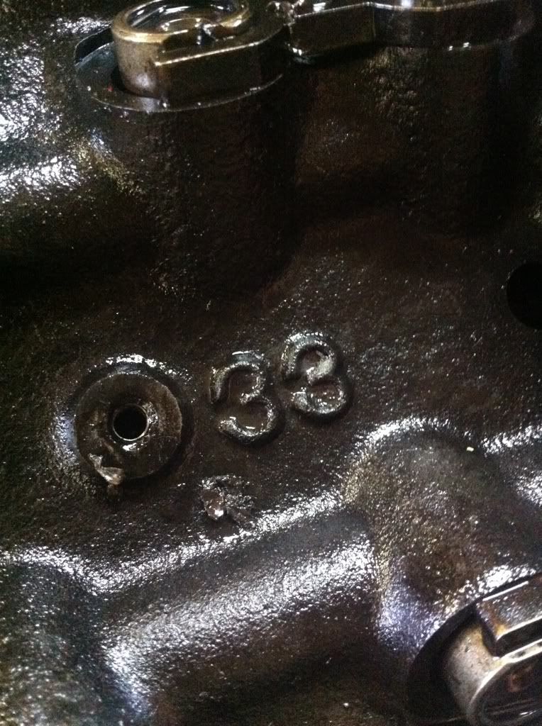

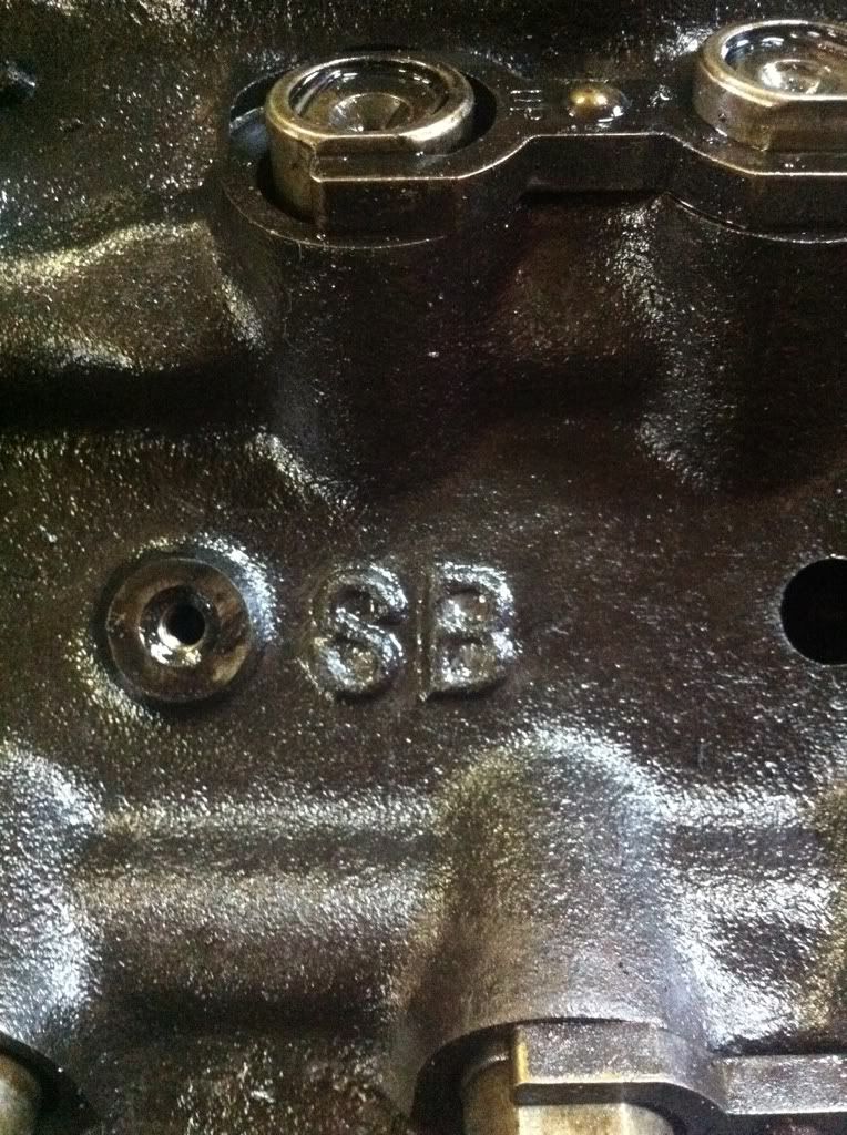

and thats about all the time i had tonight. heres a couple more pics of some markings, maybe someone could tell what they mean
Yes, you can just replace the intake system with a carbed setup. No difference in bolting up to the heads. The Lifter dog bones can be mixed, no problem there. I would recommend replacing the pushrods with new ones as the roller pushrods do not spin and end up wearing on the rocker ends. As for cleaning the pistons, you can do that with a wire wheel (use a brass one) on a drill, just do one at a time when the piston is at TDC, then blow the excess carbon out of the ring lands with a air gun, or flip the block upside down and use spray carb cleaner to flush the loose crap out and off the pistons. (I'm assuming you're going to leave the short block assembled here) Clean the head and block deck surfaces too with a wire wheel but you can use a steel one on these surfaces (iron decks) You will also need a steel geared distributor to match the roller cam to run a carb.
