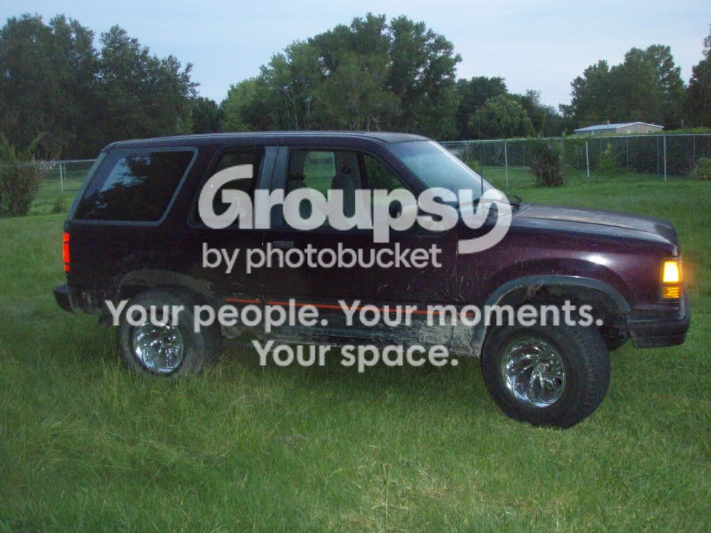

1994 2 door 4x4 4.0, 5 speed, push button t-case, 35 front, and 8.8 rear. The wheels and tires are 15x10 Primes with 265/70/15 tires, the front two are matched Yokohama's and the rears are unmatched tread but the same size. I got the wheels and tires for like 400 bucks and they had 3/4 tread on them. It has 148,000 miles on it and still runs strong. 4 1/2 years ago I bought a 5.5 inch Superlift kit for my 94 Ranger that had an identical drivetrain in it. Well I gave the Ranger to my mom when I moved to Florida and drove my 90 Cummins Dodge down. Fast forward to 2009 and while I was in Iraq working as a contractor me and my dad decided we needed to buy something to put the lift on as it was brand new setting in the box. I told him to find a 94 Extended cab Ranger or 2 door Explorer with a 4.0 (or a 2.3 cause I can get ALOT of race car parts cheap locally) with a 5 speed. I talk to dad the next day and low and behold he found one at our buddy's used car lot. Got it for 1500 bucks and they put a new water pump in it. It needed a new A/C condensor so dad put a new one in and some other small things. I got to find a good source to get a new set of rocker panels for it as the ones on it are shot cause it was originally from Pennsylvania...
Stock...
Stock with tube front bumper and box tubing rear bumper...
Tear down and assembly. Its a pain in the ass to do when your doing it by yourself...
Front lifted. I had to heavily modifiy a set of Ford Superduty brake lines so I didn't have to buy aftermarket ones...
Lifted but still needed the new lower shock tabs welded onto the axle, the rear sway bar mounted and the alignment...
On its maiden voyage with its new front bumper. I plan to make some type of grill guard for it eventually. It needs the alignment finished and and the rear sway bar put back on. I need to adjust the emergency brake cable also, it hangs up occasionally when you hit the brakes at low speed and locks up the left rear tire. Once I find a front center section with 3.73 gears and a rear axle with them I am going to swap it in, cause right now 30 inch tall tires is all those 3.2X gears want. I have a set of 33 all terrains, a set of 33 inch mud terrains, and a set of 35 inch all terrains I can mount on them, I just got to decide what tires I want to run, it will probably be the 33 inch AT's...

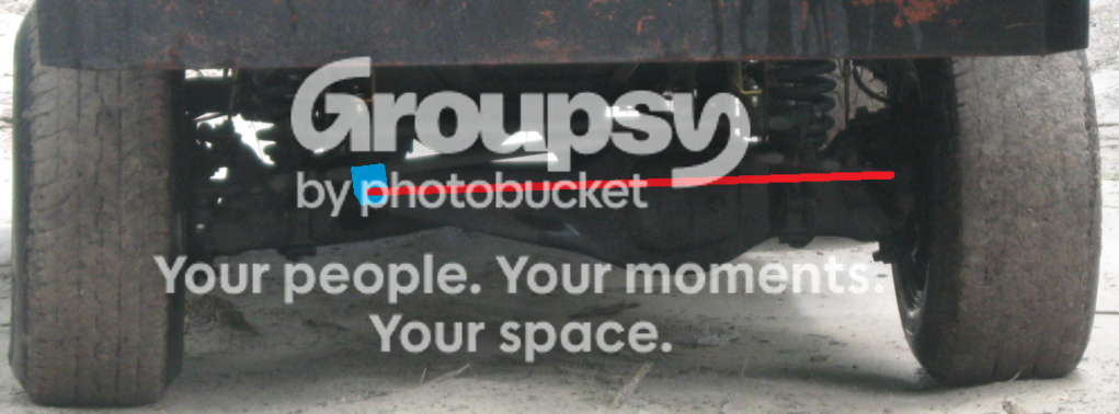

Remember that pic was taken before the springs had had a chance to settle and before my partial alignment was done. I got to take it over to the race shop one day this week and put the toe plates on it and see how far out the toe is then set the camber on it...
shouldn't matter if the springs settled some or not... the steering is still to angled. i'd recommend the stonecrushed or homemade something like it but w/ TRE's.
other than that, waiting for updates! subscribed!
In theory, actually it does matter, if the tires are like this / \ due to sagging springs then it can raise the axle mounting point in relation to the steering arm mounting point making it flatter cause there is less height from the frame to the axle and the same goes if the tires are angled like this \ / due to taller springs, it will create an angle that puts the tie rod at a different plane cause there is more space between the frame and axle...
There's way too much angle on that steering linkage, it's not gonna settle to straight. Simply put, your pitman arm is too short.
If you haven't seen this yet, take a look through here which explains exactly what's happening:

The springs have settled some and I think its still got a little to go. I got some of the alignment dialed in tonite. I never put new center pins in the spring packs. There is a set of longer shackles on the rear that someone installed before me and I may drop the springs down a hole to see if it helps. I may do some measuring and see if I can get some stock (off another vehicle) parts to work on it with a little modifying. I am going to take my stock passenger side drag link and weld a saddle to it like the Stonecrusher System uses and make as piece of driverside drag link that is longer and goes to the saddle instead of the hole close to the pitman arm. I plan to make it useable with all stock tierods...
Stock steering...
What I want to do...
Some pics from out in the swamp today...
That's essentially what the Stonecrusher's geometry is like, so that should work well.
You MIGHT still need the larger SJ drop pitman arm though if it still wants to do a side-side wiggle through dips at intersections (you are up pretty high it looks like), though what I would do it try it on the arm you have now first and see how it drives, then go from there.
